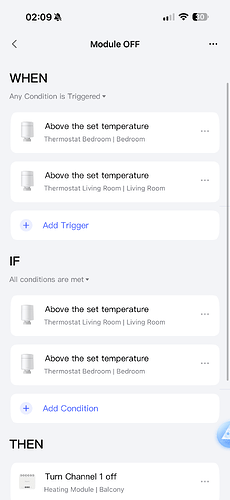

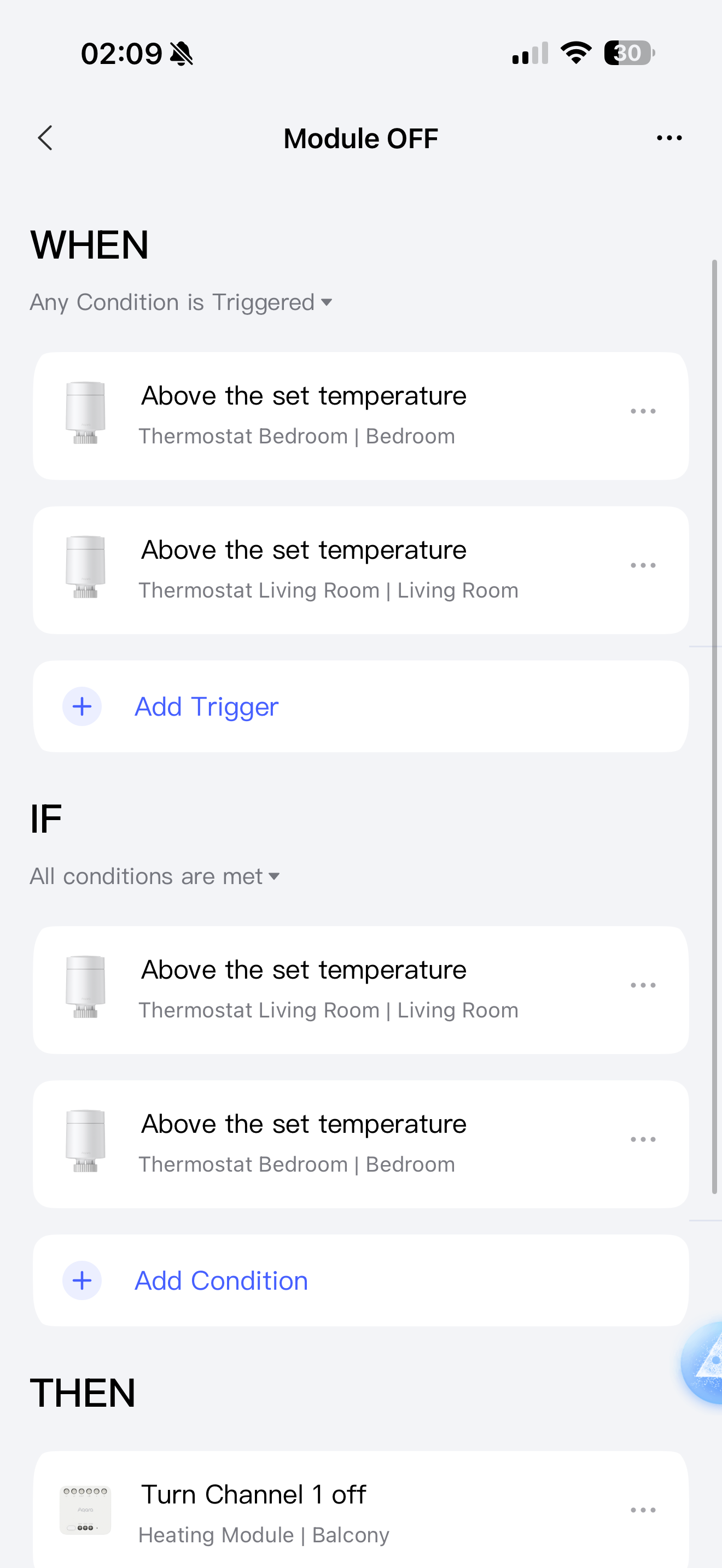

Hello, welcome to the forum. Please provide a screenshot of the automations that are not working for you.
Hello,
Thank you and nice to meet you.
I also tried a simpler approach: manually adjusting the thermostat, but nothing happened.
Example:
When
Thermostat Bedroom is above 22
Then
Turn off Thermostat.
If needed, I can provide a list of all devices and connections.
Thank you.

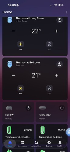

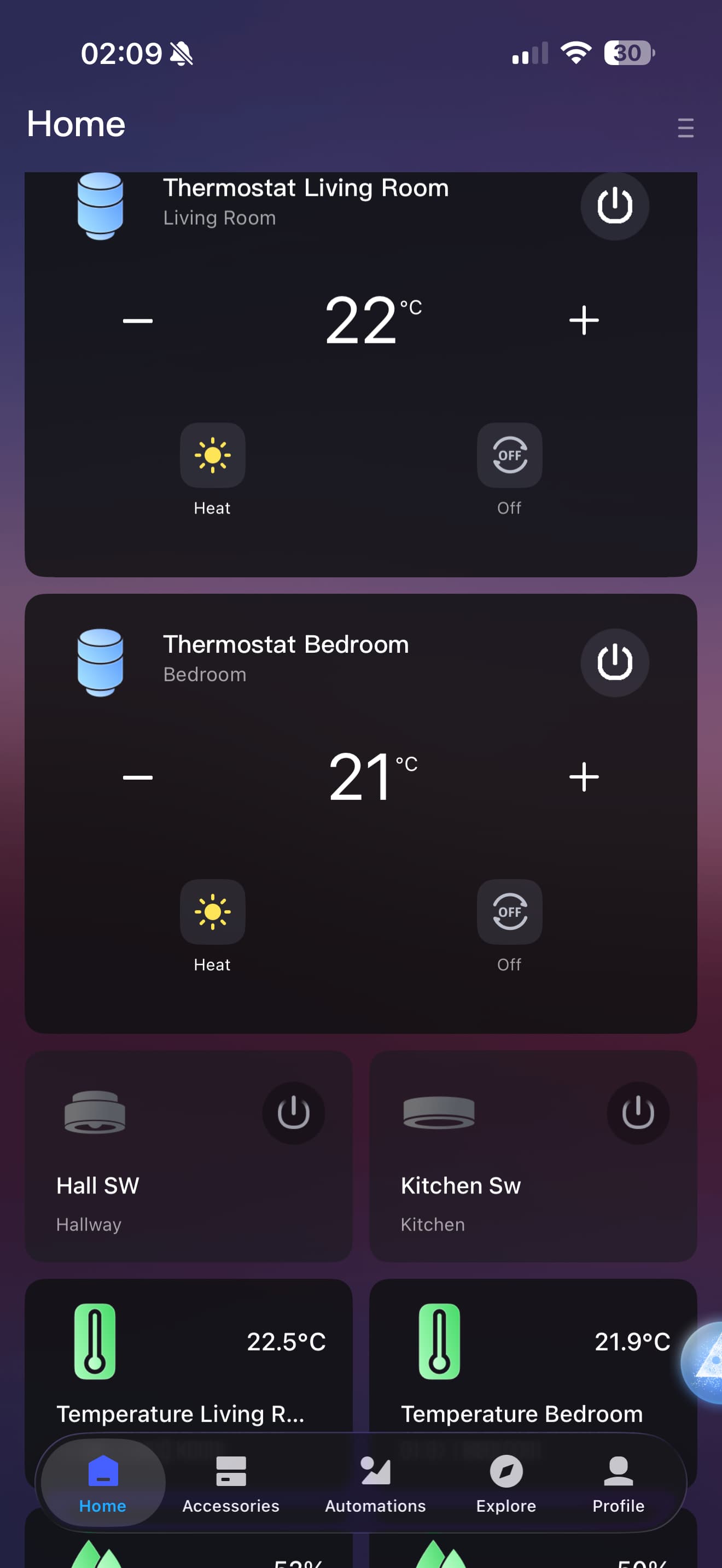

I have the W600 connected to the M100 hub. I just received an update for both, and the automations seem to be working now. When I manually adjust the thermostat values, the valve turns on and off as expected.
I hope this solves the main issue, but I’m curious if my second problem is fixed. Over the last few days, even if the thermostat was set to 21°C and the sensor reading was 22.5°C, the thermostat wouldn’t close the valve, and the room kept heating. If automations are working now, I think I can create one to force the thermostat off entirely. Also, adding a hysteresis setting would help prevent the system from frequent cycling.

Thank you for the documentation. I’m already using 2.0 and I think I’ve found the issue. Yesterday I received another update for the thermostats, and the two automations for switching the relay on/off are now working. I also added a 30-minute timer for the startup as a sort of protection in case the sensor fails, or to act as a workaround for hysteresis.
However, I’ve noticed there is some built-in hysteresis now; when the temperature was 20.2°C and the thermostat was set to 20°C, the automation didn’t stop until I manually set it to 19.5°C. Still, the logic isn’t quite complete. If the relay doesn’t switch off, the boiler will run continuously for the third radiator (the one without a thermostat) until the water reaches the temperature set on the boiler itself. In practice, it would run non-stop because even though the thermostats close the valves at 20°C, the automation reads that they’ve reached the target temperature. It’s strange.
