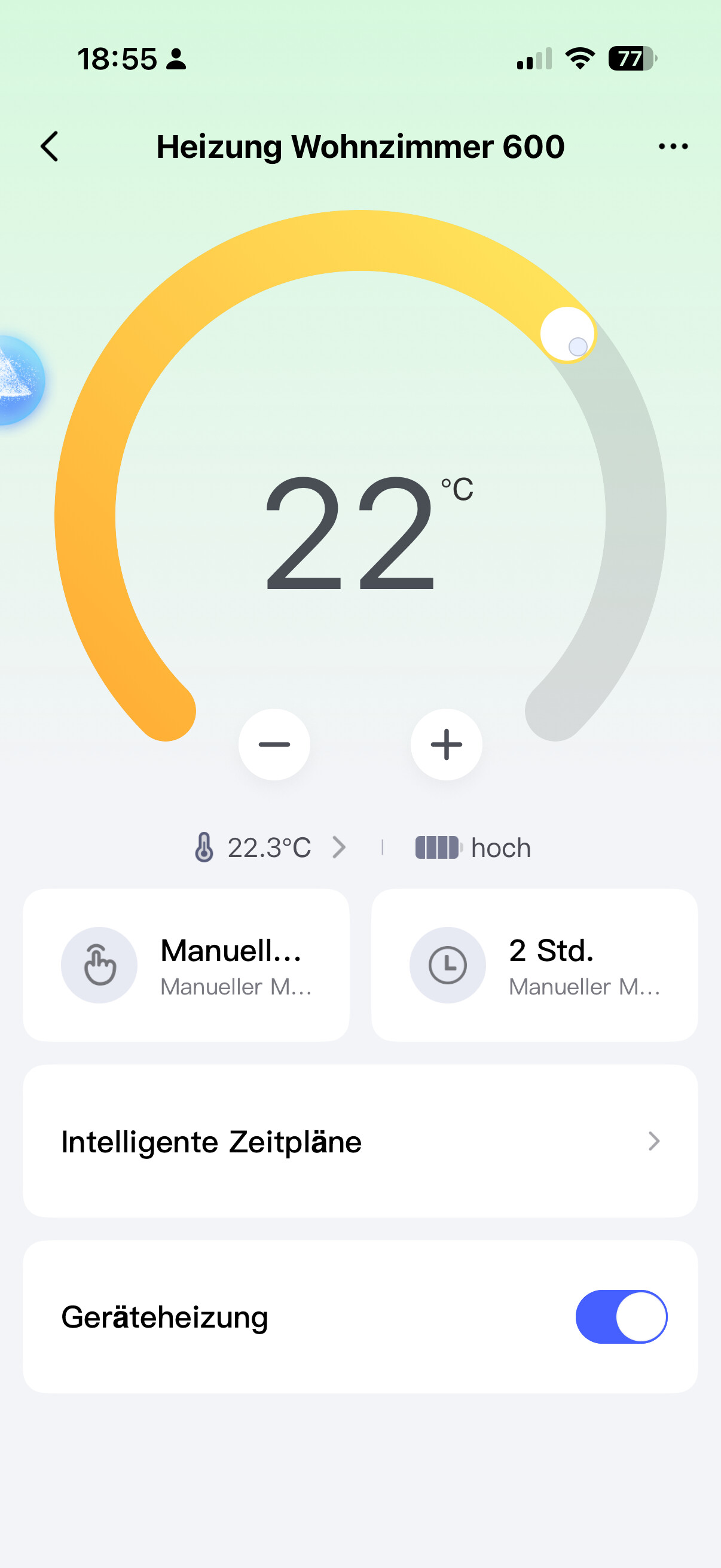

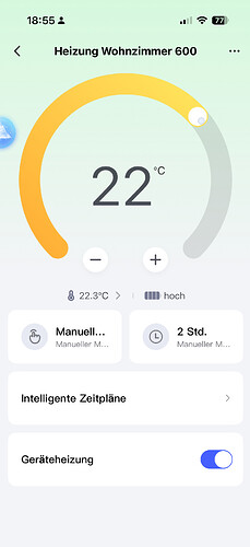

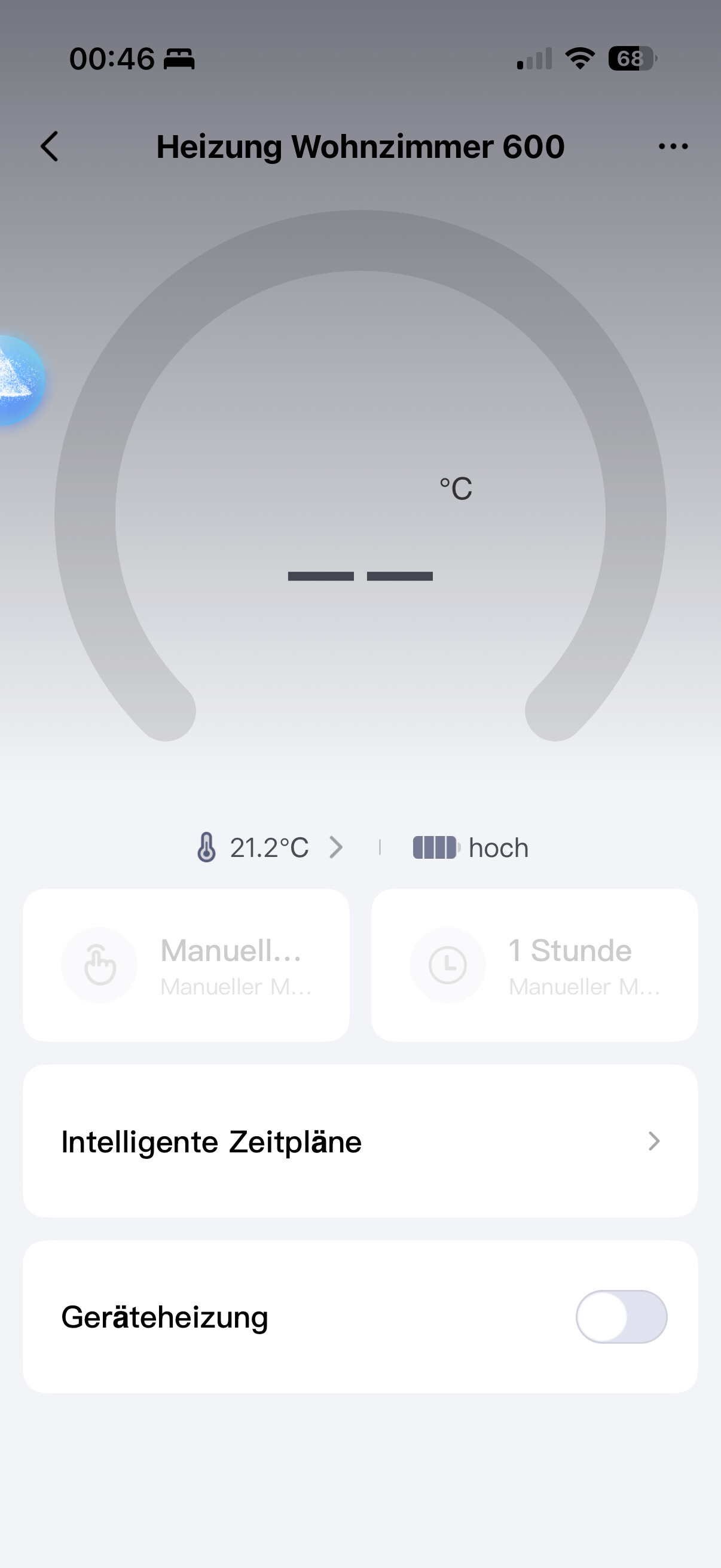

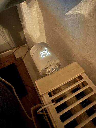

So I have an W600 where the temperature shown on the thermostat is different what is shown in the app.
When I set an temperature in the app it’s not reflected by the W600

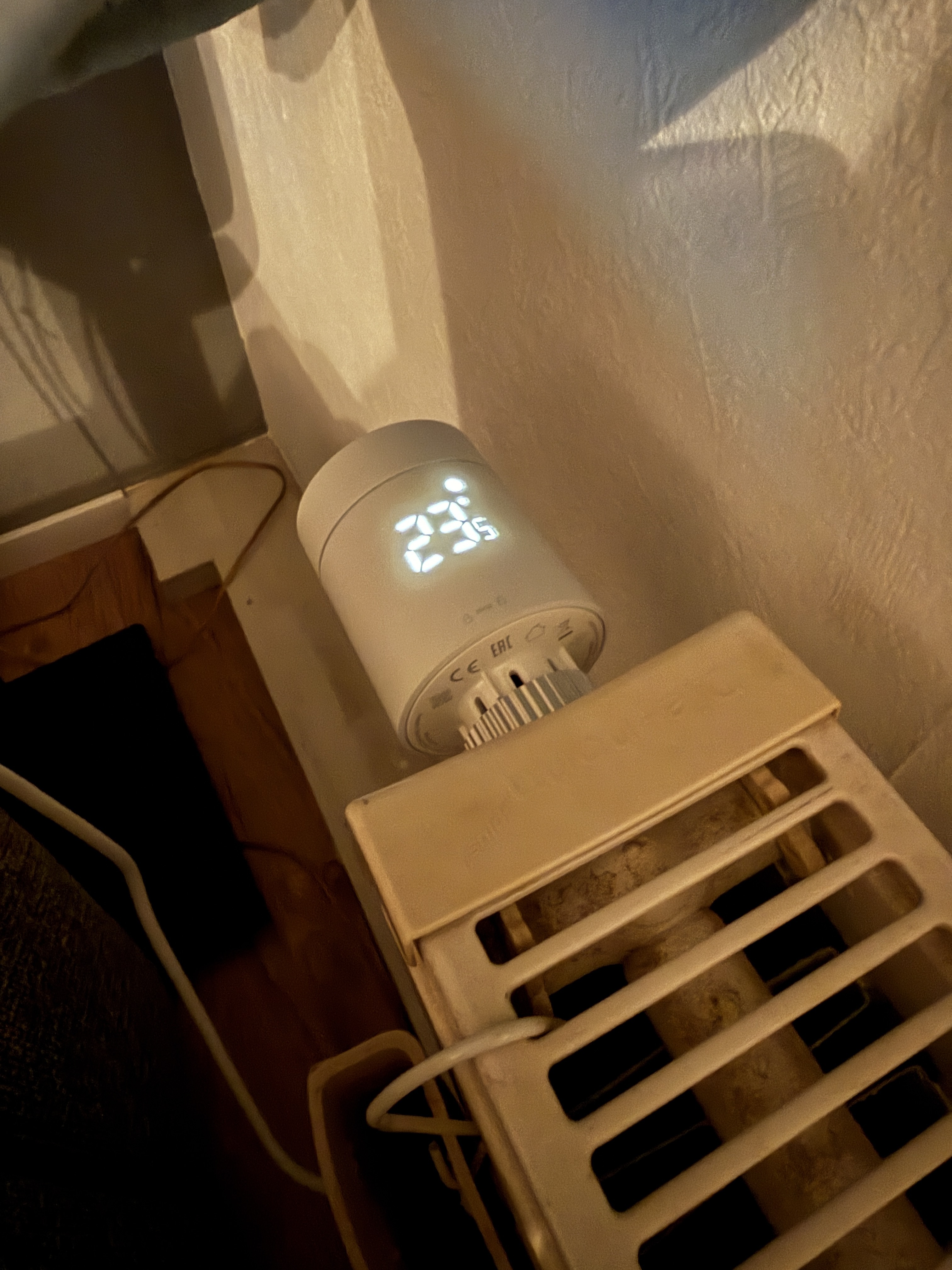

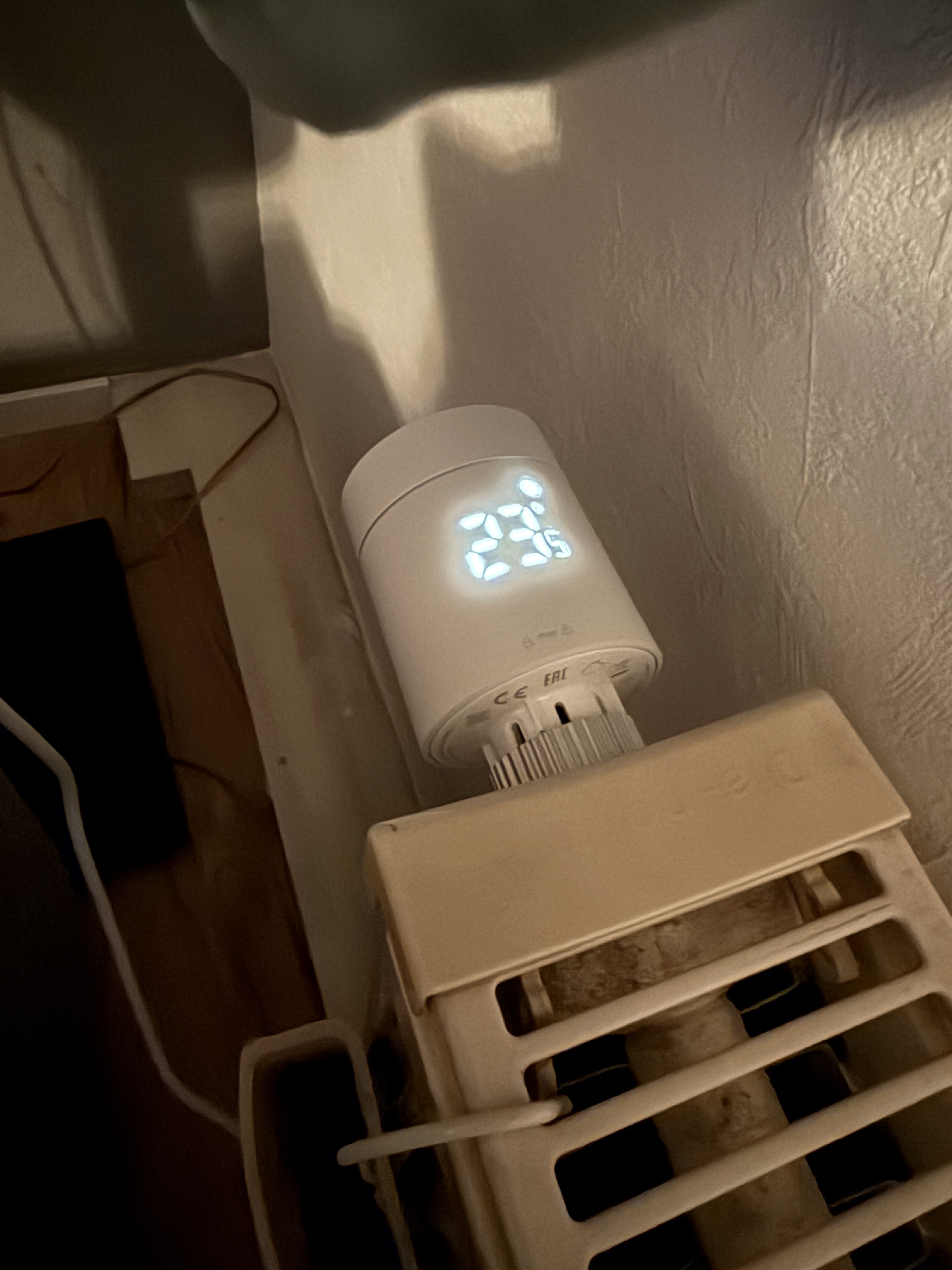

The temperature shown is kind of random? I had now 19 C and 23…
The temperature compensation is set to 0. I have an Aqara temp sensor connected.
An intelligent timeplan which is set to 21. The temperature sensor shows 22.1 C
But if I change the temperature on the W600 it is reflected in the app?
Which is weird…
This comes to the next problem. Which Temp setting is now correct? The one in the App or the one displayed on the W600?
The W600 is now turned off
But on the Thermostat
Am I the only one who has this behavior?

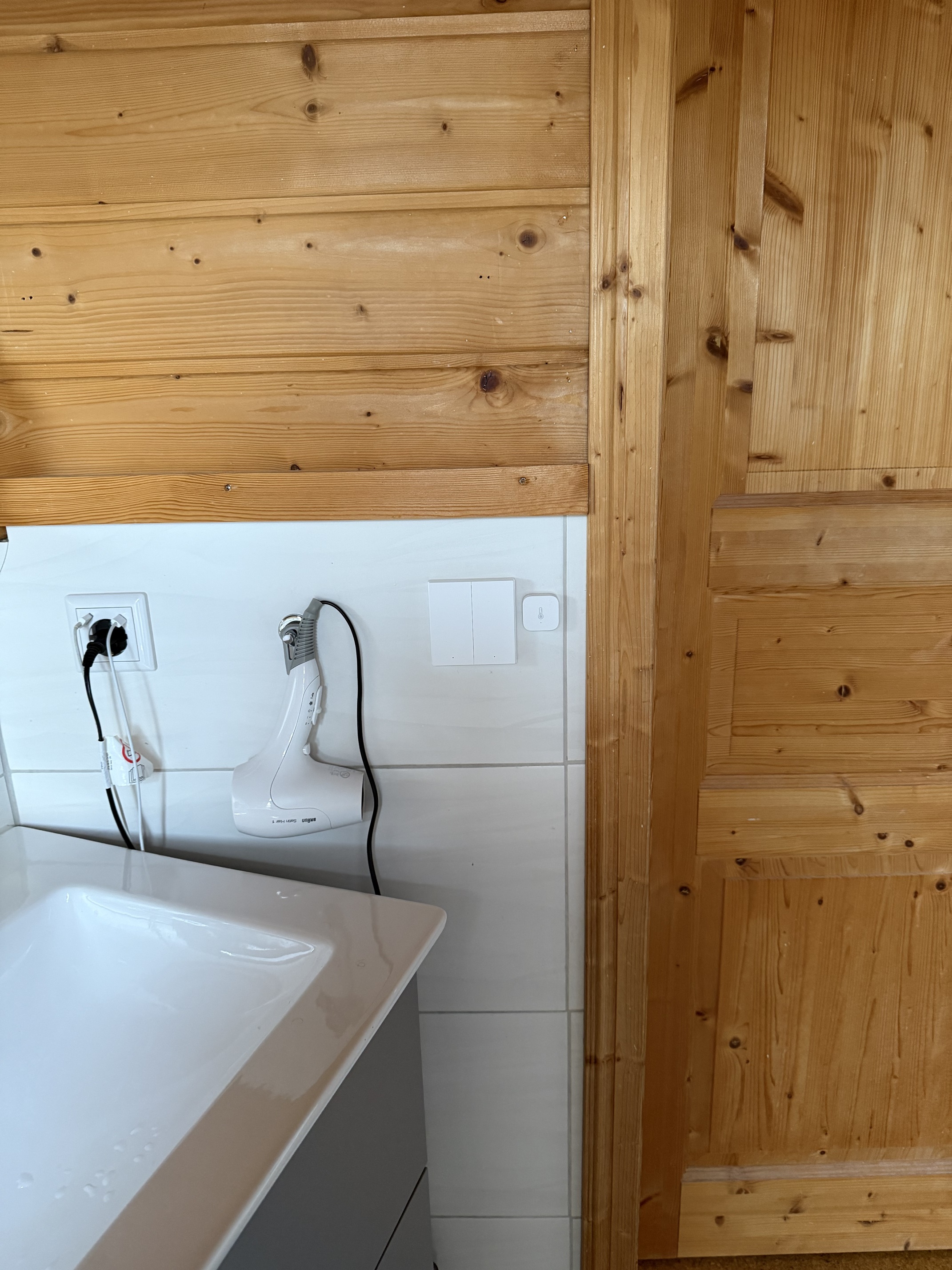

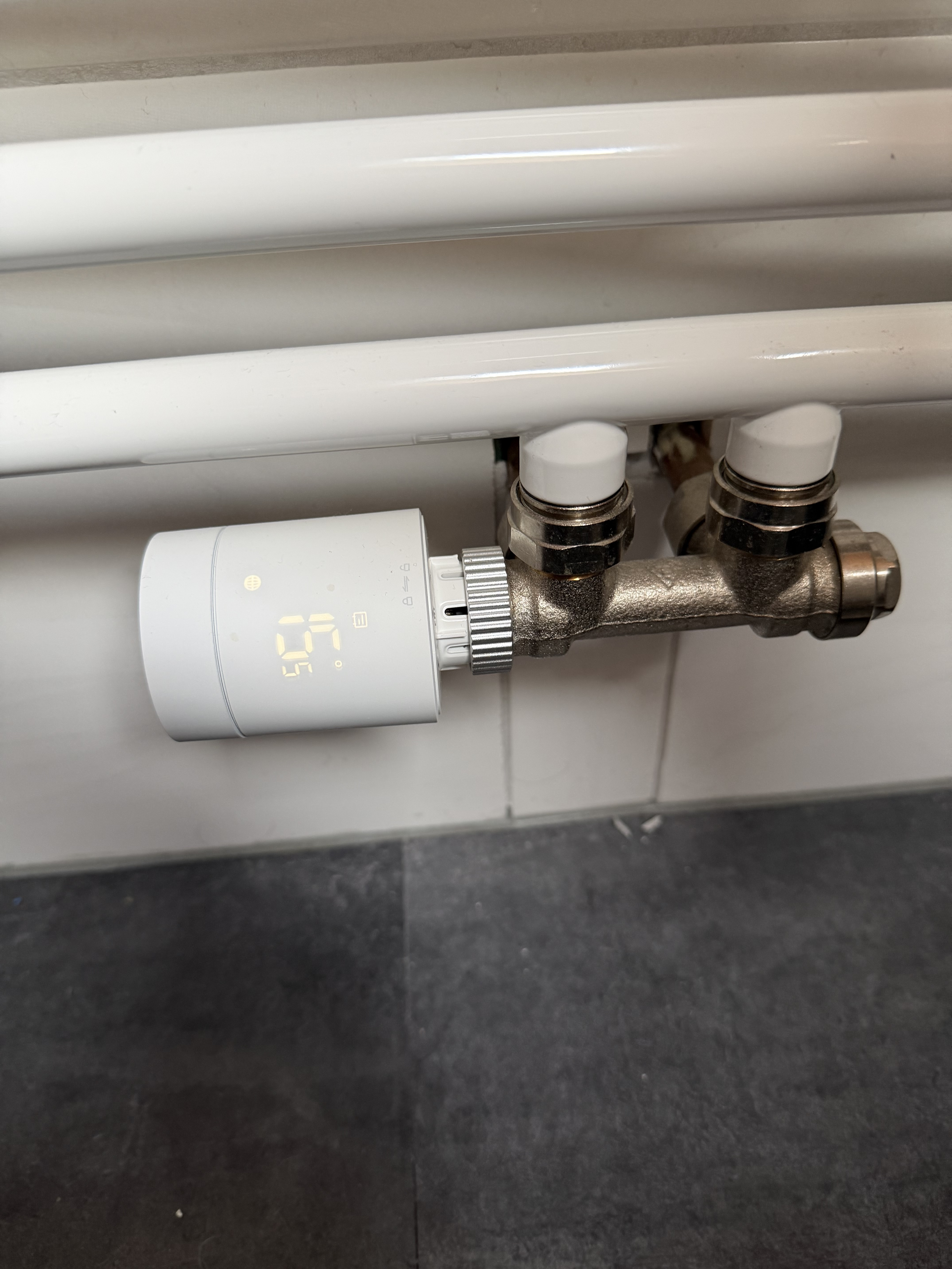

I am also having problems with the temperature reading directly on the W600. I have an external Aqara temp sensor connected and using its readings to control the temperature. The W600 is constantly showing 15.5 (never changes) while the thermometer on the wall is reading 21,8???
The W600 is controlling the heating with the external thermostat, but that the W600 temperature reading on the device is not working is not acceptable ( a minimal discrepancy due to the difference in high of the W600 and the external thermostat is expected and can be adjusted in the App).

I noticed the incorrect temperature readings. (It wasn’t 24.5°C in the room, nor was that value being measured by the external sensor). The radiators simply weren’t being regulated. The timer function wasn’t working.
After switching to Zigbee AND switching to internal temperature measurement, the thermostats are now working. The temperature display is also correct now. Program control via the app works. The window contacts correctly switch the thermostats on and off. Everything is displayed correctly in Home Assistant.
