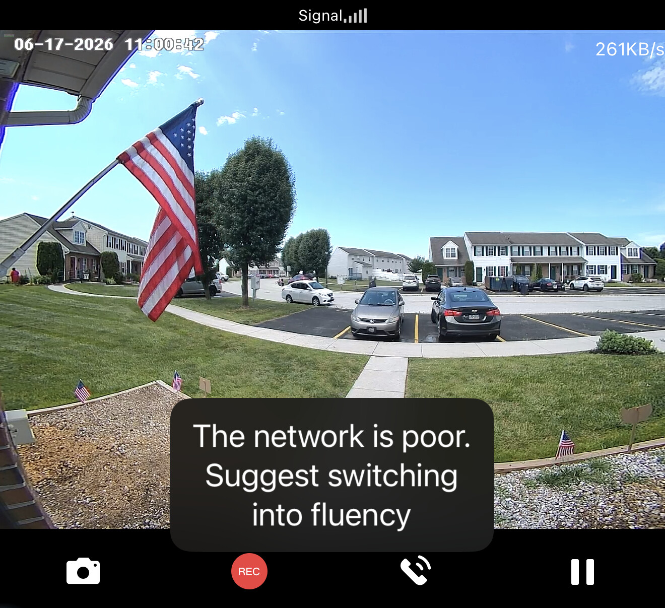

This is what I get, quite often, on my Doorbell Camera Hub G410, although as you can see, the signal is very strong, and other items much further away report no issues.
And what the heck is ‘fluency’ and how or why should I have to be switching to it?
At times it takes forever saying “Ready to Connect”, and “Loading video feed.”
Often I have to switch to another camera feed (I have G100’s too which never have these issues) and back before it will load.
The hub/speaker is within 3 feet, and both devices are within 15 feet of the Wifi router.
Does anyone know what might be causing this?

It means Low Resolution. It asking you to switch to a lower resolution to help improve the video quality. I have no idea why Aqara doesn’t just say that in the message.
“The network connection is poor, switch to a lower resolution”
I’ll have to look, but it’s only that one device that keeps having this problem. Either that it’s or it’s the only one that’s reporting a problem. I have 2G 100 and I have some WYZE cameras. I have a Tapo camera and none of them seem to have any problems. I also have a solar camera that’s way out in the backyard on a fence. That’s a camera in a birdfeeder. Never have these issues! The one that’s 15 feet away from my main Wi-Fi and only about 4 feet maybe from the Hub/speaker part of the combo and yet I keep getting this error. :man_shrugging:t2:
Yes, I assume that’s what it meant, but I was looking for the exact word fluency somewhere in the settings.
But still, I have no idea why this is the only camera that is constantly giving me that error and constantly taking forever to connect. It makes no sense as of said it’s about 15 feet from the Wi-Fi and about 4 feet from the Hub part of the Doorbell combination you know the thing with the speaker in it. Yet I’m constantly having this problem only with that one camera. Wish I knew what to check.
In the middle of the screen at the top of the live video you should see the screen resolution like 1520p etc tap that and you can switch it other resolutions including Low Resolution
Thank you for the reply, I would rather figure out why it’s having a hard time running with everything being so perfect. Going to a lower resolution is a Band-Aid, but figuring out why it’s not running at full resolution is my real goal.
Thank you again.!
