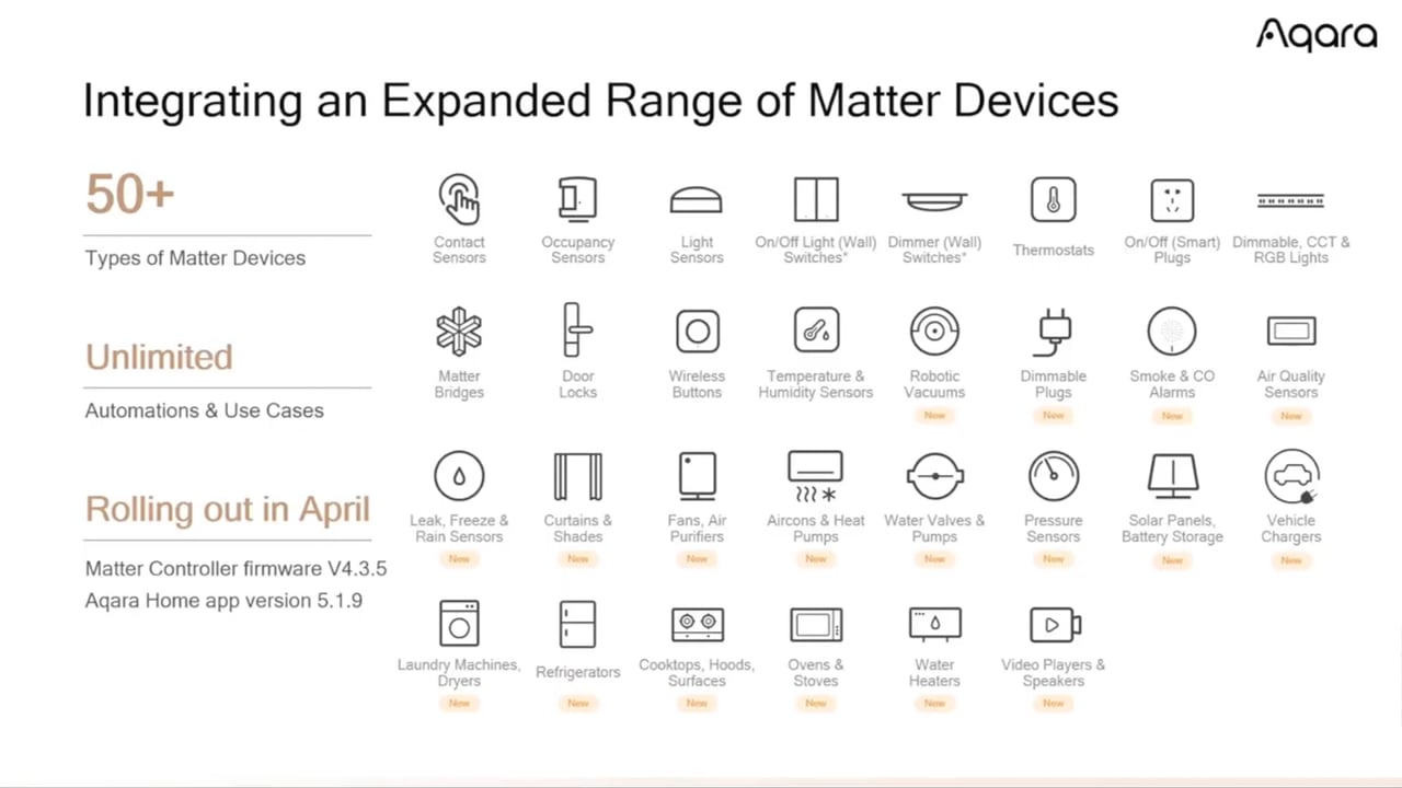

Hello @Quasi-Pseudonym
You can connect Matter over Thread and Matter over WiFi devices in Aqara Home using the Aqara M3 hub. Here are the types of Matter devices that Aqara supports.

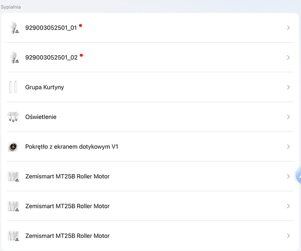

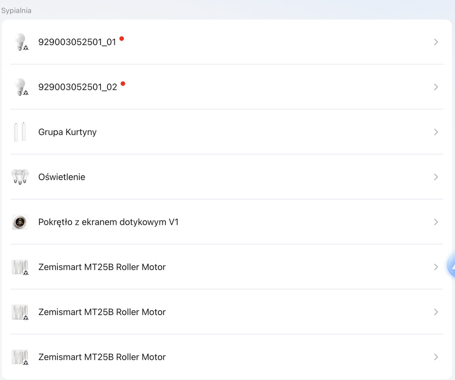

It should work:
This is really helpful. Thank you for the visual confirmation.
