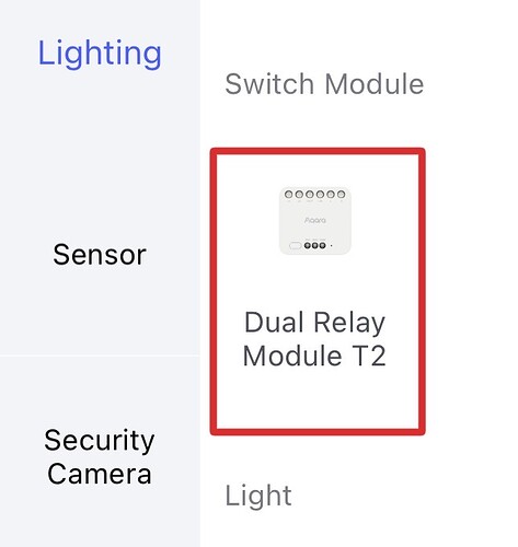

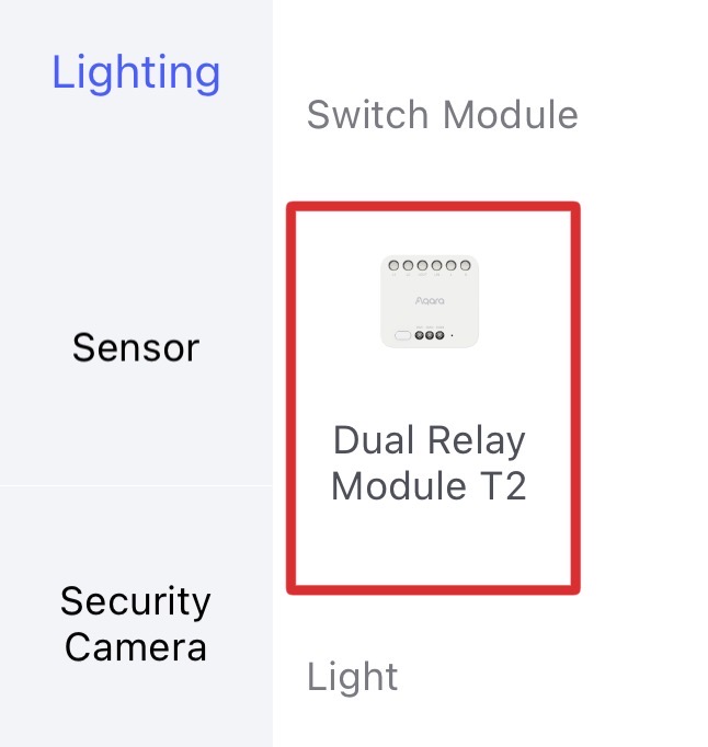

In your region, the T2 relay is available and it is a Zigbee repeater and the relay is also a proxy hub and this is the advantage of this device.
The screenshot shows the official distributors in your region
Thanks @Raman.V . Unfortunately, the T2 relay does not seem to be sold in Japan. @AqaraOfficial can you please confirm?
