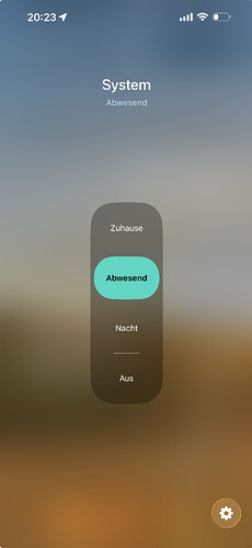

Has anyone found a way to integrate the Aqara alarm system, which is also displayed in HomeKit, into Home Assistant? I have already connected both hubs (Hub M3 & Doorbell Camera Hub G410) to HA via Matter. So far, all Zigbee devices and Matter-exposed states are shown to me there (exclude the camera stream, but it doesn’t matter).
This is the security system which I mean:

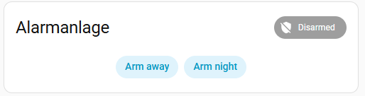

This is how it looks in my dashboard:
Appearance and details can be adjusted.

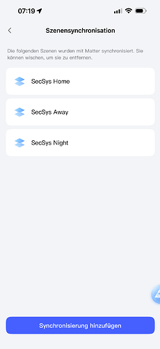

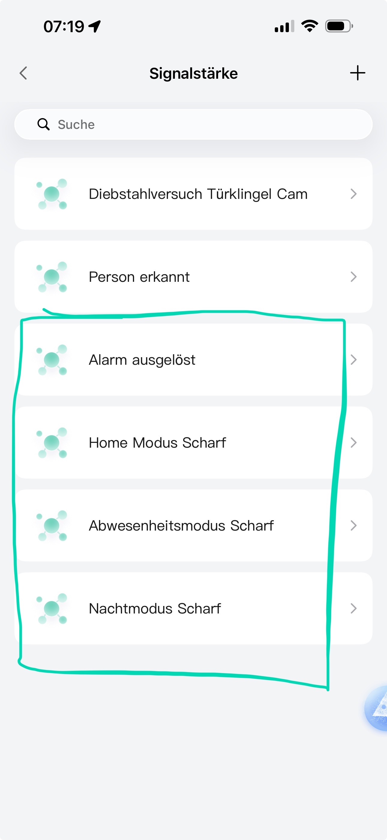

Okay, then of course there’s still the option of Advanced Matter Bridging.

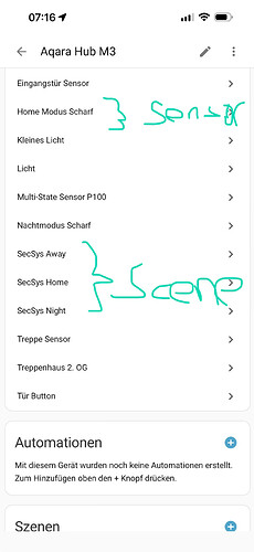

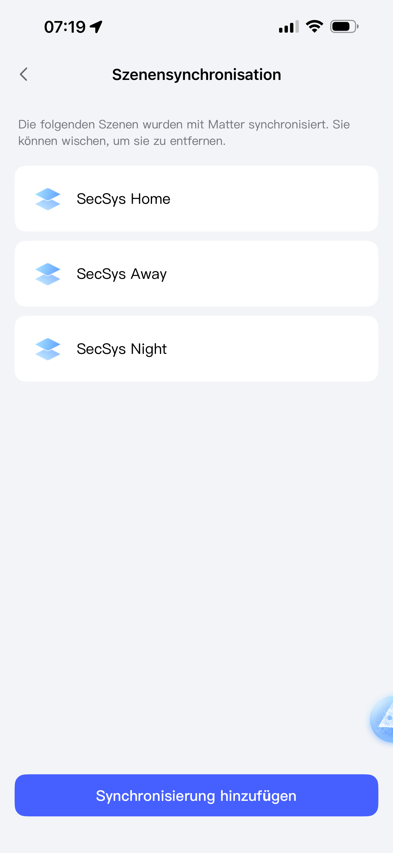

  1. In the Aqara app, create a scene for each alarm mode, e.g., activate night alarm and deactivate night alarm, etc.
  2. Then go to Profiles → Connect to Ecosystems → Matter → Scene and Signal Sync → Scene Sync → Create all the scenes as Matter signals.
  3. Since you already have the hubs in Home Assistant, the scenes should then be available there as switches.

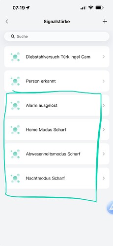

  4. To know the status of the alarm system in HA, you need to go to Aqara App → Profile → Connect to Ecosystems → Matter → Scene and Signal Sync → Signal Management → Plus button at the top right → then under IF → Add → Alarm System → select Mode (Home/Away/Night) → Arm → then follow the instructions until the signal has been created.
  5. The signals should then appear as Occupancy sensors and be displayed as occupied whenever the respective alarm is active and as unoccupied when disarmed.
You can then build something for your dashboard yourself using the switches and occupancy sensors in HA, and of course you can use it in automations.

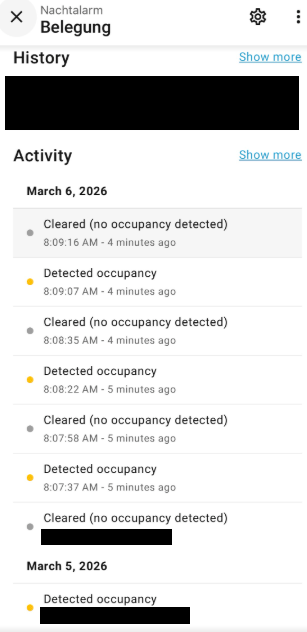

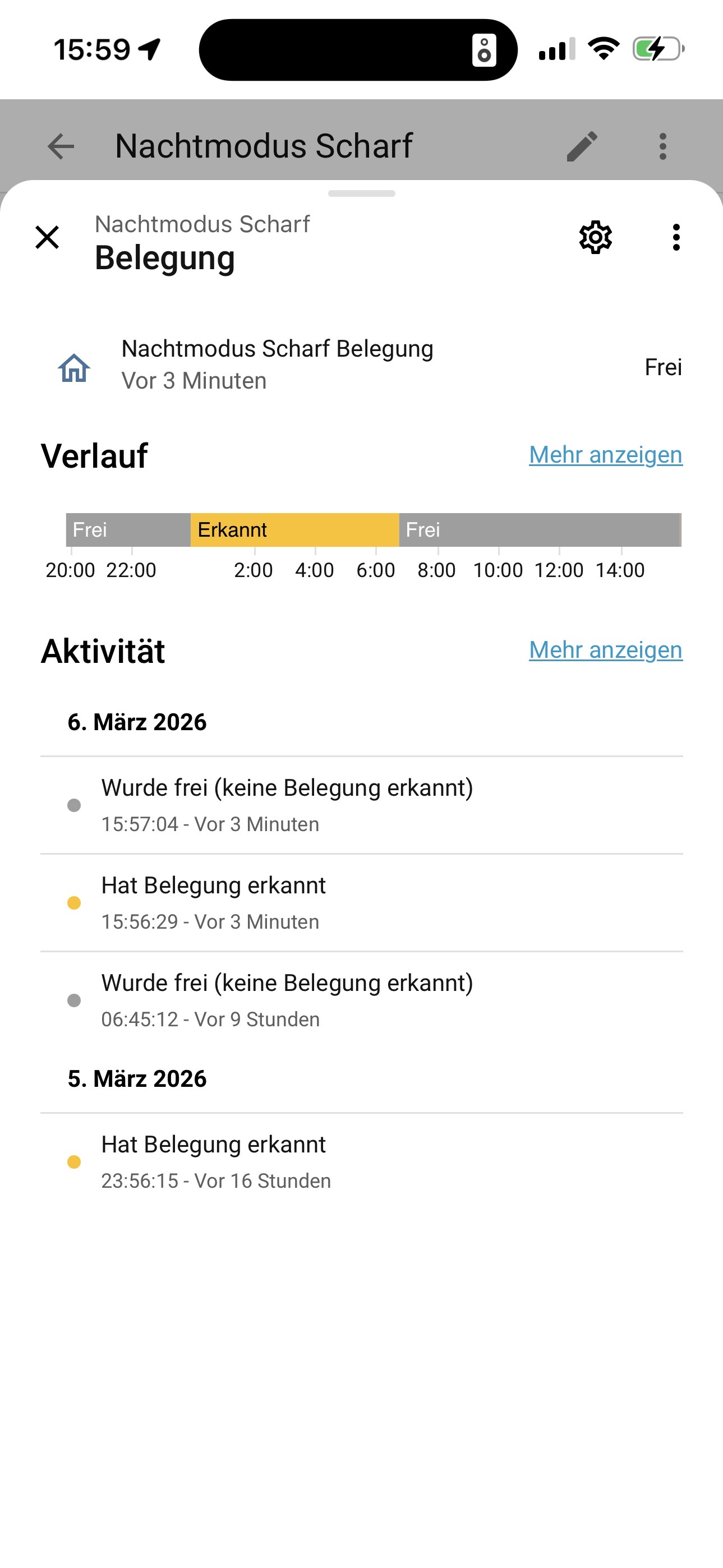

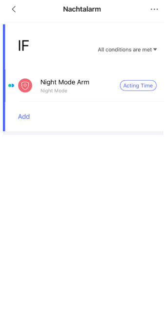

Zwischenstand: Es funktioniert bisher zuverlässig, egal ob der Nachtalarm über Siri, Szenen, HomeAssistant, Aqara App oder Zeitsteuerung aktiviert/deaktiviert wird.

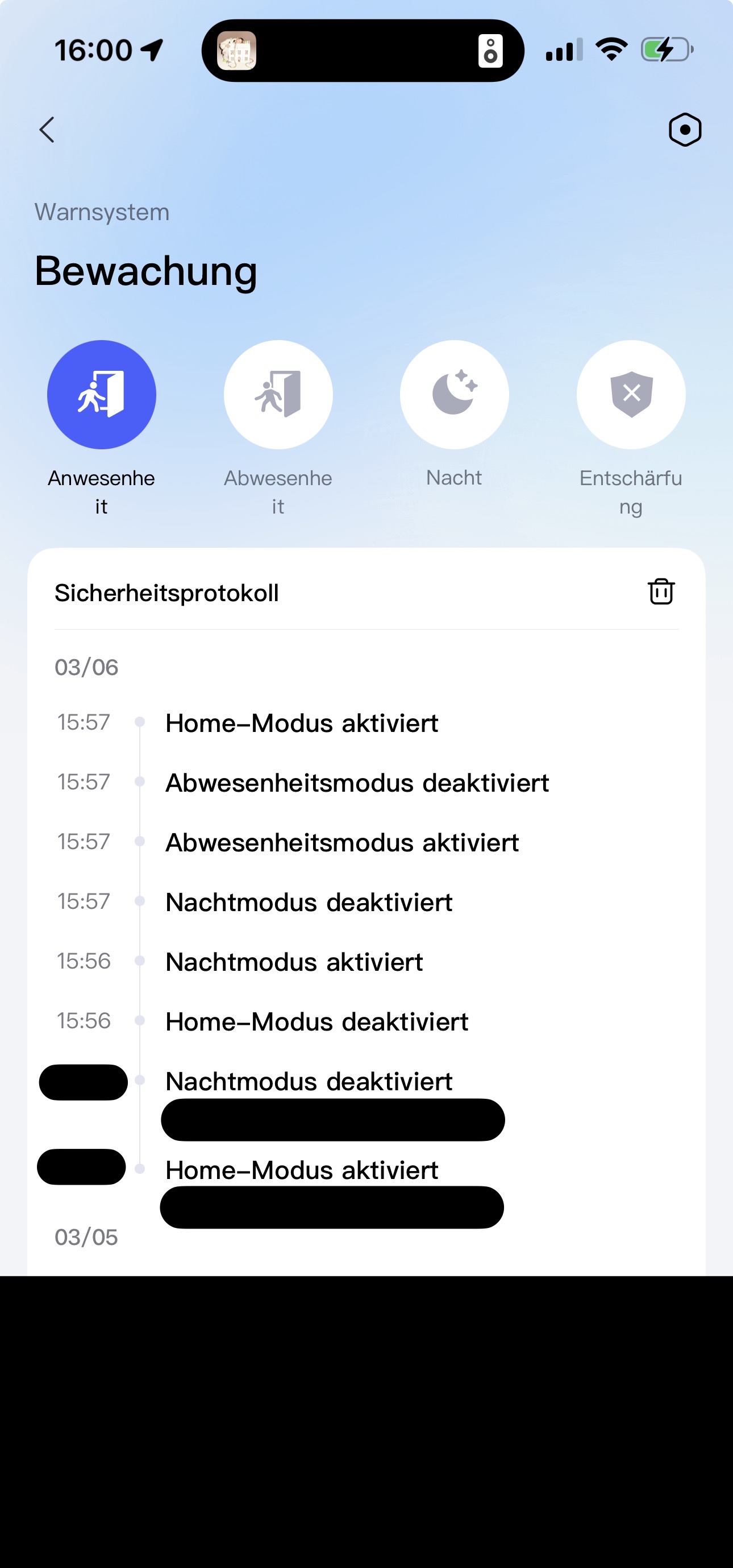

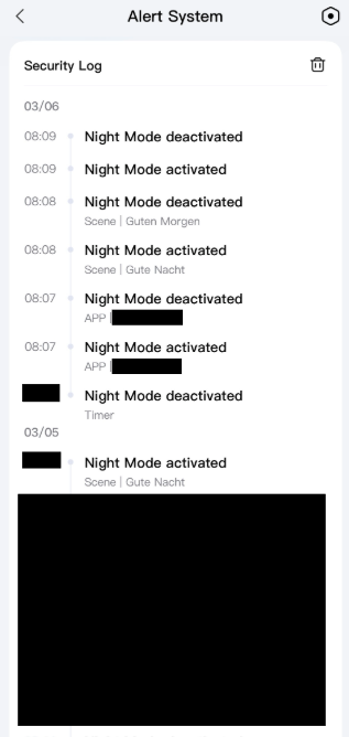

Zum Vergleich das Log aus der Aqara App (erstes Bild links oder oben, je nach Bildschimbreite) und die History aus Home Assistant (zweites Bild rechts oder unten):

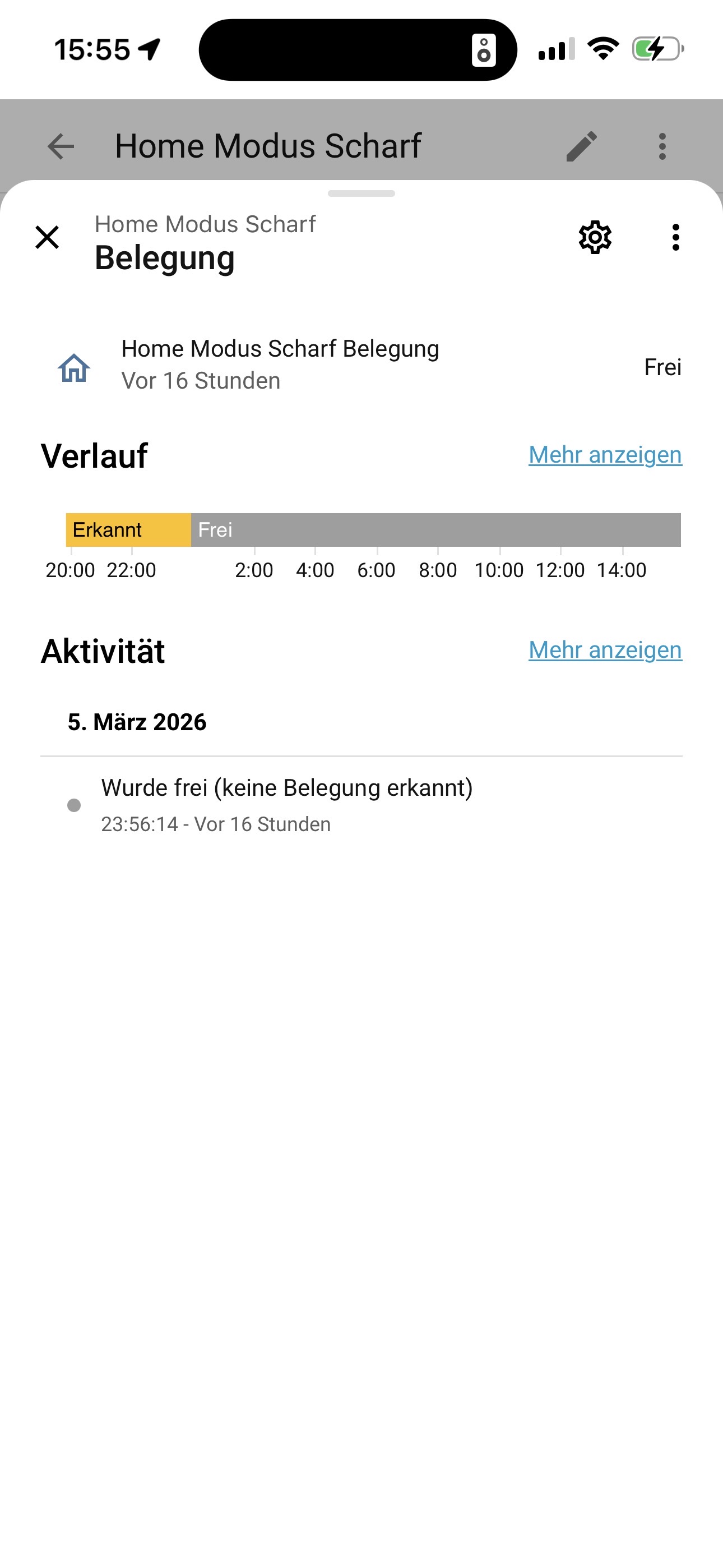

Mein Setup besteht aus einem G5 Pro Kamera Hub als Matter-Controller mit eingerichtetem Matter-Signal. Hier ist noch ein Screenshot vom Matter-Signal aus der Aqara-App (im Grunde ganz simpel):

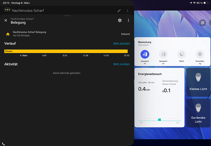

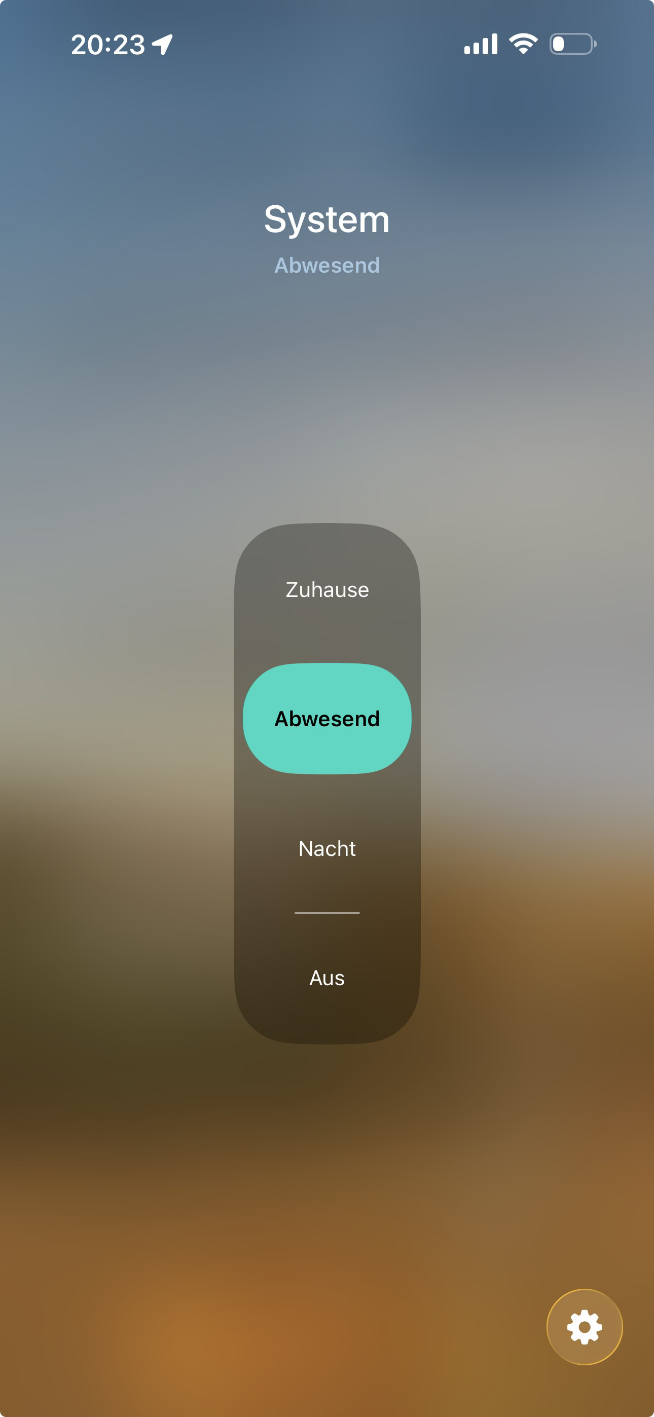

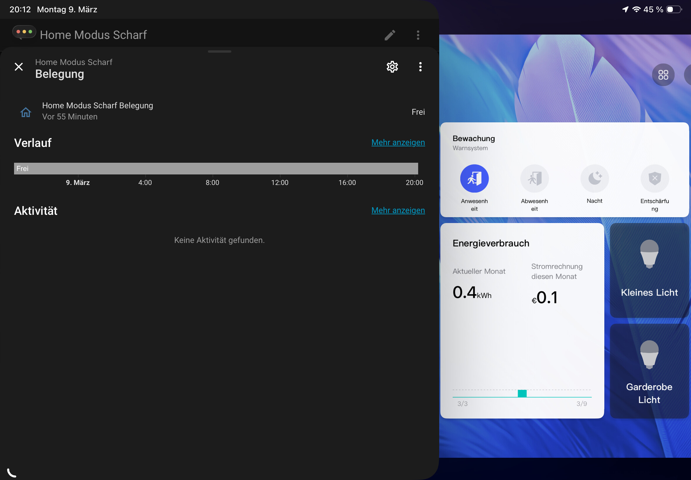

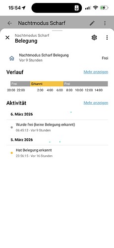

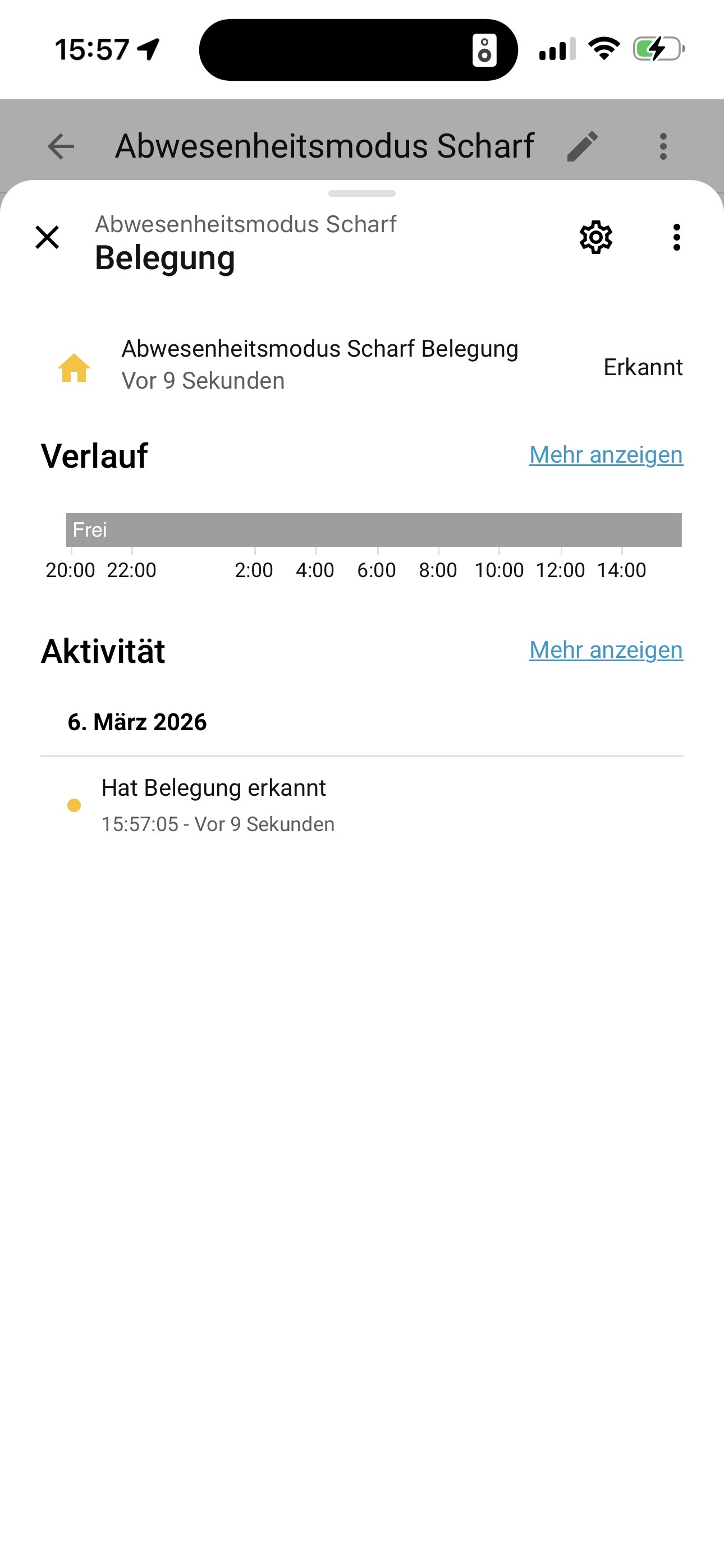

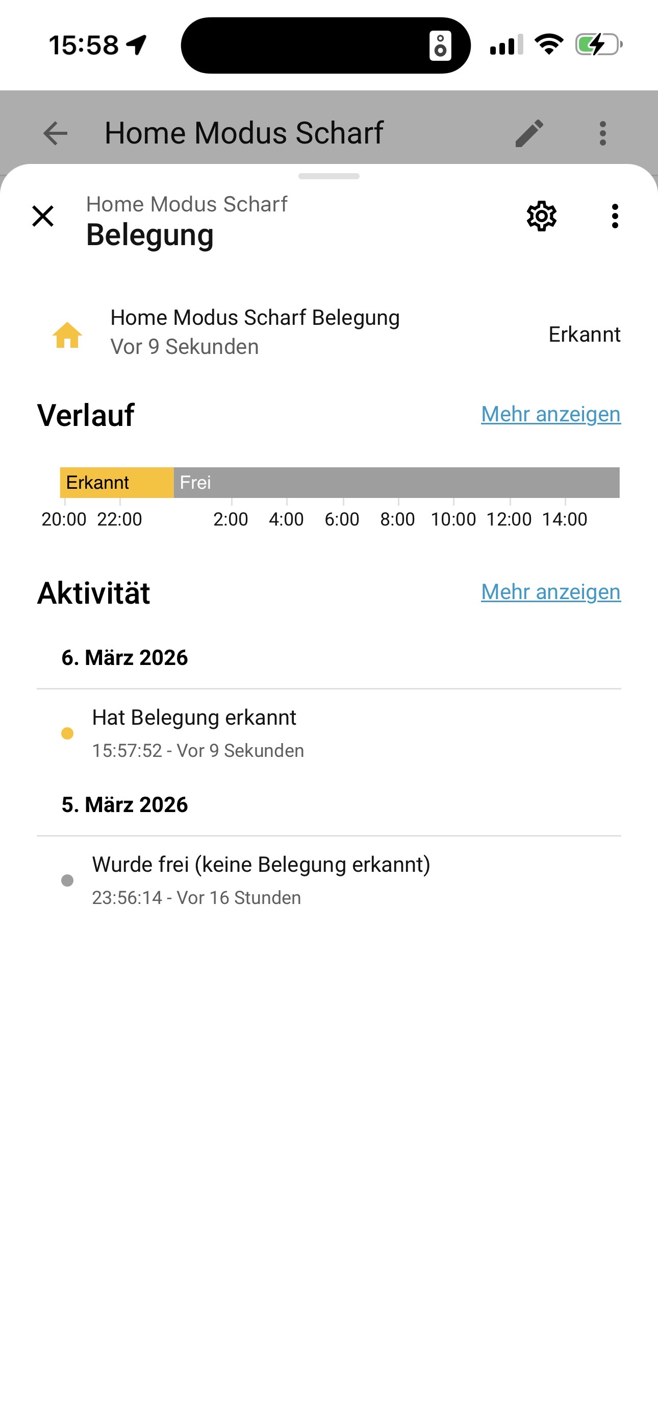

@JohnD Danke dir. Ich hab jetzt auch nochmal nachgeschaut bei mir. Wenn ich den Alarm Mode ändere (hab jetzt nur in der Home App getestet aber die Automationen über Buttons laufen auch über HomeKit (größtenteils) deswegen passt das. Bei mir werden die „Belegungen“ in Home Assistant auch als „Belegt“ angezeigt nach dem Wechsel.
Was man jetzt aber auch sieht, das der Home Modus Belegung in Home Assistant irgendwann kein Bock mehr hat und aus geht bzw als „Frei“ anzeigt.

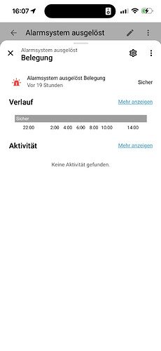

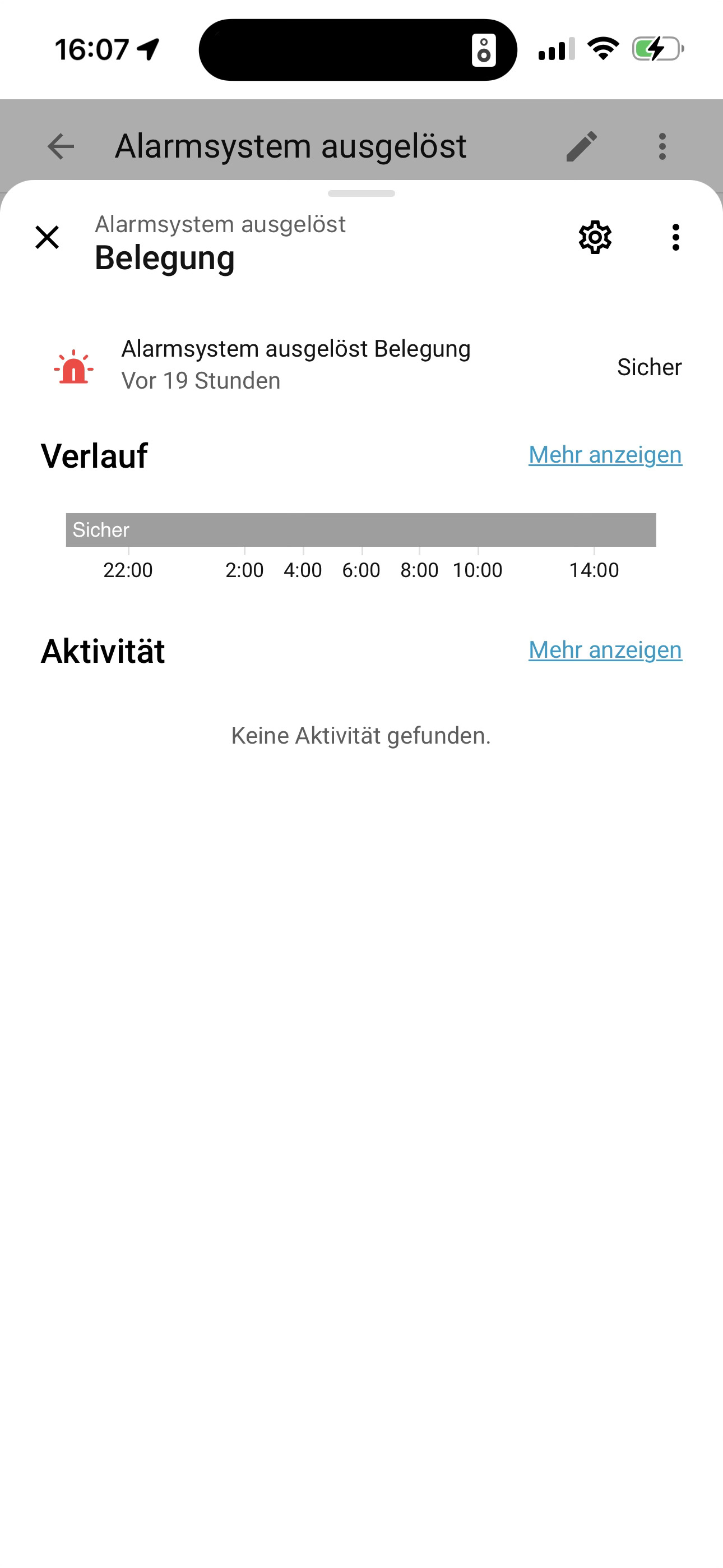

Den Alarm ausgelöst konnte ich nicht testen, weil sonst alle alarmiert werden. Das mache ich wann anders.

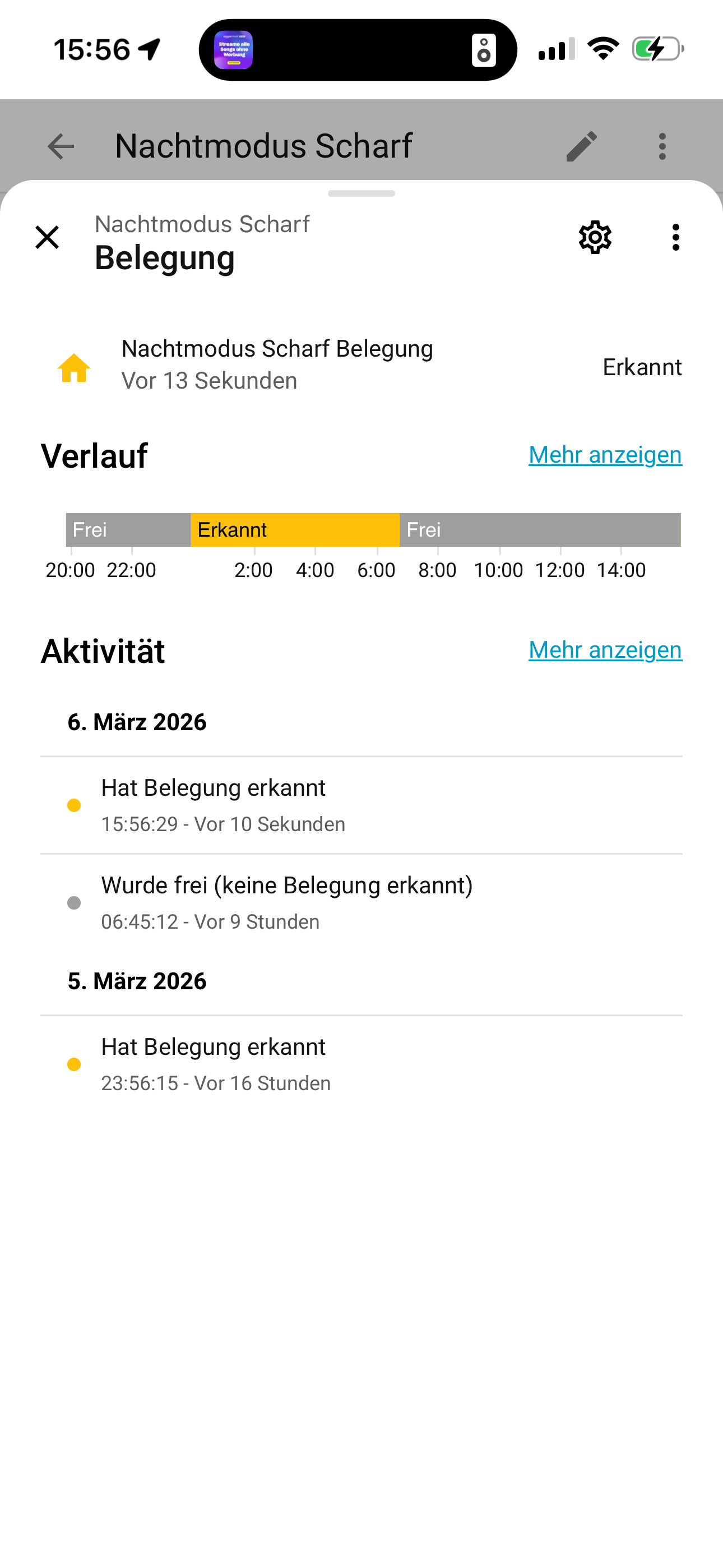

@JohnD Ich hab jetzt mal ein paar Tage vergehen lassen und dann vorhin gerade nochmal in Home Assistant reingeschaut und hab gesehen das es A) ein Update für den Matter Server gibt und
B) die Sensoren über den Home-/Away-/Night-Mode zum Teil einfach falsch sind.
Vorhin war der Anwesenheitsmodus in Aqara Home und Apple Home aktiviert. Aus irgendeinem Grund meint Home Assistant aber, dass der Nachtmodus aktiv sei. Dachte erst das ich die Matter Sensoren oder wie die bei Aqara heißen falsch eingestellt hab und nochmal gecheckt, hat aber alles gepasst. Jetzt weiß ich auch nicht mehr…
