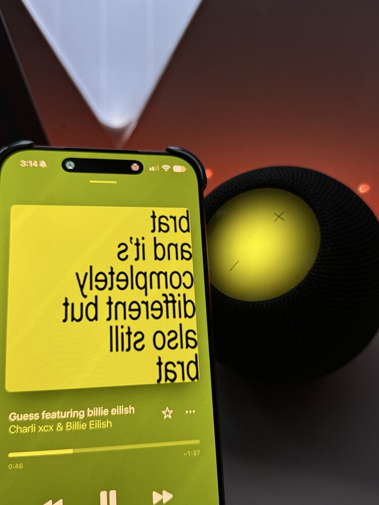

I updated my devices to anyAppleOS 27.2 (Beta) a few weeks ago and my home hubs last week. It wasn’t a problem at all. I wanted to test the new Sound Glow feature on my HomePod mini. My Apple Home didn’t get damaged at all.
