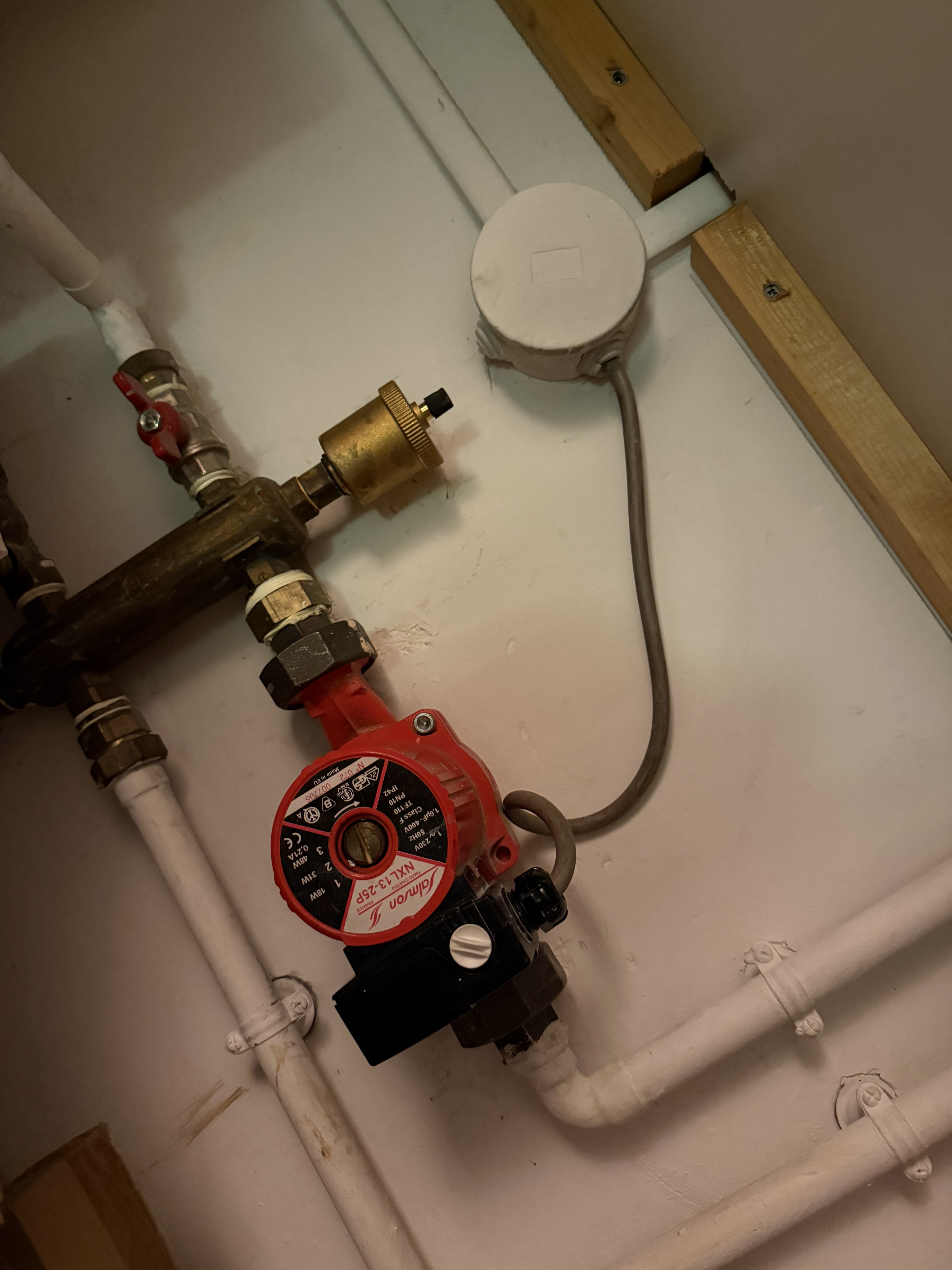

Hi, it is an old heating system. Heating pump pumps hot water through pipes to the radiators and when the temperature of the room is achieved it stop the pump. It’s an 220V Europe (France) installation. I was trying Google Nest learning thermostat but it’s not working.

Unfortunately it does not work. I only have two wire, one is live and one is not. When you connect them together they close the circuit and then heating starts.

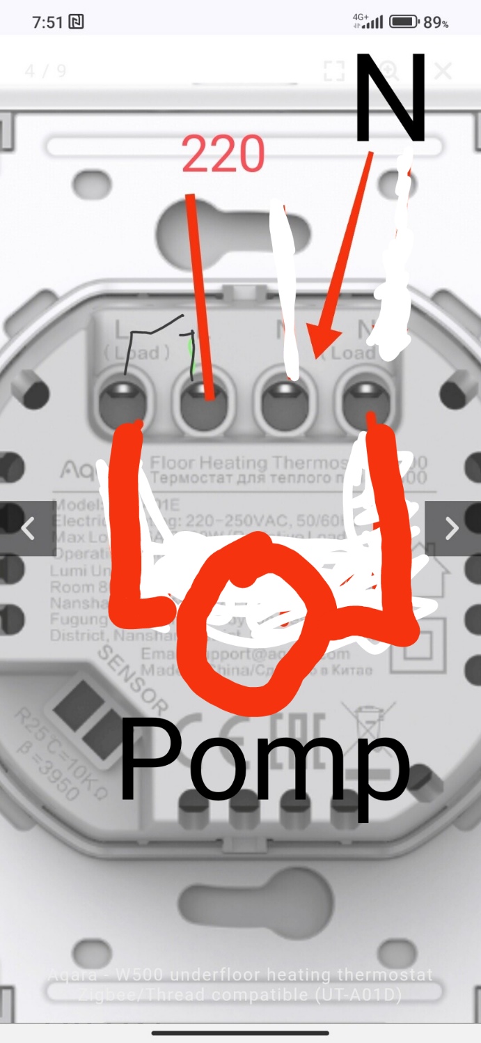

Hello, what are the problems, you connect the W500 contacts to the pump and control the pump using temperature control.
Now I’m searching the forum, I gave the connection diagram to someone.
The second way is to add an intermediate relay for 220 volts to the W500 and use the dry contacts of the relay for the contact you need. The relay connection diagram will be similar to the one above, only instead of the pump, a relay for 220 volts.
