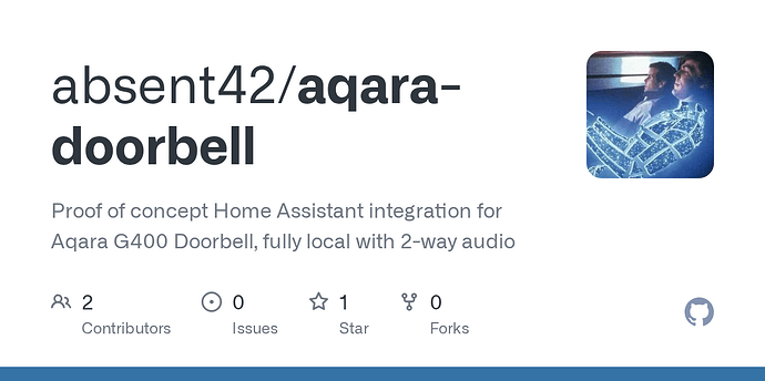

Full details, install instructions, dashboard cards, and example automations are in the Github repository:

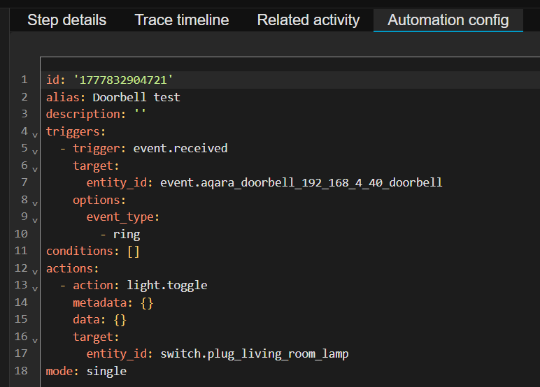

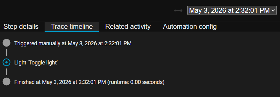

Hi, I used the sample automation you supplied and can successfully trigger it manually.
See below for YAML and Traces timeline. It doesn’t fire, though, when I ring the actual doorbell.

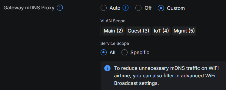

Yes it is on the same subnet (which I use for IoT devices). When I added your integration it was automatically discovered. Also, I get full camera notifications directly in Home Assistant from the G400 doorbell (via Frigate). i.e. person or car detected.
I run a Unifi home network and allow mDNS across VLANs, although this traffic should stay within the IoT network.

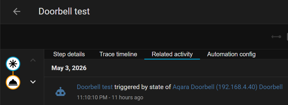

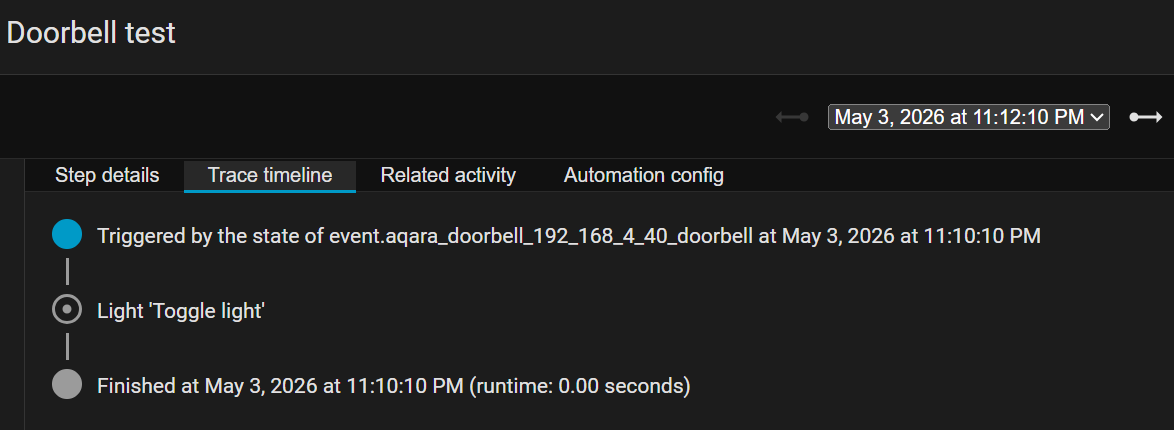

FYI, about 11pm last night the Doorbell Test automation that you provided triggered itself five times without anyone pressing the doorbell. Here’s the trace from the first event. BTW, I’m still running version 0.1.1

That’ll be the multicast detection not working properly with your network setup. The integration currently doesn’t filter multicast propely, that’s not implemented. It’s only supposed to be a proof-of-concept for the 2-way audio, not a fully working doorbell integration, and I currently don’t plan on developing it into one. I suggest you use the official Homekit implemention for a properly working doorbell.
