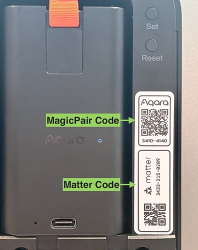

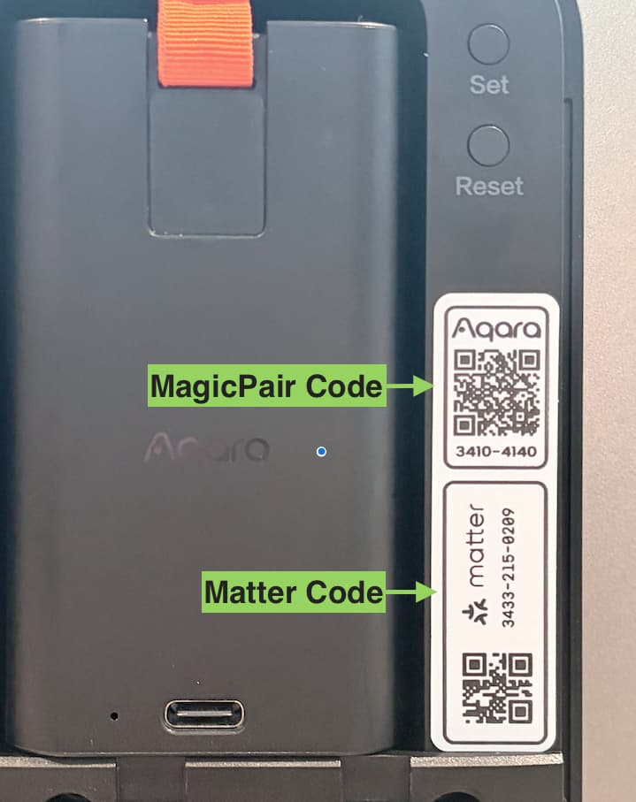

Before You Begin: Two Codes, Two Purposes
The U400 has two different codes printed on it. Scanning the wrong one is the most common cause of pairing failure:
Aqara MagicPair Code: Bind the lock to the Aqara Home app (via Bluetooth)
Matter QR Code: Bind the lock to Apple Home or other Matter ecosystems
Important notes:
  • Do not scan the Matter QR code when using Aqara Home — the app may read the wrong code, causing the binding to fail or behave abnormally. Pro tip: cover the Matter code with your finger while scanning, so the app reads the correct code.
  • The Matter QR code on the lock becomes invalid once the lock is paired with any Matter ecosystem. To add the lock to another Matter platform later, generate a new pairing code from the app it’s already paired to (e.g., in Apple Home: lock settings → “Turn On Pairing Mode”).
  • If something goes wrong while pairing with your first Matter ecosystem, first reset the lock, then delete the U400 device card from that Matter ecosystem, and go to your iPhone’s Settings, find the U400 lock that failed to pair, and completely remove its leftover data.

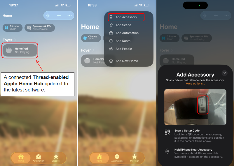

  1. Apple Home Hub (required)
You need a Thread-enabled Apple Home Hub, updated to the latest software, and already set up and visible in the Home app:
  • Apple HomePod (2nd generation)
  • Apple HomePod mini
  • Apple TV 4K (2nd generation)
  • Apple TV 4K (3rd generation, Wi-Fi + Ethernet)
Third-party Matter hubs do not meet this requirement. Without one of the hubs above in your Home, pairing may fail, or the Home Key may not generate properly and won’t sync to your Apple Watch.

If you already have a working Apple Home Hub set up in Apple Home, you can now pair the lock as follows:

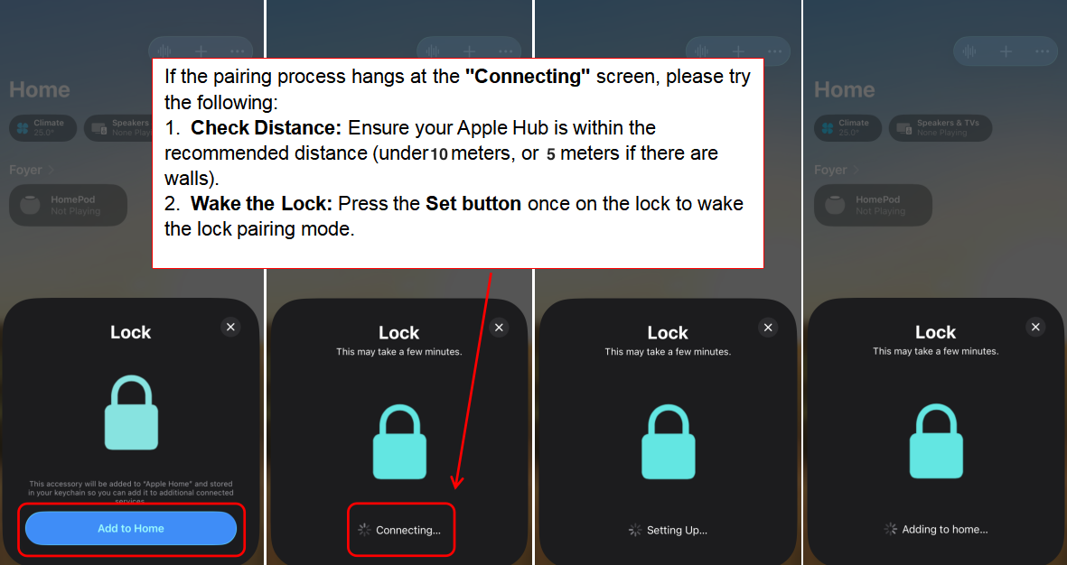

  • Reset the lock: press and hold the Reset button for 5 seconds.
  • Enter pairing mode: press the Set button once to wake the lock and enter pairing mode.

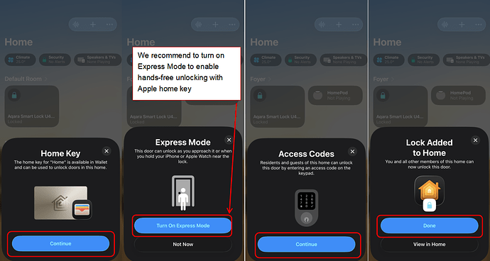

  • Add to Apple Home: open the Home app, tap “+” → Add Accessory, and scan the Matter pairing code on the lock.

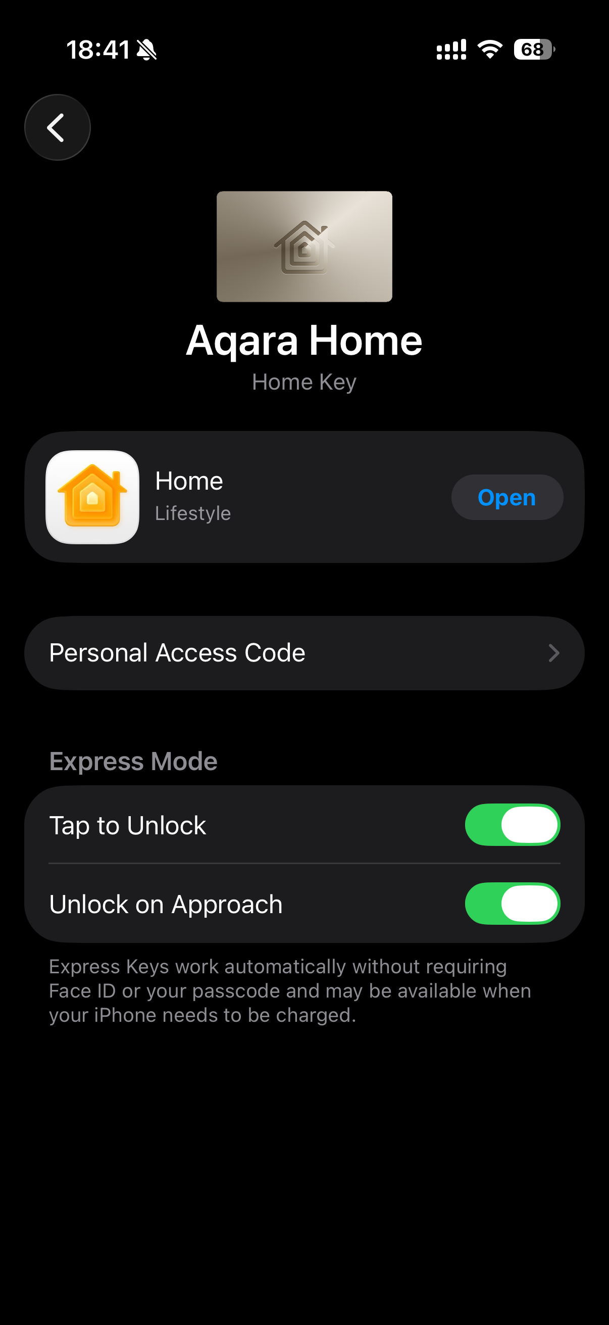

  • After pairing succeeds, a Home Key is automatically created in your Wallet, and Express Mode is turned on automatically.
What is Express Mode? With it on, tap your iPhone/Apple Watch on the keypad to unlock — no need to wake or unlock your device. With it off, you must unlock your device every time you use the Home Key.

  • Step 1 — Re-check the checklist. Go through items 1–4 above (hub model, iOS/watchOS version, IPv6, same Wi-Fi, Bluetooth on, distance). Most pairing failures trace back to one of these.
  • Step 2 — Simply retry. Repeat the binding steps once more. Small signal interruptions can sometimes cause a timeout.

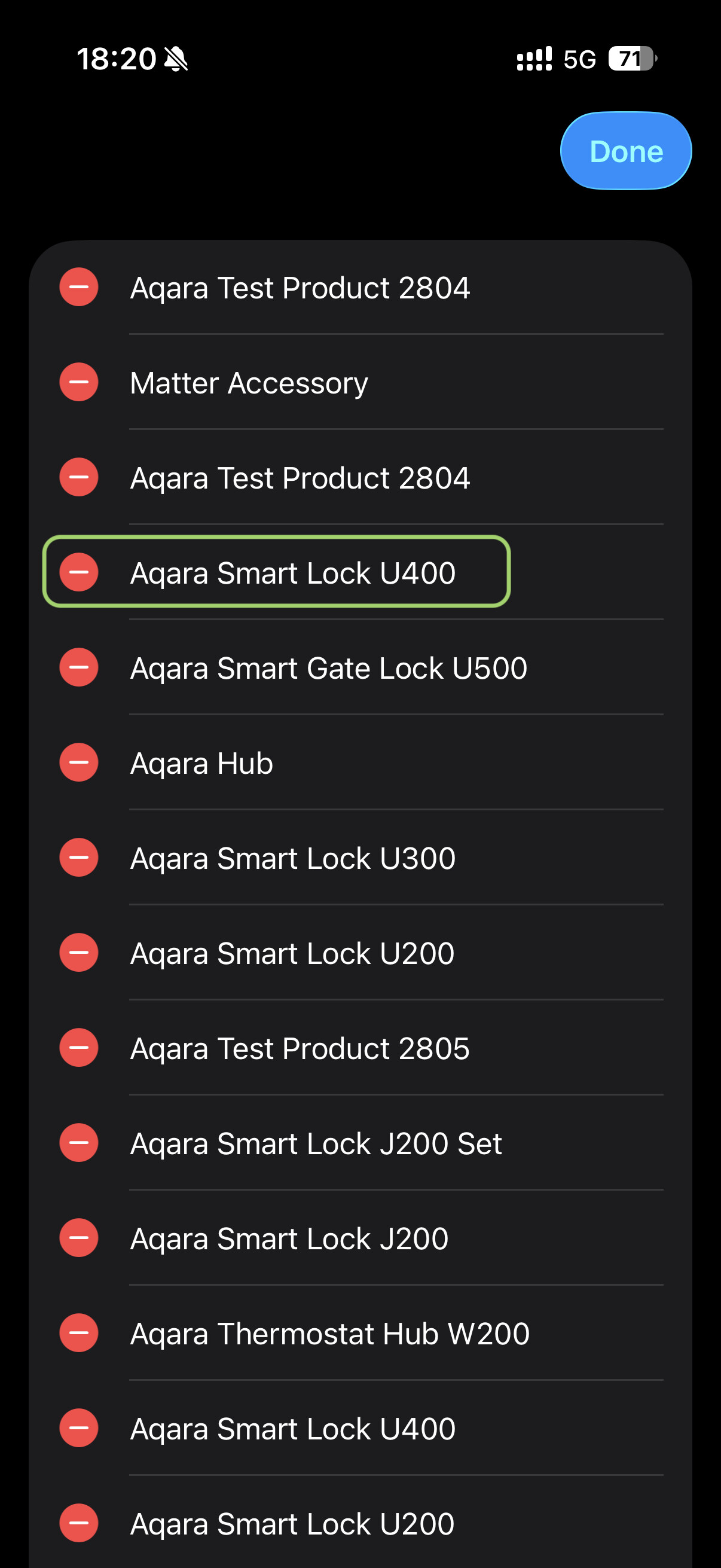

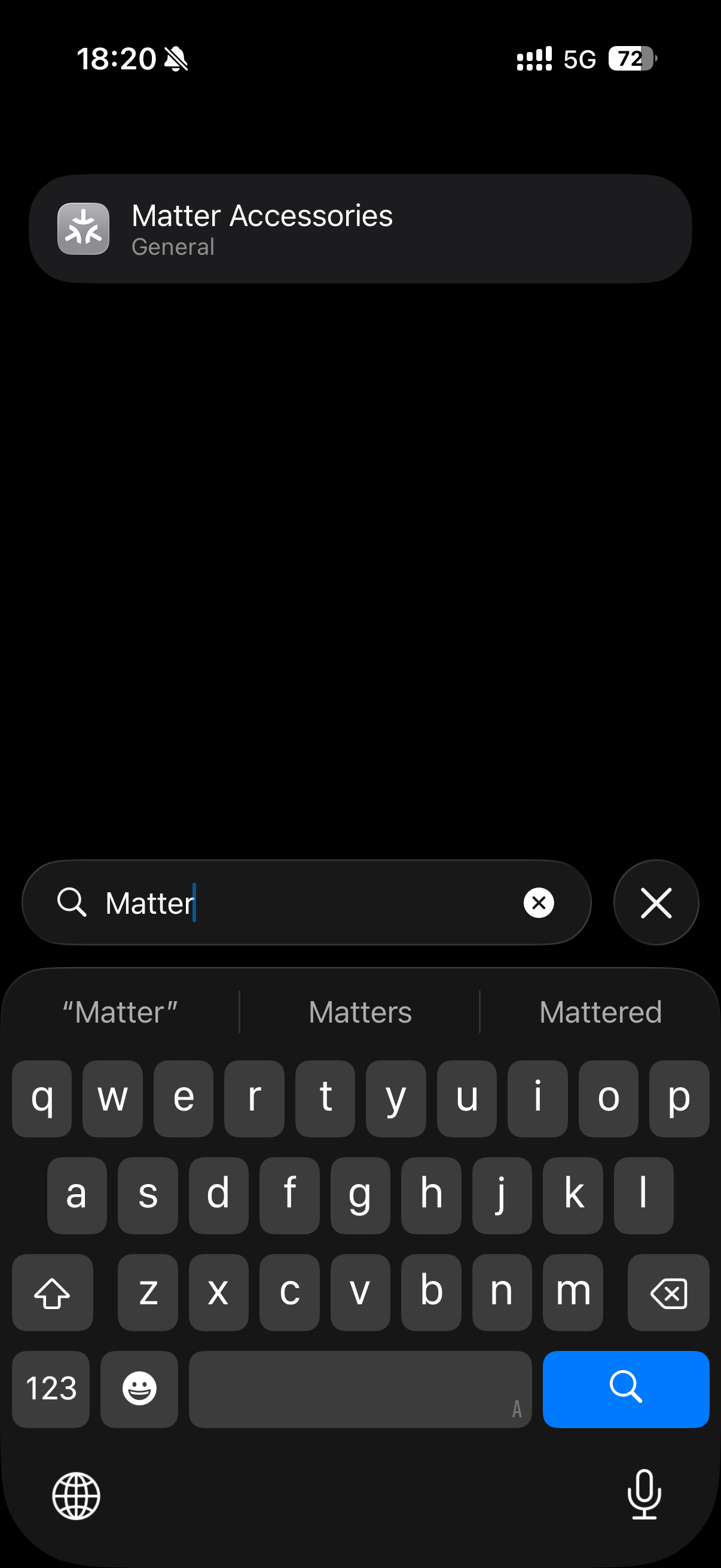

  • Step 3 — Delete the U400 device card from the Matter ecosystem, then go to your iPhone’s Settings, find the U400 lock that failed to pair, and completely remove its leftover data.
  • Step 4 — Reset the lock and pair again. Press and hold the Reset button for 5 seconds, then pair from a clean state.

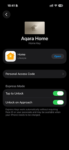

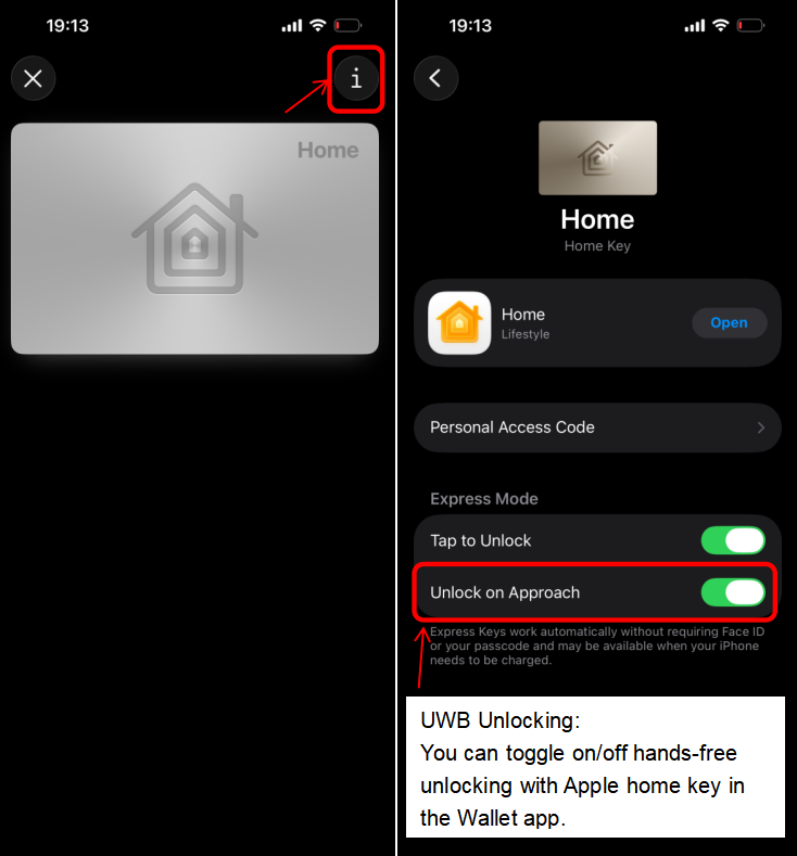

Home Key Tap to Unlock Works, but UWB (Hands-Free Unlock) Doesn’t?
Try the following:
  • Make sure your phone and Apple Home Hub are both updated to the latest software.

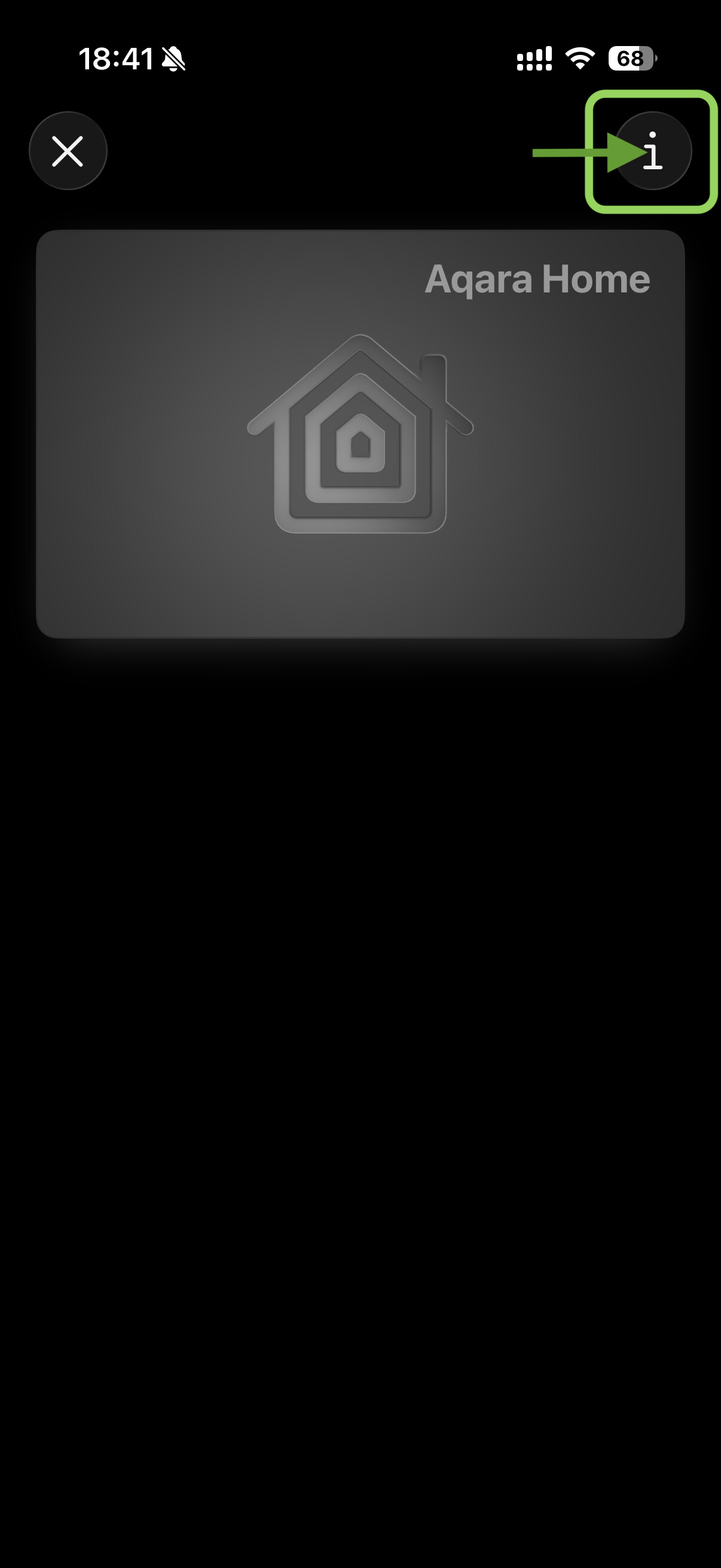

  • In the Wallet app, find the Home Key for this home, tap the “i” in the top-right corner to open the details page, and confirm that “Unlock on Approach” appears there and is turned on.
  • If you don’t see “Unlock on Approach” in Apple Wallet, restart your phone and Apple Home Hub to trigger a Wallet data refresh.
  • If it still doesn’t work: create a new Home, reset the lock, and pair it again into the new Home. Keep your Apple Watch unlocked during the pairing process.

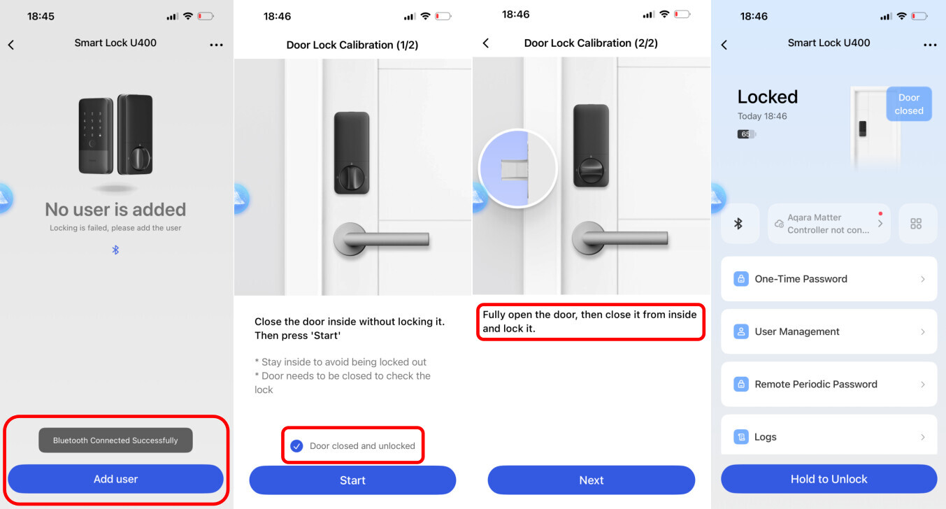

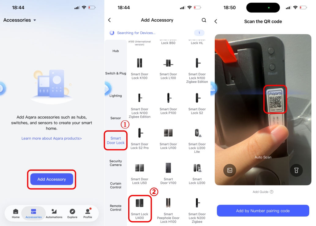

Step-by-Step Binding Procedure

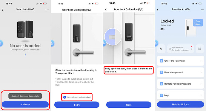

  • Press the Set button once on the lock to enter pairing mode.
  • Open the Aqara Home app, tap “Add Accessory”, and select Smart Lock U400.
  • Scan the Aqara MagicPair Code on the lock.
Pro tip: cover the Matter pairing code with your finger while scanning, so the app reads the correct code.

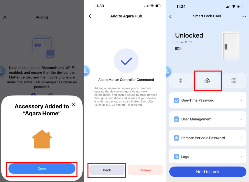

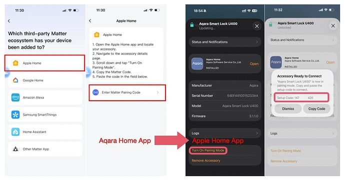

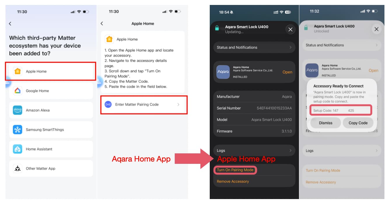

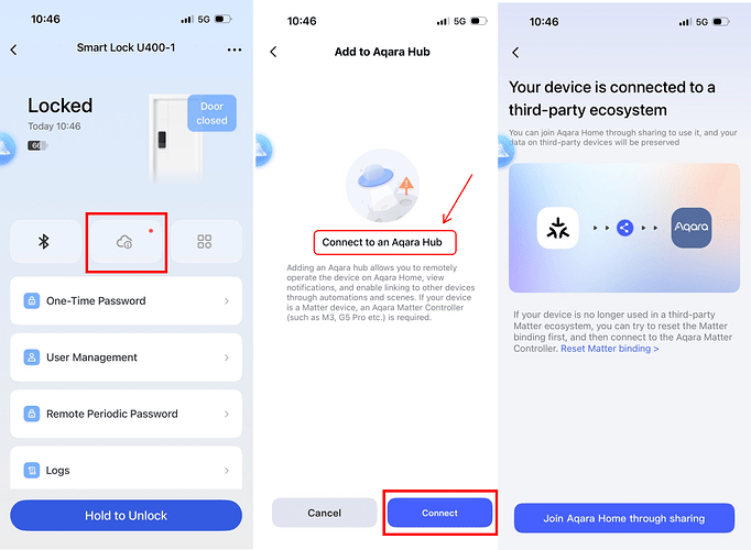

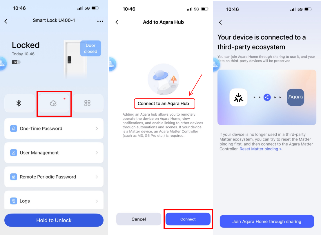

  • In the Aqara Home app, open the U400 device page and tap the Cloud icon.
  • Tap “Connect” and select “Join Aqara Home through sharing”.

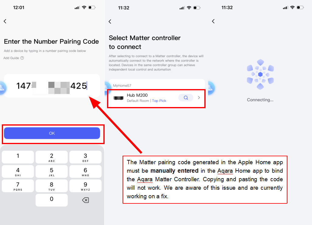

  • Select “Apple Home”, then tap “Enter Matter Pairing Code”.
  • Switch to the Apple Home app: go to the U400 settings and tap “Turn On Pairing Mode” to generate a pairing code.

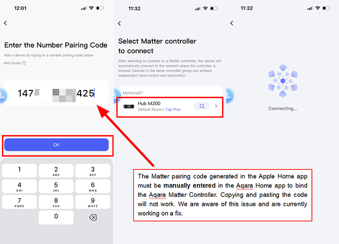

  • Manual entry (important): switch back to the Aqara Home app and manually type in the pairing code generated by Apple Home.
  • Press the Set button once on the lock, select your bound Aqara Hub, and follow the final prompts to complete the binding.

Note on pairing codes: currently, you must manually type the Matter pairing code into the Aqara Home app — copy & paste is not supported for this step at this time. We are working on a fix to make this easier in a future update.
