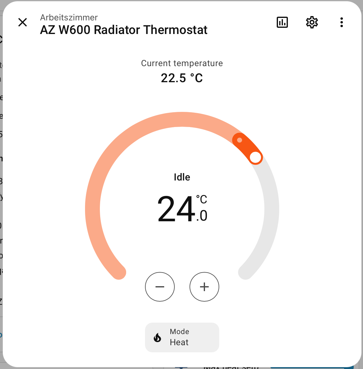

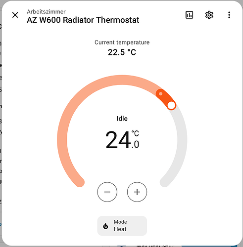

I’ve started playing around with HA and Aqara devices. The quirk I came up with for the W600 allows to set the temperature as shown in the screenshots:
if I manually change the setting on the knob the new value is being reflected in HA.
ISSUE: when I try to make an automation to set a temperature for the night (lower it to 8 degrees) that is not possible. The field to set the temperature does not appear.

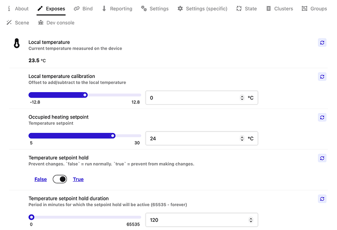

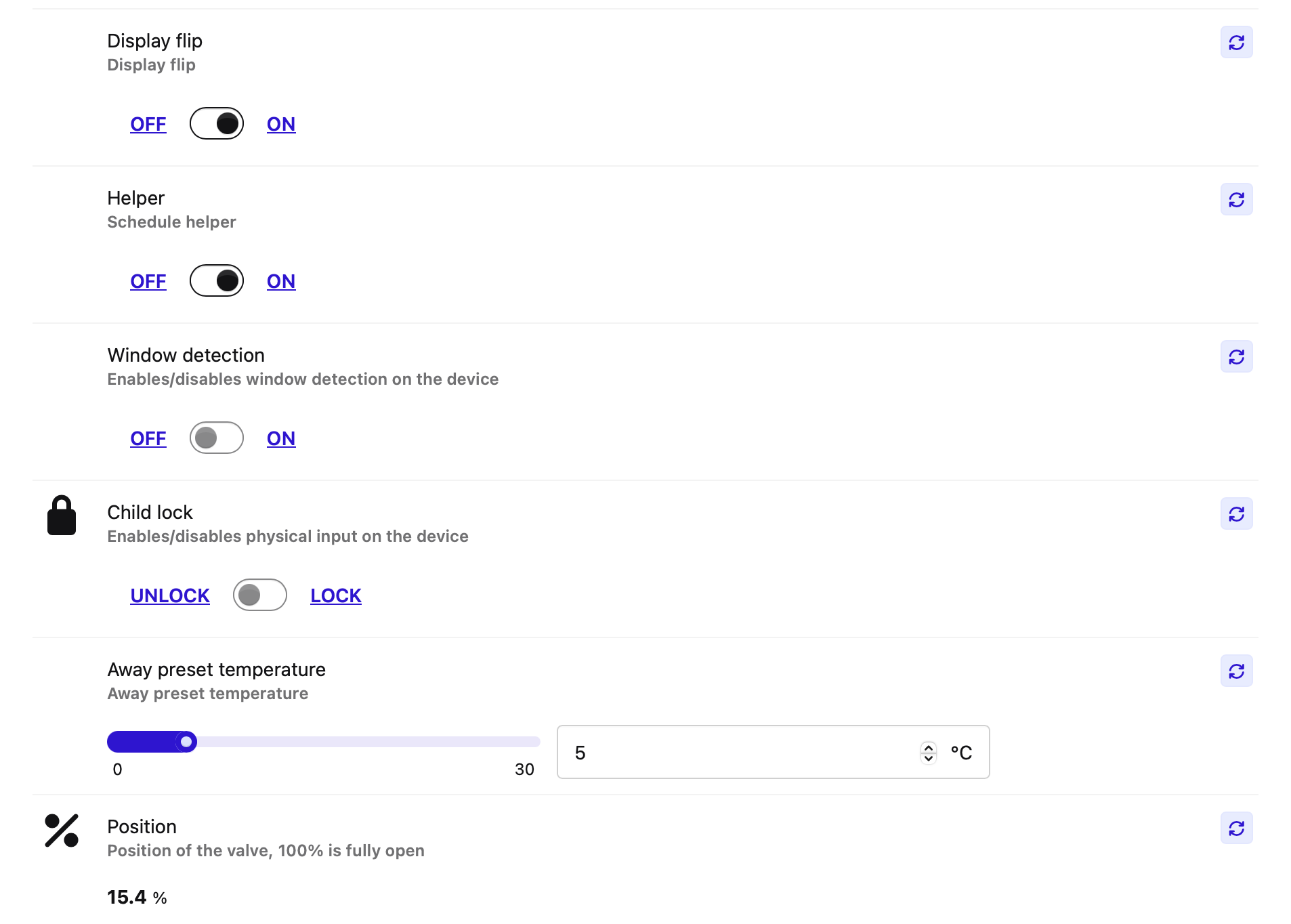

I started playing around with HA only a few weeks ago running HA in Docker on a Synology NAS. After the Christmas holidays, I reinstalled HAOS on a dedicated Mini PC. I took the opportunity to switch to Zigbee2MQTT - more out of curiosity than anything - so I won’t be putting more effort into this quirk for the foreseeable future.

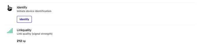

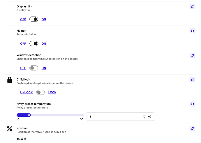

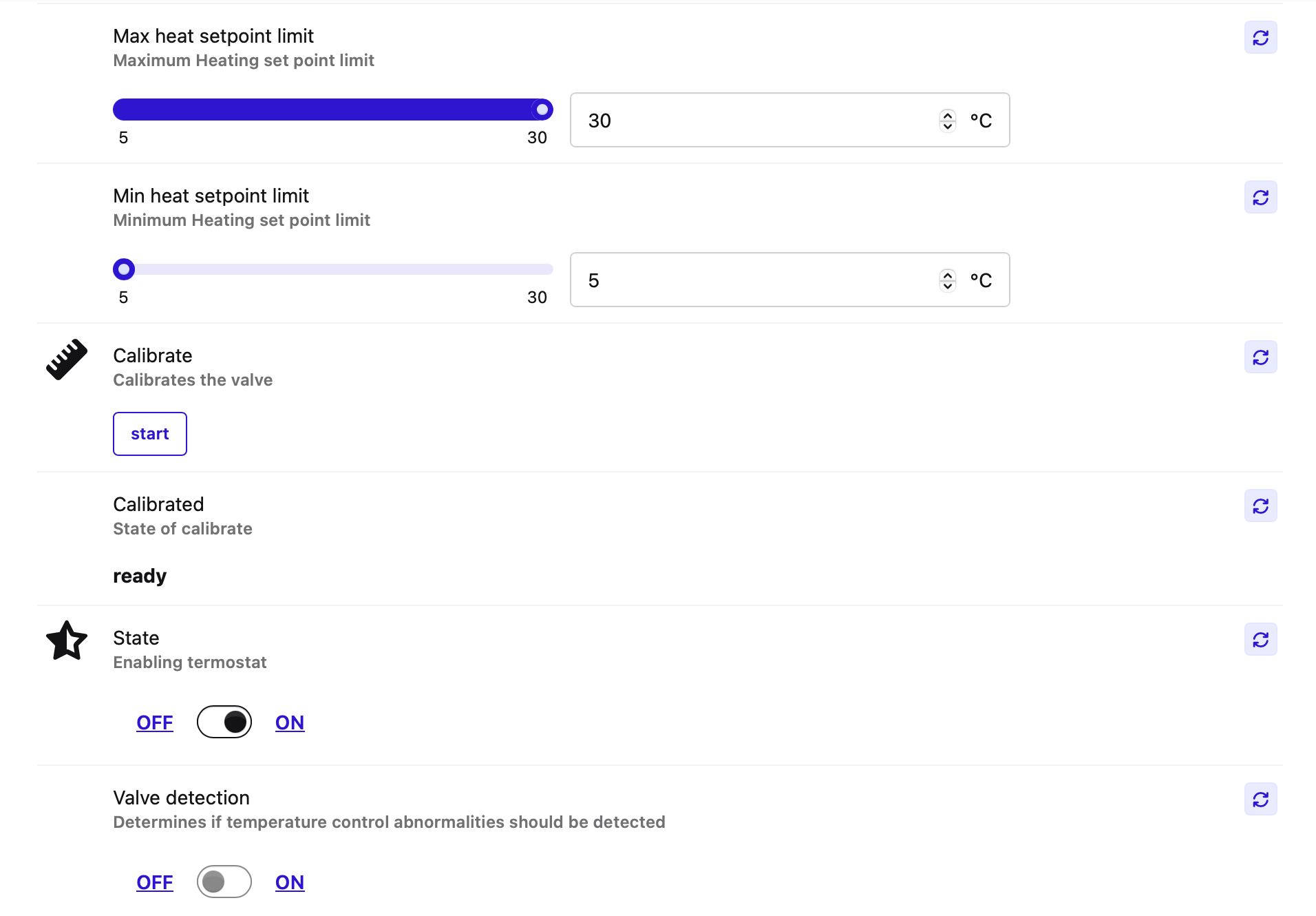

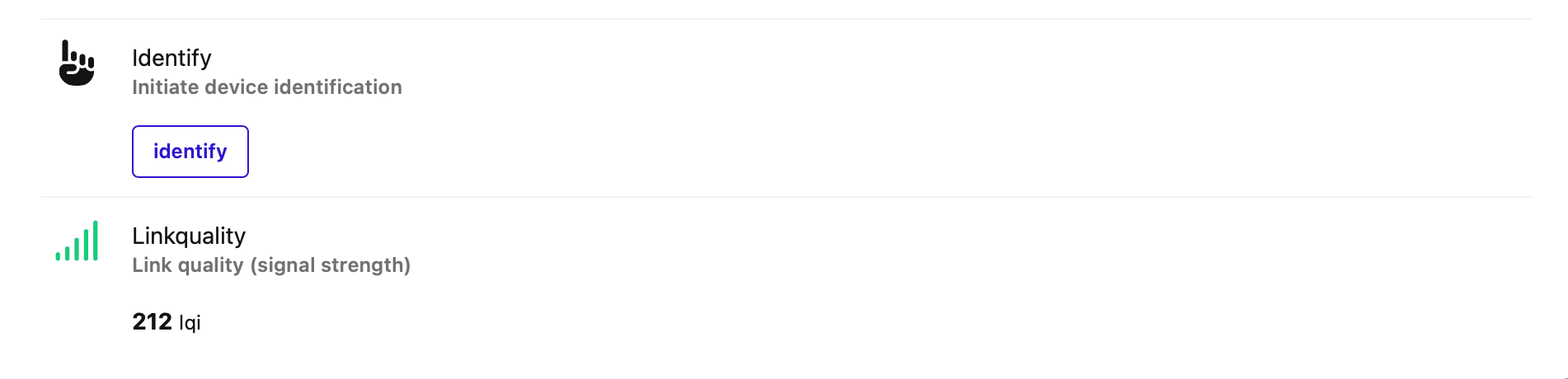

FYI, this is what Z2M exposes for the W600 out of the box:
Hi, thank you for your efforts. I also considered to make this switch, but the wisdom that in the end two things often turn out to be more complicated than one held me back. You made huge progress in a short period of time.
