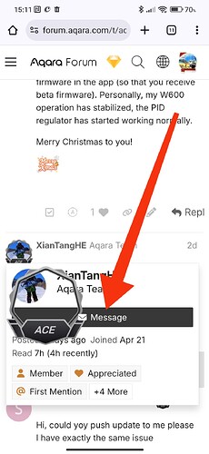

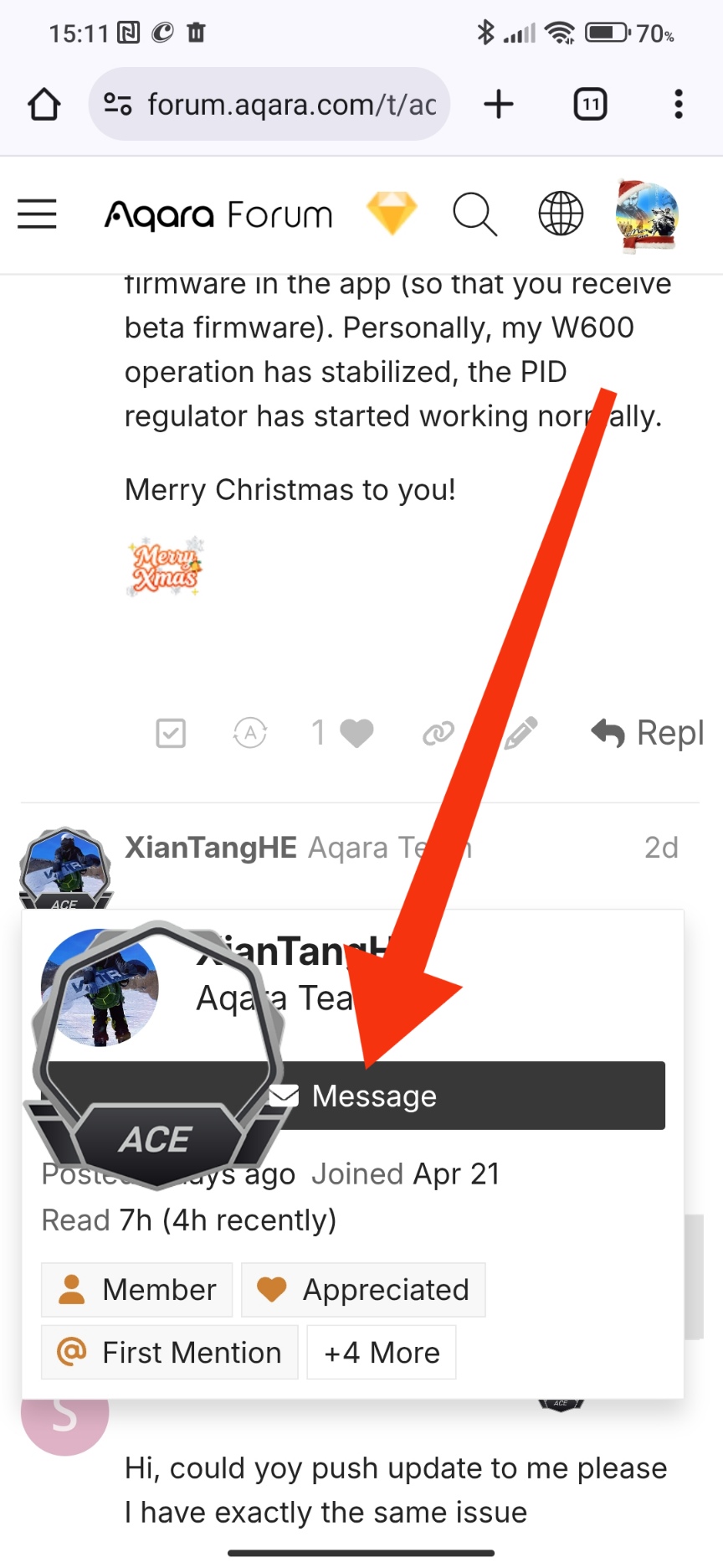

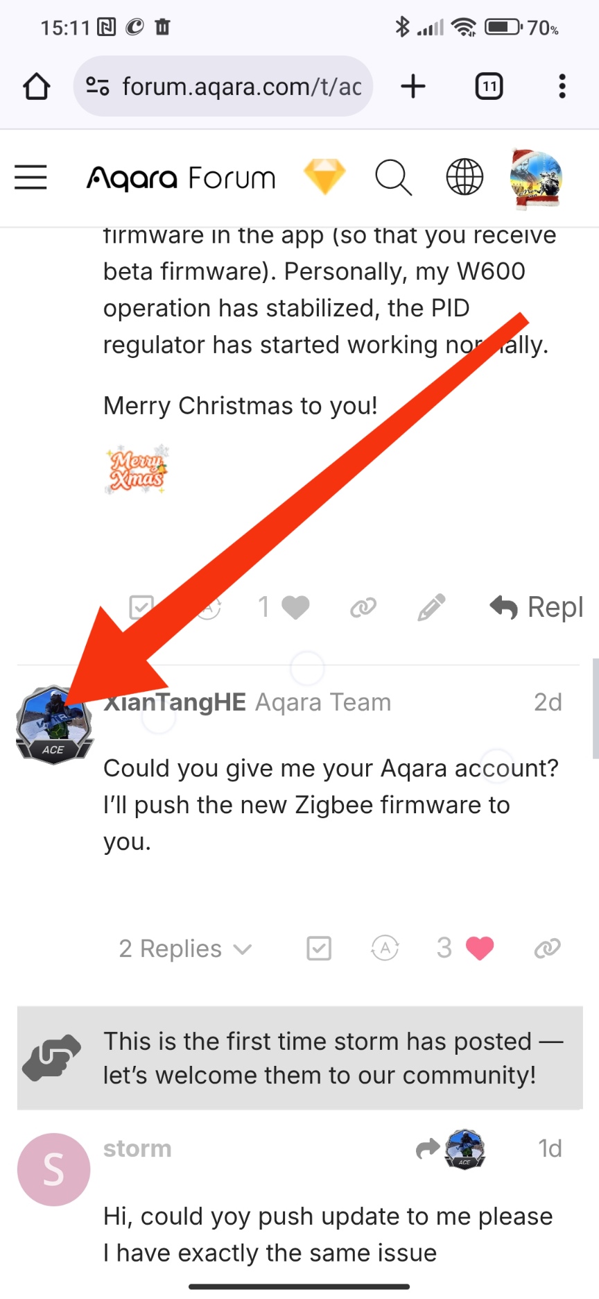

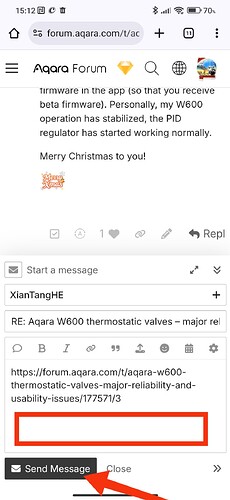

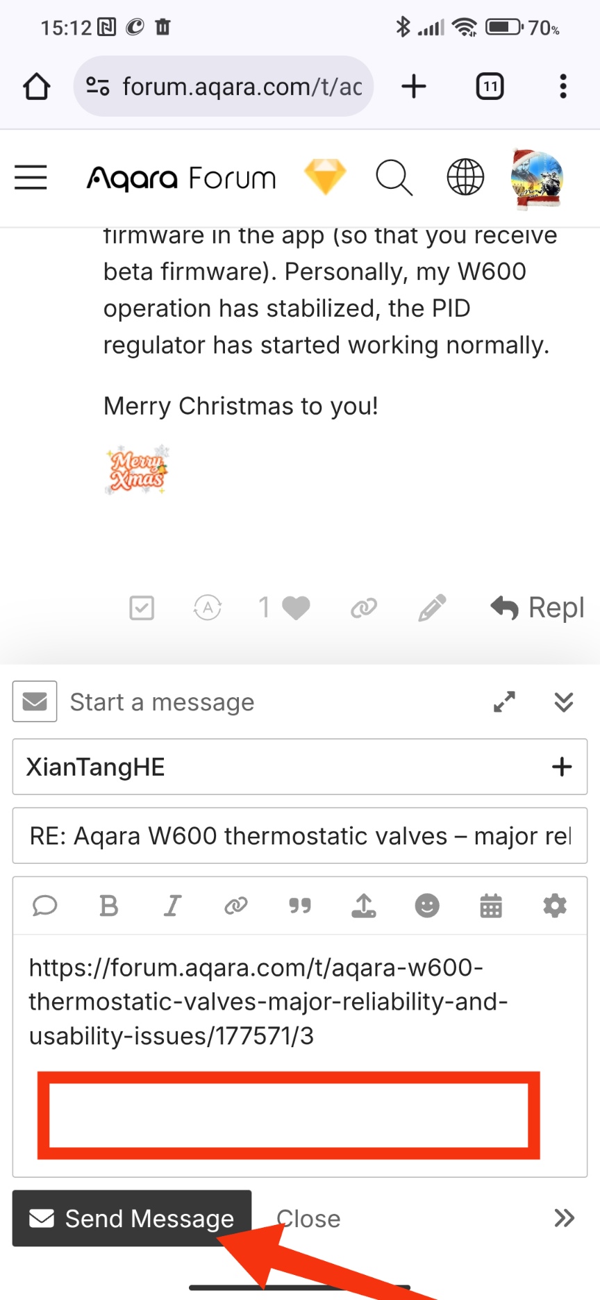

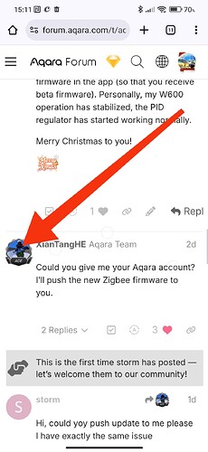

Not sure how to send a private message
Hello, Merry Christmas to you. I showed you how in the screenshots.
