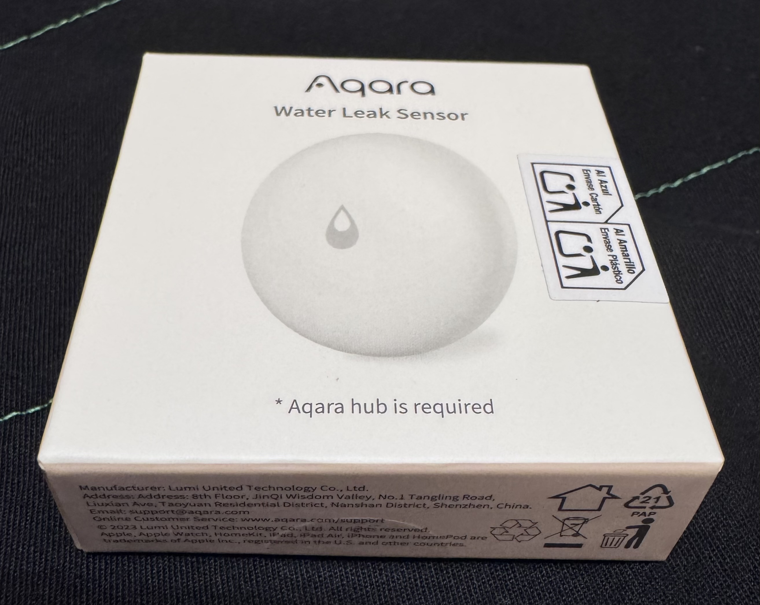

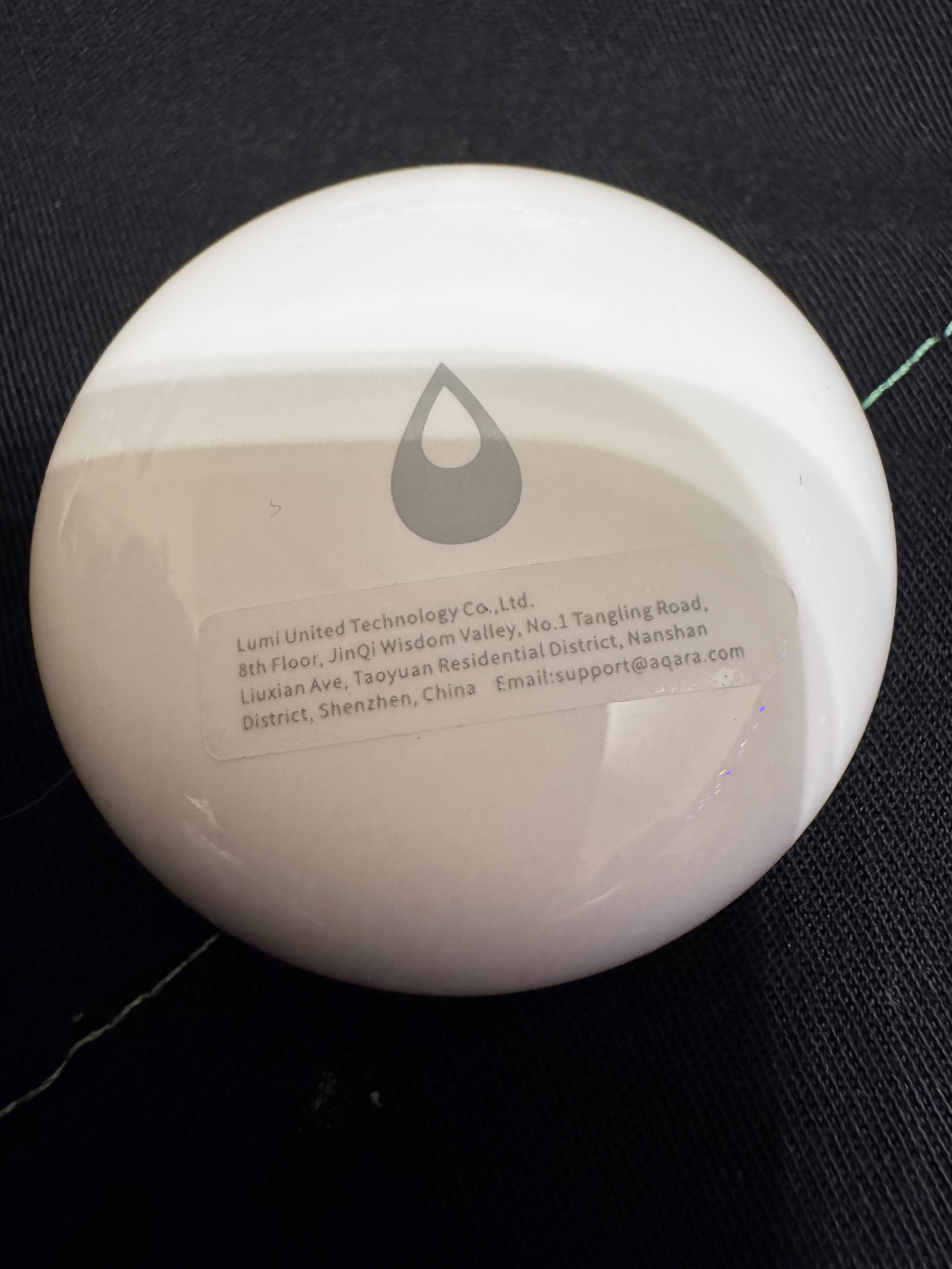

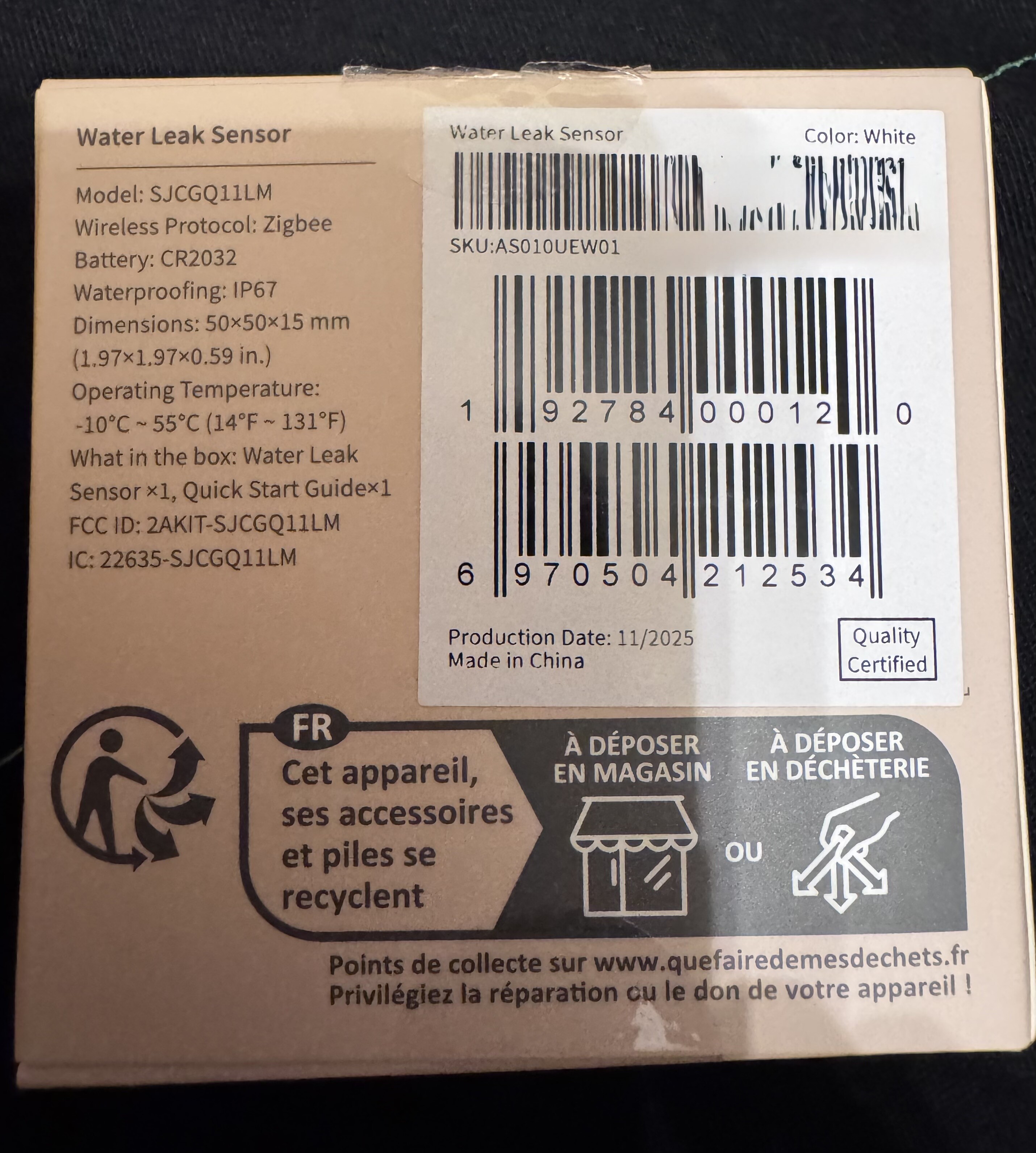

This seems like a silly question, but are the Water Leak sensors compatible with the new M200 Hub? I just purchased some Aqara products to set up our daughter new place and thought I’d try the M200 hub. I had no problem connecting the LED Bulb T2 as well as the Temperature and Humidity Sensor, but when I tried the 3 Water Leak Sensors I had no luck. Tried new batteries and still no luck.

Hello, have you tried connecting two sensor options (regular and T1)? Another question, is the leak sensor in European packaging or for the Chinese market?
Yes, I have the M200 and four Water Sensors and they connected fine. Only issue I had was how long to press the top of the sensor when pairing to the hub. It says wait for 3 flashes of the light but it just keeps flashing. So I just kept holding the top down. I think I was just resetting them by holding too long. I held the sensor right next to the hub, pressed the top and let go as soon as it flashed 3 times. Then it paired.
