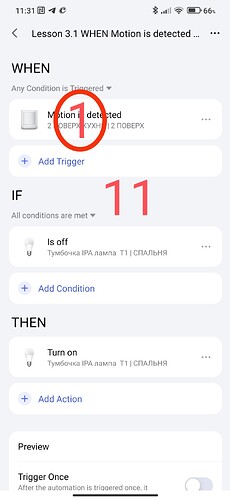

Lesson 3 we completed by creating a comprehensive lighting automation.

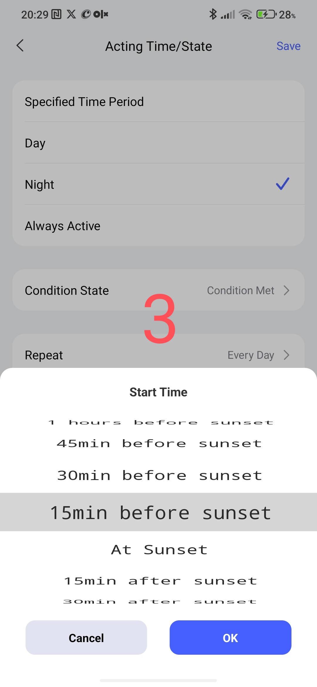

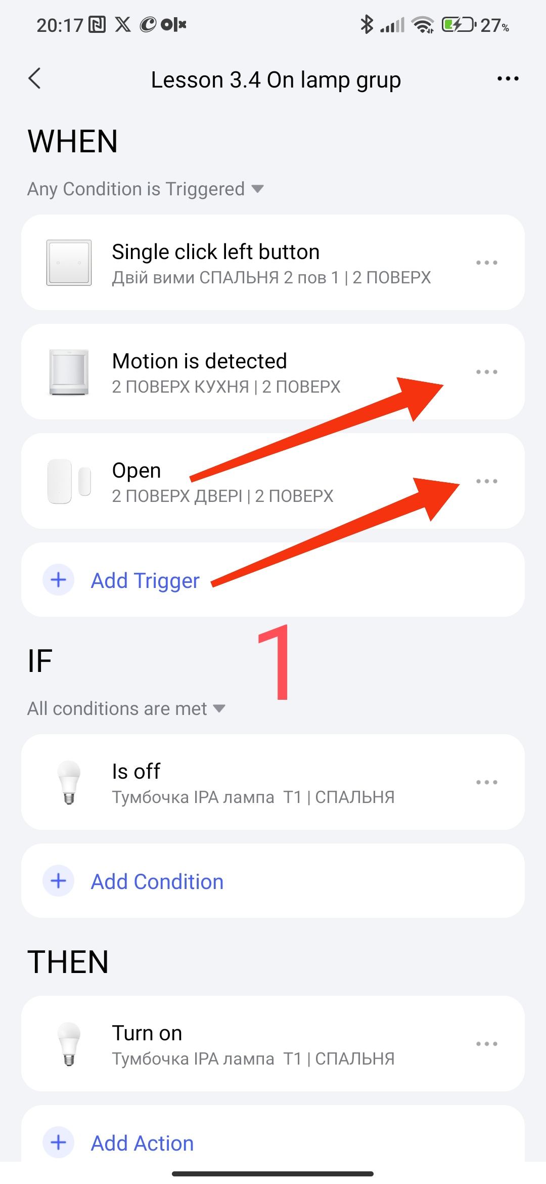

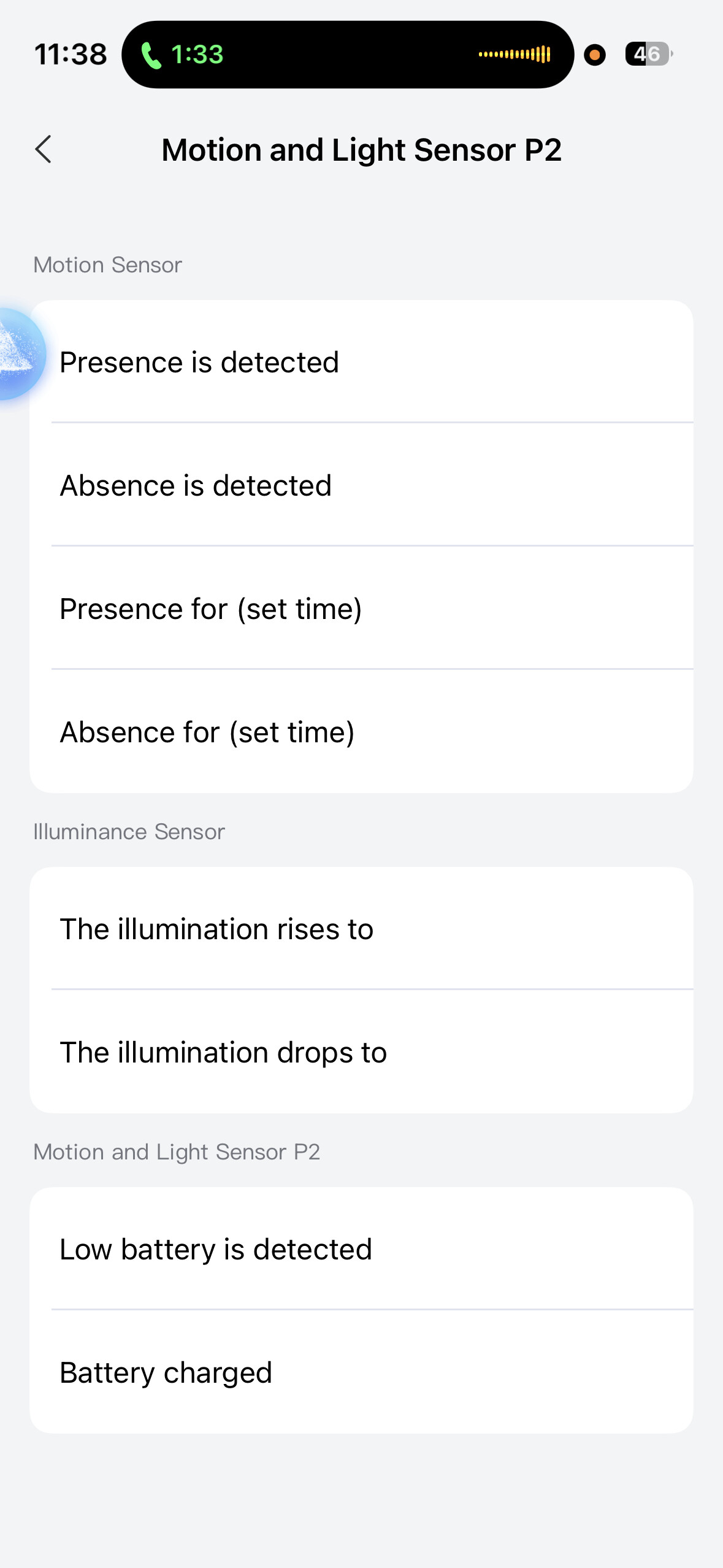

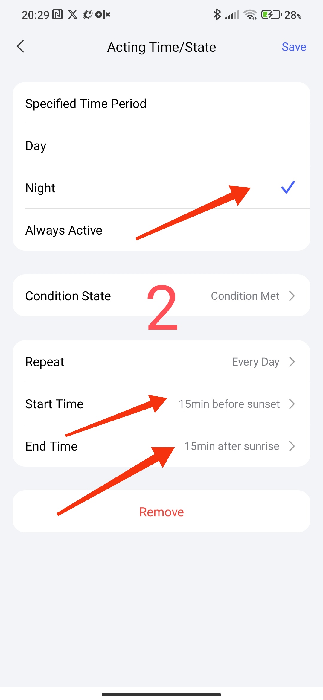

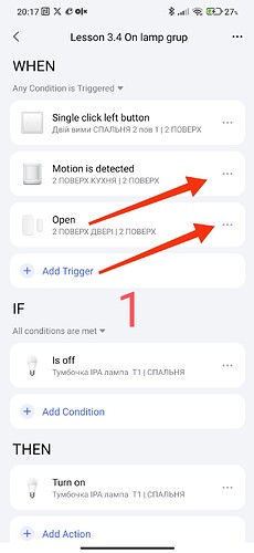

Let’s supplement this automation with the “night” activation period, from lesson 2 we will go to the “…” settings and select “Acting time” for the motion sensor and the opening sensor.
Figure 1.

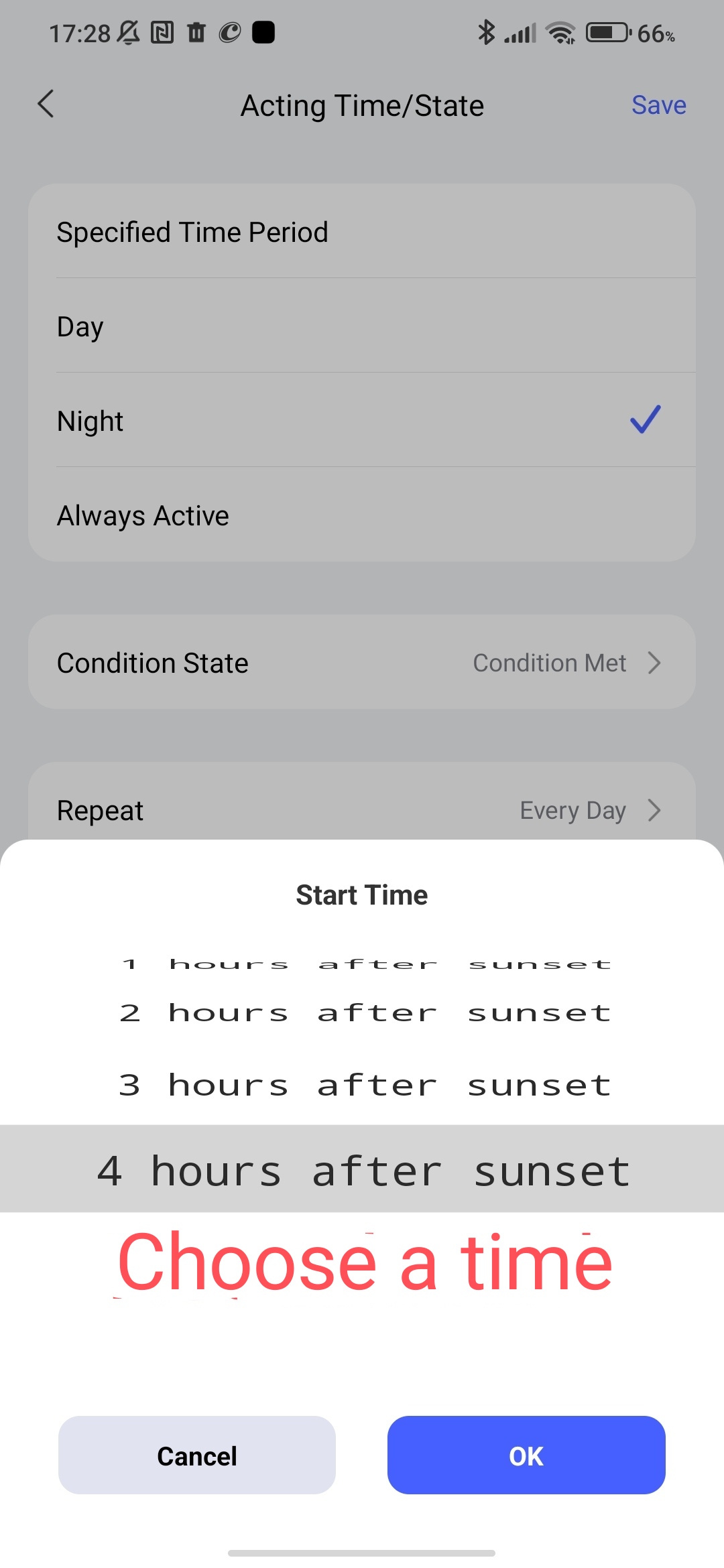

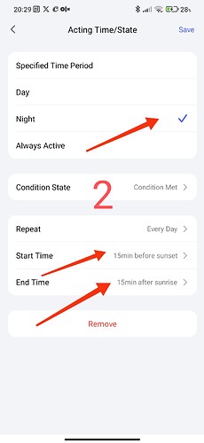

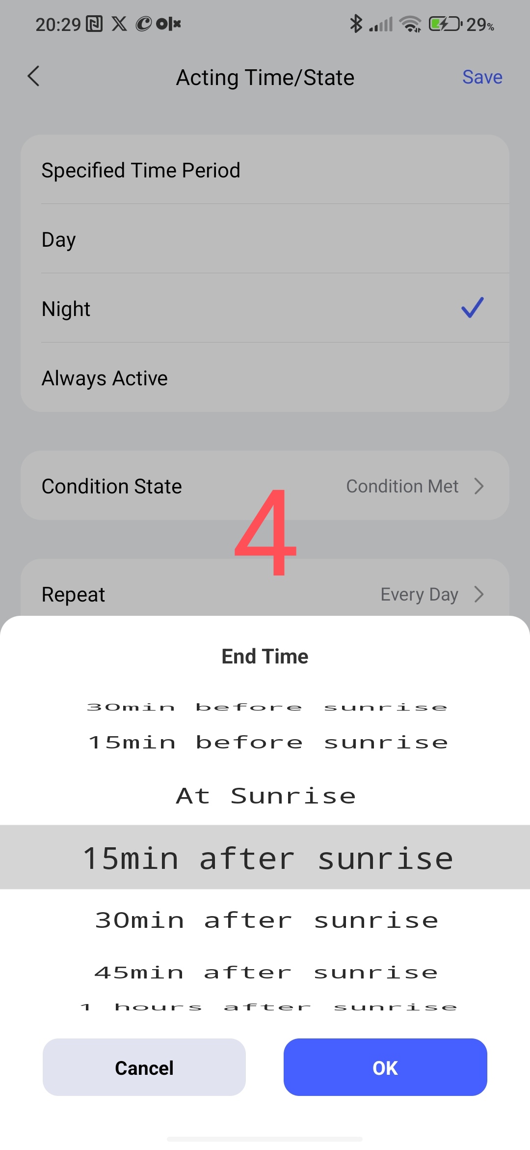

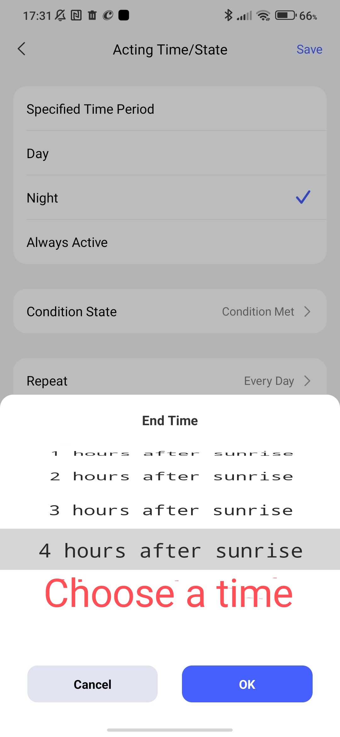

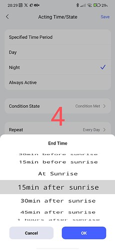

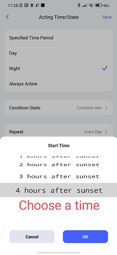

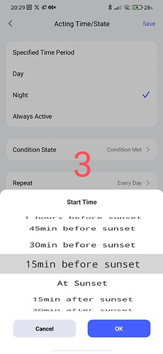

We select the “night” option, I practice choosing the start of the event 15 minutes before sunset and 15 minutes after sunrise. This selection is optimal for my region.
Fig. 2,3,4

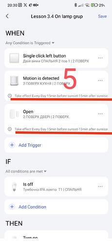

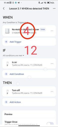

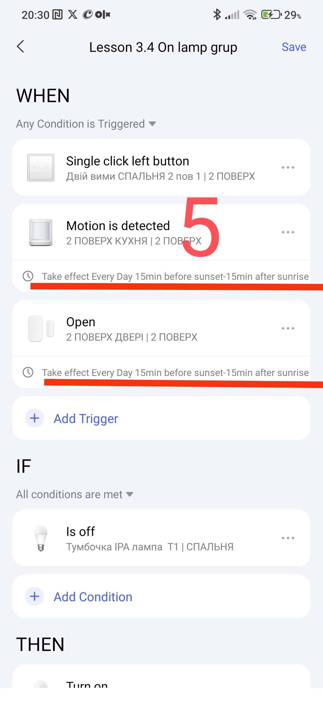

As a result, we will get a ready-made automation for the night period. Automatic triggers are a motion sensor and an opening sensor. The wireless button works 24/7 for manual light switching, there are times when you need to turn on the lamp even during the day.
Fig. 5

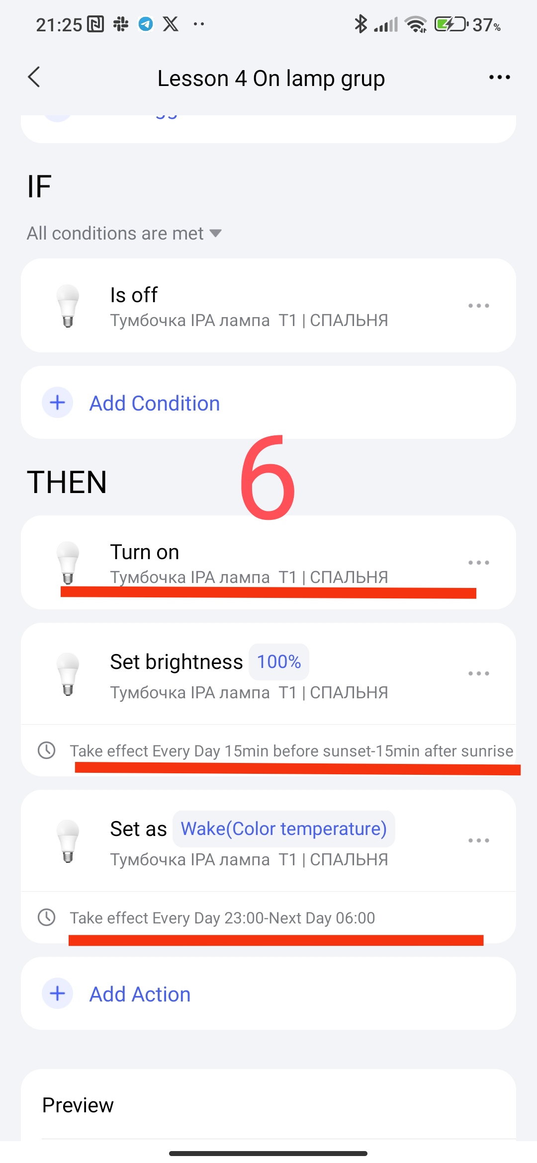

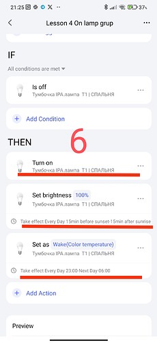

Now let’s consider my lighting solution by time periods (evening, night, morning).
To understand this solution, I will make an extended explanation.

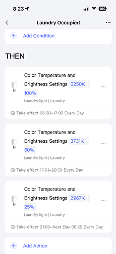

We will make three different light switchings for different parameters in the “THEN” conditions.
  1. On lamps.
  2. Set the brightness.
  3. Set a static effect (create a cozy light for the night).
You ask, why not “set the brightness” three times, because Aqara has limited the function of performing the same action in “THEN”, I am making a request to @AqaraOfficial regarding this limitation.
We do not limit the switching period “1”.
For the “2” switching period, we choose “night”, similar to the motion and opening sensors.
For the “3” switching period, we choose the time range 23.00-06.00.
We will get such automation in the “THEN” section
Fig. 6
Now I will explain the switching algorithm.
“1” (On without a period) will constantly turn on the lamp state that was after the lamp was turned off (Off). “2” turns on the light at 100% during the “night” period. “3” turns on the light 23.00-06.00. Please note that after 06.00 the light continues to work at “2”-100%.
There is one feature in this automation, when the first switching on occurs in the period 23.00-06.00, 100% is instantly observed and then the entire period the specified (dimmed) lighting.
I use such automation in the bathroom, toilet, corridor, kitchen.

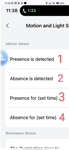

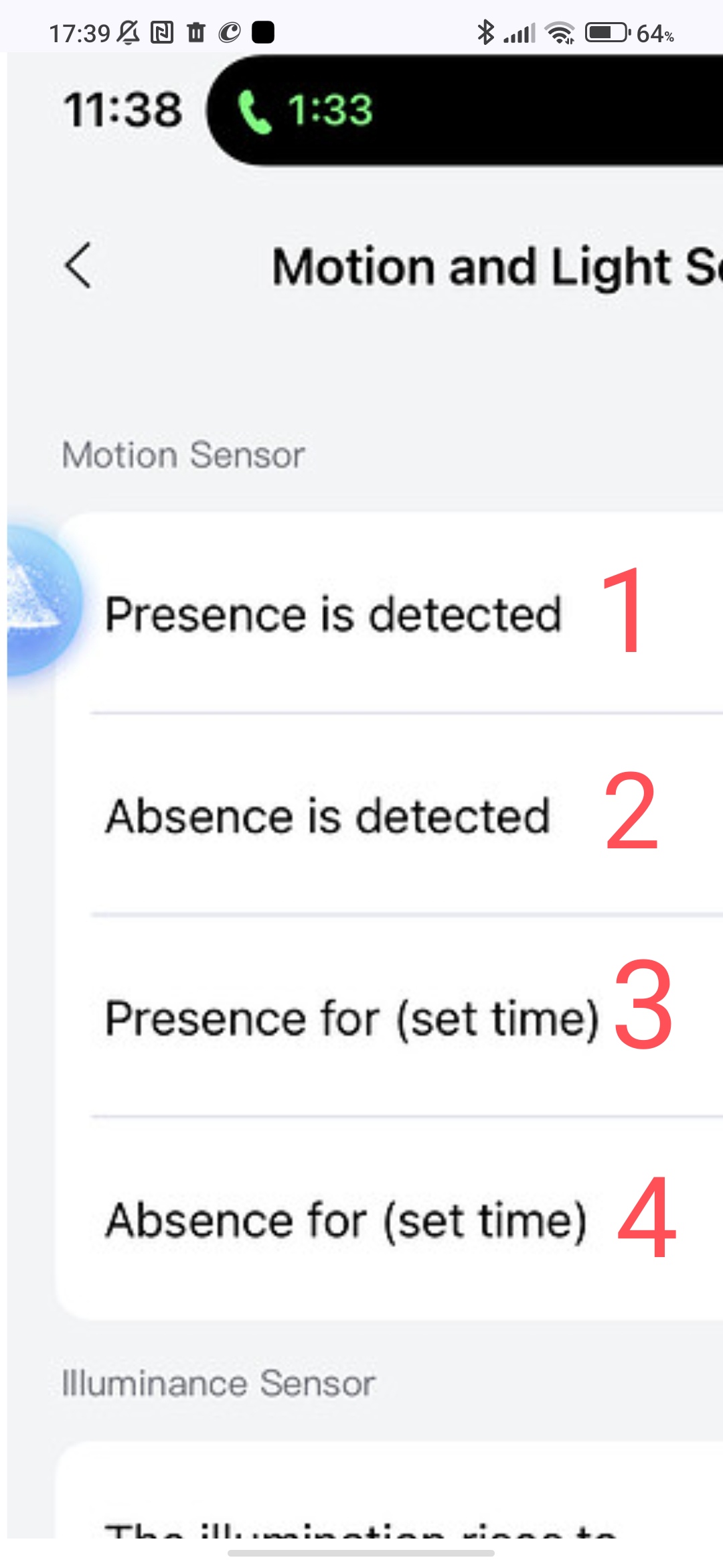

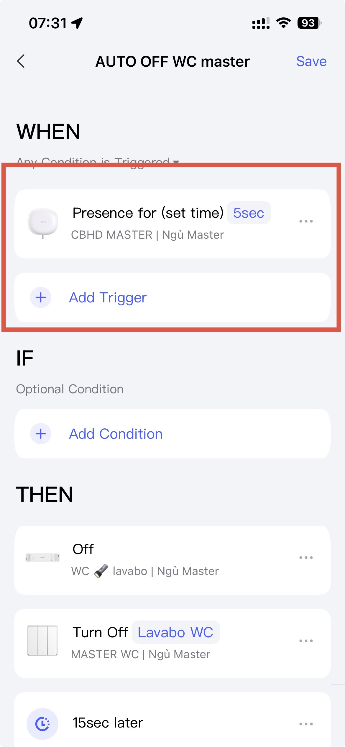

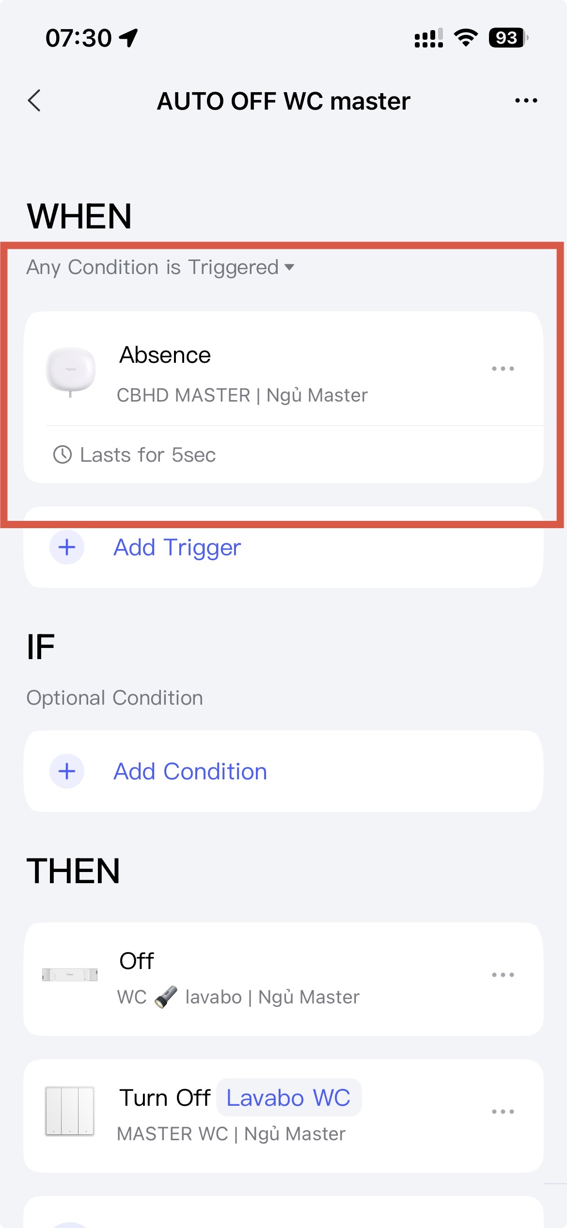

When use the trigger with the presence sensor What is the different between “presence for 5s” and “presence duaration 5s”
The “duration” option was added in version 2.0 and in version 1.0, only “presence for” was available. Therefore, I would assume that “presence for” was simply carried over, which is also beneficial in terms of user-friendliness and was probably easier for the programmers :wink:
Hello, please show a screenshot of the conditions to understand the essence of the question. And also, what sensor are you talking about? Thank you.
Here sir. Im using FP1E
Hi, there is no difference in your example. The delay parameter “…” plays the same role as the condition in the sensor. Thanks for the question.
