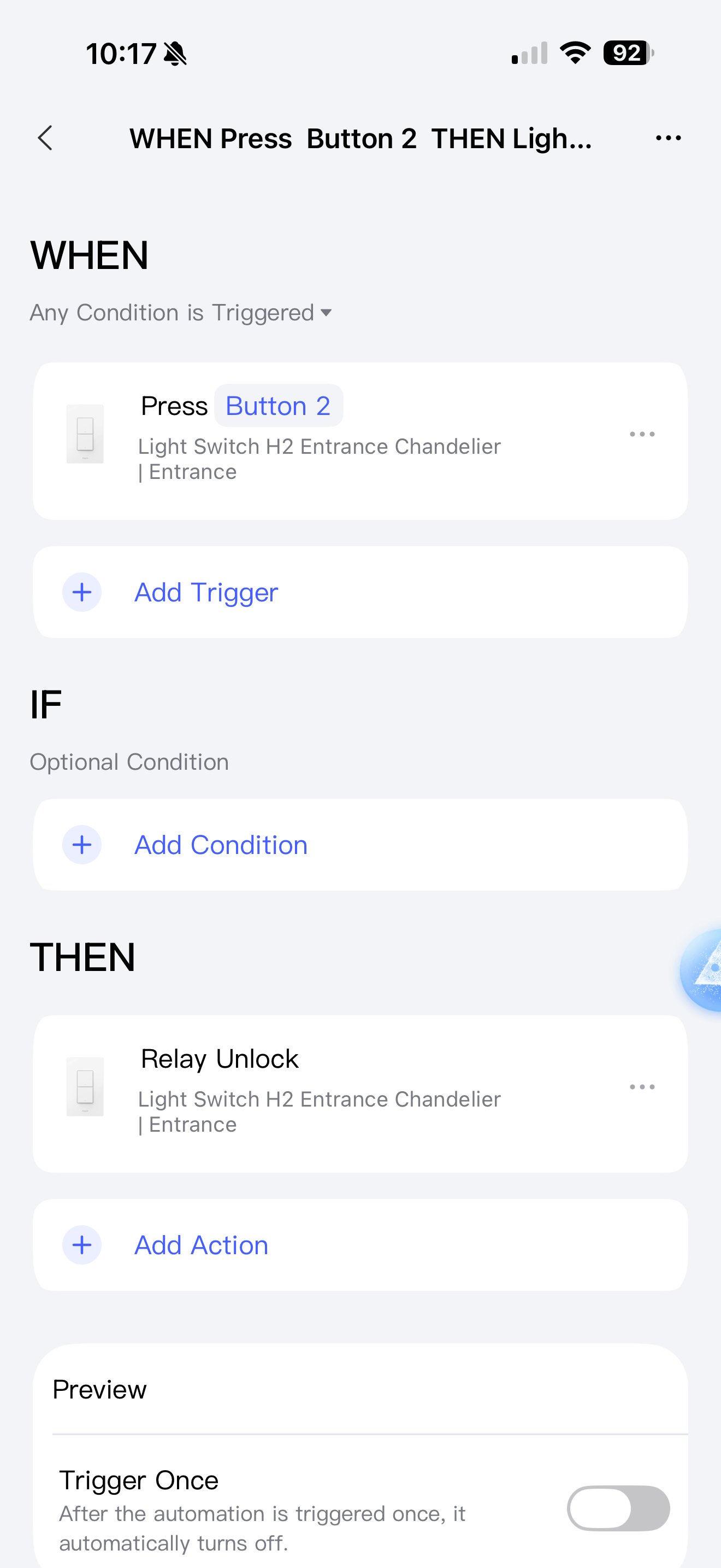

I have 14 H2 switches that I use through out my house with smart and dumb bulbs. The automation I use when the switch controls a dumb bulb:
If single press second button
Then relay unlock
This way it’s very natural for people to press top button to turn on lights and bottom button to turn off lights.
For some reason this automation doesn’t work in the H2 switches I just bought. When I press the second button nothing happens.

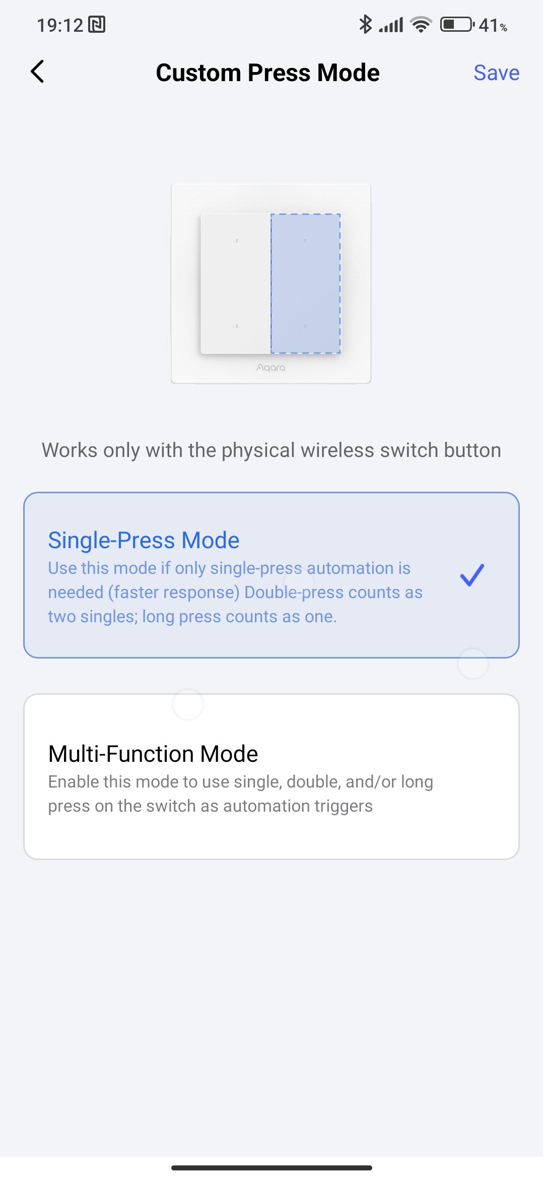

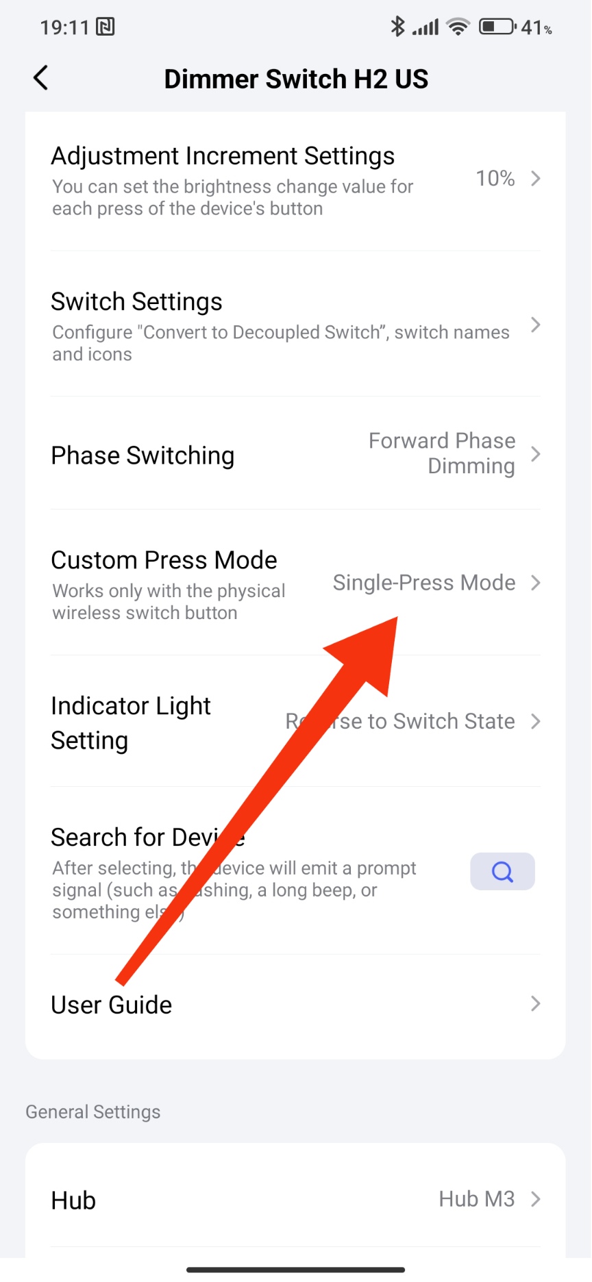

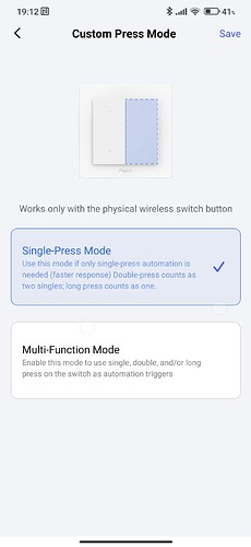

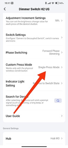

Hello, the button on the switch is untied, it works like a contactless one.
Maybe this is the problem, without untiing it works like a regular switch?

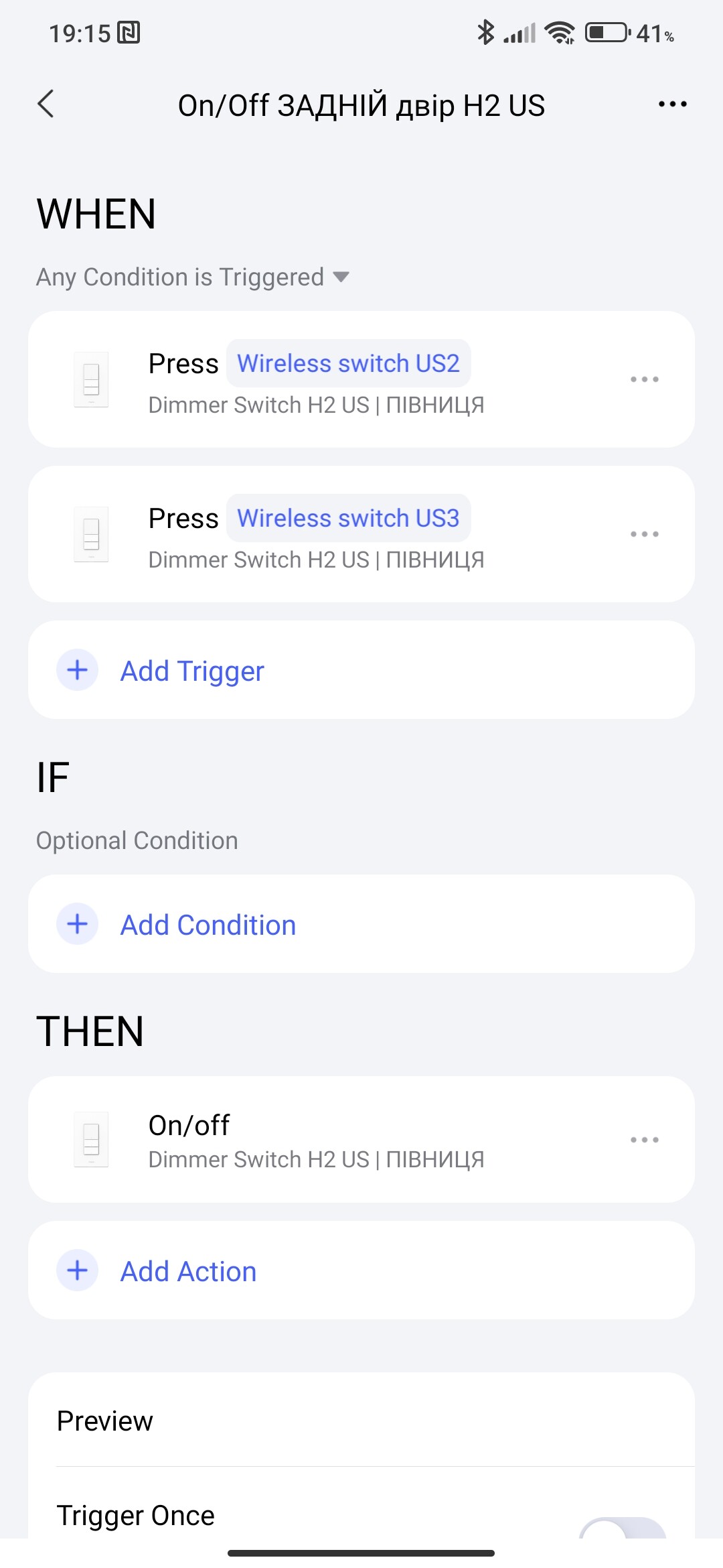

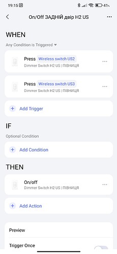

I actually made such automation, so no matter which switch I turn off (upper, lower), the required function is always performed.
Very smart!! I’m going to try that.
