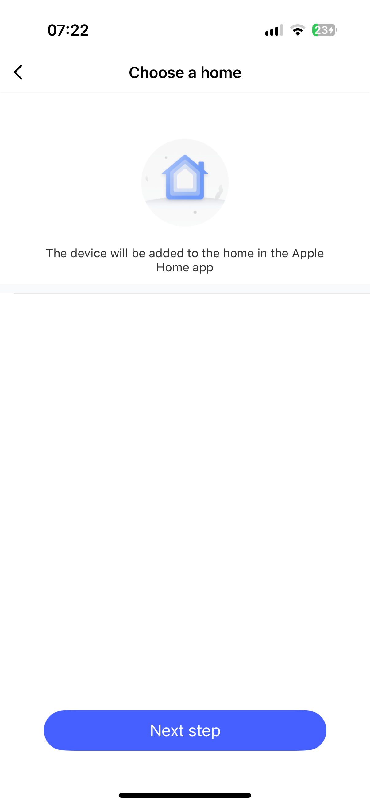

I want to connect the E1 hub but in step 2 of the process the Aqara app can’t see the home I’ve added. What to do?

@ryanvoerman Please provide screenshots of the Aqara Home App showing the specific issue you’re experiencing, so we can better understand and address your problem.
See the screenshot. While connecting the app can’t find the home I’ve added.

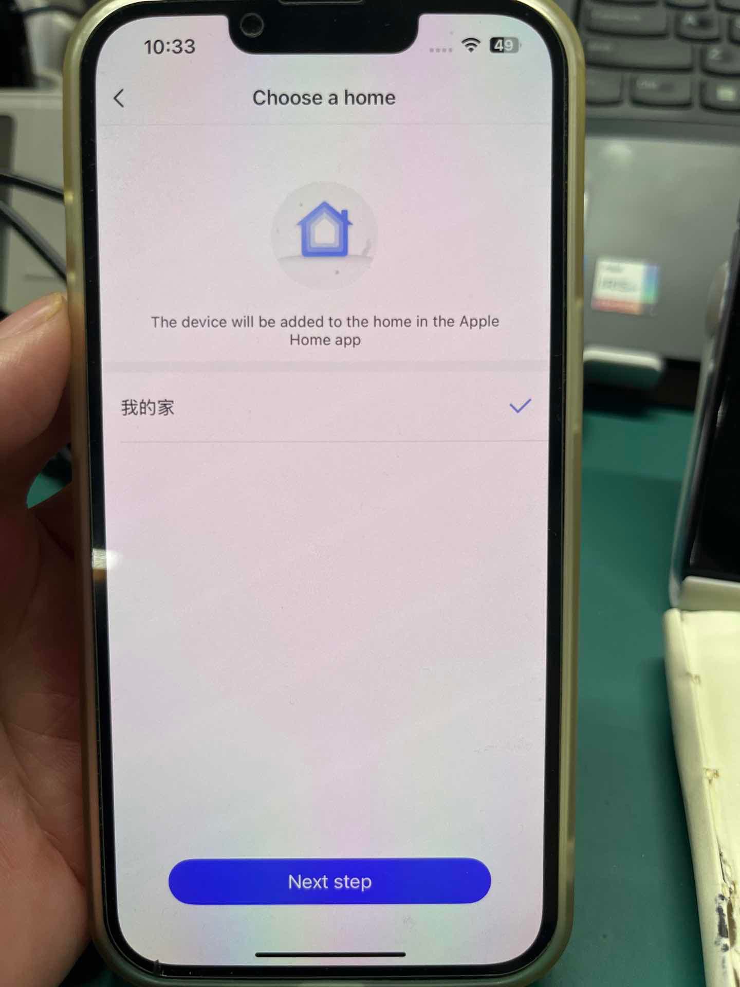

@ryanvoerman The normal display effect should be as shown in the figure below:

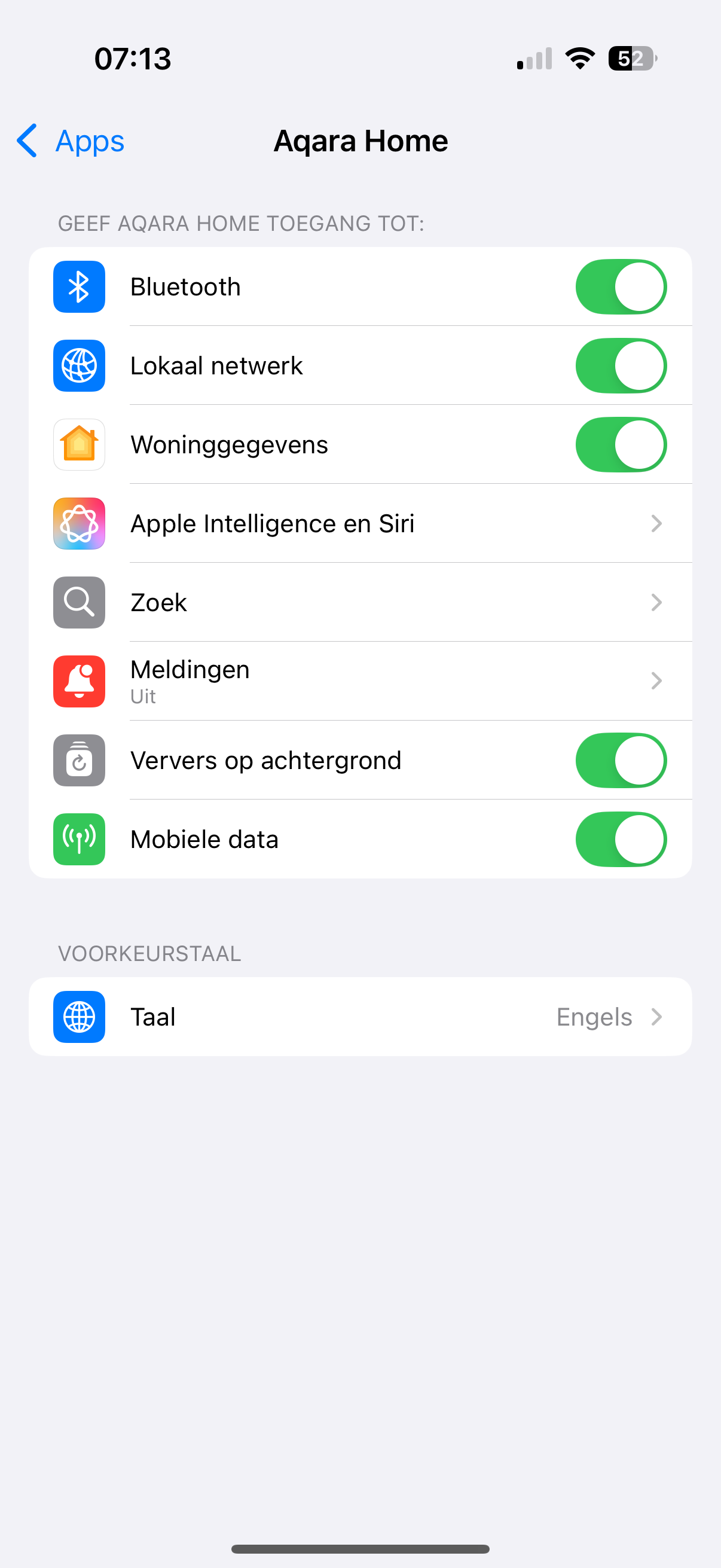

Please go to the “Settings” — “Aqara Home” on your iOS system and try enabling “Home Data”.
Hey, thanks for your response. Home Data (called Woninggegevens) is already enabled.
thanks! it works for me after I have reboot my phone.

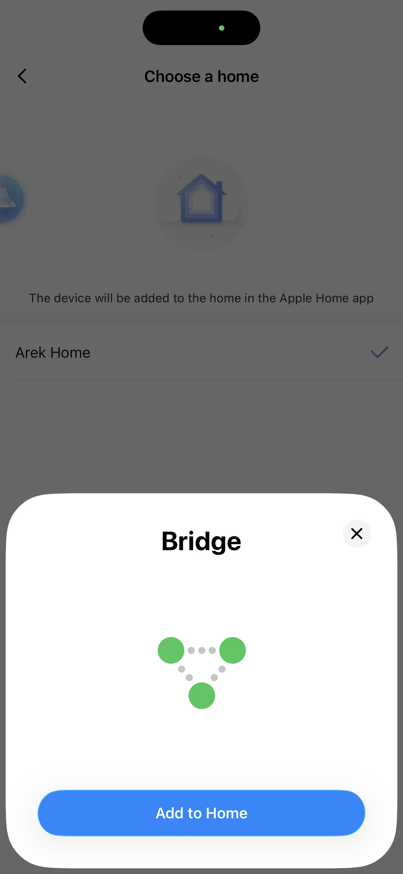

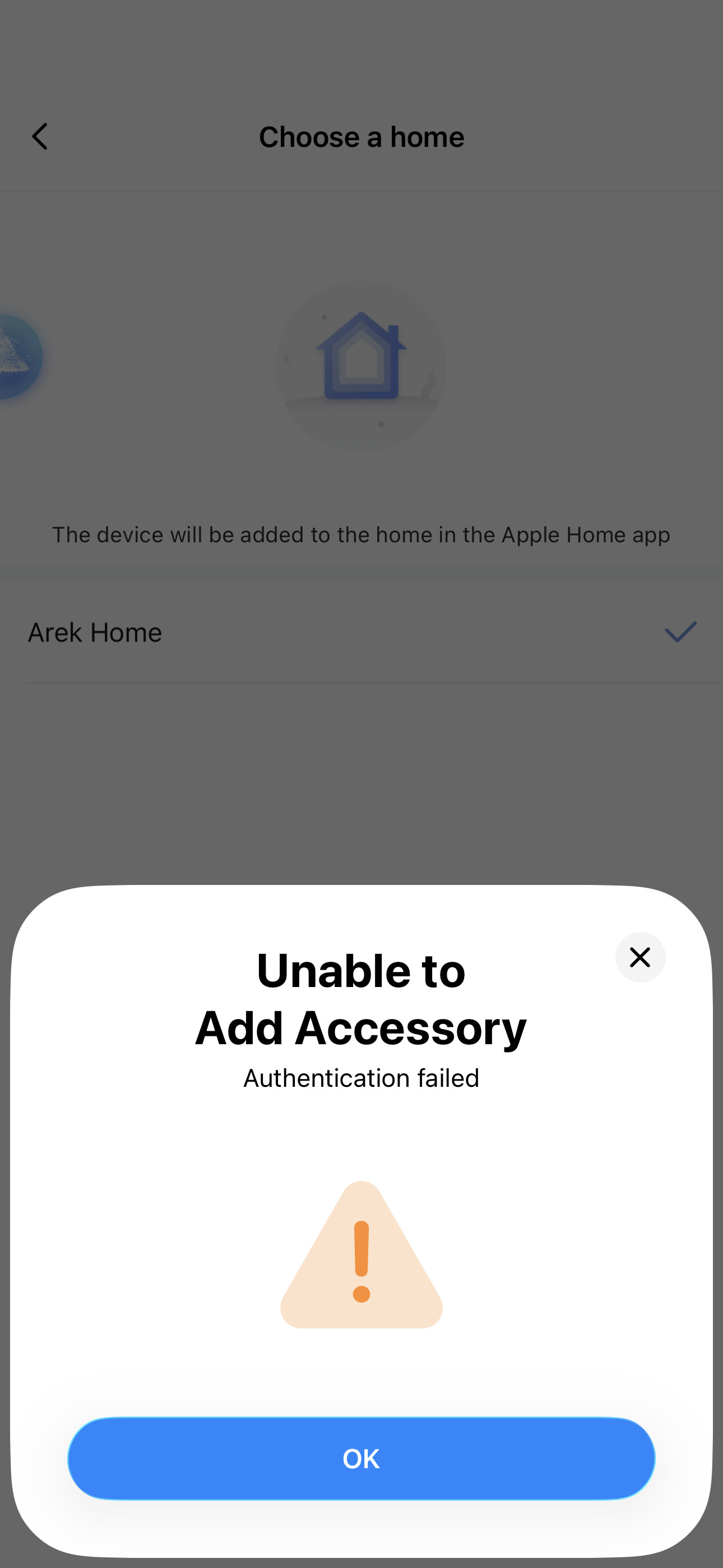

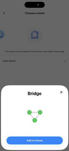

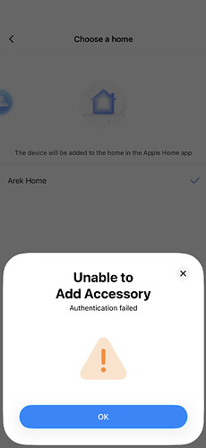

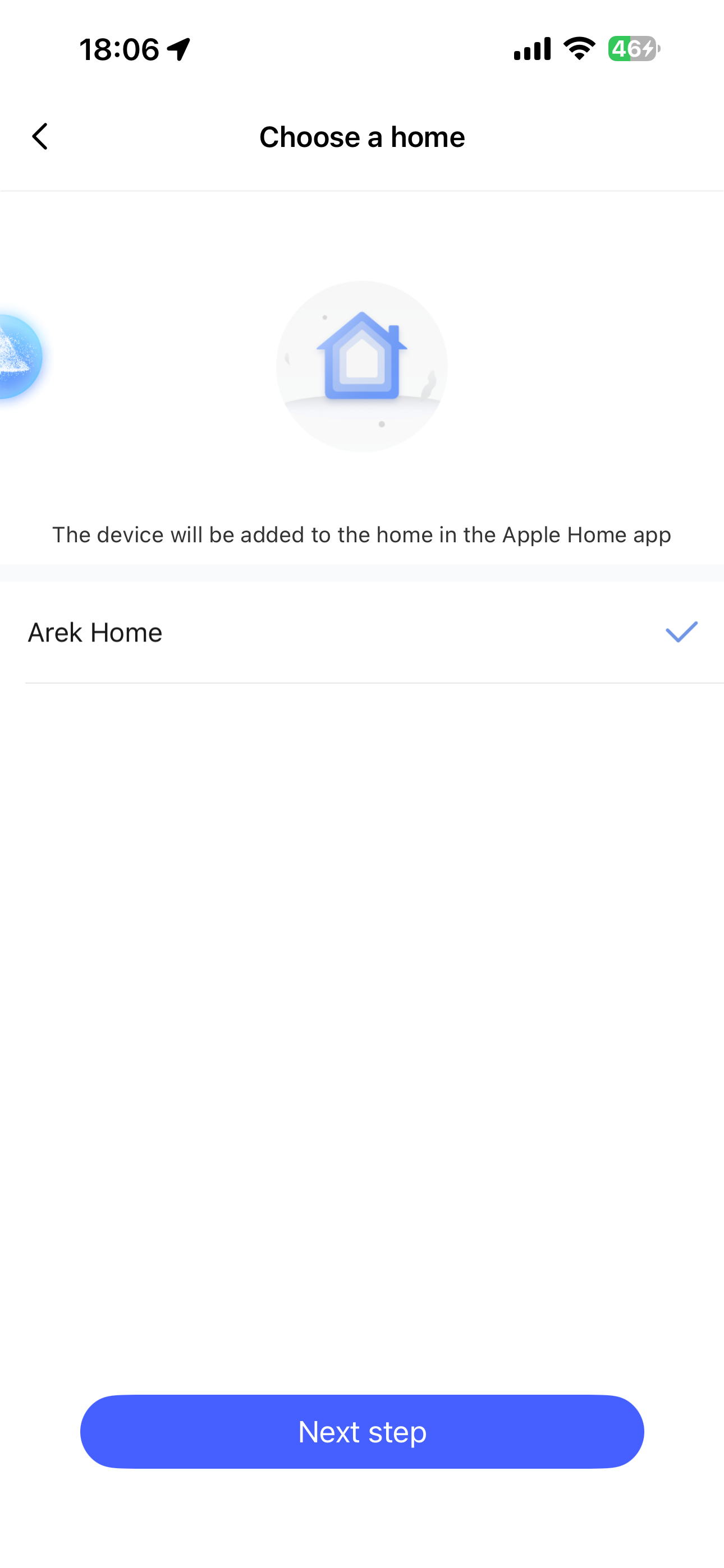

Hey, I face the same issue. Cannot connect the E1 Hub.
I followed all the steps and rules: only using 2,4 GHz wifi (5GHz is off), I simplified the name and password, reset Hub by pressing 10+2 times, waiting for yellow LED, I tried both CN and EU regions, data share with Aqara and Apple Home is enabled, restarted my iPhone as well, no VPN on, i keep it close to t
I’m stuck at this step:
" 3.
If you are using an iOS device, you might need to scan or enter the HomeKit code on the Apple Home app during this process." - here is where Apple shows “unable to add accessory, Authentication failed”. - check screenshots.
I dont really understand why i even have to go through Adding to-Apple Home step. I dont need it there. Just wanna add it to My Aqara Home app. WHY YOU CAN’T SKIP THIS STEP.
EDIT: what helped at the end, was unplugging the E1 Hub, as well.
@vazvaz Hey there! It sounds like you’ve really been through the wringer trying to get that E1 Hub connected.
Regarding the issue of not being able to add the accessory with an “Authentication failed” message on the Apple Home app during the process, it could be due to multiple adding failures causing the error information of iOS cache not being removed. You can try restarting the iOS device and reset the hub again. After that, you can manually enter the HomeKit setup code and add it again .
As for why you can’t skip the Apple Home step when using an iOS device, the Hub E1 is designed to integrate with HomeKit for those who want to use it in the Apple ecosystem. Even if you don’t plan to use it in the Apple Home app in the end, this step is part of the setup process for iOS devices to complete the overall connection and configuration of the hub.
I’m glad to hear that unplugging the E1 Hub helped in the end. If you run into any more issues or have other questions, don’t hesitate to let us know. We’re here to help you get your smart home up and running smoothly! Let’s keep the discussion going and see if others have had similar experiences or tips to share.
