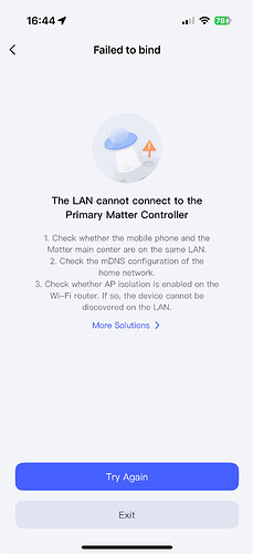

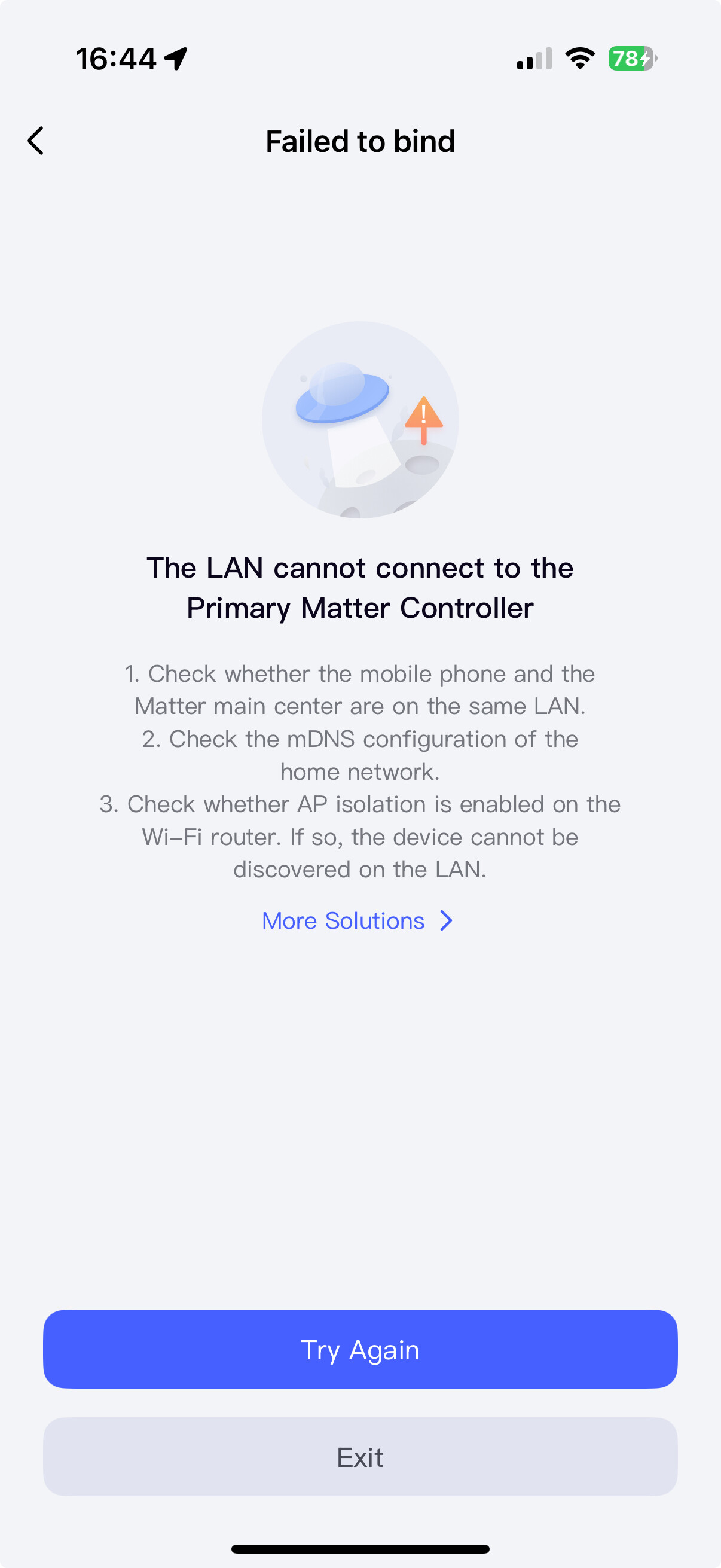

I have an Aqara HUB M3 and 3 Door and Window Sensors P2. I’m trying to add the Sensors to the hub via matter with the Aqara Home app on my IPhone. And unfortunately that doesn’t work. Can’t pair any of the 3 sensors. The app detects the sensor. Then I scan the matter code. The app says it’s connecting to the sensor. (it detects it is a sensor). Then the app says it’s setting up and that fails after a while.

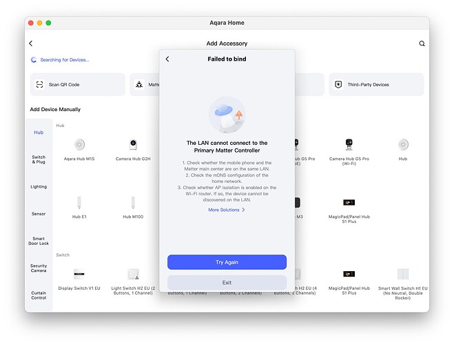

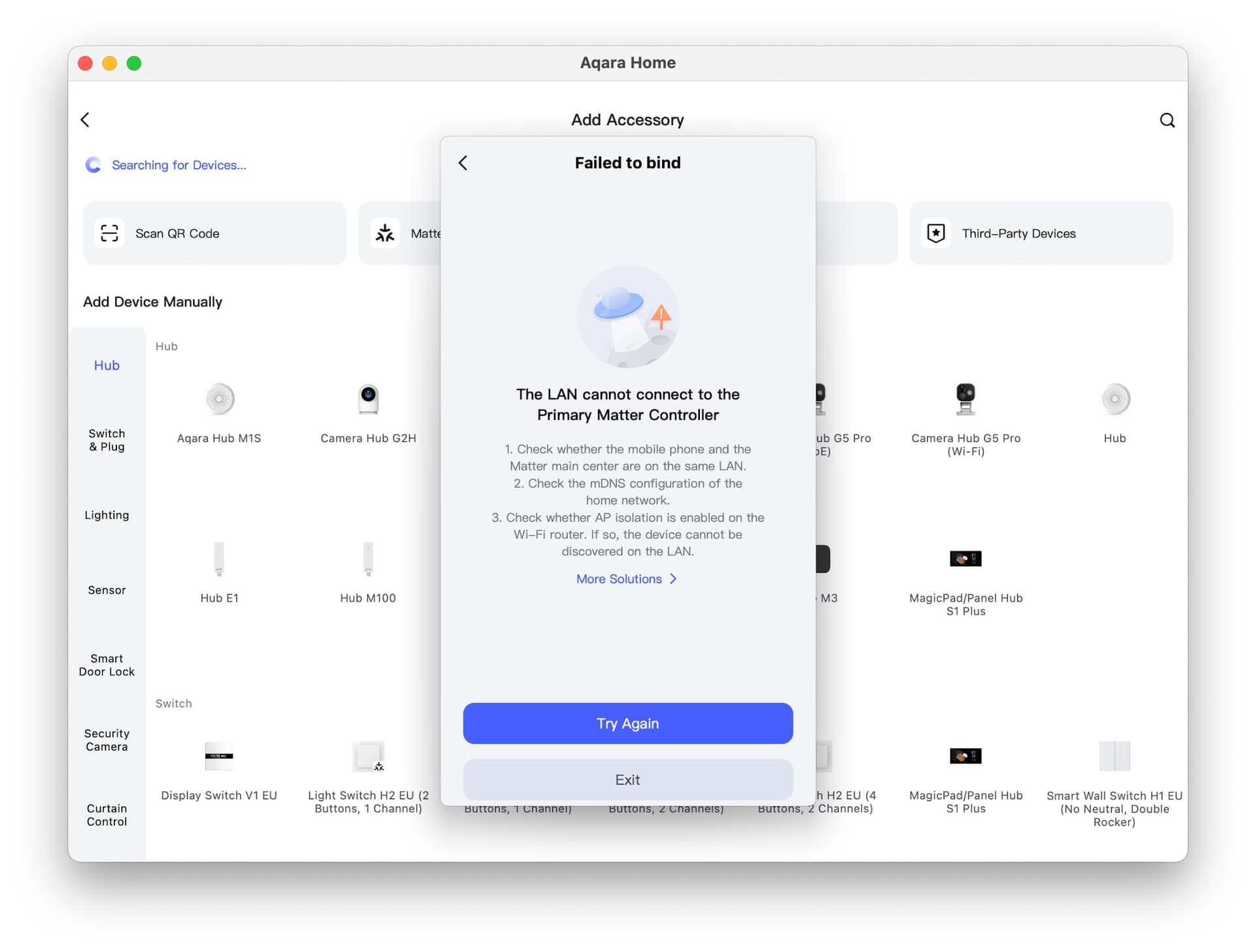

Thank you for your feedback.
Based on the snapshots you provided, it doesn’t appear to be a bug in iOS 18.4. Instead, it seems that your phone is unable to discover the Primary Matter Hub (M3) on the same local network.
Please make sure that your phone and the M3 hub are connected to the same Wi-Fi network, and check if features like AP Isolation or mDNS are disabled on your router, as they may prevent local discovery.
Let us know if the issue persists after checking these settings.
