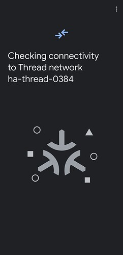

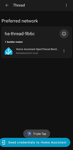

What I see is that in HA I have a different Thread network name than what Google Home sees. Why is that?

Looks like you have two Thread Border Routers that are creating separate networks. It should be possible to set it up in a way so both are part of the same network:
The documentation of the Thread integration has some information: Thread - Home Assistant
