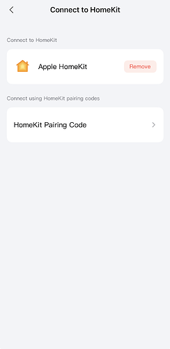

Many Options = Duplicate Devices
You can integrate Aqara Zigbee devices into Apple Home via the Matter Bridge function. The problem: Most Aqara hubs also bear the “Works with Apple Home” logo and can be integrated via the classic HomeKit method.
If you accidentally connect the hub via both methods (once via HomeKit and once via Matter), all connected sensors and switches will appear twice in the Apple Home App. This causes chaos in operation and with voice commands.
:mag: To avoid duplicates, you must choose one path. Currently, the classic HomeKit integration (without Matter) is usually the better choice for Aqara hubs, as Matter does not yet support all special functions that already work via the native HomeKit connection.

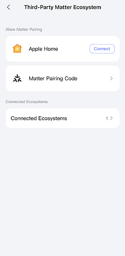

Connecting to Additional Systems (Multi-Admin)
  1. Generate Code: Go to the app with which you connected the device first (e.g., Aqara Home). Important: Do not use the sticker on the device for this second step.
  2. Activate Mode: Look in the device settings for an option like “Matter Pairing Code” (Aqara) or “Turn On Pairing Mode” (Apple).
  3. Copy Code: The app will now generate a new, digital QR code (or a numeric code). The code is usually in the format 0000-000-0000. When copying, ensure the format is correct (some apps require the hyphens, some do not).
  4. Second Pairing: Now open the second app (e.g., Alexa or Home Assistant) and scan this QR code (or paste the numeric code). Important: Pairing should be done immediately, as the generated code is time-limited (usually 15 minutes).
:spiral_notepad: For any subsequent ecosystem, can simply generate a new pairing code from any app where the device is already successfully connected. It does not have to be the original or first app to which the device was connected.

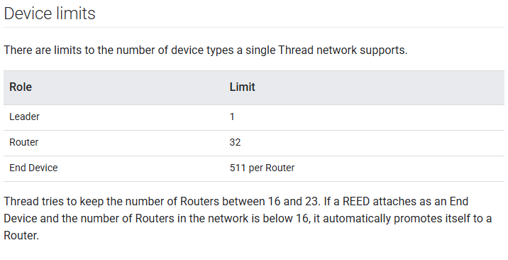

How many Thread networks should there be?
Matter is designed to form a single, large Thread network (“Single Mesh”) that covers your entire home. Multiple separate Thread networks are counterproductive: They form isolated wireless islands that do not build a common mesh. You thereby lose the advantage that every device increases the range for all others. Additionally, you lose other strengths of Thread, such as self-healing in case of failures. Only when all devices broadcast in the same network can they support each other and span a stable, house-wide network.
A Matter device can only be active in one thread network at a time for technical reasons. While in theory multiple Thread networks can exist side-by-side, with communication between the “islands” occurring via LAN/Wi-Fi, since the devices cannot broadcast directly to each other, the signals must forcedly take the detour via the Border Routers and the home network. This burdens the network unnecessarily and increases reaction time (latency).
Much more critical, however, is the reality: Communication often fails due to manufacturer software. A Border Router often stubbornly searches for new devices only in its own wireless network. If a device is in the other Thread network, it is simply not found (Discovery Error), even though a connection via LAN would theoretically be possible.
Starting with Thread 1.3, it is possible for multiple Border Routers (even from different manufacturers) to jointly form a single Thread network.

Viele Möglichkeiten = doppelte Geräte
Man kann Aqara Zigbee-Geräte über die Matter-Bridge-Funktion in Apple Home integrieren. Das Problem: Die meisten Aqara-Hubs tragen auch das “Works with Apple Home”-Logo und können über den klassischen HomeKit-Weg integriert werden.
Verbindet man den Hub versehentlich über beide Wege (einmal per HomeKit und einmal per Matter), erscheinen alle angeschlossenen Sensoren und Schalter doppelt in der Apple Home App. Das sorgt für Chaos in der Bedienung und bei Sprachbefehlen.
:mag: Um Duplikate zu vermeiden, muss man sich für einen Weg entscheiden. Aktuell ist die klassische HomeKit-Integration (ohne Matter) für Aqara-Hubs meist die bessere Wahl, da Matter noch nicht alle Spezialfunktionen unterstützt, die über die native HomeKit-Verbindung bereits funktionieren.

Wie viele Thread-Netzwerke dürfen es sein?
Matter ist darauf ausgelegt, ein einziges, großes Thread-Netzwerk (“Single Mesh”) zu bilden, das Ihr gesamtes Zuhause abdeckt. Mehrere getrennte Thread-Netzwerke sind kontraproduktiv: Sie bilden isolierte Funk-Inseln, die kein gemeinsames Mesh aufbauen. Sie verlieren dadurch den Vorteil, dass jedes Gerät die Reichweite für alle anderen erhöht. Zudem verlieren Sie weitere Stärken von Thread, wie die Selbstheilung bei Ausfällen. Nur wenn alle Geräte im selben Netz funken, können sie sich gegenseitig stützen und ein stabiles, hausweites Netz aufspannen.
Ein Gerät kann technisch nur in einem Thread-Netzwerk gleichzeitig aktiv sein kann. Zwar können in der Theorie mehrere Thread-Netze nebeneinander existieren, wobei die Kommunikation zwischen den “Inseln” über das LAN/WLAN erfolgt. Da die Geräte jedoch nicht direkt untereinander funken können, müssen die Signale zwangsweise den Umweg über die Border Router und das Heimnetzwerk nehmen. Das belastet das Netzwerk unnötig und erhöht die Reaktionszeit (Latenz).

@siobhanellis in your blog you write that a maximum of 64 routers are possible, but I have found other sources stating that the limit is 32 active routers per network.
Source: Node Roles and Types  |  OpenThread
Good updates, it’s a Jungle for sure and those in charge of both those organizations have little to no interest in communicating with the public.
Thanks for pointing out my error. I actually knew it was 32, so don’t know why I typed 64. Maybe I found out after I initially typed that and never fixed my initial write up.
Anyway, I fixed my blog post.
