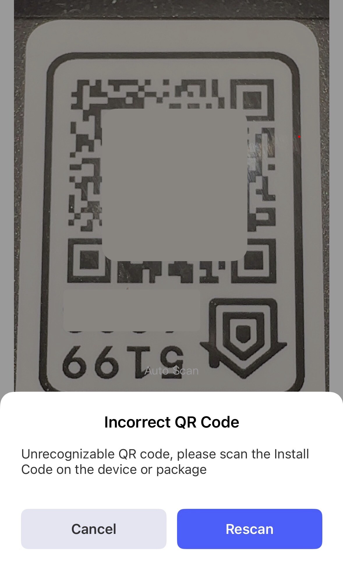

Lately, I’ve often seen the same problem discussed: users try to add a smart lock to the Aqara Home app, scan the QR code, and get the error “QR code not supported.”
Guys, let’s figure out why this happens and how to add the lock CORRECTLY.
The main point: you DO NOT NEED to scan the QR code from the box in the Aqara Home app to add the lock!
The initial setup for U100, A100, D100, N100 locks is exclusively via Bluetooth. An Aqara code is simply not provided for them.
So, what is this code then?
The package includes a code for Apple HomeKit (HK). You can use it in the Home app on your iPhone, but not in Aqara Home.
If you try to scan the HK code in Aqara Home, you will get the “not supported” error because the app doesn’t recognize it without the appropriate request from the HK system.
