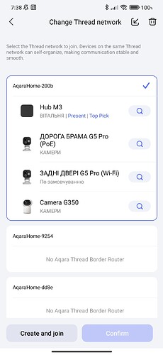

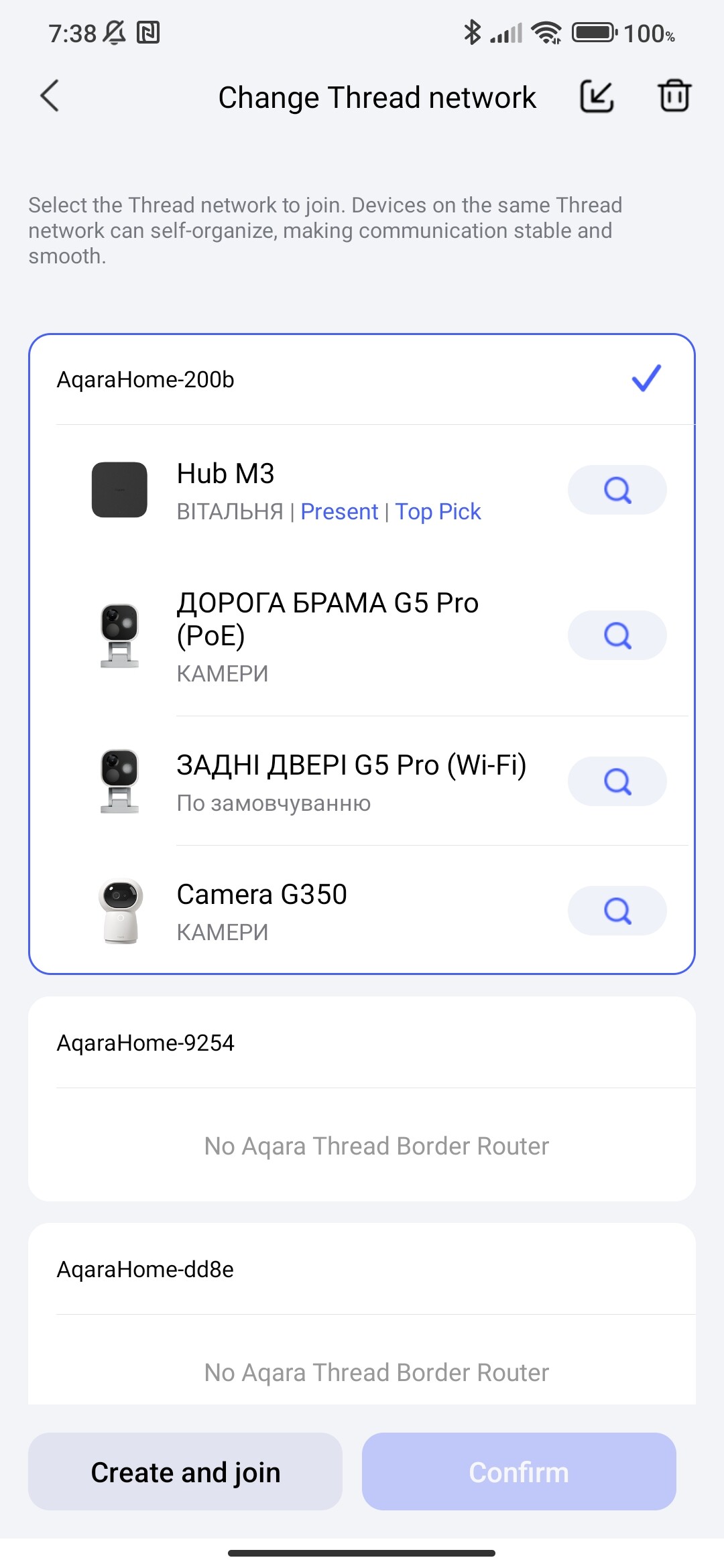

Another question, did you delete the Tried network in the M3 gateway and create a new one? It helped me.
