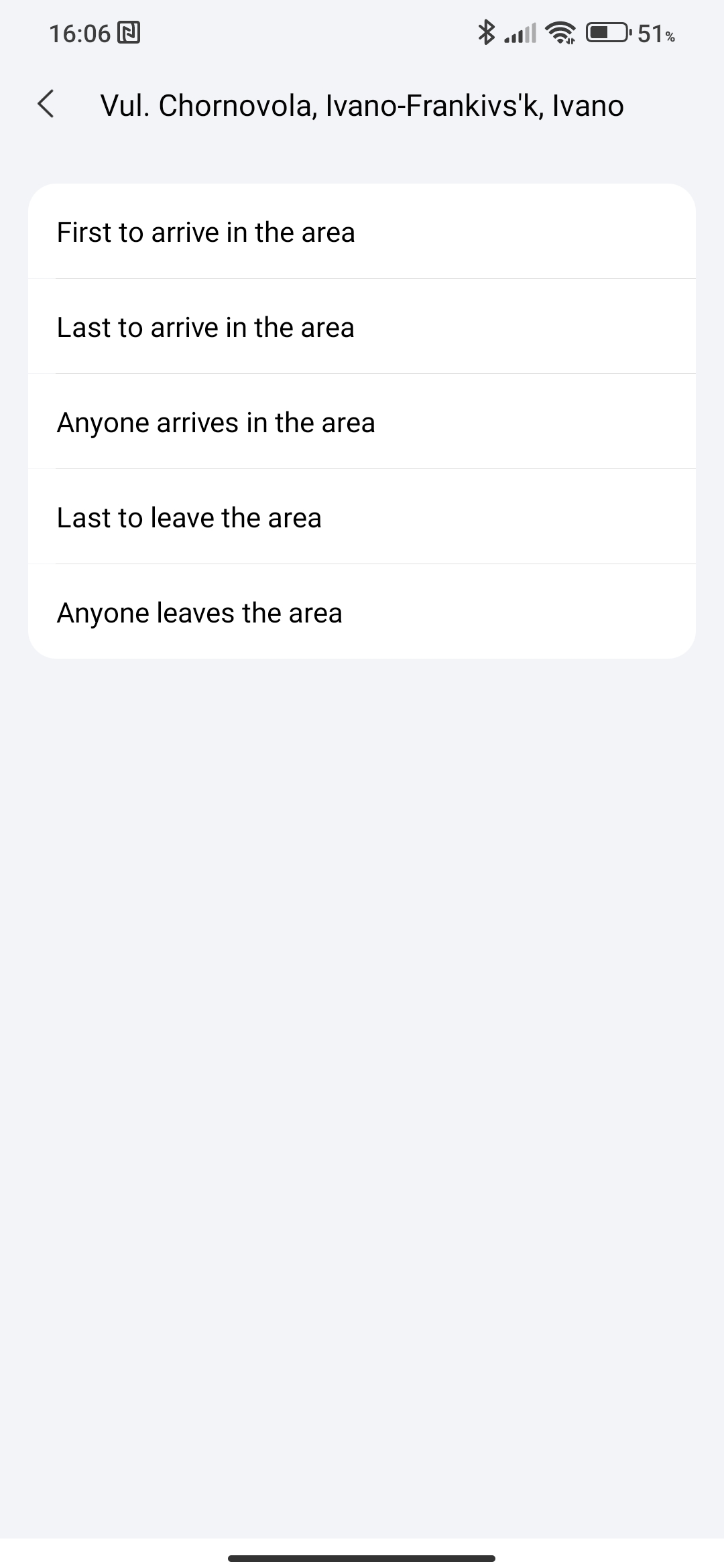

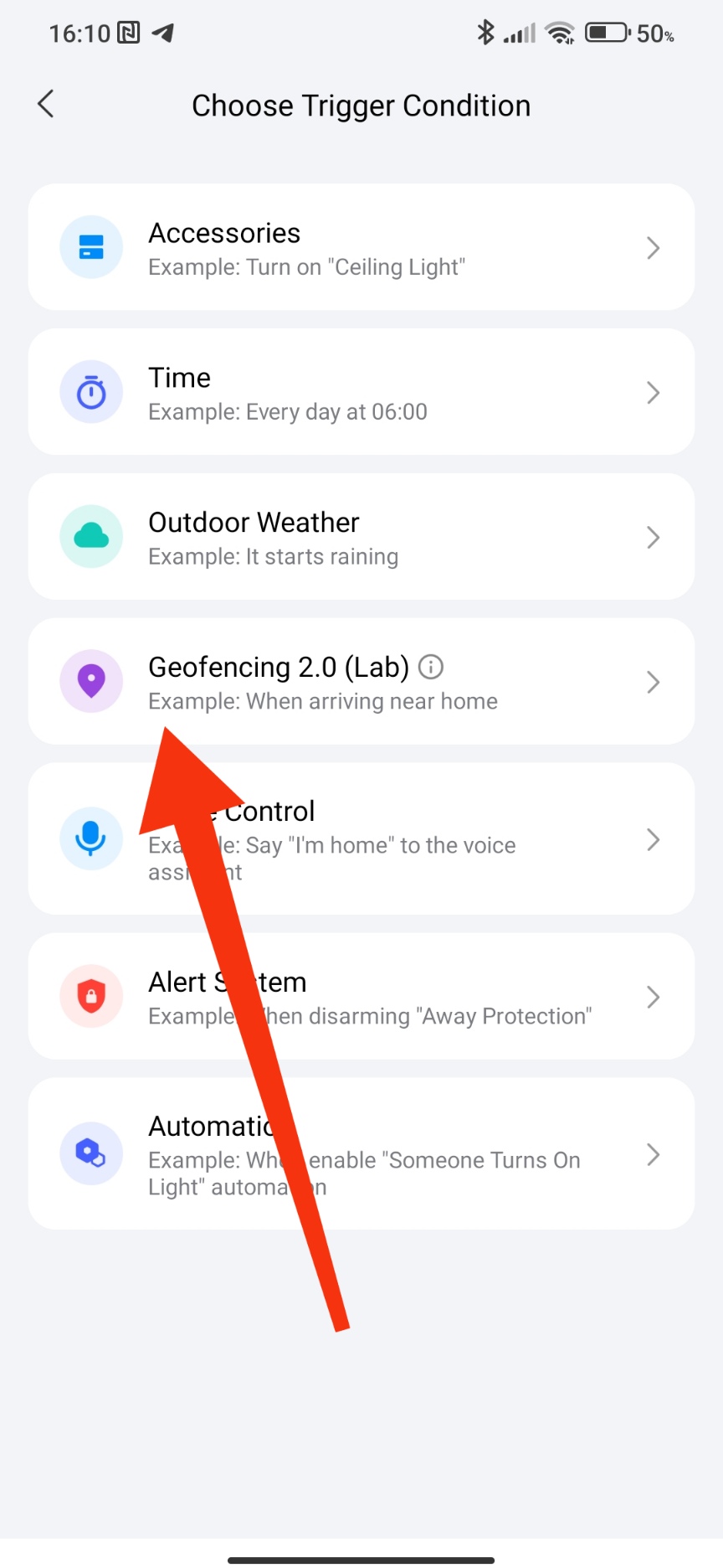

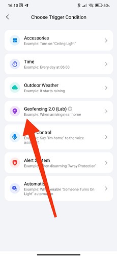

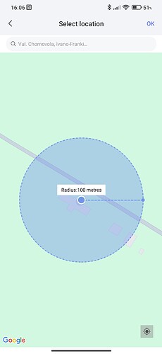

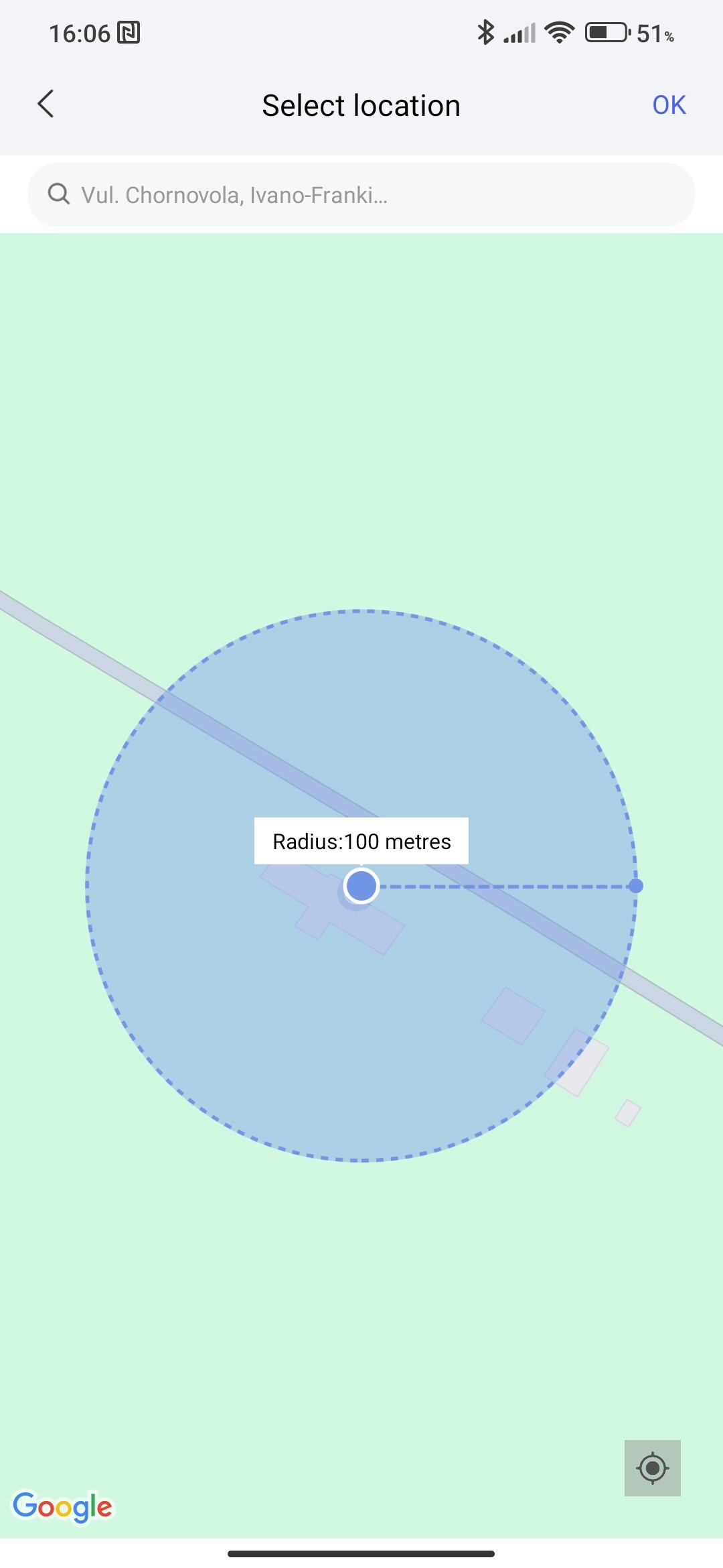

Hi, you can use geozone to close the blinds. The radius starts from 100 meters, what you need.

Automation 2.0?Automation 2.0 Tutorial Collection - Lesson 1 report
Give a screenshot of the automation.
