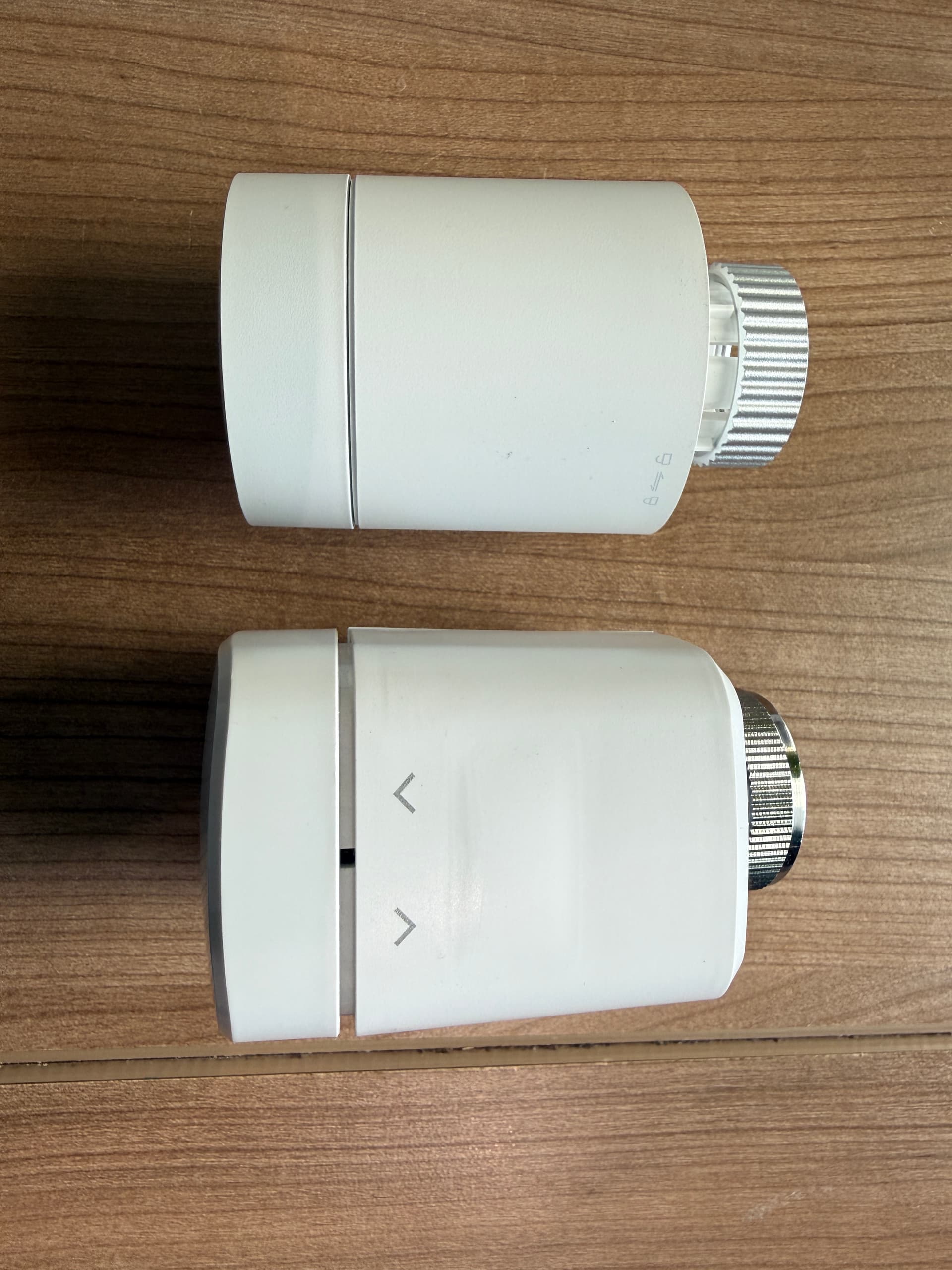

I did that too and now the W600 does what it should. My house is full of EVE Thermos, but I really wanted to test and compare the W600 with the EVE Thermo.
So, I use the Aqara W600 and the EVE Thermo in Matter over Thread mode. Both devices are paired to Home Assistant and Apple Home. All my automations are in Home Assistant, while I use Apple Home as my Frontend.
I have 7 Apple Thread Border Routers and 73 Matter over Thread devices.
  • Aqara W600 and EVE Thermo have nearly the same size, overall the W600 is a bit smaller
  • Aqara W600 and EVE Thermo both use AA batteries
  • Aqara W600 seems to be a bit slower than the EVE Thermo in processing the commands from my Matter fabrics, but it doesn’t seem to eat the batteries as fast, as my EVE Thermo does
  • EVE Thermo is significantly louder than Aqara W600, when adjusting the temperature
  • Aqara W600 has a much more informative display
  • EVE Thermo can be used with the EVE app without having a hub
  • Via the EVE app we can control some Matter custom cluster features (calibration, screen rotation, temperature offset, valve protection, temperature unit, child lock and transmit power)
  • EVE Thermo can be bound to an EVE Thermo Control (temperature sensor) via a Matter binding, Aqara W600 doesn’t have this capability
  • EVE Thermo uses Matter DCL to give us new updates. I really hope Aqara is working on this Matter OTA update feature. I also have a this thread running here in the forum.

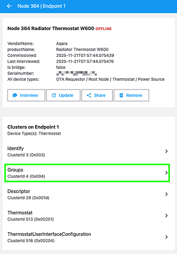

Her you see two screenshots from the clusters on Endpoint 1 of both devices:
The EVE Thermo has (as already said) the Binding cluster, that I really miss on the Aqara W600. Therefore the Aqara W600 has a Groups cluster. What can we do with this and how can we make use of it?
