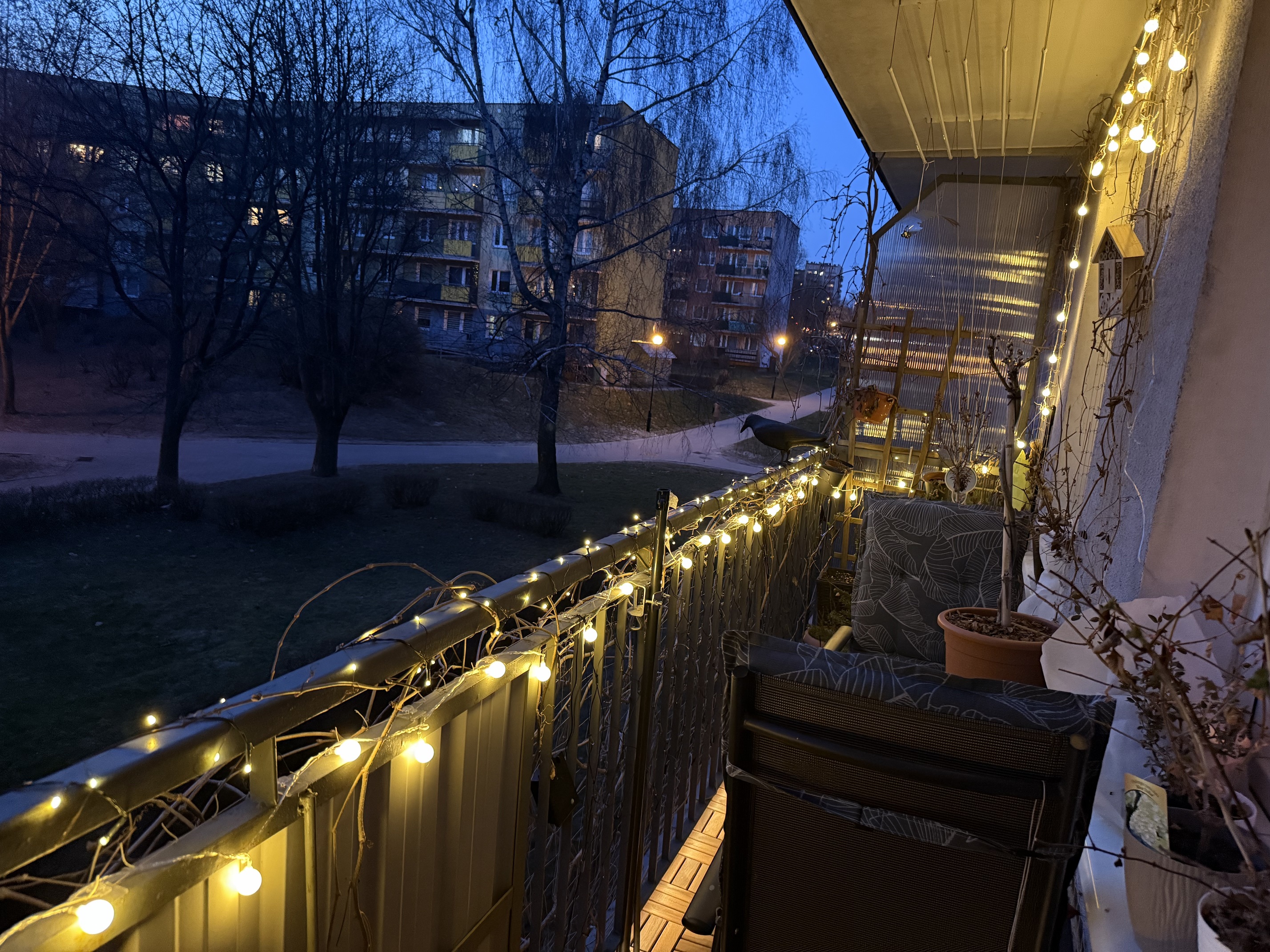

Now, to make this more complete looking and more convenient. I’ve also added some frosted string lights. My complete project looks like this:
I can’t wait until it becomes greener :grin: We have a lot of plants and we have vines on the railing, and with the Aqara lights (and the string lights) it will look vet impressive and rustic in a few weeks.

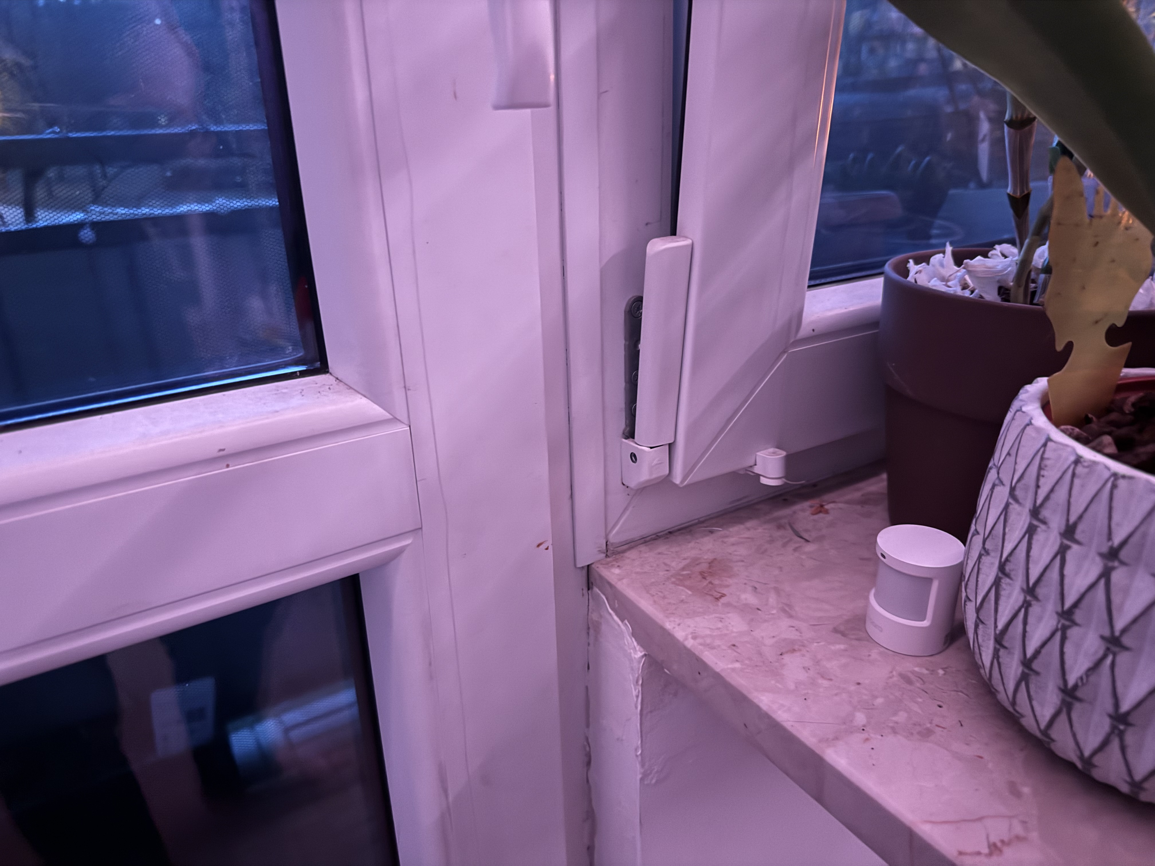

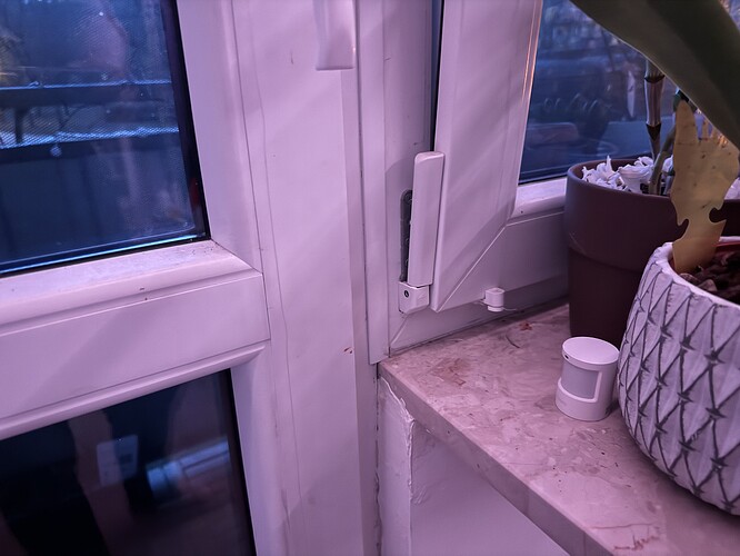

What about the convenience, you might ask? The string lights are plugged via an Aqara Smart Plug (installed inside, I’ve run the cable through the window like the one for the LED strip).

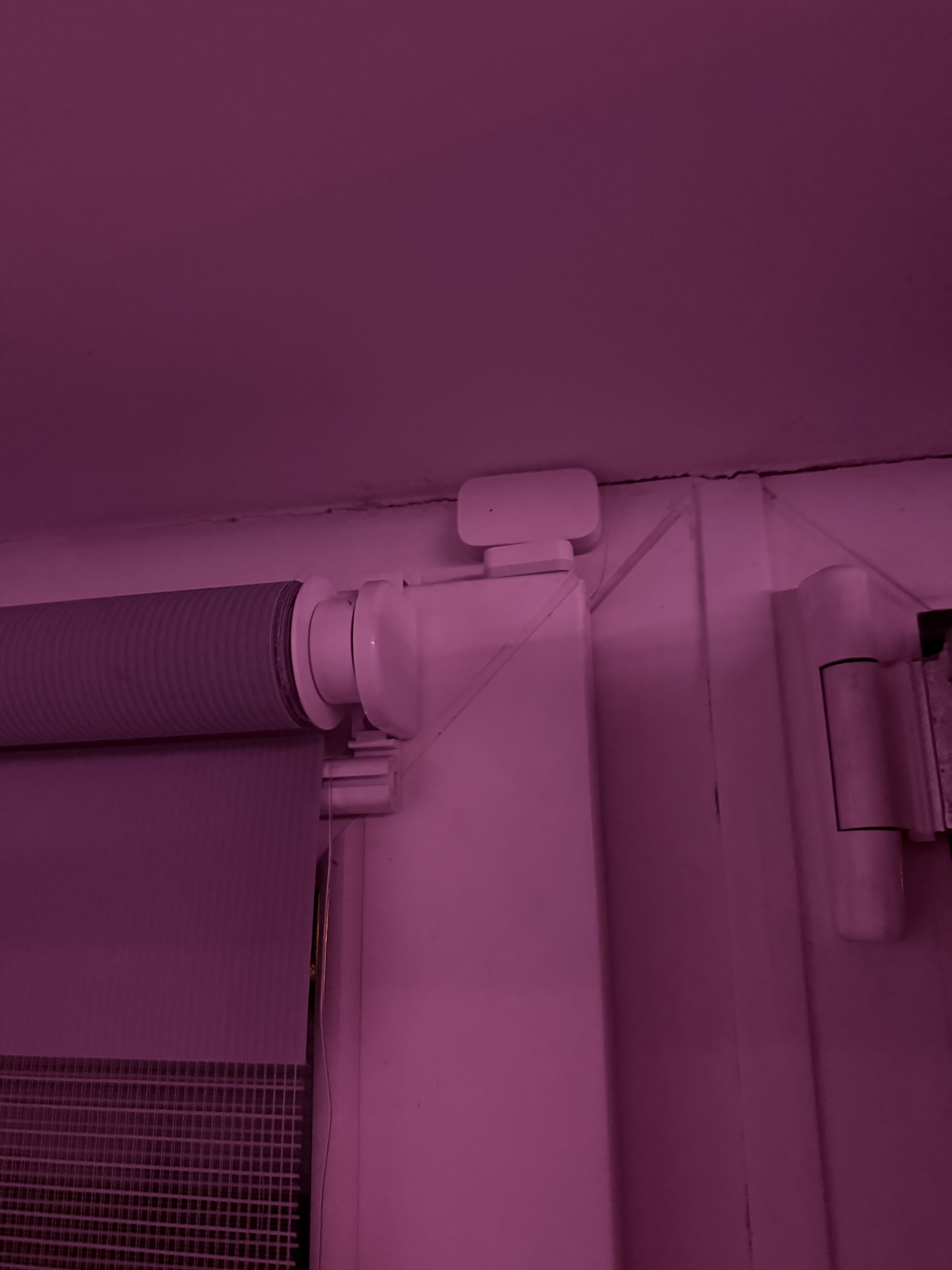

I’ve also installed an Aqara Door and Window Sensor and Aqara Motion and Light Sensor P2 to fully automate the lights when we open the door.

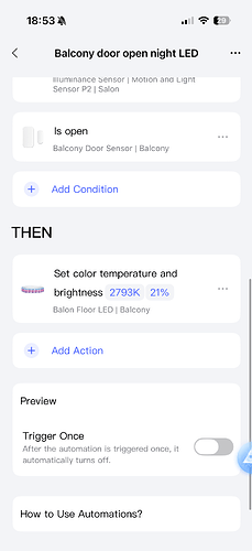

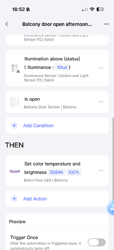

Now, with a few handy automations, my lights are only turned on when it’s dark, and when the LED strip dims as it gets darker. I didn’t want blinding lights at 11PM on my romantic balcony, so based on the light intensity sensed by the P2, I adjust the brightness of the strip.

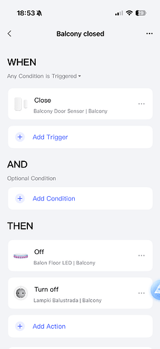

And the lights automatically turn on when we close the balcony. Which basically means we don’t use it, as we can only close it from the inside, there is no handle on the outside.

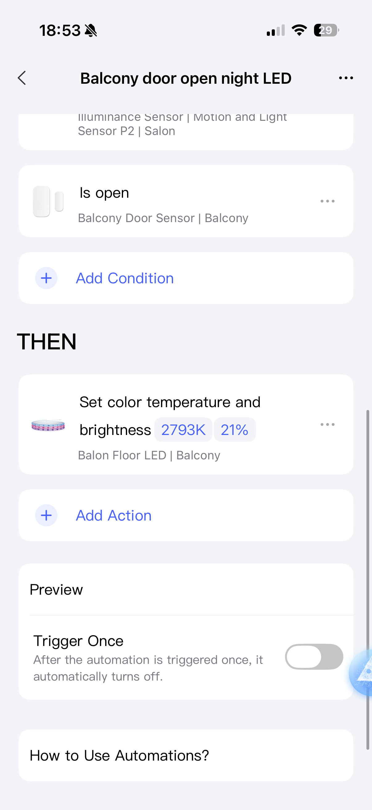

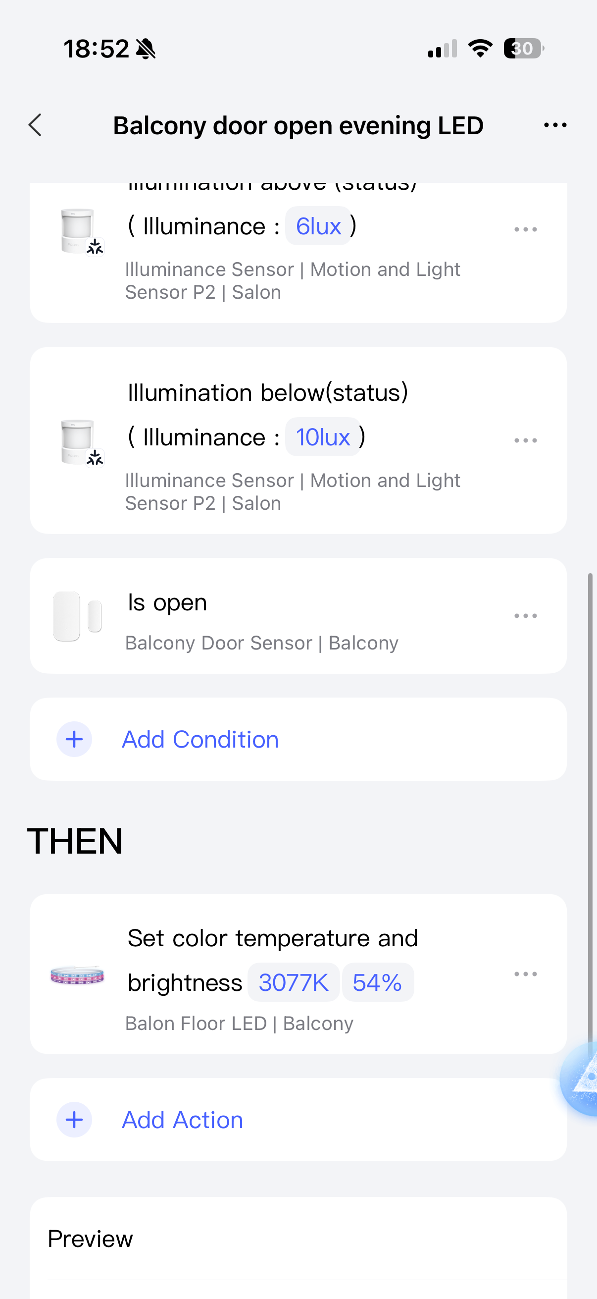

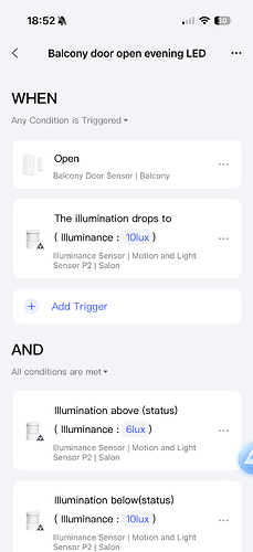

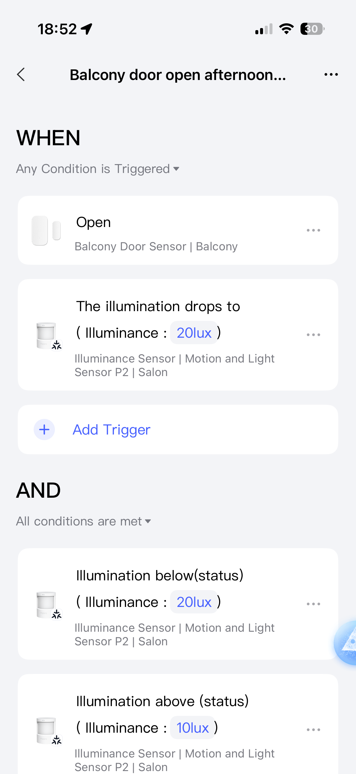

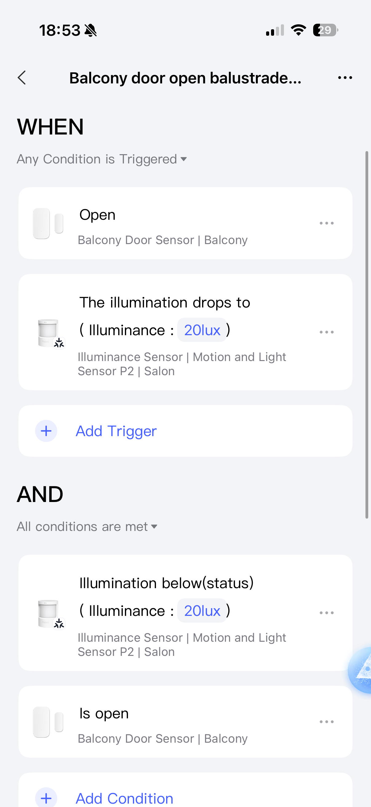

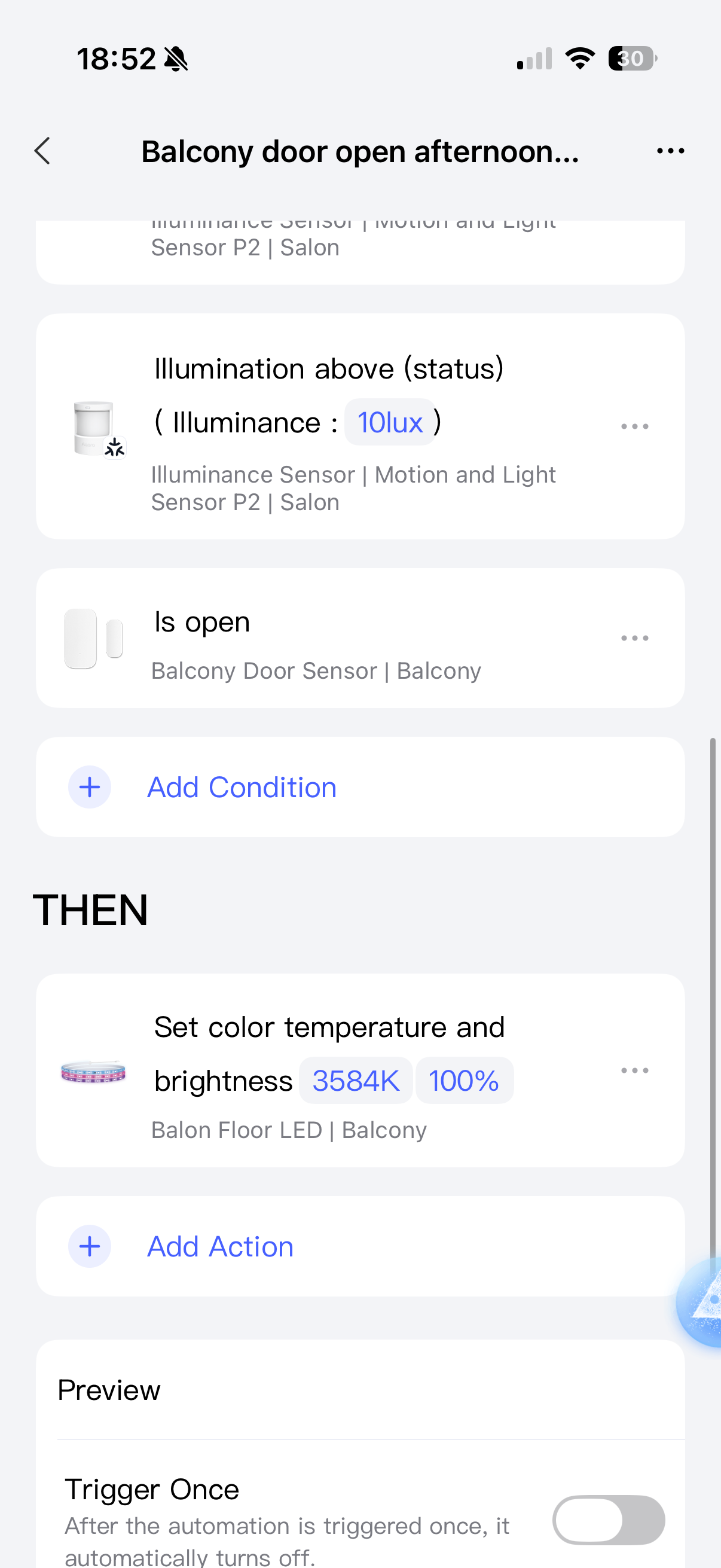

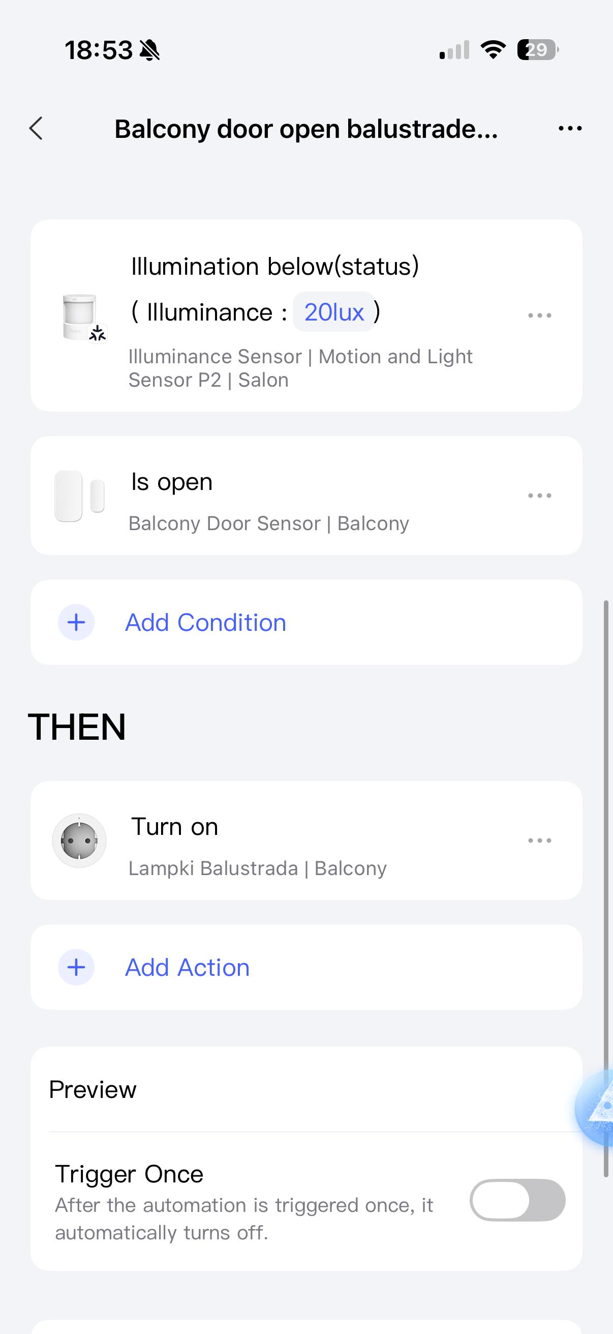

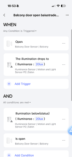

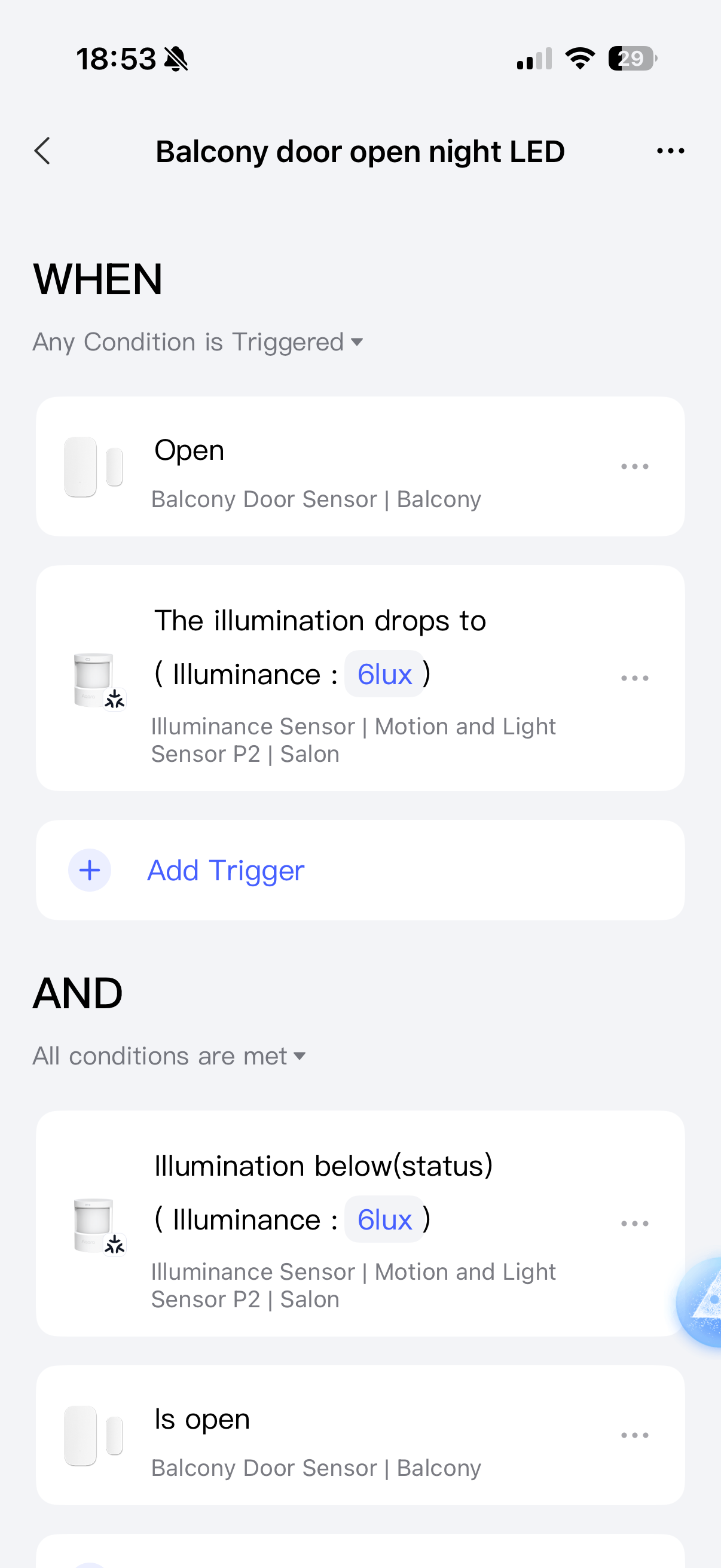

The automations
Note: those automations have “is open”, which looks like a duplicate, but one of the trigger is “the illumination drops to”.
“Is open” makes the automation only run (and correct the LED brightness) when the balcony is open. So it doesn’t run when it gets darker and the balcony is closed.
The automations will automatically adjust brightness when you open the door, and they will also adjust brightness when you leave the door open when it gets darker.
Balcony door open afternoon LED
Balcony door open evening LED
Balcony door open night LED
Balcony closed
Balcony door open balustrade lights
