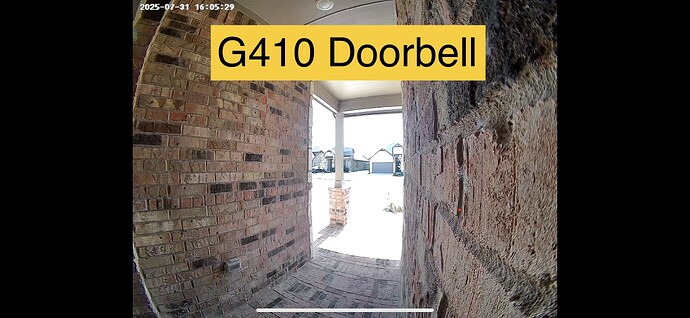

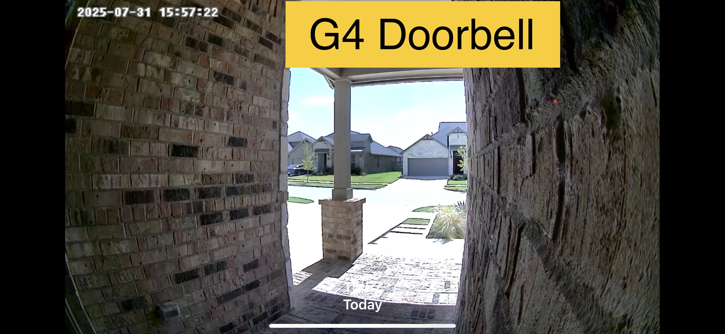

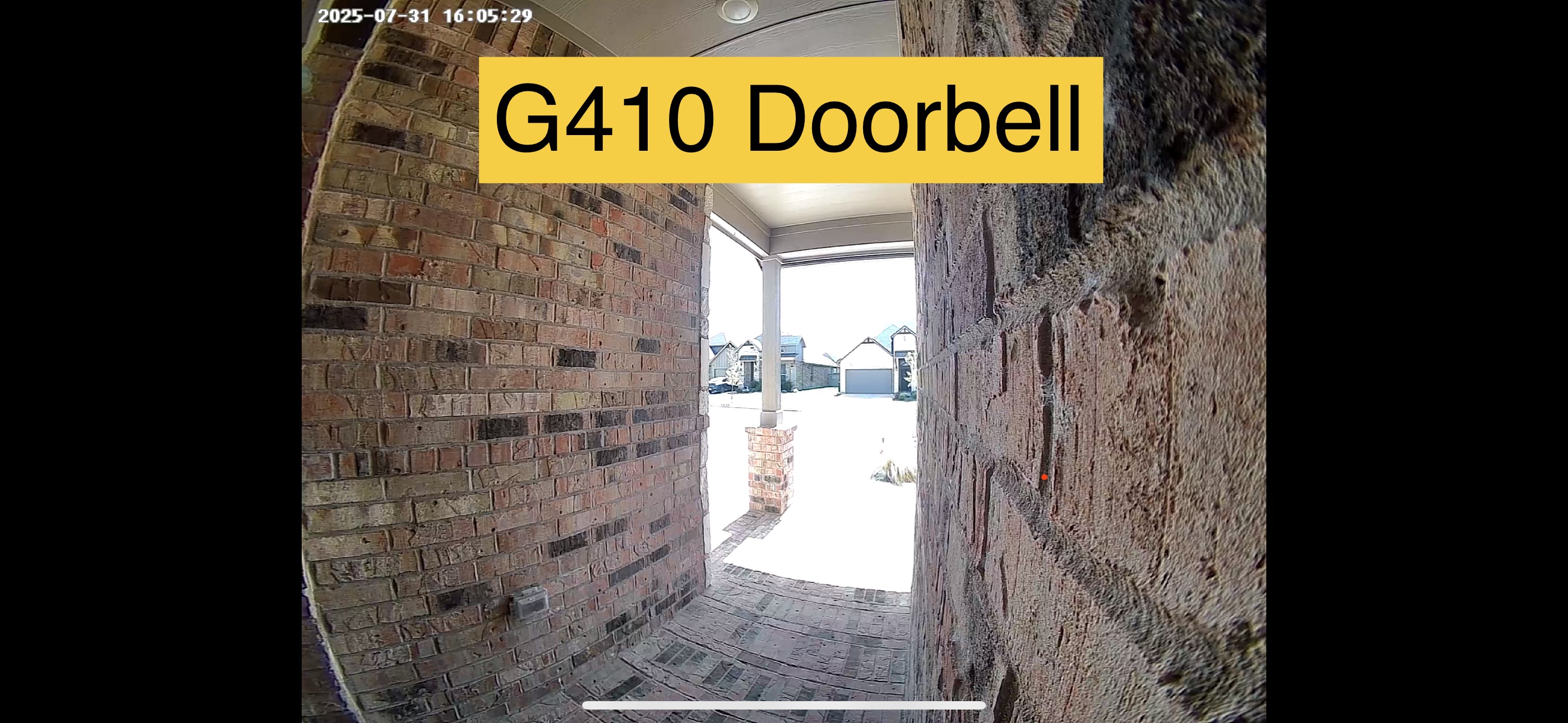

Has anyone had issues with the new G410 Doorbell video being overexposed? I’ve tried everything possible and have just reinstalled my G4 because the video brightness is better balanced even though it’s less quality.

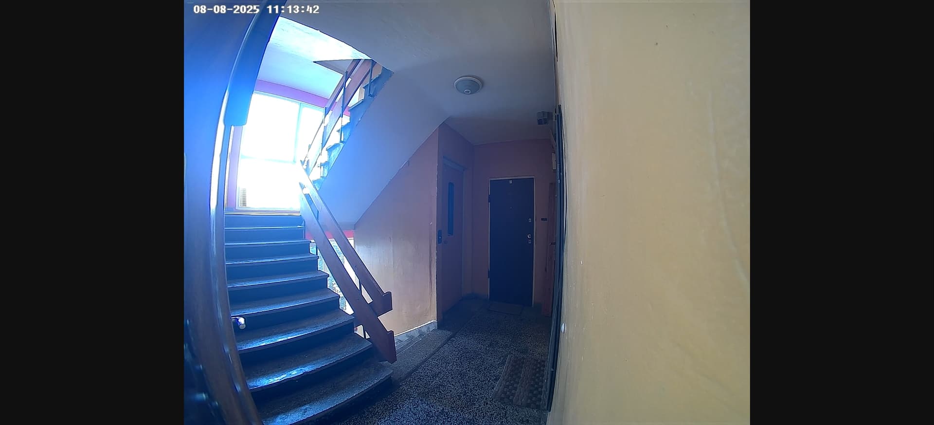

today installed my G410 and replaced the G4 and thought the same thing - bright areas are very overexposured on G410 than they were on G4

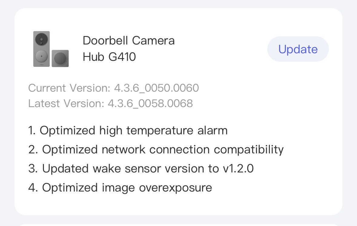

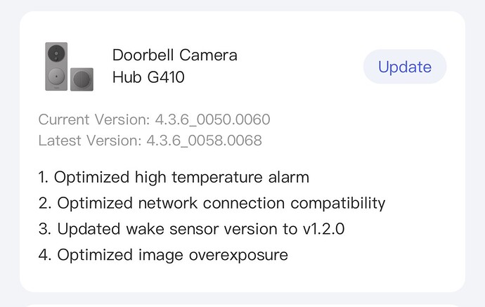

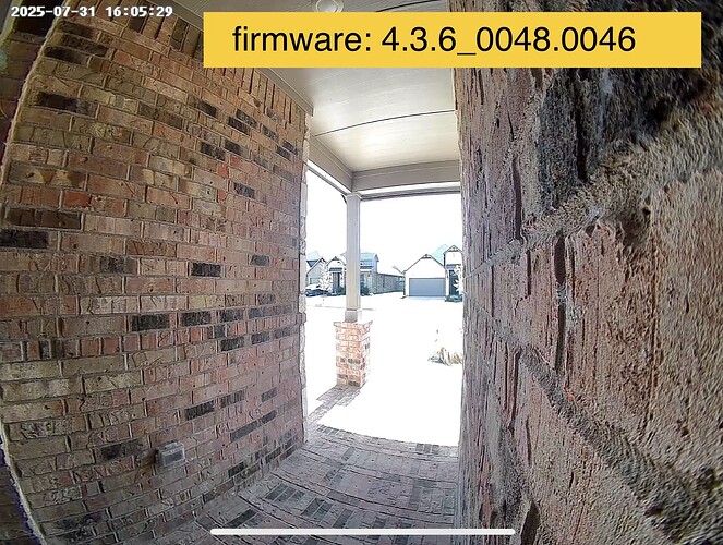

Today a new firmware came out and this problem should be solved, install the latest update. Can you share the results after the update.

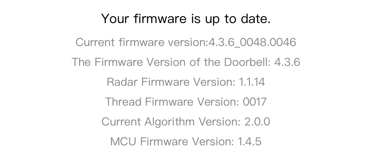

Hey @Raman.V - I just gave it a try by unplugging my G4 and put my G410 back up, but the app is saying firmware is up to date for a version that’s even older than your picture.
The firmware does not arrive to everyone at once, usually they are rolled out gradually, you need to wait until it is available for you.

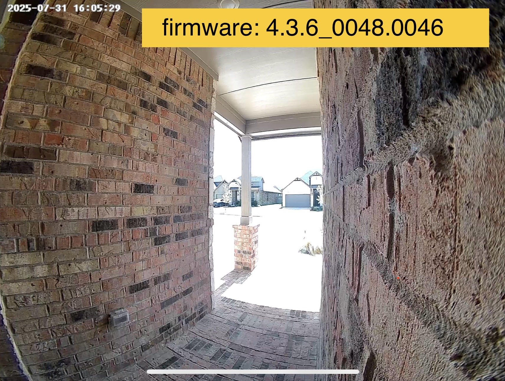

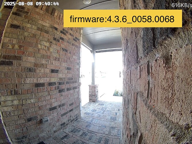

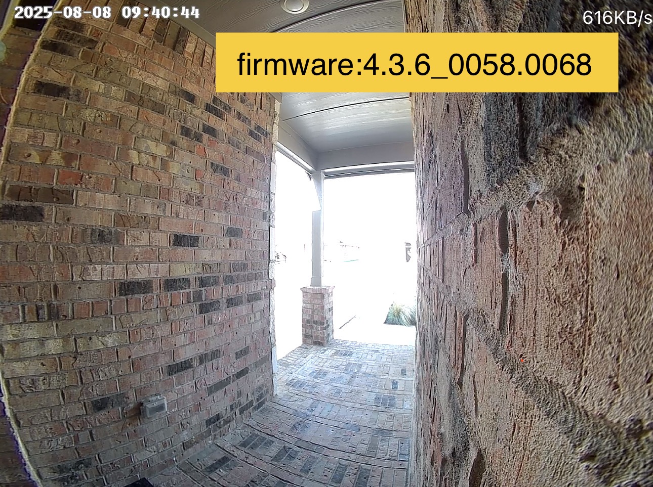

Finally got the latest firmware for my G410 and installed it.
I don’t see much improvement with the bright areas overexposure.
Anyone with improvements for this issue?
@AqaraOfficial, I finally got the latest firmware, and if anything, the over exposure is WORSE.

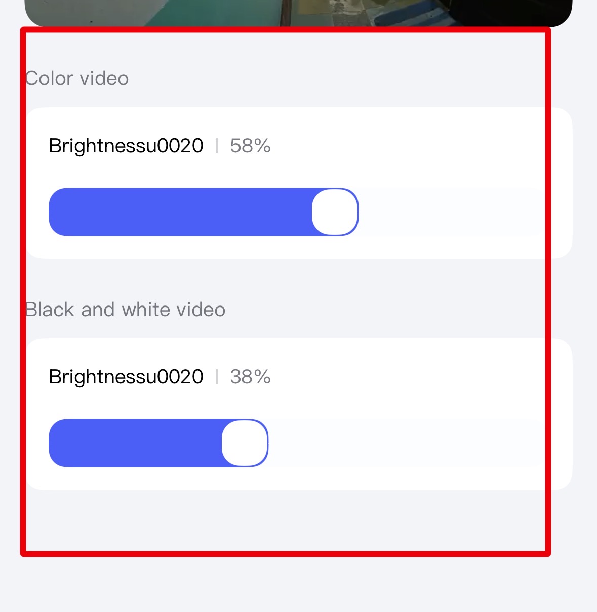

Hello @jrzap
Now you can correct this in the new firmware, if you haven’t received it yet, you need to wait until the update comes to Aqara home

Maybe you can help me:
Where do I find the video settings? Can’t seem to find them.
