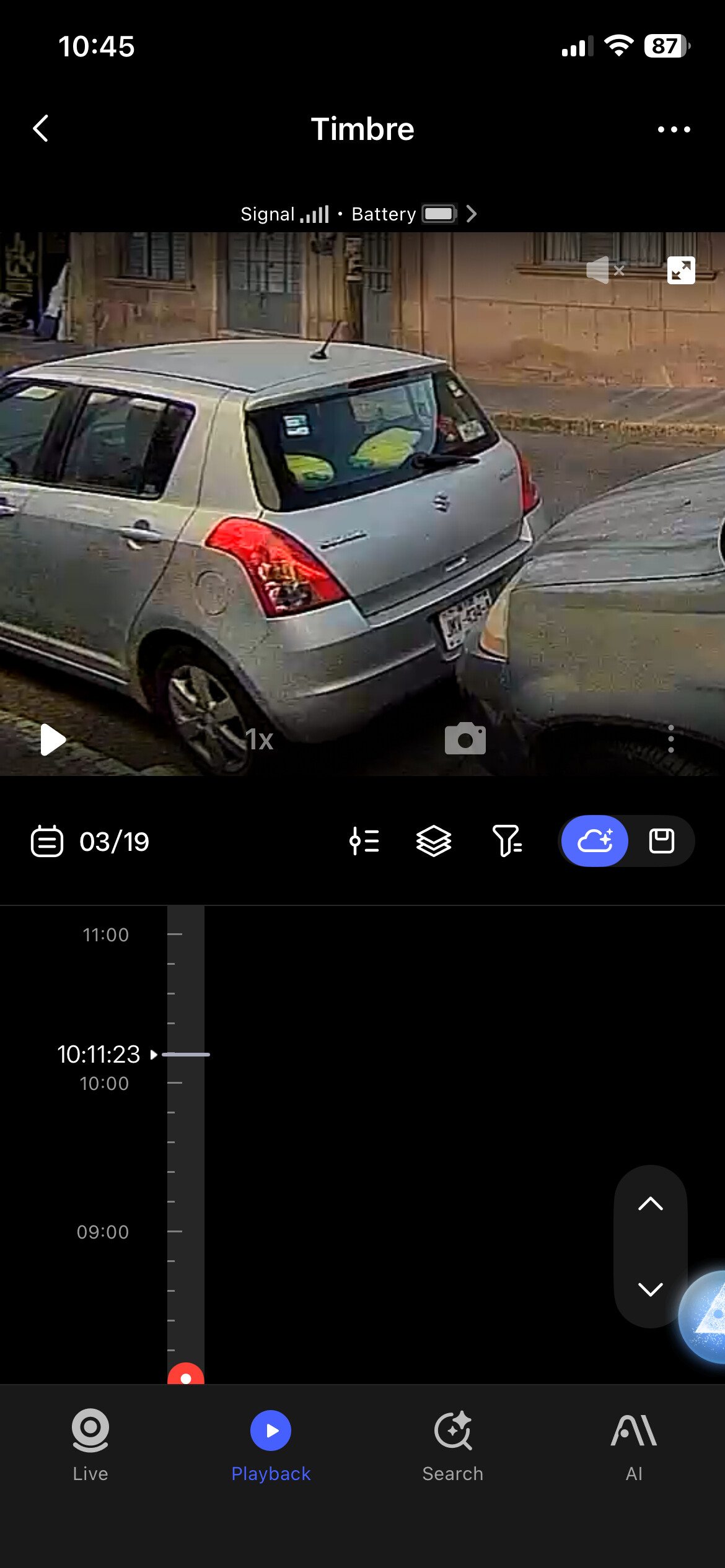

I have been using the G410 and from 8am-11am

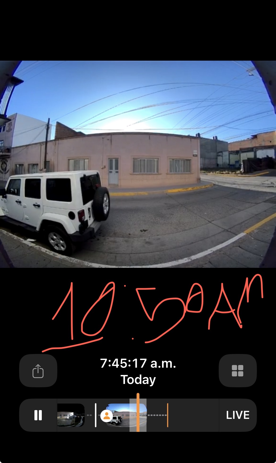

the video stream loses total connection.I can still get the notifications and sound through my homepod mini but i can’t see who’s at the door since the video just keeps losing and loading (both on apple home and Aqara app) around 11am the connections comes back and you can see there’s a gap where the G410 camera didn’t record anything from that timeframe.
the reason it’s because around that time the sun hits directly the device as seen in the pictures, Aqara support was of no help, I’ve seen this on other users and since i can’t return the item (it was bought through a third party seller) I wish I could solve it myself or at least make Aqara solve it with a firmware update

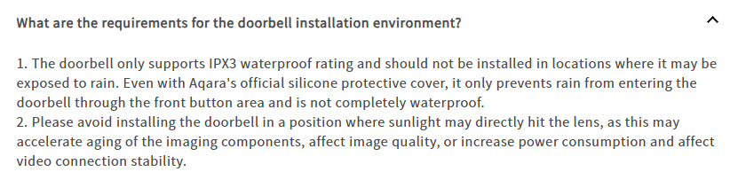

Aqara seems to be aware of these limitations and points them out in the FAQ:

To truly get this issue under control, the best solution is usually an installation location that protects the G410 from both rain and direct sun. A small canopy or setting it slightly deeper into a wall niche is often enough to keep the lens in the shade.
