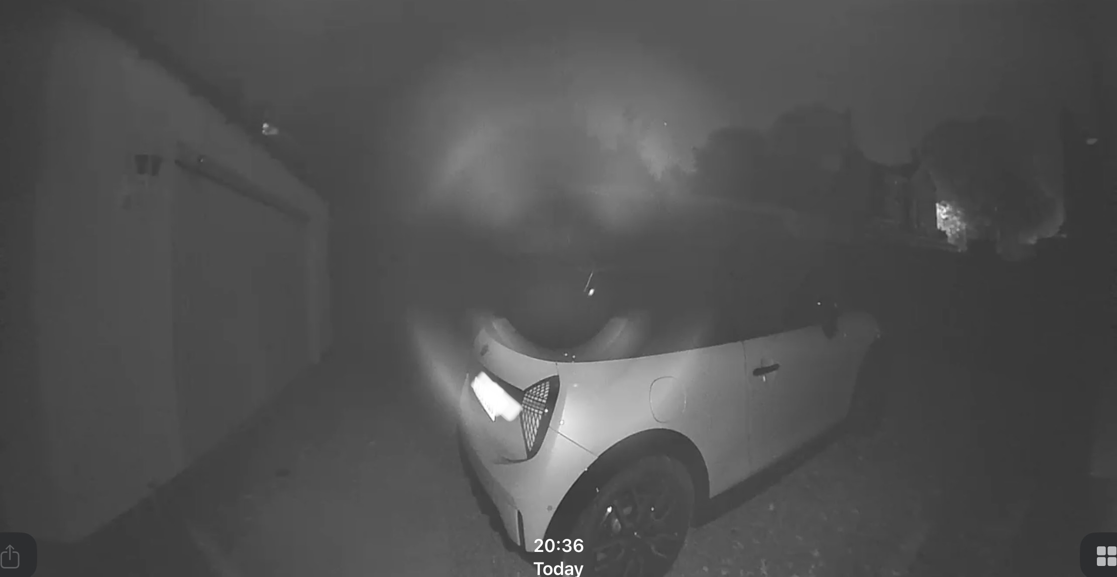

Hi, can someone advise why my G410 night vision video is really bad?
I have this central circular lens issue like the camera is causing feedback on the video.
Is it a setting issue, I’ve tried all kind of video setting changes.
Moved from battery to now using full power supply 24v and still the same.
Thanks
Friend, please provide another night vision picture that contanted no car in front of the doorbell for me to confirm the issue.
I have the same problems.
It’s the same without the car there.
You can see someone else has same issue.
Hope it’s software related and not hardware?
