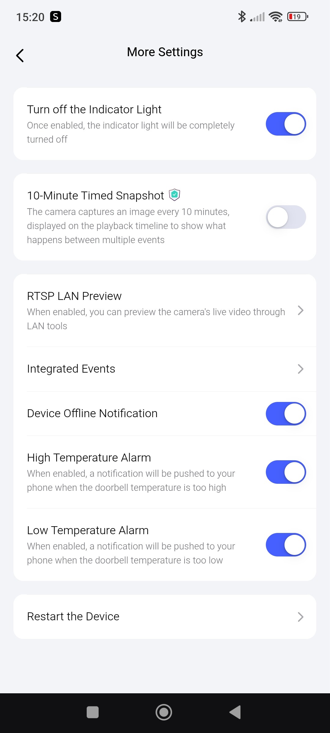

I switched to the G410 from Ring because I was sick of paying a mandatory subscription fee to access videos. My G410 is battery powered and has the supplied card in it which is mostly empty. The Aqara has not recorded anything since early June 26. The doorbell does work. Can anyone point to some reasons why this device doesn’t seem to be working for me?
Just adding, I have enabled the correct settings, there is a Cloud log showing a list of recent events, but the Local log is “unavailable”. That suggests to me that it is disconnected from the network. On following up on that, I see it’s connected to my router, and has recent activity (seen on router log).
My G410 is powered, has a SD card but I have enabled the recording writing to my NAS.
This is functional as expected. Not sure but I think this has something to do with using your G410 on battery power only
Thanks. Nah, don’t think it’s that as the documentation explicitly says that it’s possible on battery, indeed, the card has recordings from the first few weeks after I installed it. Batteries have been replaced as well. Do Aqara monitor these forums?
See my earlier post about failure to record to SD card.
My G410 (external power source) failed to recognise the SD card after a power cut - stating that the card was not present. I unplugged the power supply, waited 30 seconds and plugged it back in. Recording to SD card resumed shortly thereafter. Maybe you need to remove all the batteries and reinsert them.
For other failures to record, try restarting the device from the app
