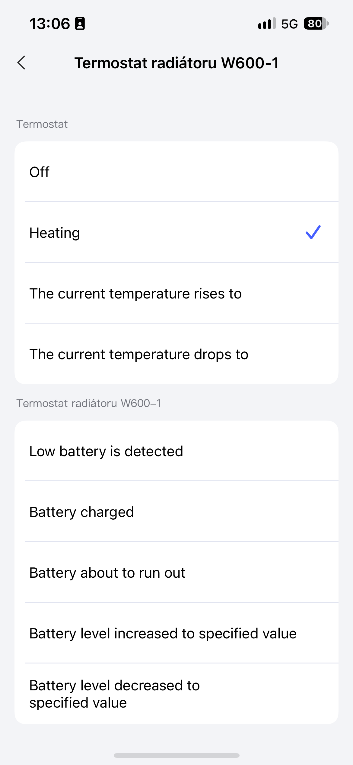

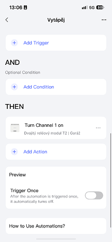

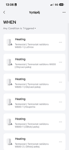

But main problem is the T2 relay for pump. It needs to be turn on only when thermostatic valves are open / wants to heat. For that I set up in Aqara App automation. I set up WHEN - all the valves, condition ANY and Heating is on - this should switch on the T2 relay.

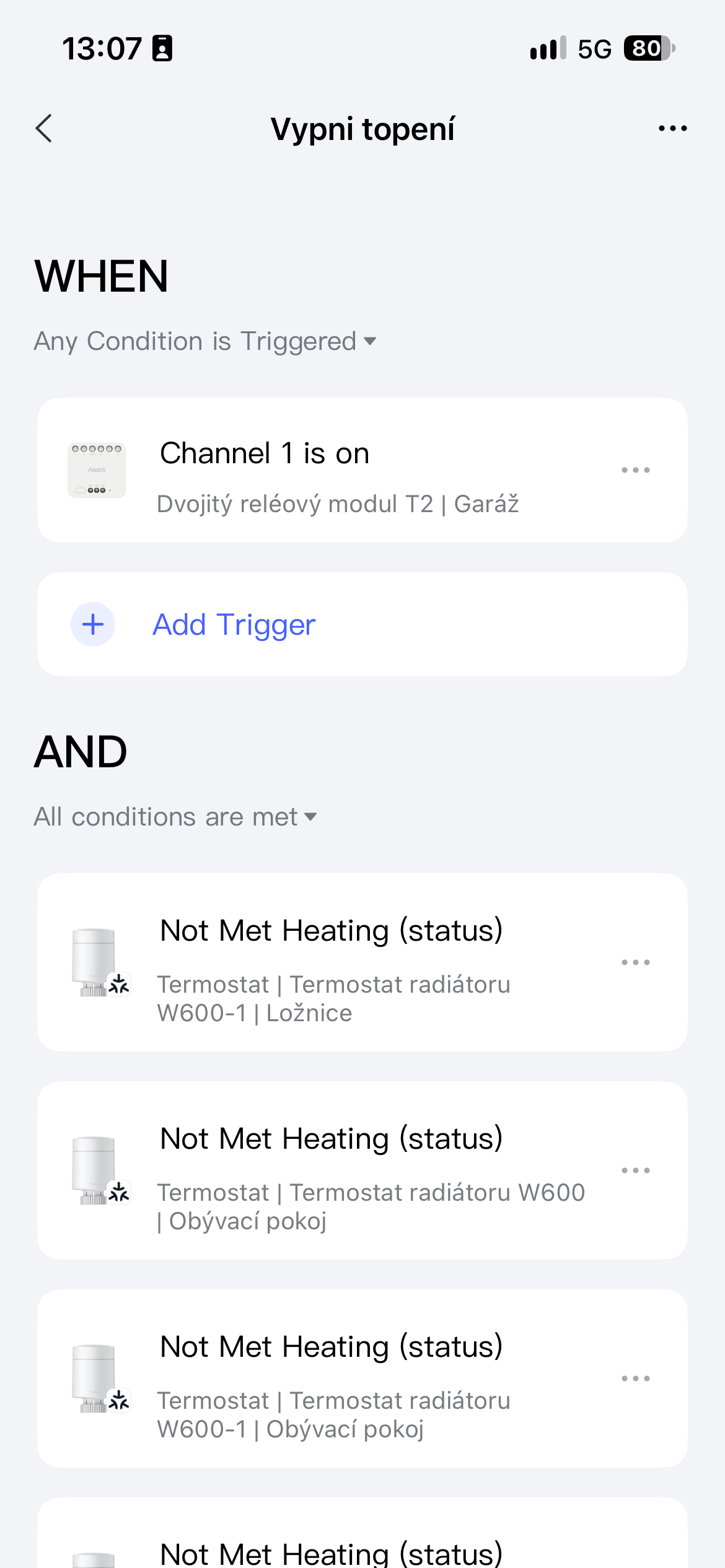

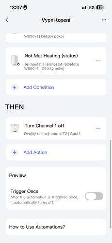

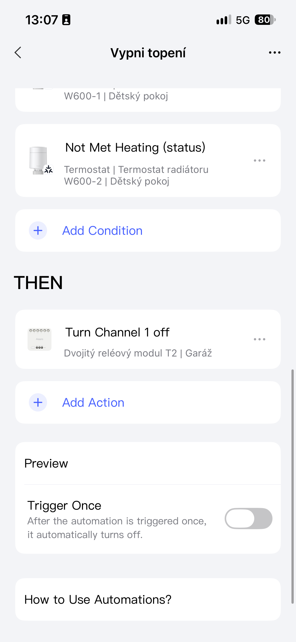

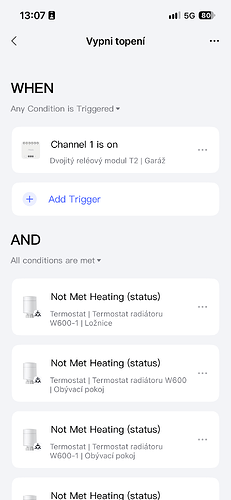

And for switch off I wanted to use WHEN the T2 relay is on and condition ANY of the valves do not need to heat to switch off the T2.

The problem may be in the switching off logic.
The trigger “relay is on” happens probably exactly once, which is when the heating switches on. And then at least one heating from the “and” condition is on (otherwise the relay would be off) → the condition is checked once, the end AND fails, the relay stays on.
I see two options:
  • you make the “heating turns off” a trigger and let it trigger on any of the valves. Then you leave the AND section as it is.
  • you make the trigger time based, i.e. check every 5 minutes if any thermostat is still calling for heat (i.e. you keep the AND section as is)

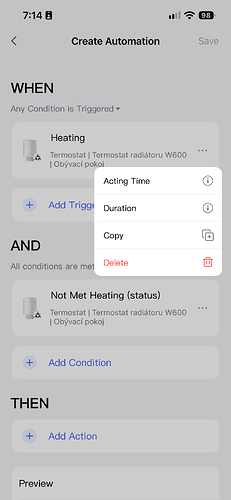

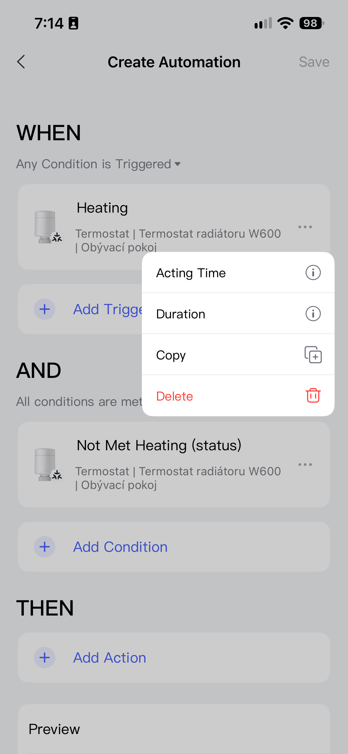

I haven’t find the option like a “repeater” (every 5 min or something). Preparing dozens of the same automations with different time is not a good option.
Second possibility would be add to the condition not only “Any” or “sequence” but also “All” (like in the second part).
Problem here is that maybe there is no such thing as main thread where you can create variables / logic blocks and this thread runs repeatedly all the time. Because if the condition is run through only once I’m not able to prepare automation like this.

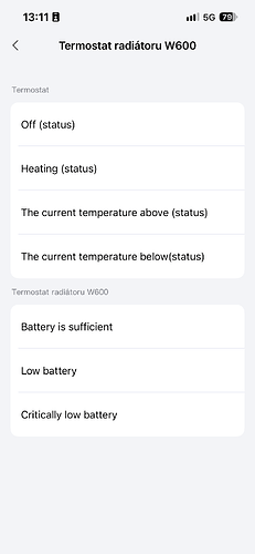

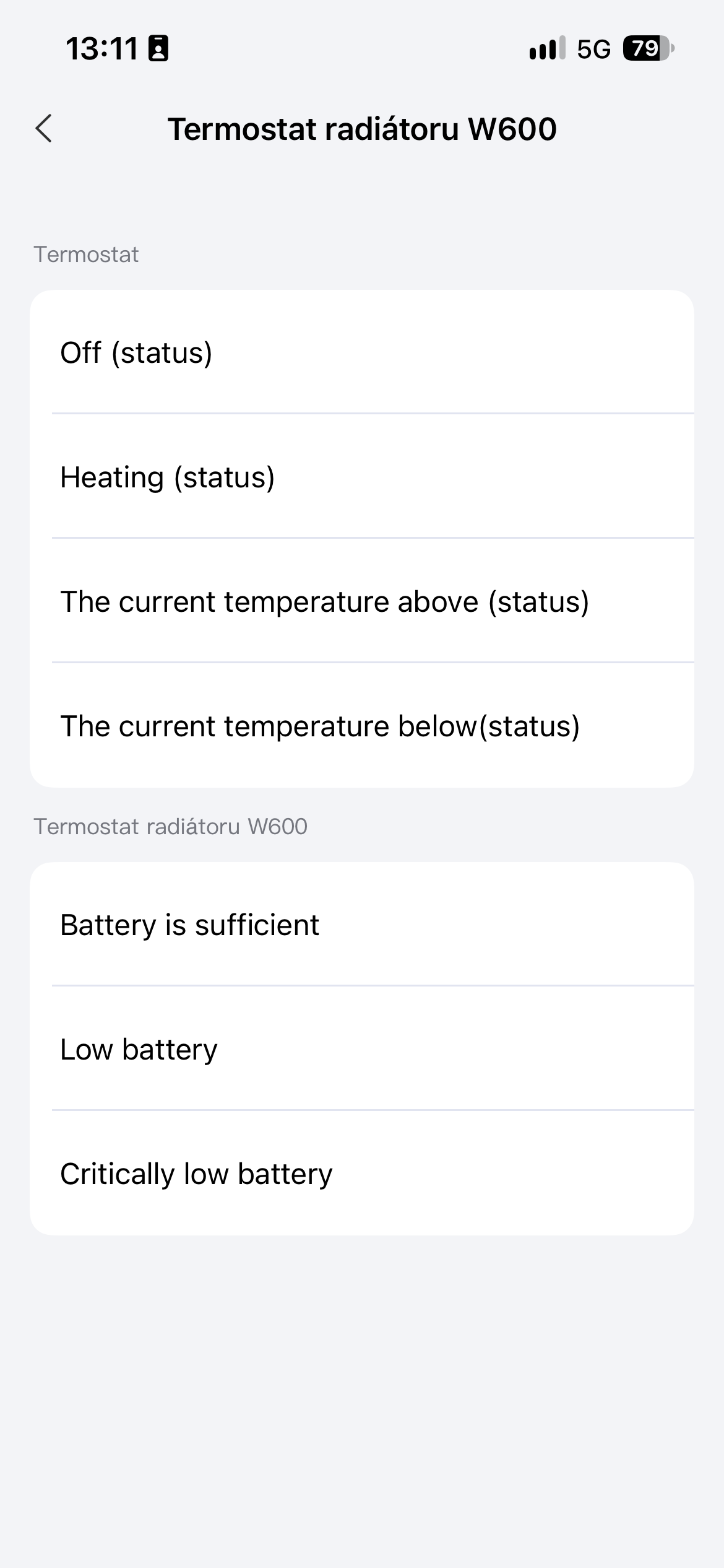

And now I even realazied that you can not set up “not heating” for E1 in the first part of the When condition. So it’s even less possible to do this type of automation.
