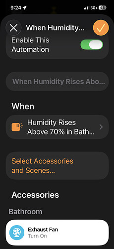

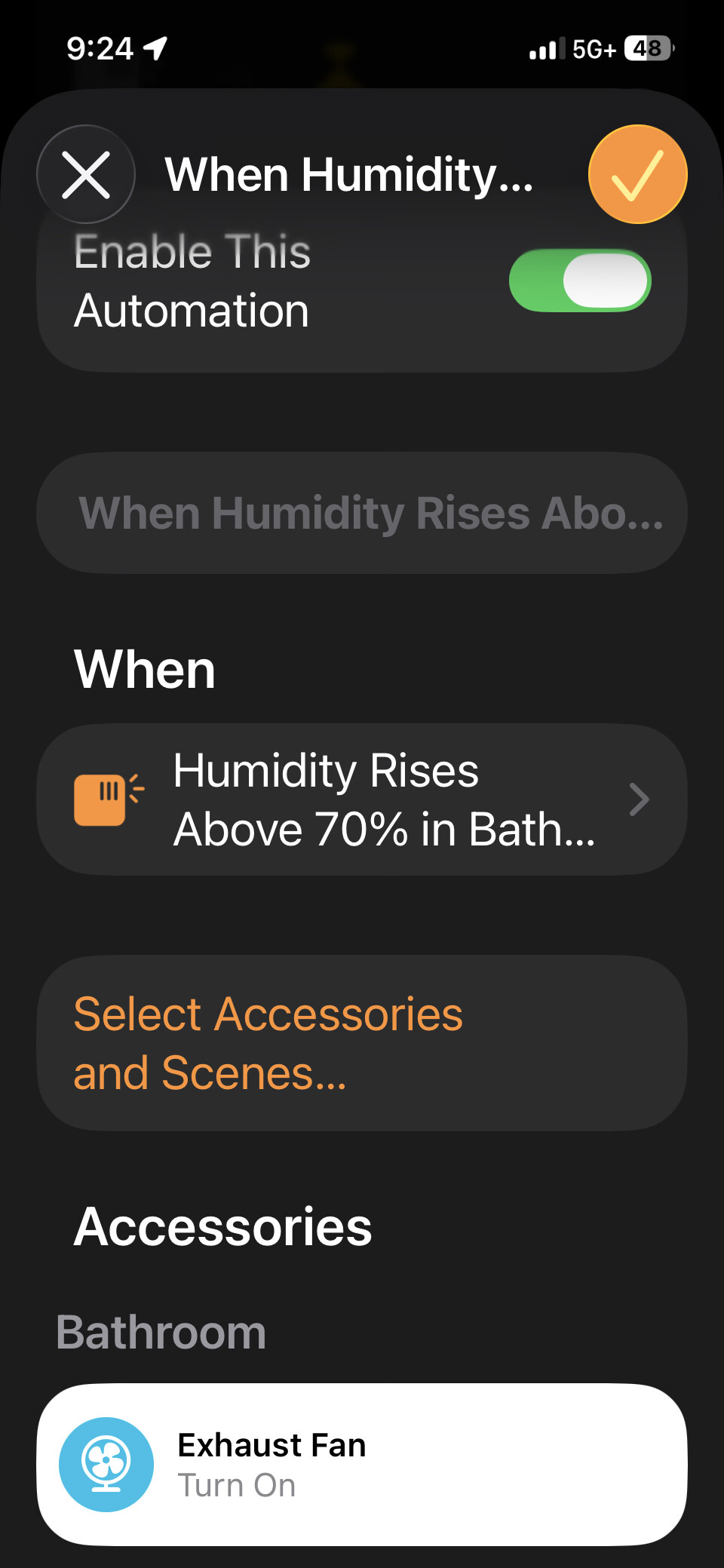

I run my house off of Apple home this is pretty much my set up…The bathroom fan stays on until humidity drops to 54% not sure what platform you run yours with but I hope it helps
