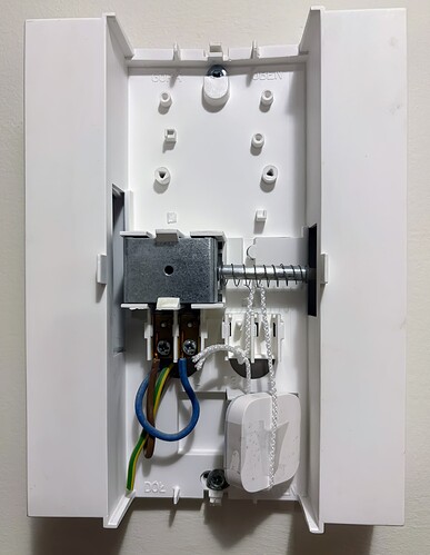

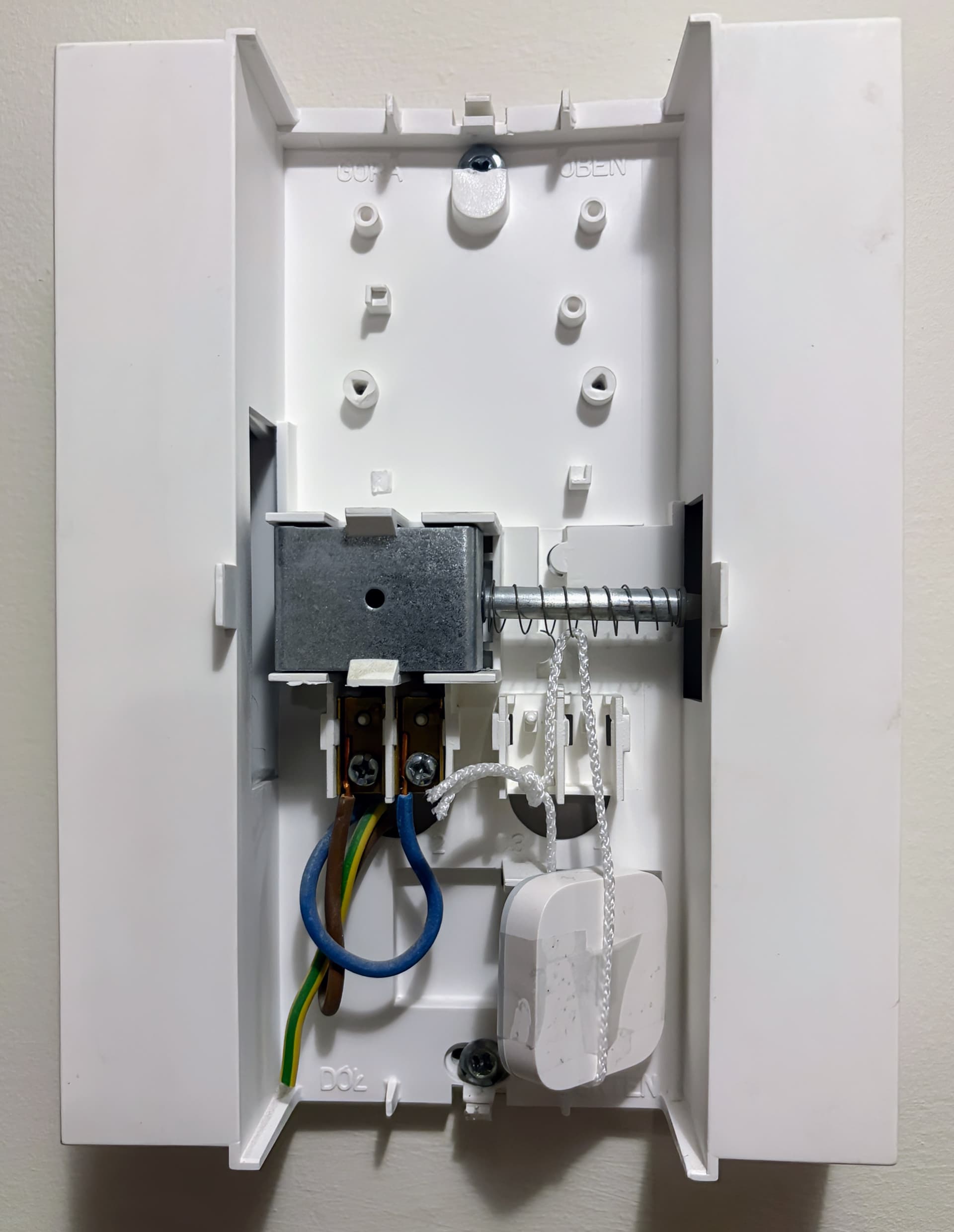

At some point I wanted to prepare an automation to detect a doorbell, but I didn’t want to install a smart dorbell. I found some youtube videos how to disassemble vibration sensor from aqara and connect to electronics of a doorbell, but I didn’t want to do that either. And my doorbell is really dumb and simple :smiley:
How I fixed that? scotch tape and a vibration sensor and a small piece of string. Job done, as you can see on the picture
I have configured few automations (in Home Assistant), such as - someone pressed the doorbell switch and no one is at home or someone pressed the doorbell switch and no one opened even though someone was at home.
