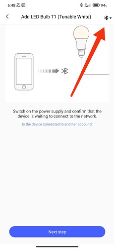

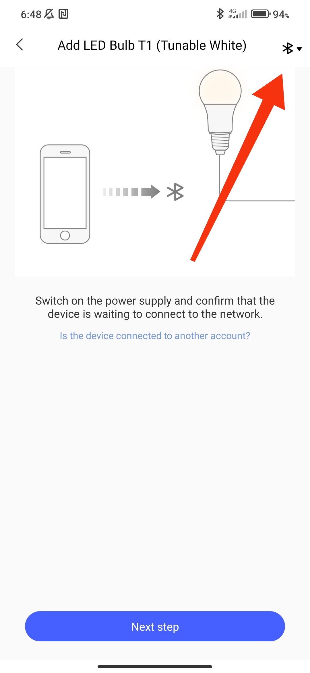

I had this problem, you just need to select Zigbee in the upper right window during installation (Bluetooth is the default).
Try it, maybe it will help.

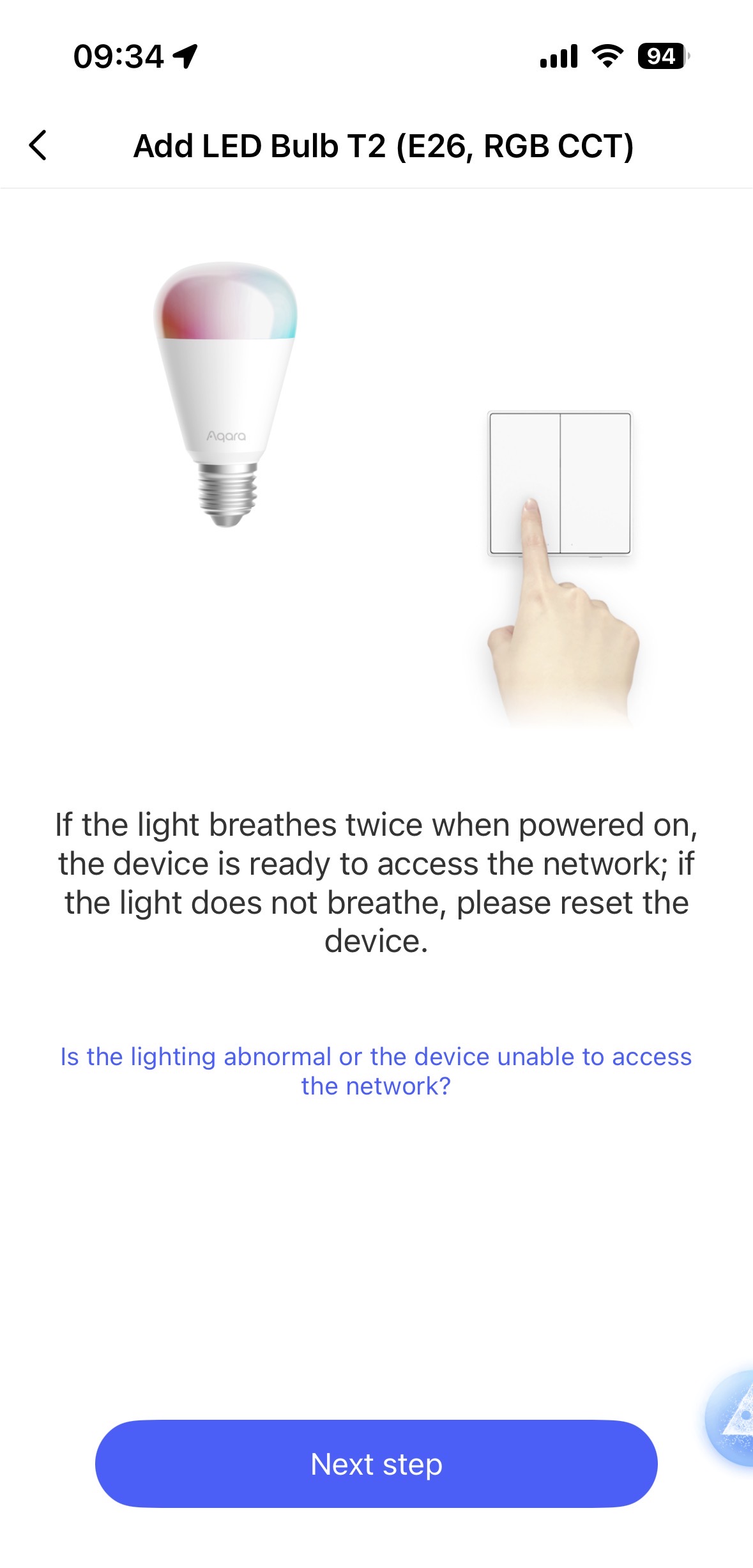

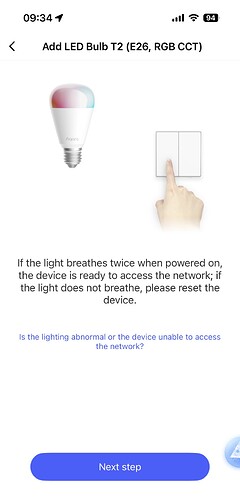

My recommendation is, as I faced a similar issue today, delete the bulb from all ecosystems that you might have, then unscrew and screw the light bulb 10 times in a row fast until it blinks. Then, in the Aqara Home app, scan the Matter code of the bulb; it will prompt you to select which protocol— select Zigbee and wait for the firmware to upload. After that, it will bind automatically. If it fails (which is what happened in my case), just click the button on the hub 3 times, then unscrew and screw the bulb a couple of times fast until it blinks twice, and it will bind to the hub. Then you can add the hub to HomeKit from the hub menu, and it will add the bulb with it.
