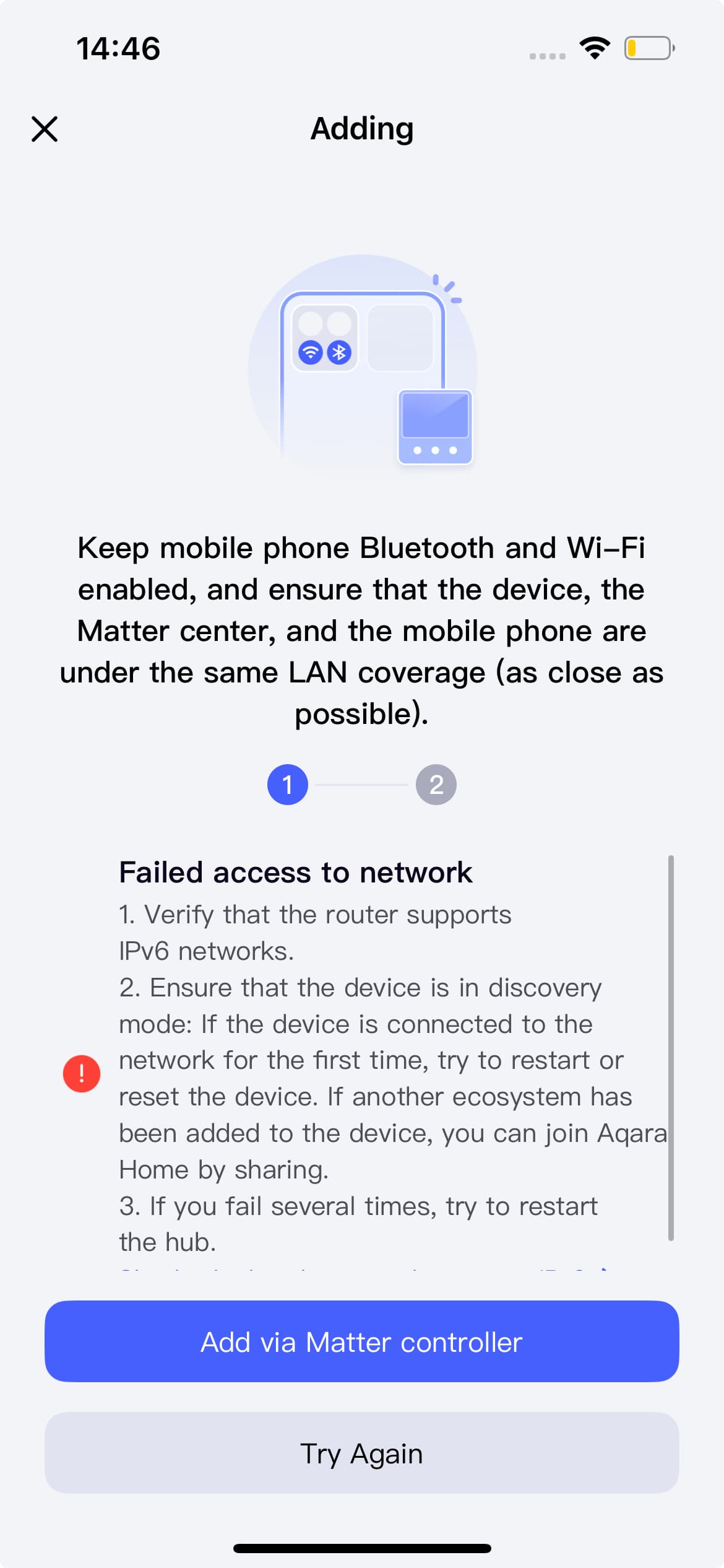

  3. If pairing fails, you’ll see a screen with further options
  4. Tap “Add via Matter Controller”
  5. Follow the on-screen instructions — the Hub M3 will attempt to discover nearby Matter devices via Bluetooth or LAN

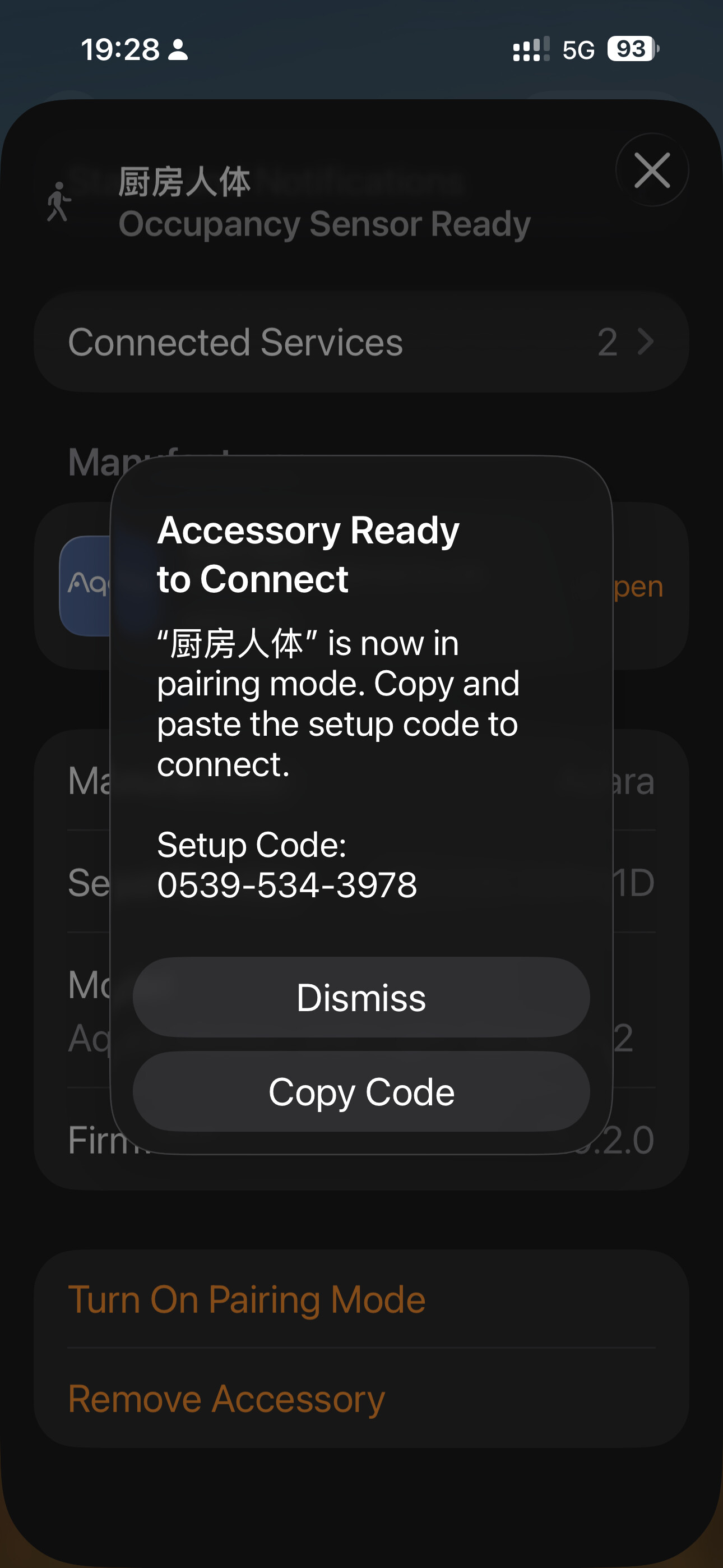

It is to share your device from Apple Home to Aqara Home.
Step 1: Enable Apple Home Sharing for Matter
  1. Open Apple Home app.
  2. Go to the Matter device you want to share .
  3. Tap gear icon (Settings).
  4. Scroll down and find “Turn On Pairing Mode” or “Share with another app” → tap it.
  5. A QR code or numeric code will be shown.
Step 2: Add in Aqara Home
  1. Open Aqara Home app.
  2. Tap “+” → Add Accessory .
  3. Choose “Add via Matter” .
  4. Use the camera to scan the QR code or enter the numeric code manually.
  5. Follow the prompts to complete pairing.

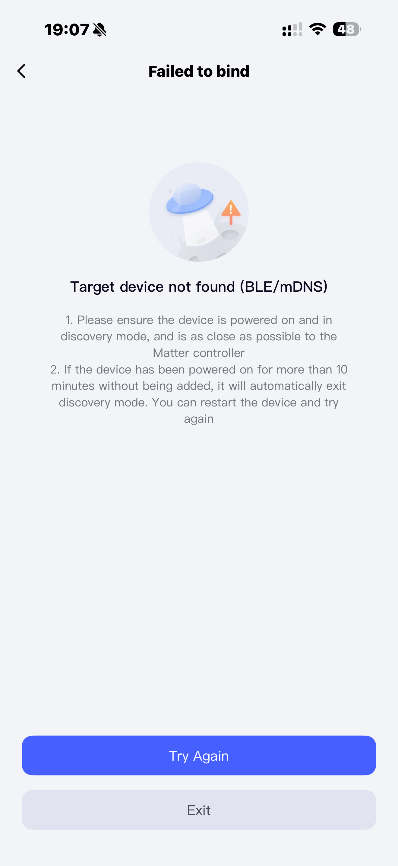

Thanks for sharing but unfortunately it doesn’t work for me. Been trying to connect my U200 lite to my M3 hub for days now and I am having no luck. I have even tried pairing directly to apple’s homekit and even HomeAssistant but even there I get no success :cry: I am at my wit’s end
Is your M3 updated to firmware version ≥ 4.3.7? I only managed to get it to pair via M3 directly as per the steps given above after updating the firmware.
Yes I did update it to the latest version. This was the latest error message after following all the steps:
It seems that the Hub M3 can’t find the device via BLE. how far is it between the Hub and device?
My hub is about 1,5 to 2 metres away from the lock
