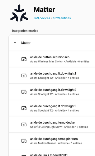

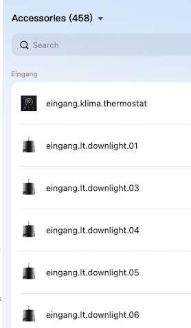

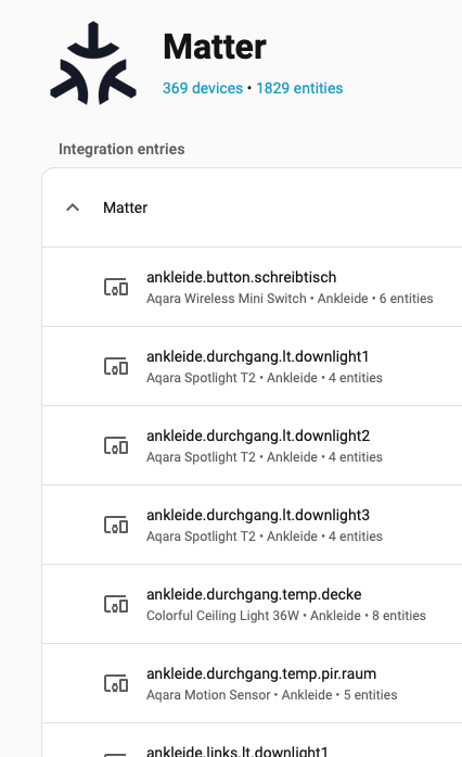

I currently have 458 Aqara devices installed, but Home Assistant only shows 369 Matter devices — and that number even includes some Matter devices that aren’t Aqara at all.
What I can’t see are things like the smart locks, thermostats, air-quality sensors, and LED drivers. Yes, all of these are products that aren’t officially available in Europe… but that probably isn’t the reason they’re invisible in HA. I can see other non-EU devices just fine (like the downlights), because my hubs are all connected to Home Assistant.

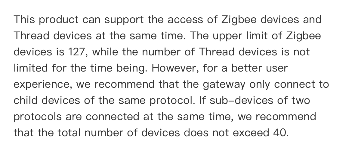

90 devices to one hub?
That’s probably too many.
Aqara Hub M3 can directly connect to 64 child devices, and can access 127 child devices if bridging through a Zigbee router / Thread mesh extender nodes.
Recommendation for the G5 Pro (can’t find anything in the FAQ for the other hubs, but it will probably be similar):
