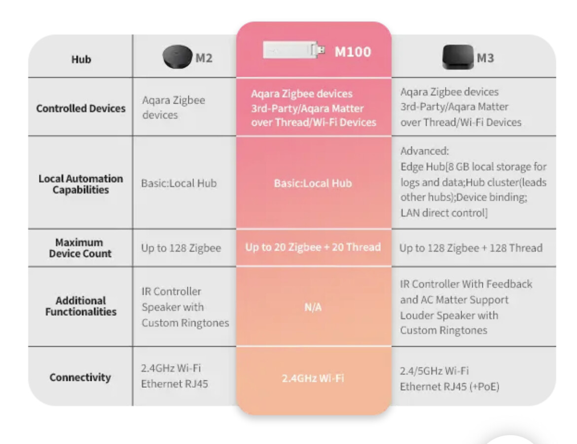

Source of the picture: Aqara Website
The M100 only supports 2.4 GHz WiFi. Perhaps these posts will help you:
