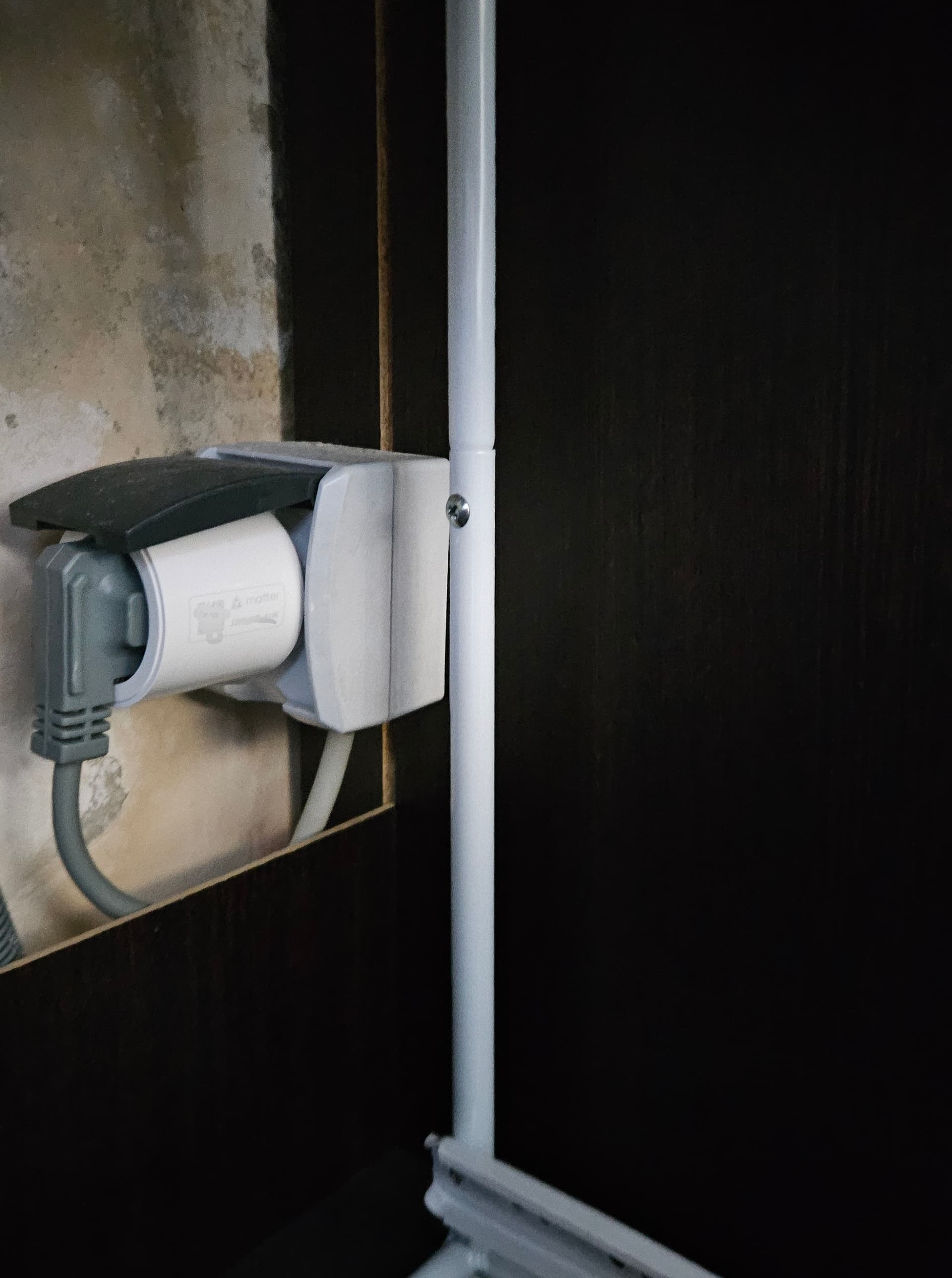

I use the Aqara Power Plug H2 to make our “dumb” built-in dishwasher smarter.
The dishwasher itself has no status LED and only beeps 3 times when it finishes, which is very easy to miss.

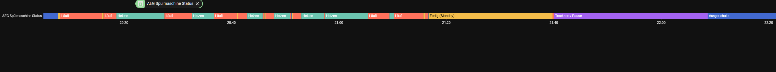

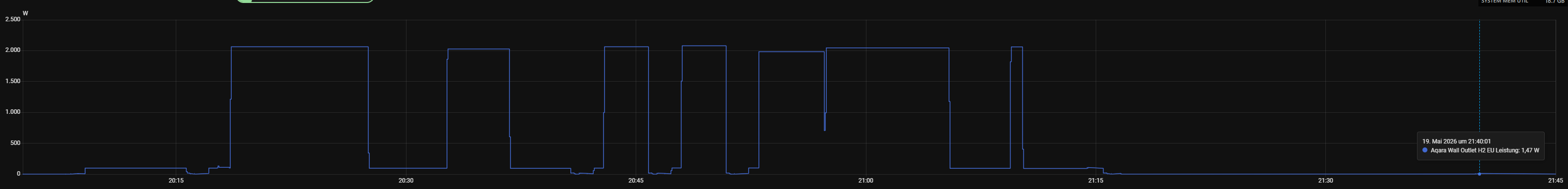

Using the power monitoring inside Home Assistant, I created different states based on the current power consumption:
  • Off
  • Standby
  • Running / Drying
  • Heating
This allows me to create notifications and display a visual status on my Home Assistant dashboard depending on the current cycle state.

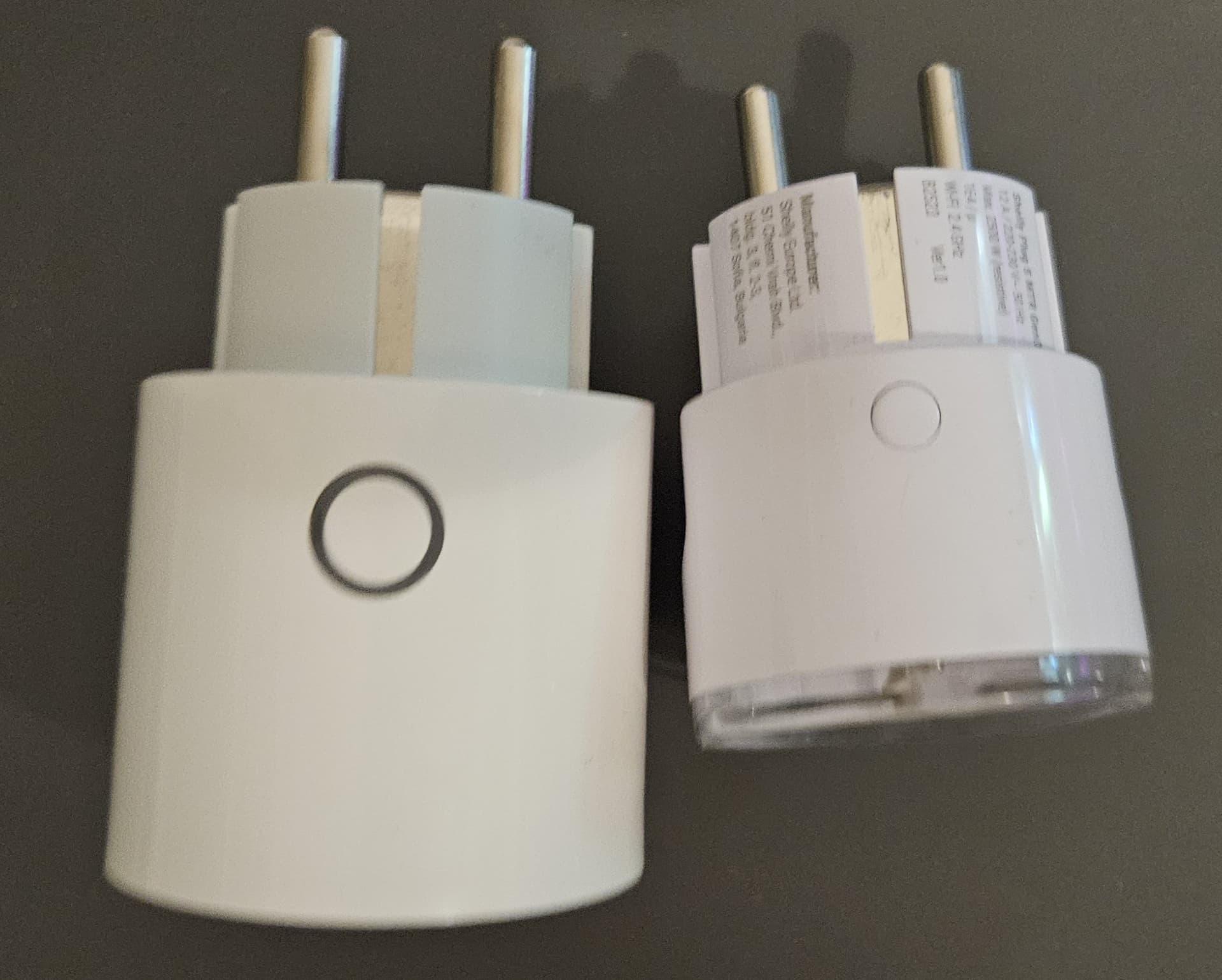

This is my first Matter-over-Thread smart plug. Before that, I used the Shelly Plug S Gen 3, which uses Matter over Wi-Fi.
Compared to the Shelly, the Aqara plug is noticeably larger, but I really like that it uses Thread instead of Wi-Fi. I haven’t had any connection or stability issues so far.
I also really like the RGB LED, which is controllable via Matter. In my case it’s unfortunately hidden and therefore not very useful, but if the plug is visible it could also work great as a customizable status indicator.

Getting reliable appliance states only from power consumption can be a bit tricky, especially because the dishwasher changes its consumption pattern quite a lot during different phases. I would probably need to fine-tune the thresholds and timings a bit more to always get the correct matching state.
