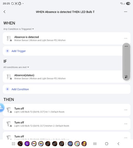

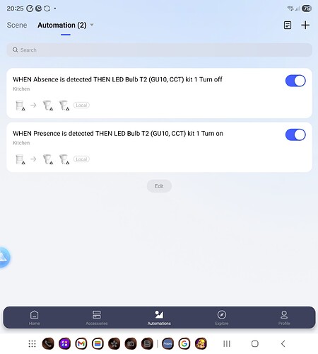

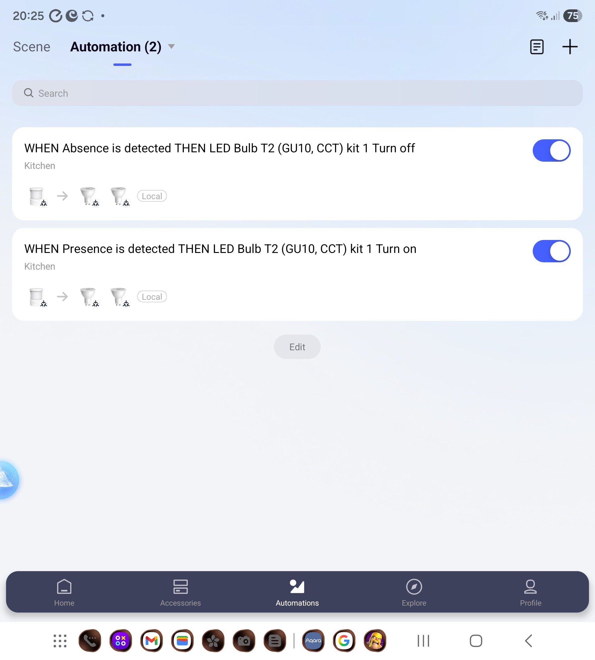

Can you post screenshots of your automations?
If you click preview on the automation does it all work?

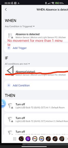

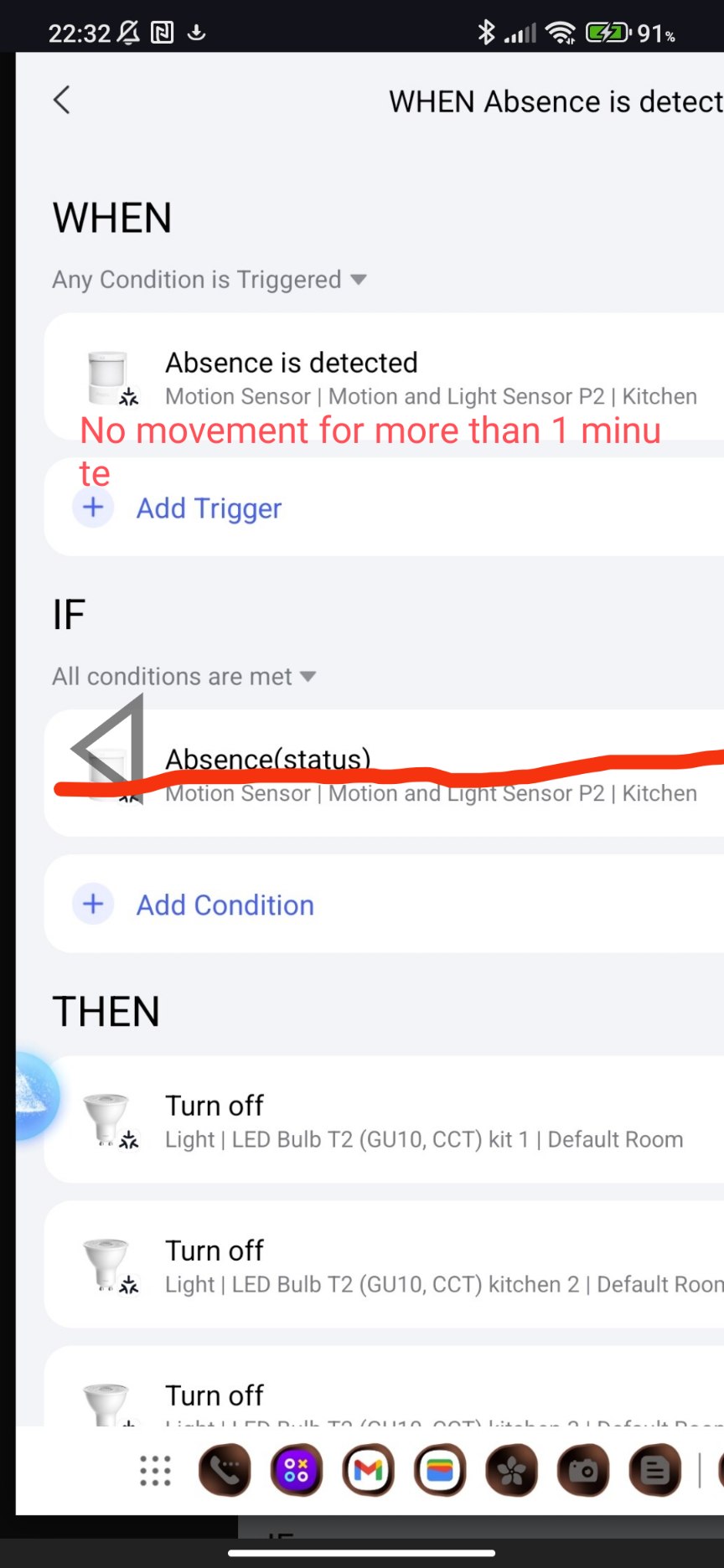

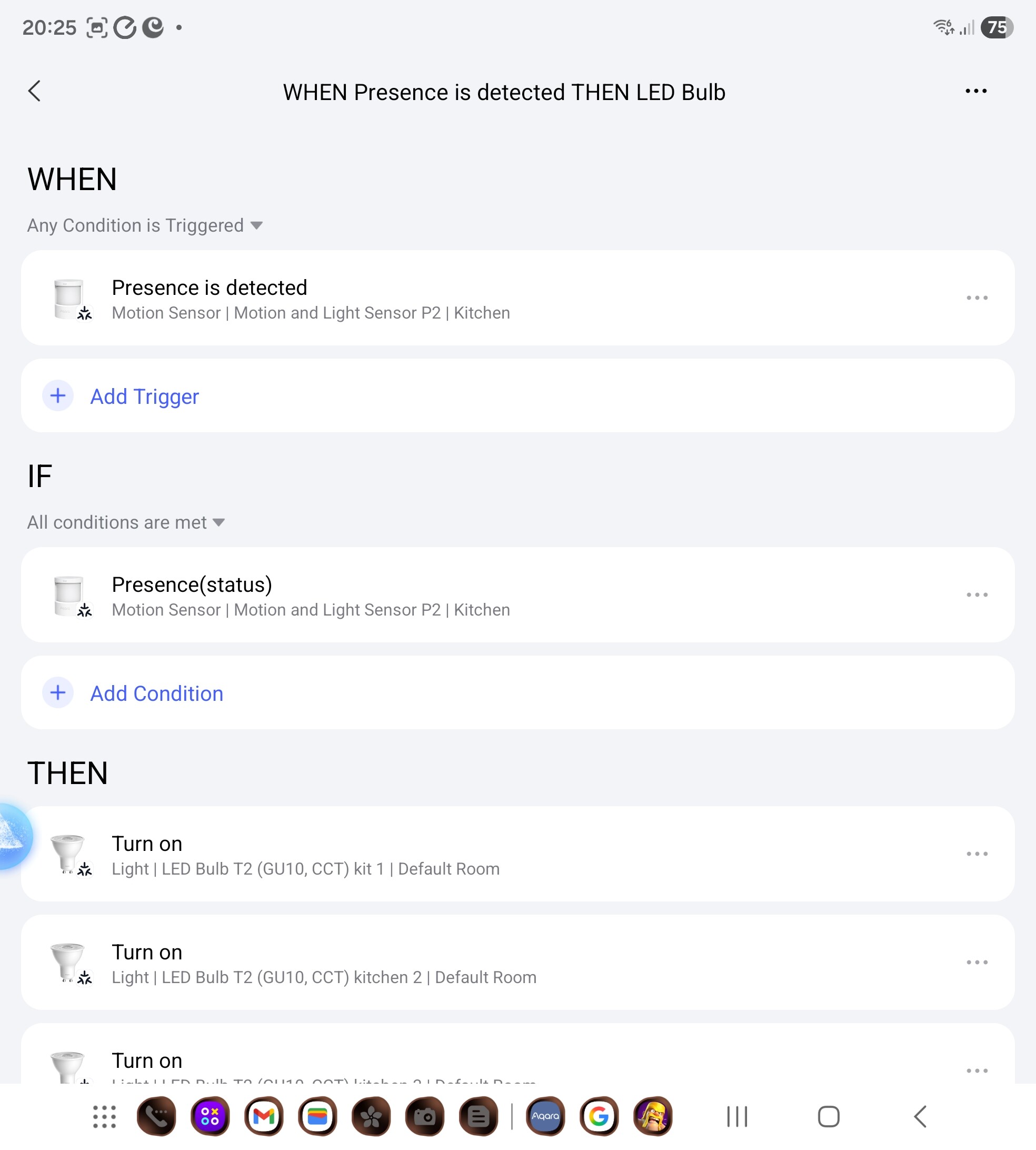

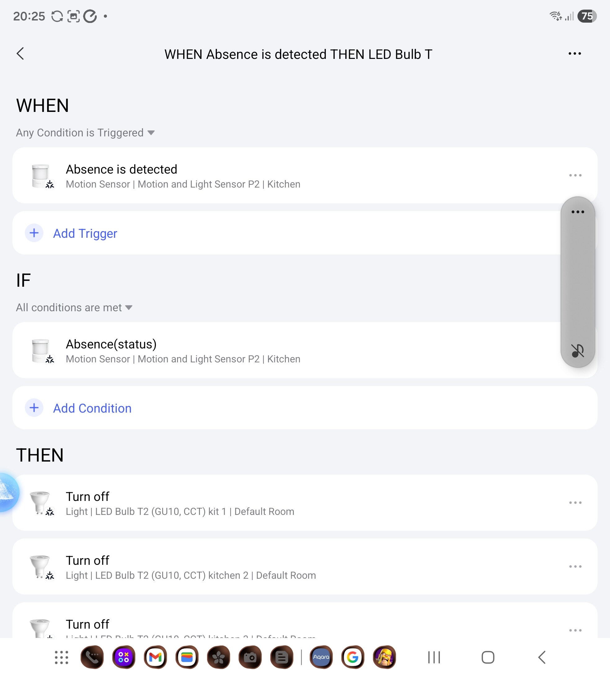

You don’t need the same devices in When and If. These are simple automations. Remove the optional IFs.
What happens when you run these automations? I’d guess it fails at the second step.
Also - you’re only using the P2 Motion sensor, not the FP2?

Cheers i update

This is the difference between Automations 1.0 and 2.0. It shouldn’t matter for you as a new user, but older docs might confuse users or even support agents.
1.0 was just IF-> Then.
2.0 is When → If → Then.
In your case you have the same devices in both When and If. This is unnecessary for what you are trying to do.
Let us know if you get better results.
So after making the small changes that you guy suggested it been working like a dream. Cheers for your help…
