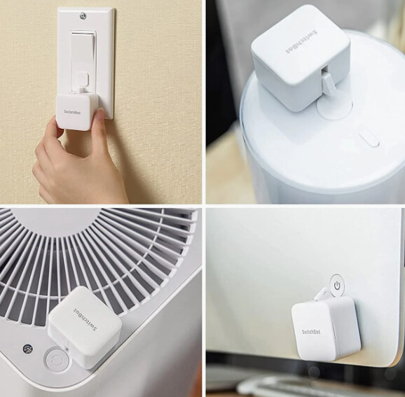

If your sister’s child doesn’t want to climb inside into the closet anymore, you can buy a Swichbot Bot instead to calibrate the sensor :rofl:
