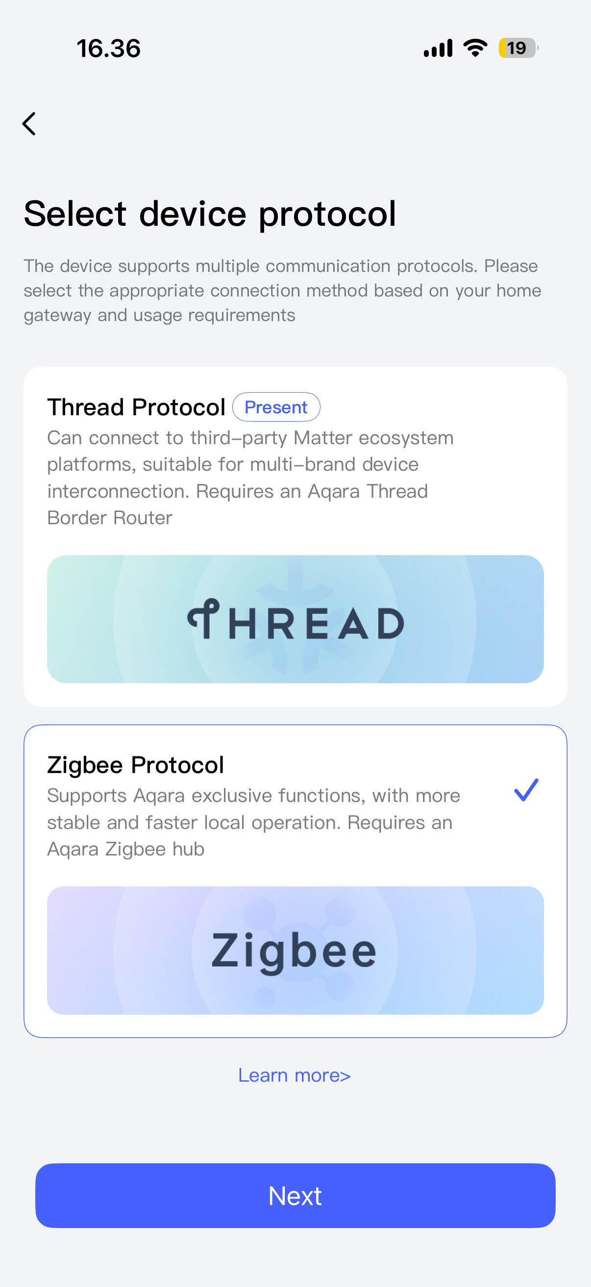

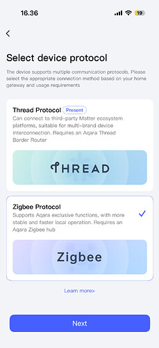

Hello. G3 is also an Aqara gateway. Transition sequence. 1. go to the G3 gateway and disable the option “prohibit device removal”. 2. Remove H2. 3. Reinstall it, when you first launch the installation window, select Zigbee mode. Then everything is standard.

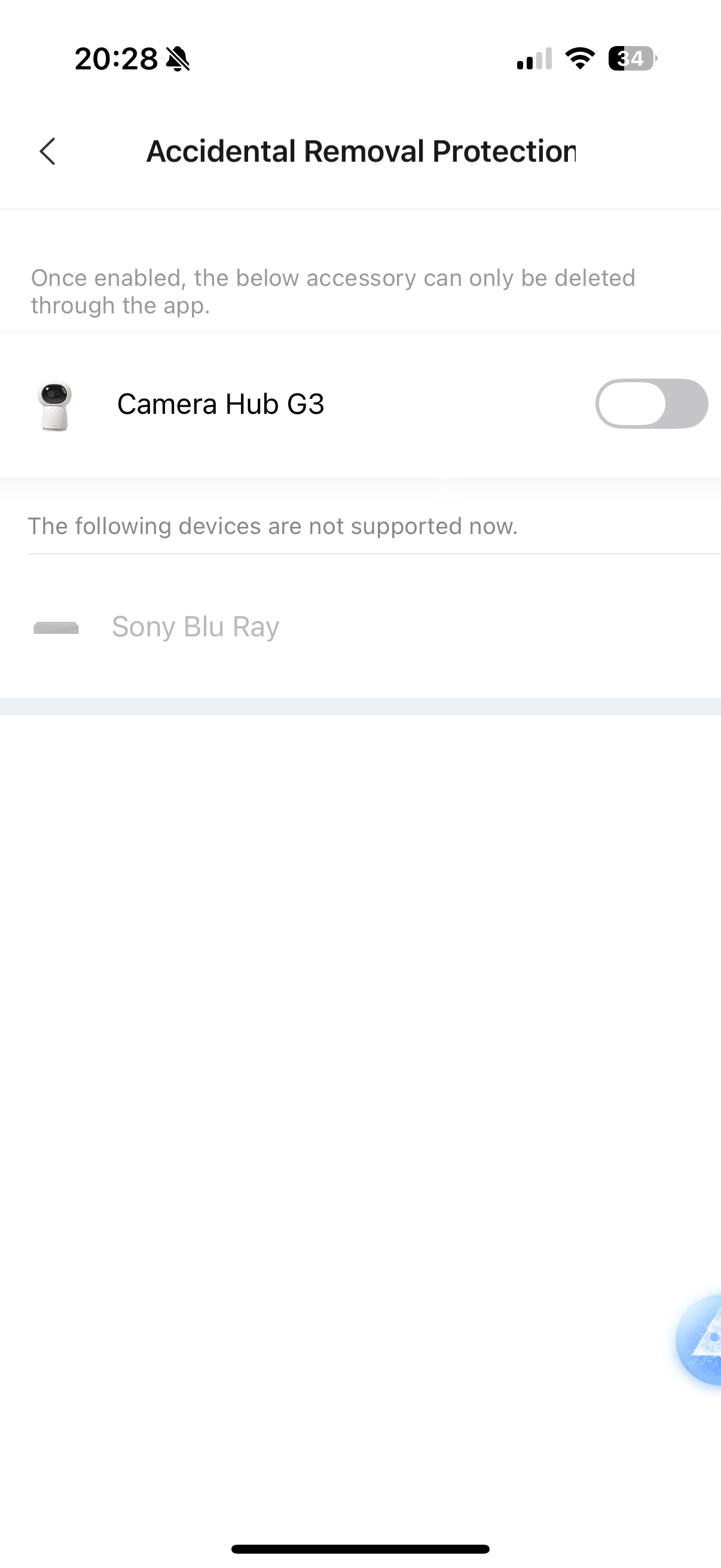

Clarification, perhaps the G3 does not have the “prohibit device removal” function.

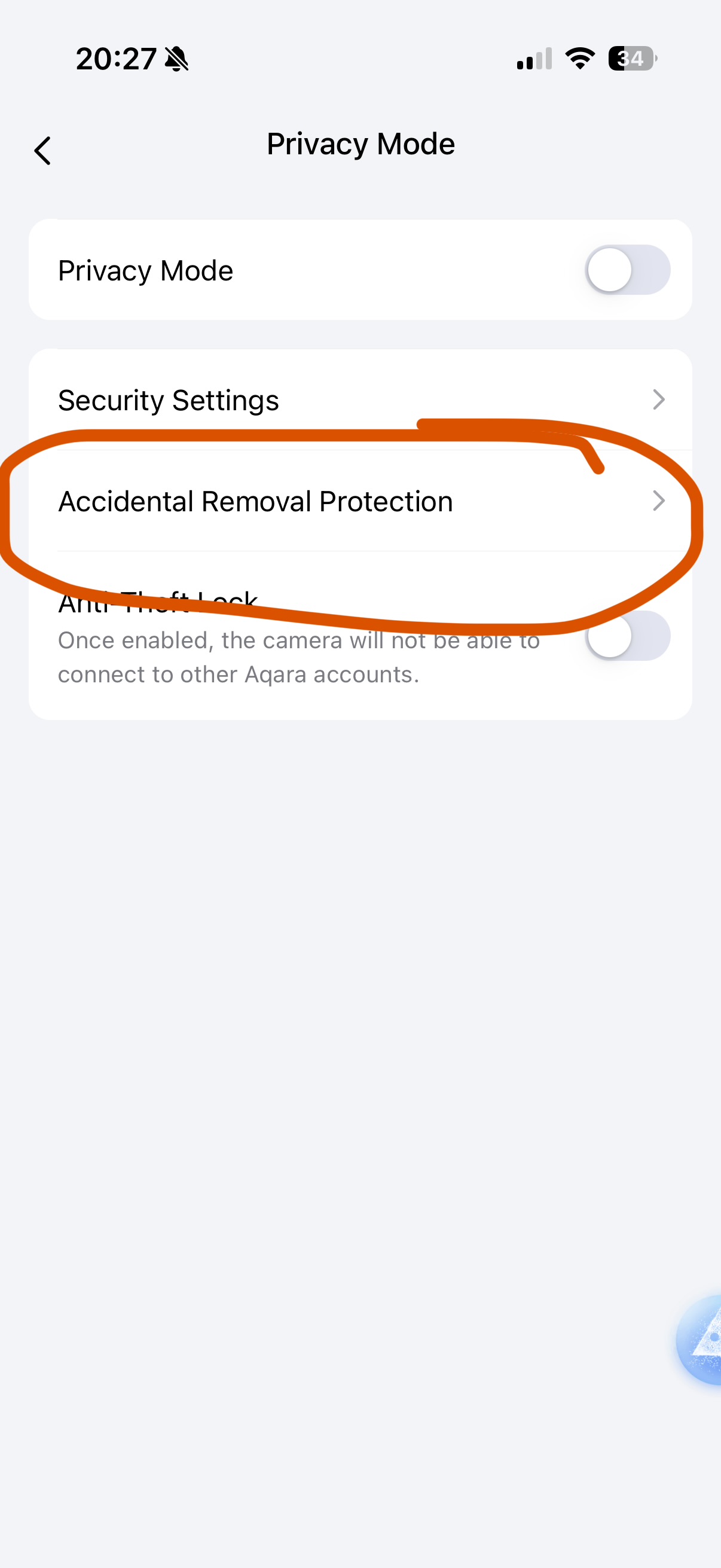

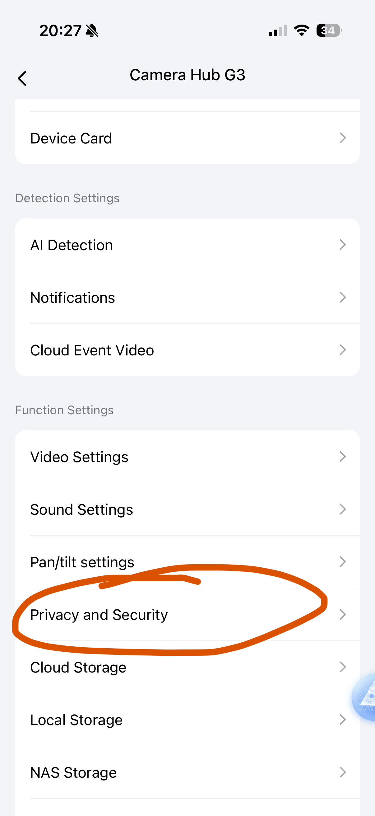

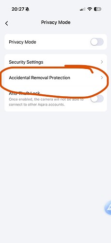

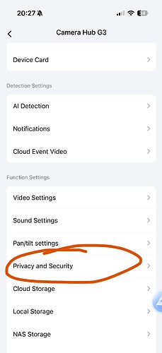

The G3 does have accidental removal protection, under three dots → Privacy and security
The H2 is a dual protocol device, but you need to select which firmware to use during pairing (either Thread or Zigbee). Default is Thread, but the G3 is not a Matter controller, it only supports Zigbee. Please select Zigbee (instead of the default Thread), as @gafich10 suggested

Yes, because dual protocol devices have to be paired using Matter code, and then you should have an option to select protocol

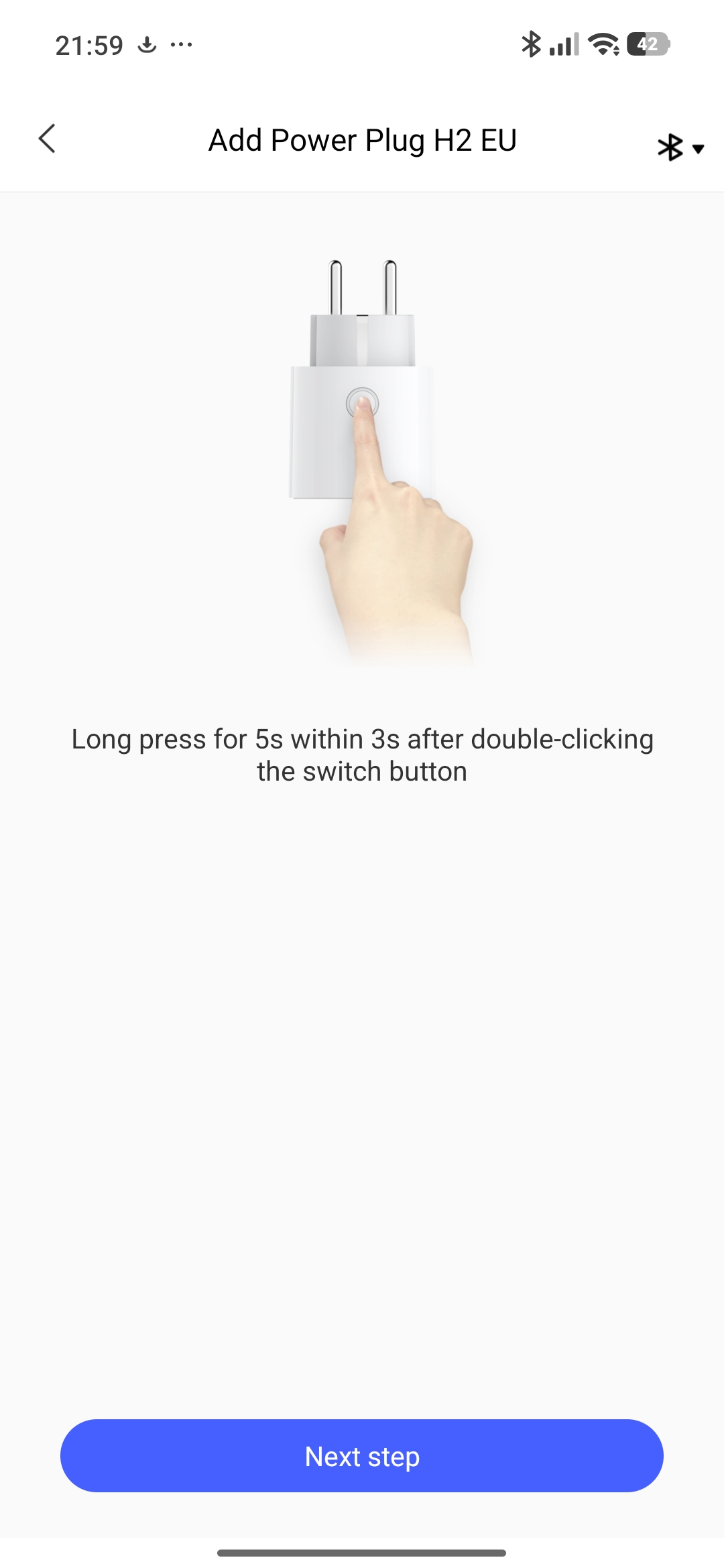

Double-click the button and then press and hold for 5s within 3 seconds, the indicator light will flash quickly to indicate successful reset.

The option to ‘prohibit device removal’ is disabled

I recall people on this forum just used Aqara app to switch firmware to Zigbee and then added their devices to third party Zigbee ecosystems, so the method we showed you had definitely worked before for other devices.
