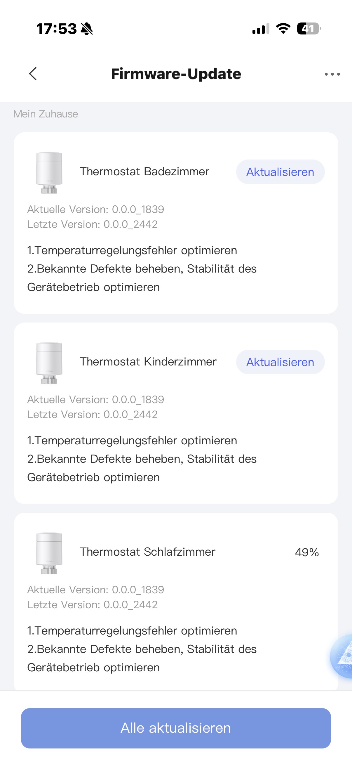

0.0.0_2442 Is the new Firmeware

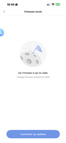

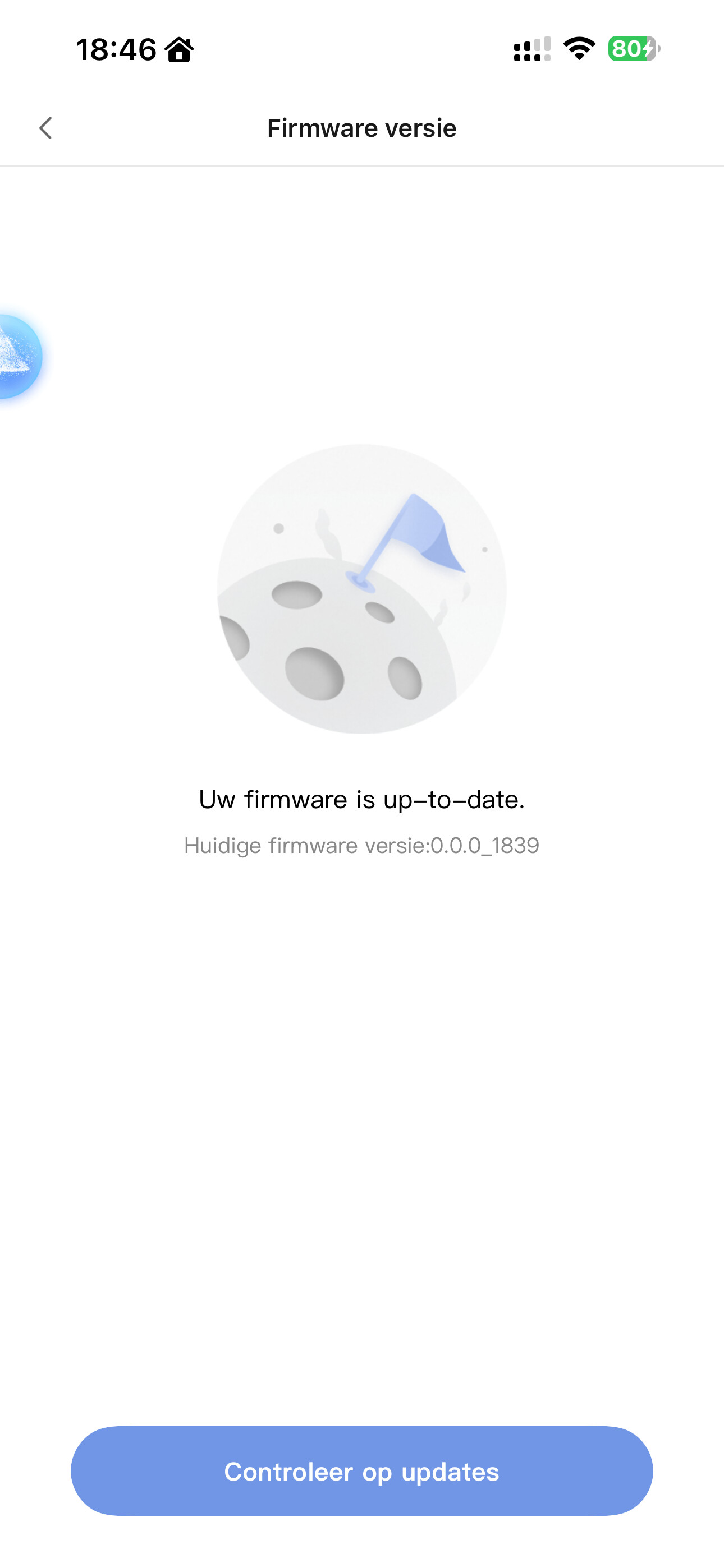

Hi folks, I’m facing the same issues with 3x W600’s, I don’t see any firmware update on the App. Using Zigbee, current firmware version is 0.0.0_1839.
How do we get the updates?

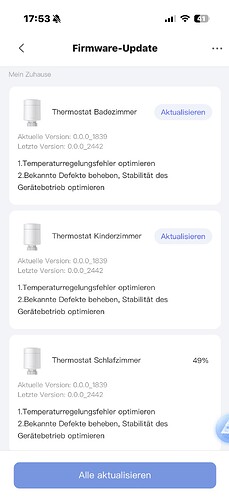

Hello, welcome to the forum. The principle of updating Aqara products.
@Solmath Thanks a lot. Now I know I have to send it back. No software updates without a hub is a no-go

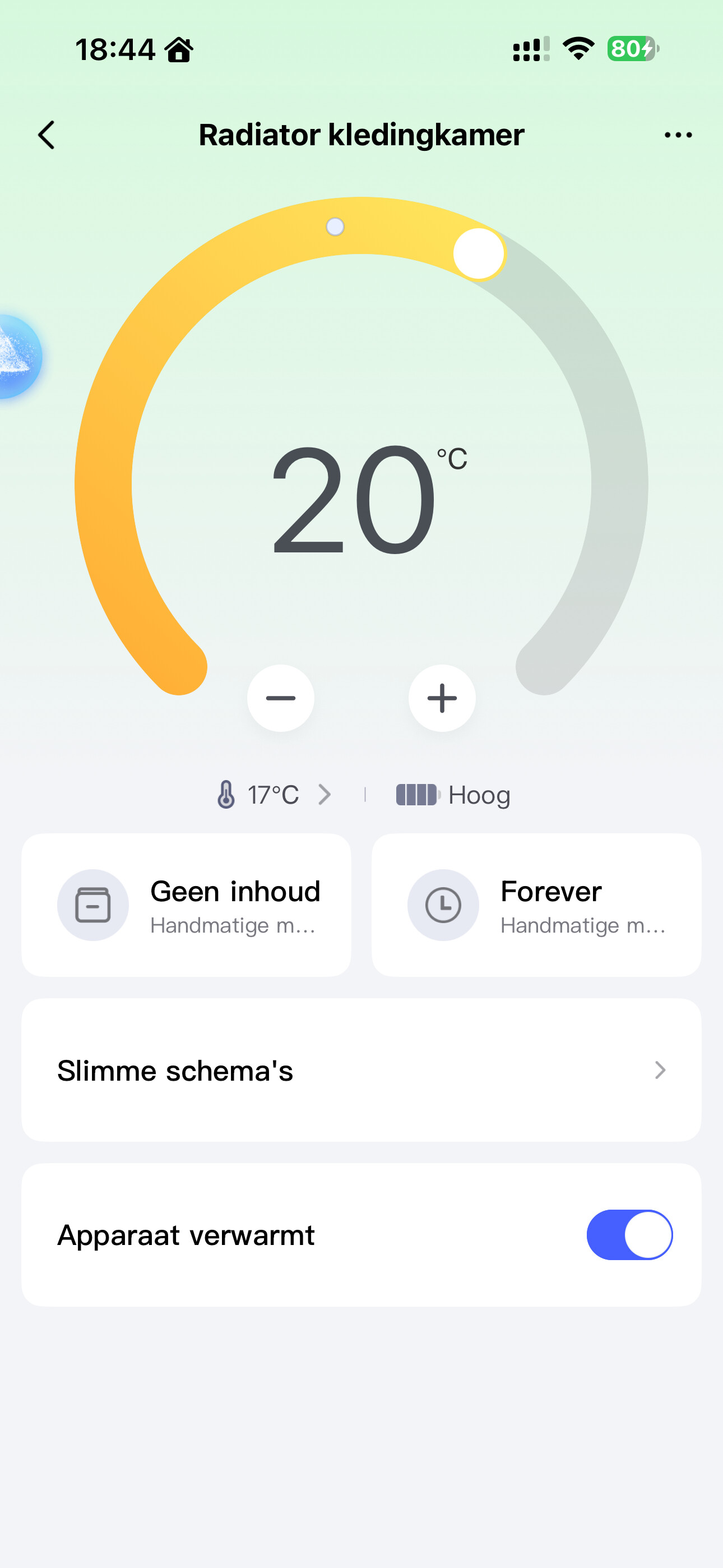

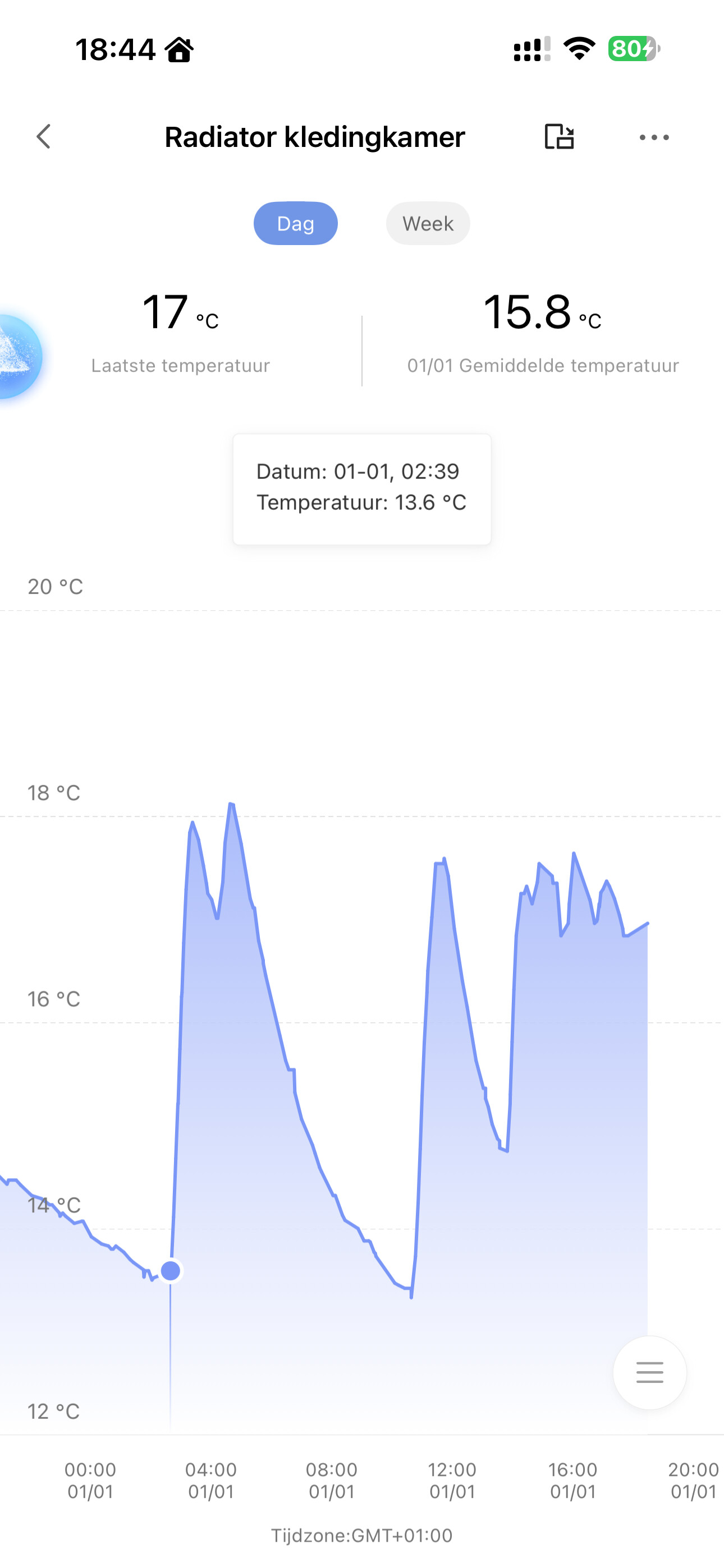

Today had to heat the room the W600 is in.
Was set at 17, now to 20°C
Turned on and started heating:
As you can see it went up to max 18 and then went all over the place and then setteled around 17° while it was still set to 20.

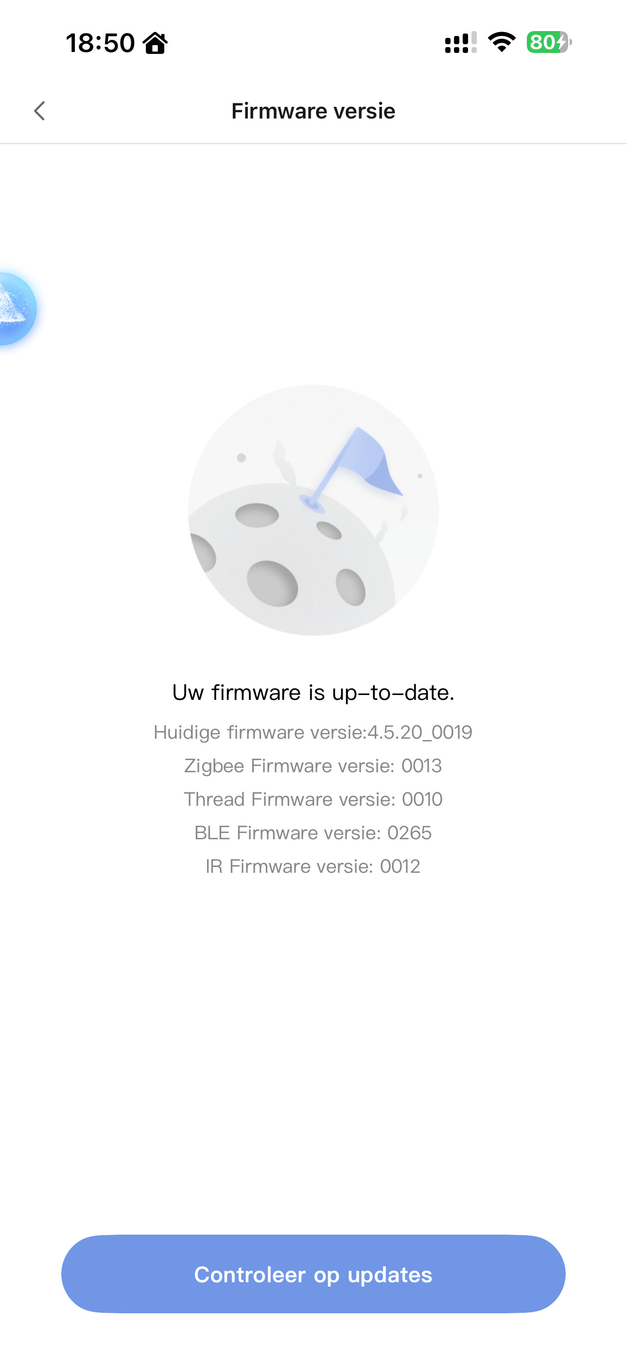

M3 firmware:
W600 firmware:
