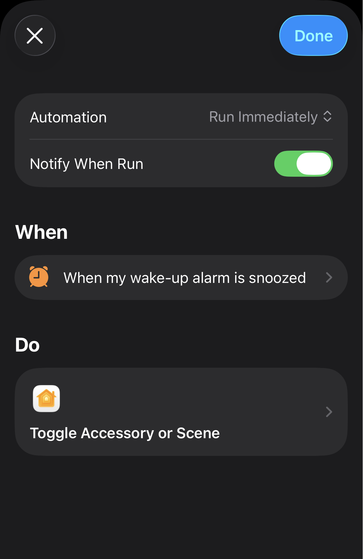

One more thing: If you use Apple Home and have an iPhone, you can also trigger scenes with your alarm clock

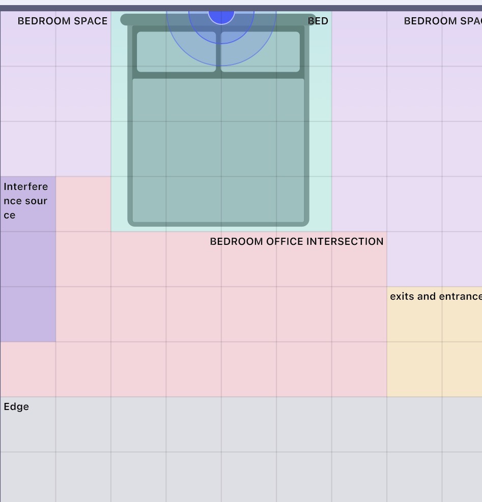

I am using fp2 in such a way that the bed is a zone (2x2.2m). It detects one or two persons in bed. It us positioned right above my bed on the wall… not sure if it suits your exact purpose…

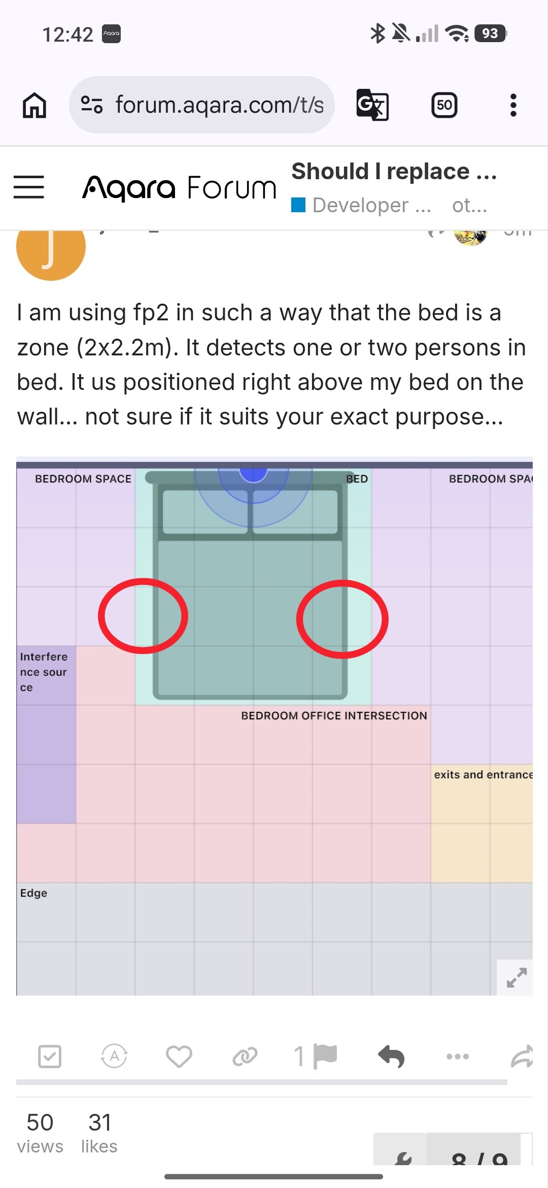

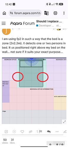

I suggest putting a P1 under the bed with the control zone I drew in red. You lower your legs and the system sees that someone is “getting out of bed”.

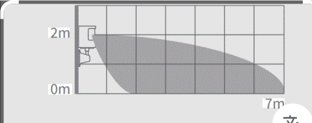

Hello, I know I’m being persistent, but a motion sensor under the bed won’t bother anyone and won’t take up any space.
By the way, you can mount it not under the bed. It will also work on the wall below, the main thing is that the directivity diagram works.
