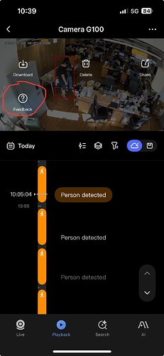

Thank you very much @Aqara_PM_Donie, I will wait for the new firmware to see if the discrimination between person and pet improves. Would it be possible to share clips and frames somewhere to help you optimize the algorithm? Or do I continue to do it through the feedback button of the Aqara Home application? If there is another method I could provide you with clips and other information in order to help improve the G100 camera.

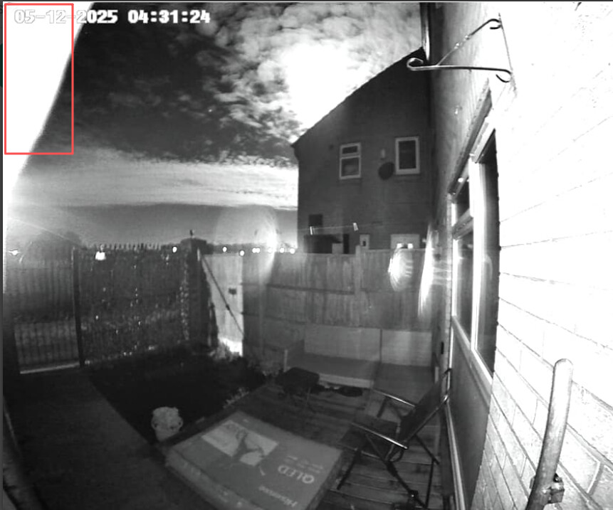

I have the same issue, I have two G410s and it only shows on one during nighttime use

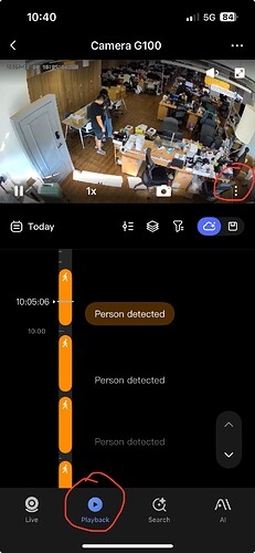

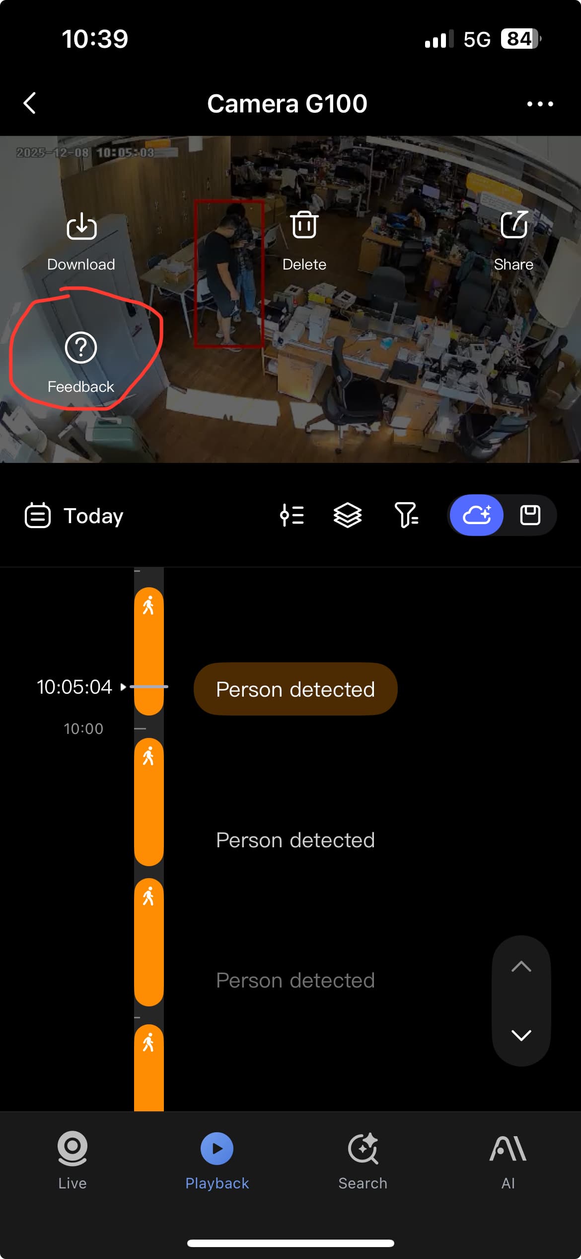

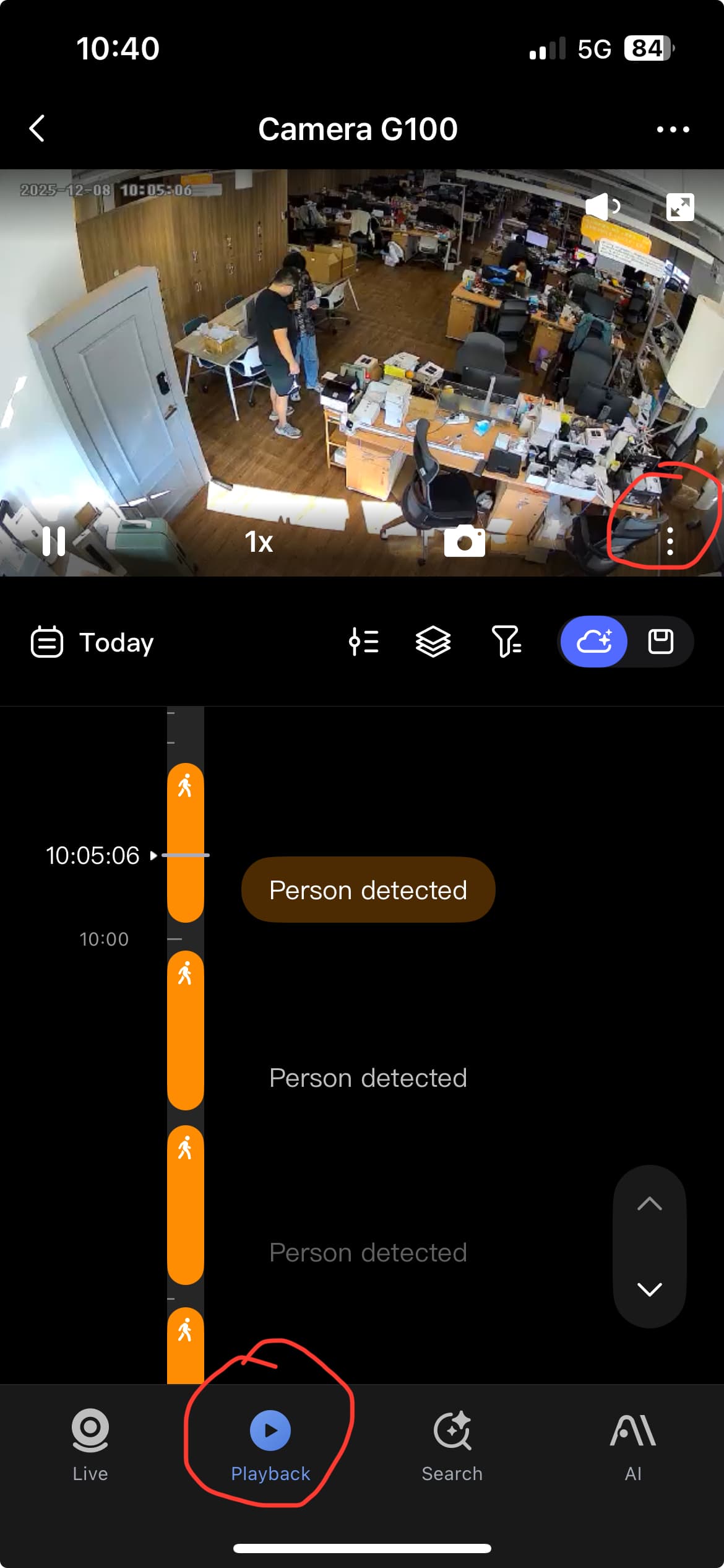

friend, you can feedback as follow pictures showed:
The problem caused by the reflection of infrared light in the triangular area in the upper left corner, can be improved by covering this area with a black piece of paper, to prevent it from reflecting infrared light.
Thank you,
That part is actually black as its a cover over the top of the doorbell to help with weather. The doorbell is on its angled bracket hence why it can see it.
