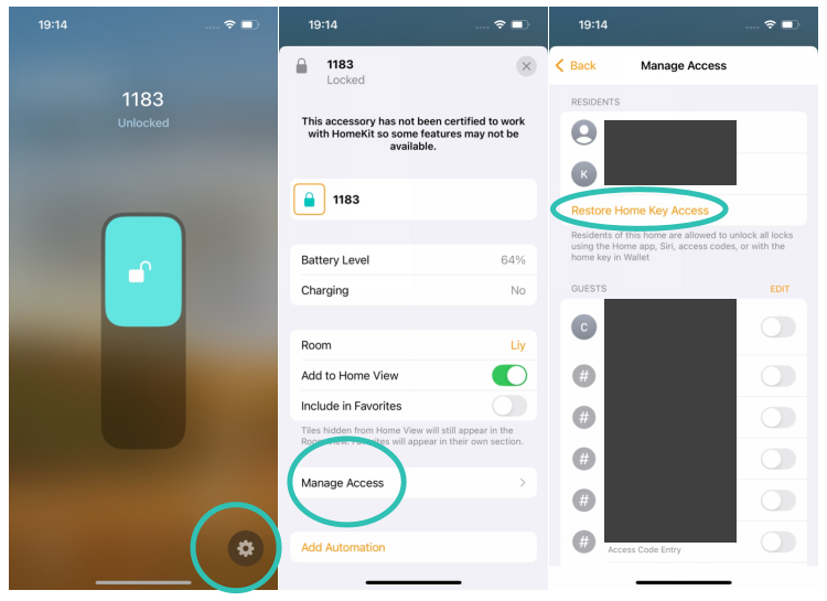

:left_speech_bubble: IF: Missing Home Key card after the update
If your Home Key card disappears, update your iPhone and HomePod to iOS/tvOS 18.4.1 or later. Then, use the new feature called “Restore Home Key Access” to bring it back.
(Home app> U200’s setting> Manage Access> Restore Home Key Access)

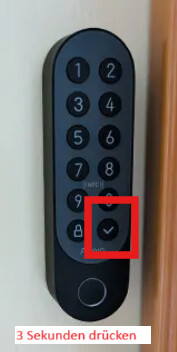

Hello @KinseyCreateGoods , I would like to briefly address this topic again, as many people tell me that pressing 5 seconds does not help. It would only want to lock the door several times but not start a password request.
The manual states on page 4 at the bottom
that there are two versions for resetting the Matter. Once for Aqara Home users and for Matter users (Apple possibly also)
  1. press the confirm button.
  2. for Matter users: Press and hold (3 seconds) the Confirm button
  3. briefly press the Set button on the U200 lock
  4. now briefly press button 4 on the keypad to reset the already bound Matter ecosystem.
Is this correct?
I’ll try to explain it to some people on the German community board and, if necessary, convey it correctly:
Hi , If the user only bound to Matter, you can login to the local settings page by doing the same thing as you said.
Matter Users: Long press (3s) the Confirm Button and press the
“Set” button on the Lock
