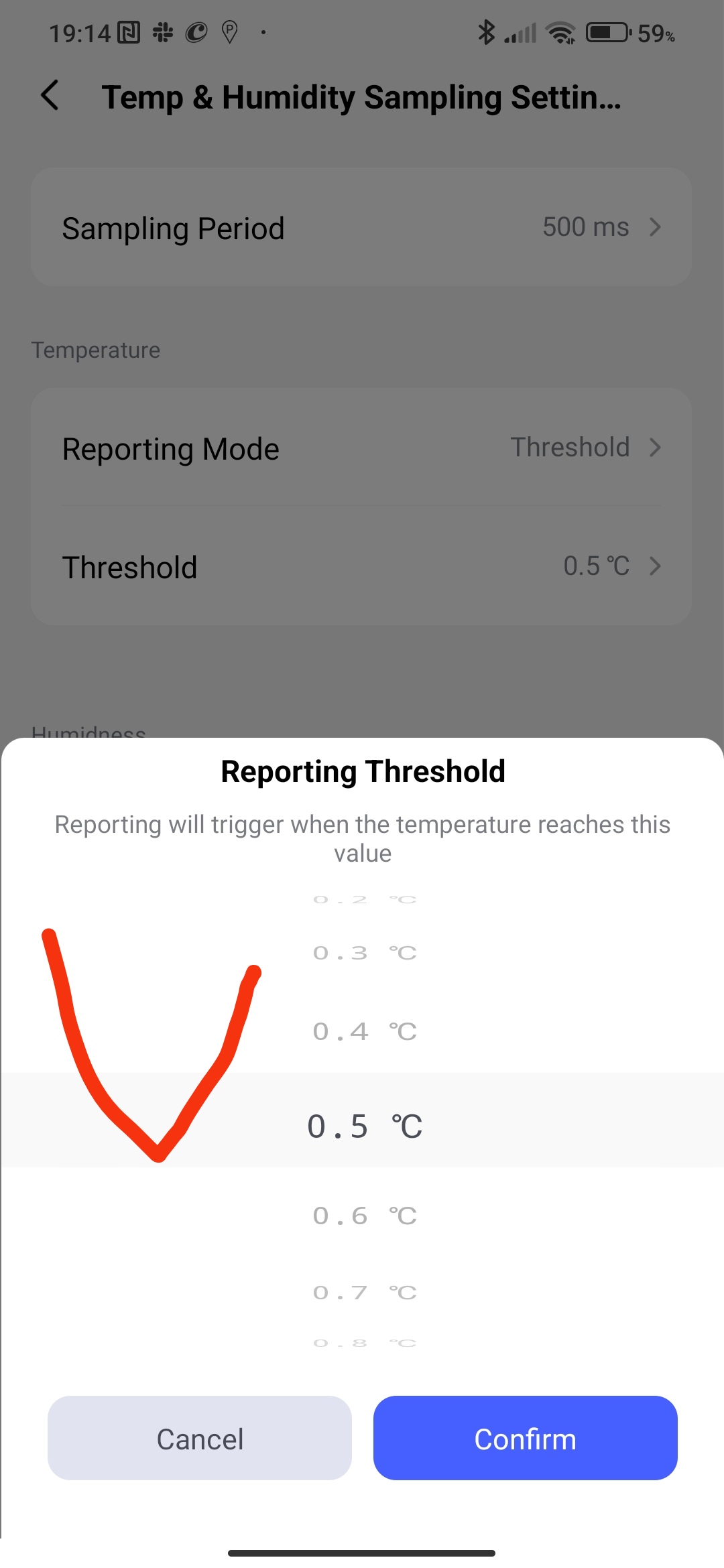

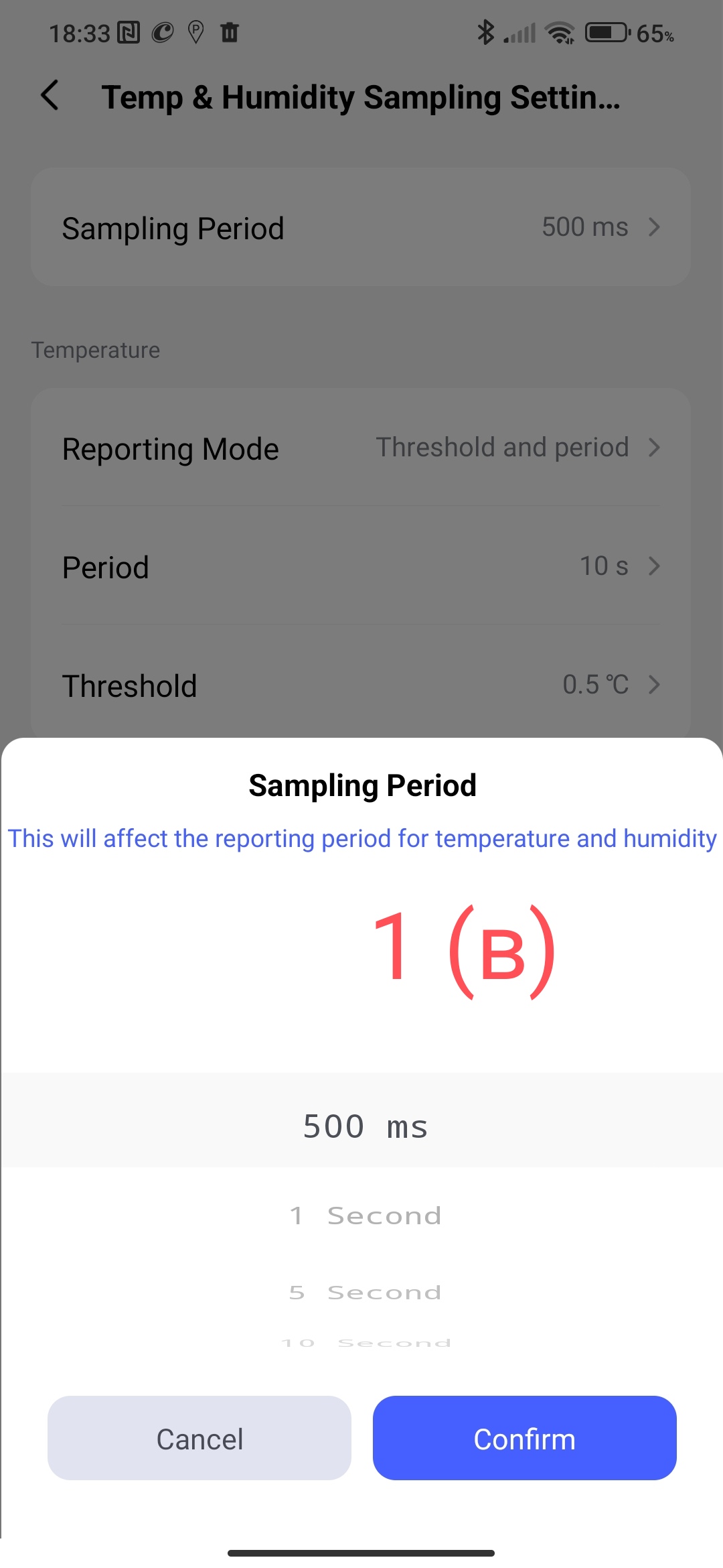

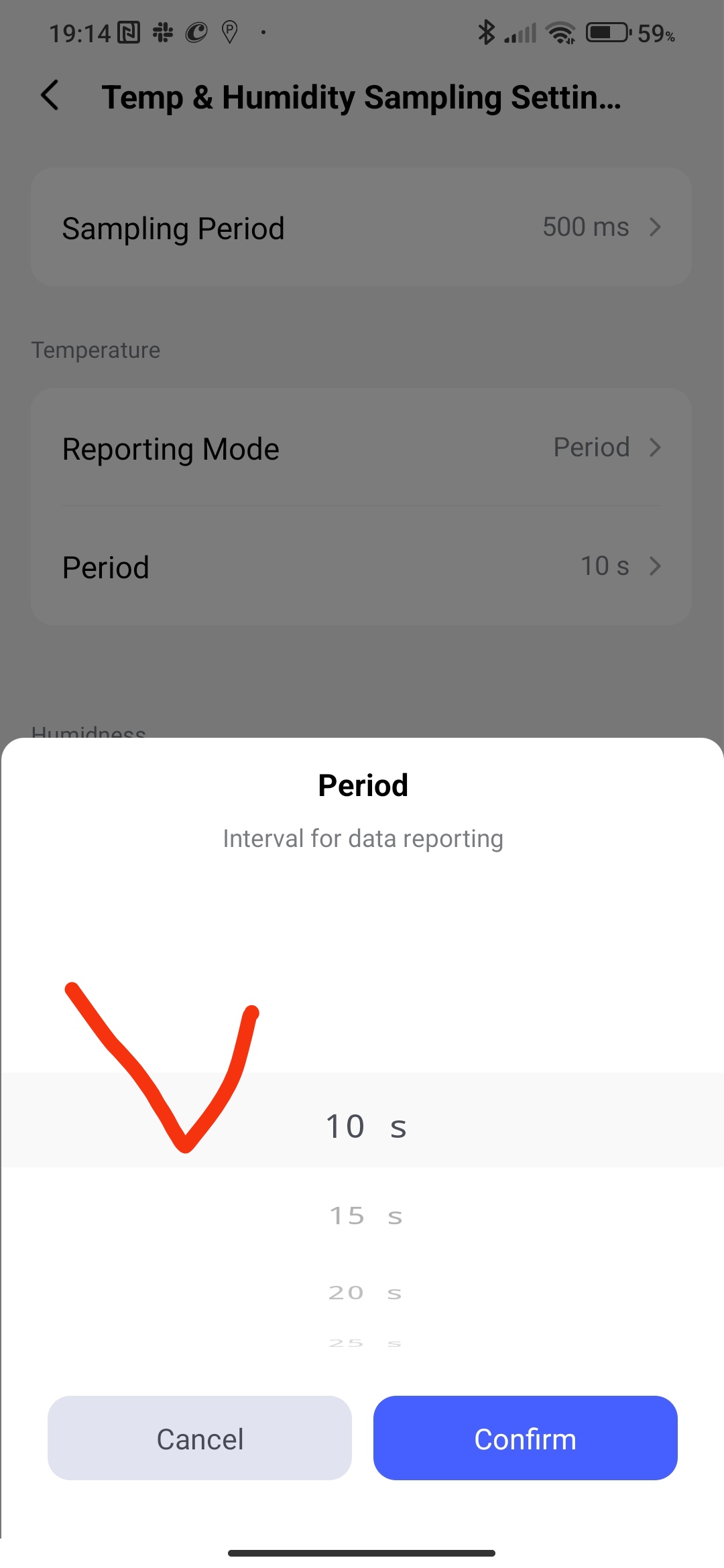

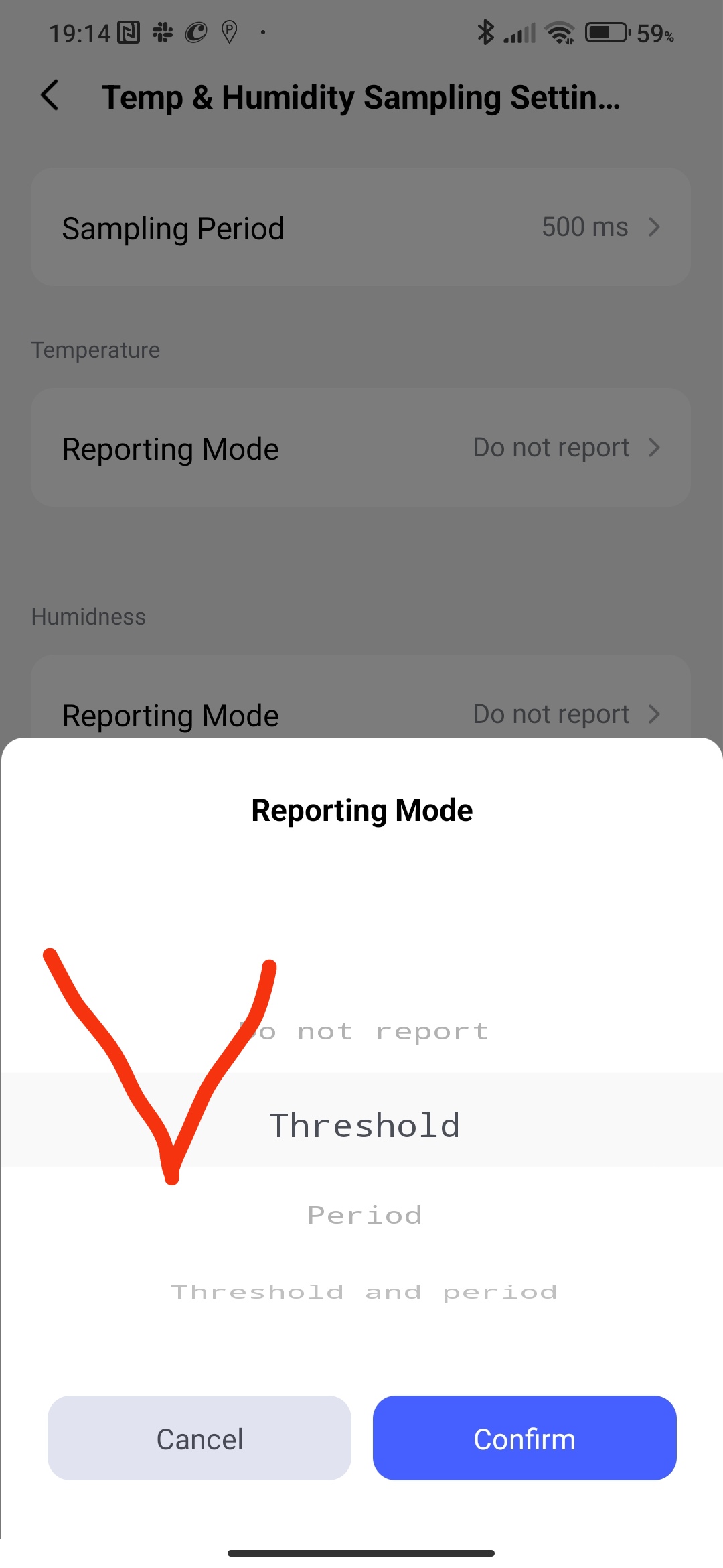

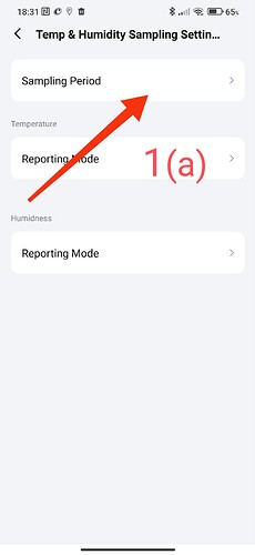

Information on the physical monitor is displayed according to the time specified in this setting, the speed can range from 0.5 seconds to 10 minutes.
Regarding the second question, the Aqara app allows you to set only a threshold of 0.5°C, believe me, I have been fighting with developers for more than three years for these 0.5°C.

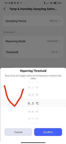

My recommendations are, if you want a range of 0.1°C, in automation set On if more than XX°C and Off if less than XX°C. In W100, set the sensitivity to 0.2°C in the settings.
When the temperature changes by 0.2°C, the information will immediately go to the automation for execution. The peculiarity of this setting is that we can control in increments of 0.5°C (…10;10.5;11;11.5…°C), I think this feature is not very critical for the room.
Set the update time according to the criticality needs (I choose 10 min) of temperature control in the room, this time makes the temperature survey independent, always, with the set period (sends the result to automation). If you set a very short time, the heating boiler will be triggered (On/Off).
