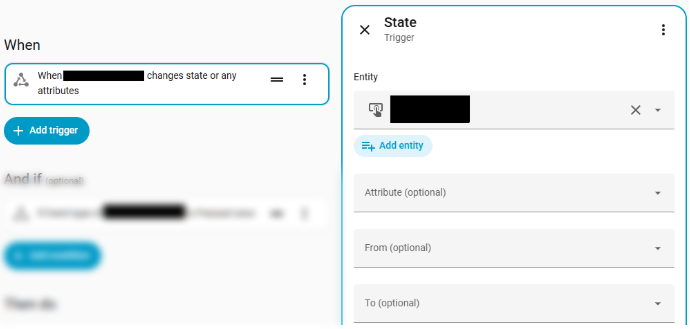

Try this in the WHEN Section: Add trigger → Entity → State
Under Entity, select Button 3.

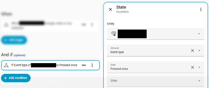

Then under the AND IF Section: Add condition → Entity → State
  • Under Entity, select Button 3
  • Under Attribute select Event type
  • Under State select Presed once
It should look like this afterward:
