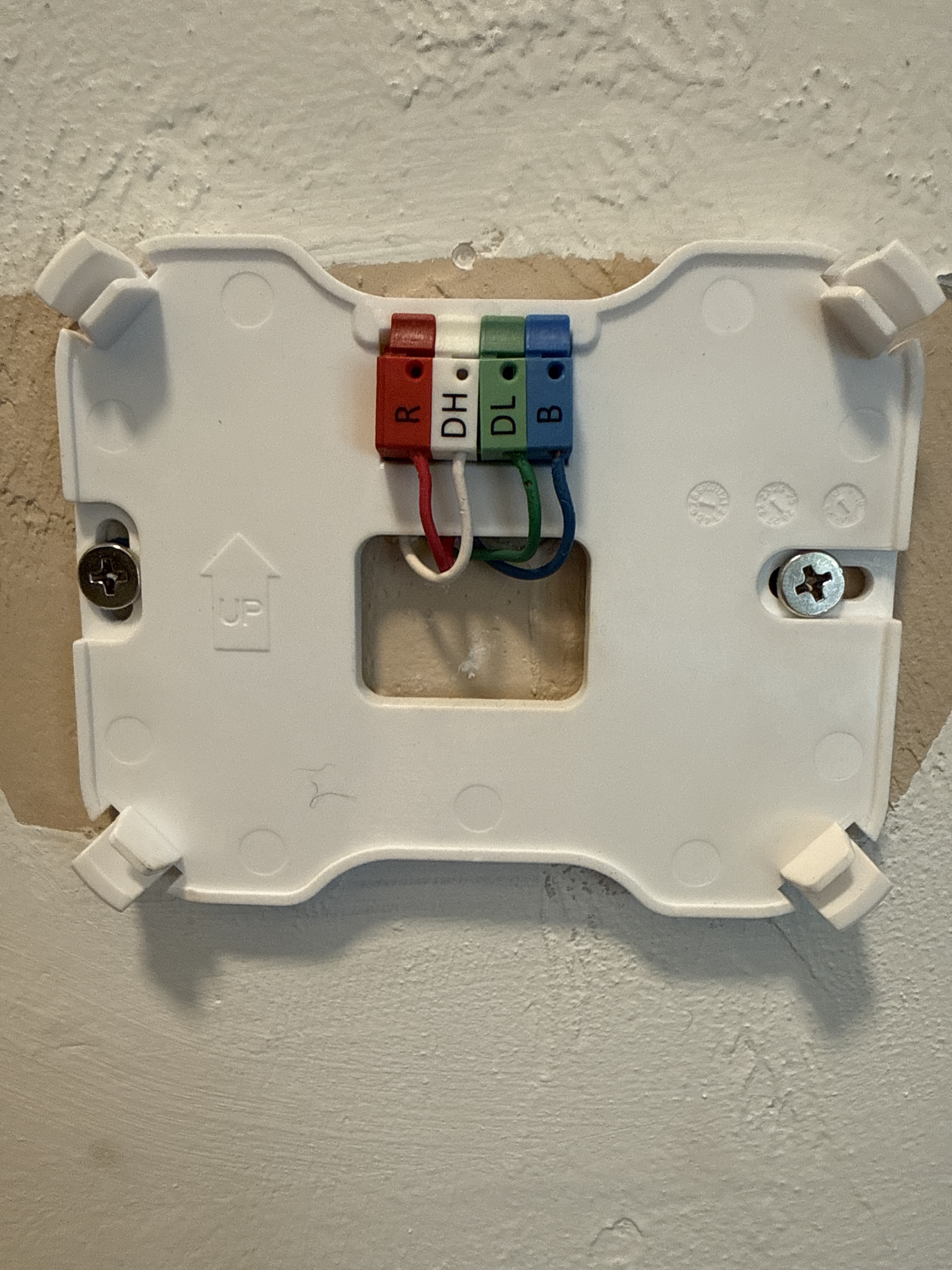

It was installed last year.

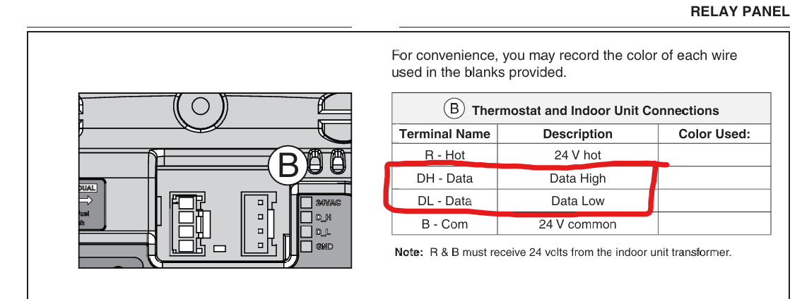

Unfortunately, that appears to be a Trane/American Standard ‘communicating’ thermostat based on the wiring.
Data High and Data Low are not traditional thermostat wire terminals.

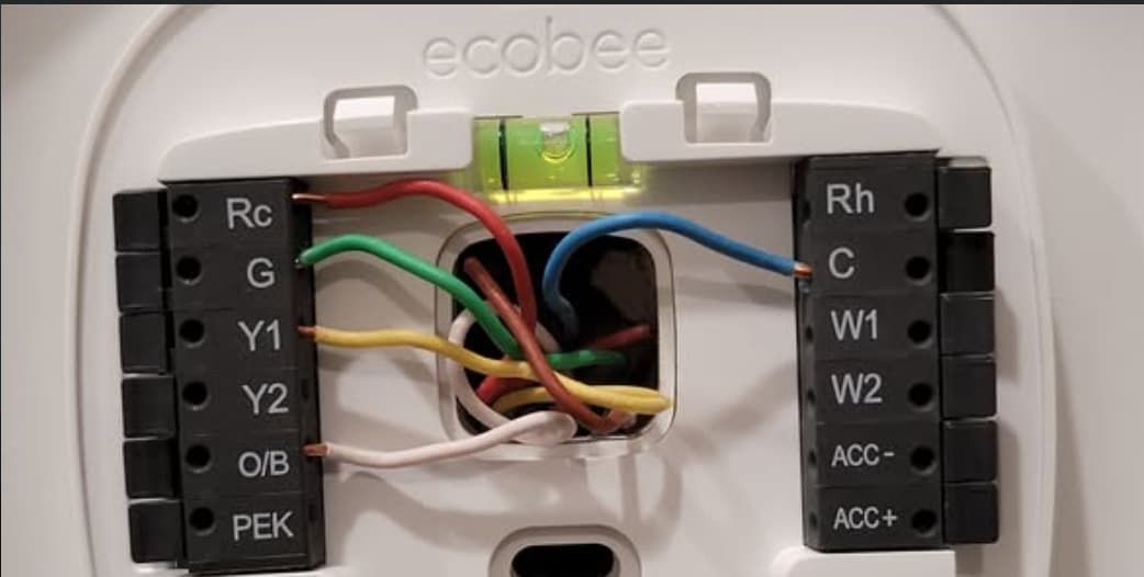

This is what traditional thermostat wiring looks like.

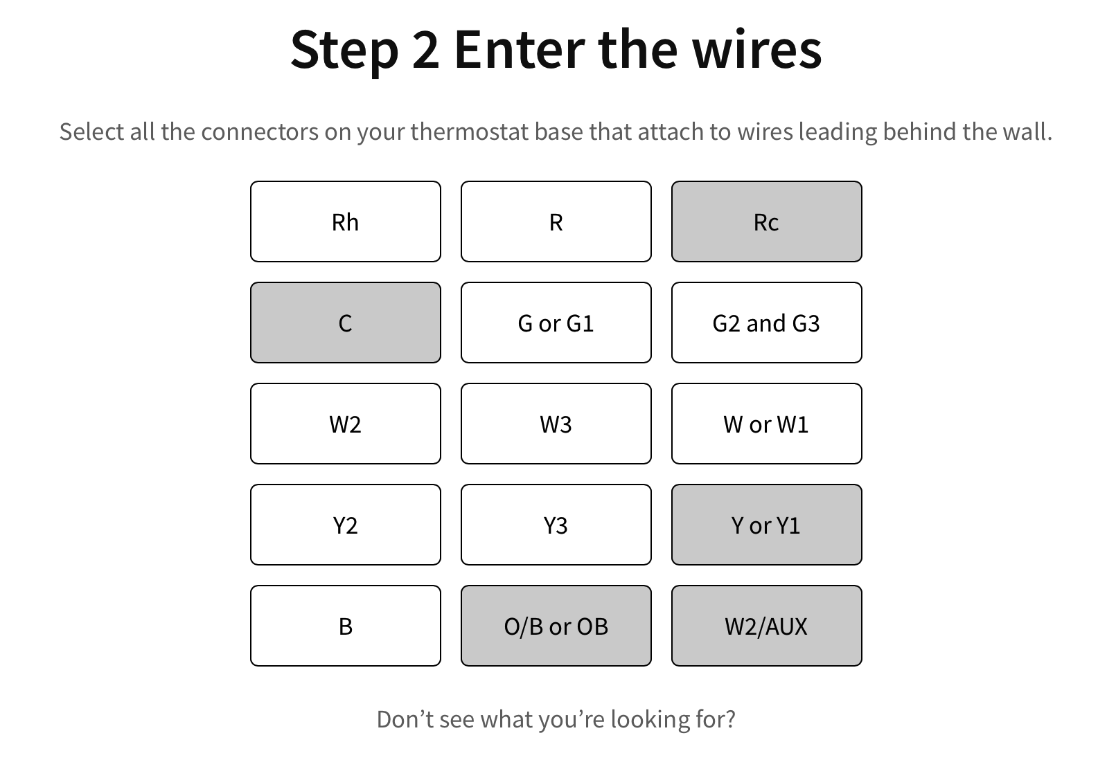

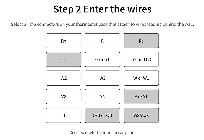

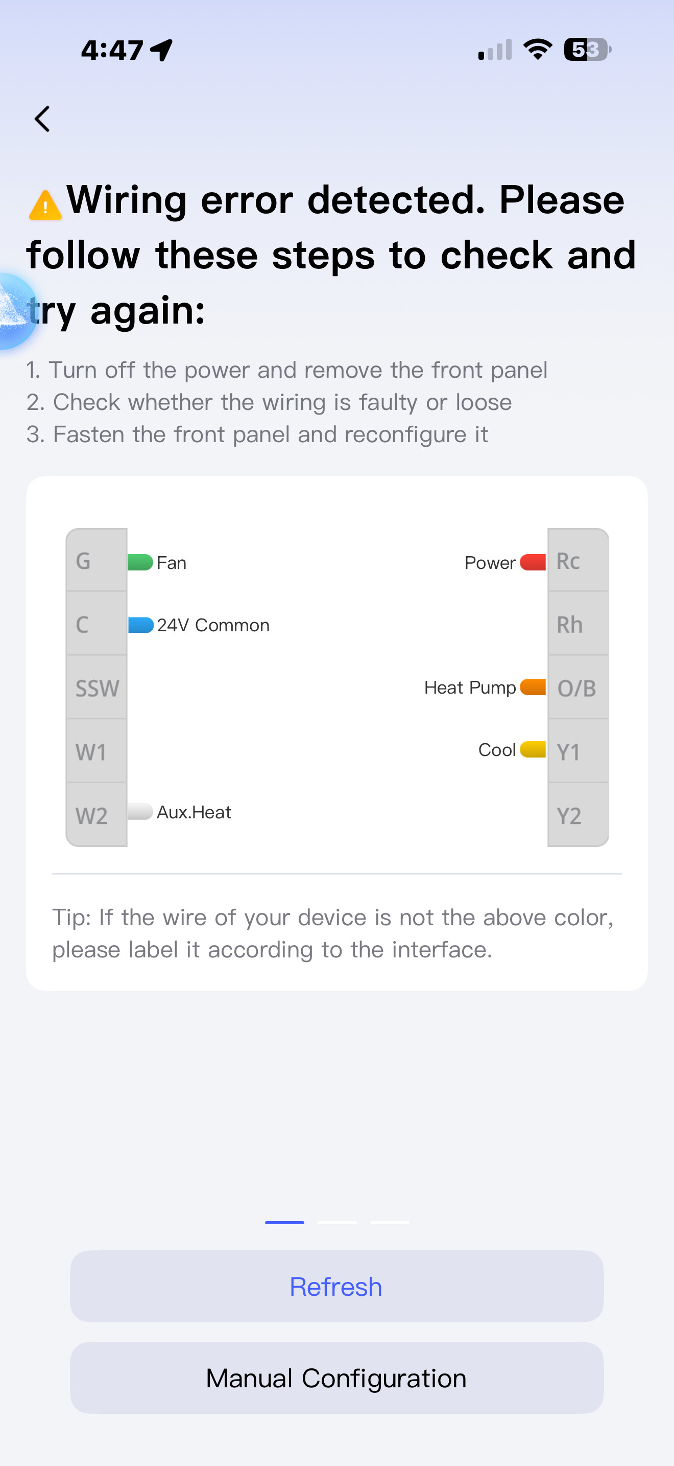

I submitted my wiring info online and got “Based on your wire selection, the Thermostat Hub W200 may not be compatible with your system.” See the attached diagram.

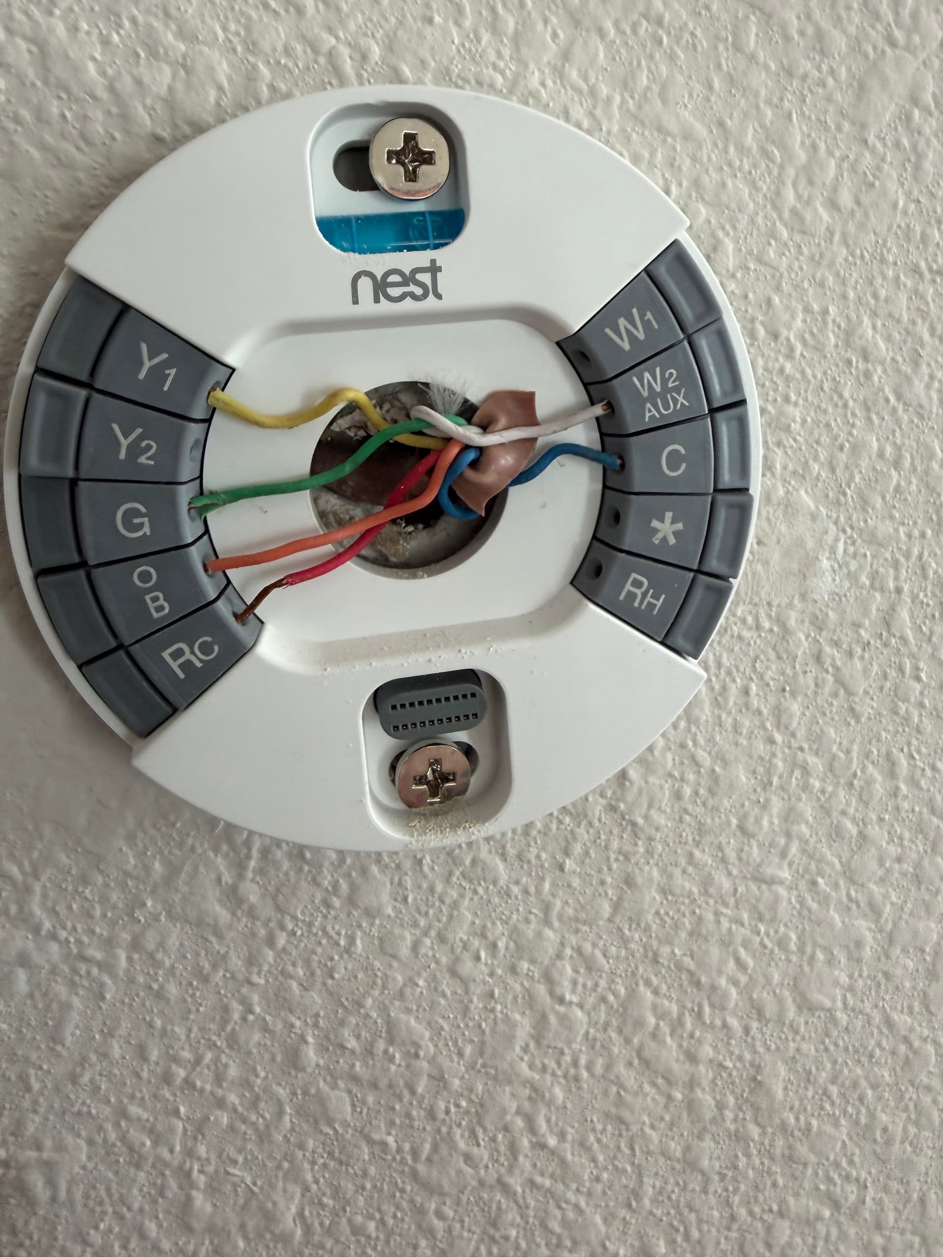

Unfortunately, I didn’t realize the compatibility problem before I ordered and installed it. The Carrier HVAC system worked fine with my Nest thermostat, but the W200 gave me the wiring is wrong error, and it instructed me to check for loose connections. I kept fooling around making sure the wires were the correct length and were properly stripped, but no luck. It was recognized by my Aqara app, so I thought it was definitely a wiring problem or my faulty installation. However, after reinstalling for the fourth time I gave up and reluctantly reverted to my Nest.
I hope the compatibility gets resolved soon, because I want to integrate the W200 to work with my other Aqara devices.
I also uploaded this info to Reddit to see if anyone encounters the same problem.
Pictures of how the Nest is wired, as well as how you attempted to wire the Aqara W200 would really be helpful to allow the community to assist you.
I did’t upload photos, but I uploaded a snapshot of the connected wires Rc, C, Y1, OB and W2/Aux. I’m now uploading a photo of the connections the W200 and the Nest detected. Also a photo of the actual Nest connections; sorry, don’t have a photo of the W200 connections because I returned it. However, as you can see I had the same colored wires connected to both thermostats.

Should work.
Y1->Y1
G->G
RC->RC
O/B->O/B
W2->W1
C-C
Did I understand you correctly that my HVAC system will show as compatible and work correctly by connecting the W2/Aux I have to the W1 terminal?
I know that if I use the Aqara Thermostat Hub W200 Compatibility Checker, it indicates that the configuration using W1 will work, but I’m presently using W2/Aux on my Nest, and the checker indicates that it’s not compatible. Thanks.
Their link I provided for wiring says:
“5. My old thermostat has a W2 wire. How do I wire it for auxiliary heat?
Answer: If you only have W2 (no W wire), connect the W2 wire to the W1 terminal . Leave all other connections as normal.”
Yes,it can work correctly~
