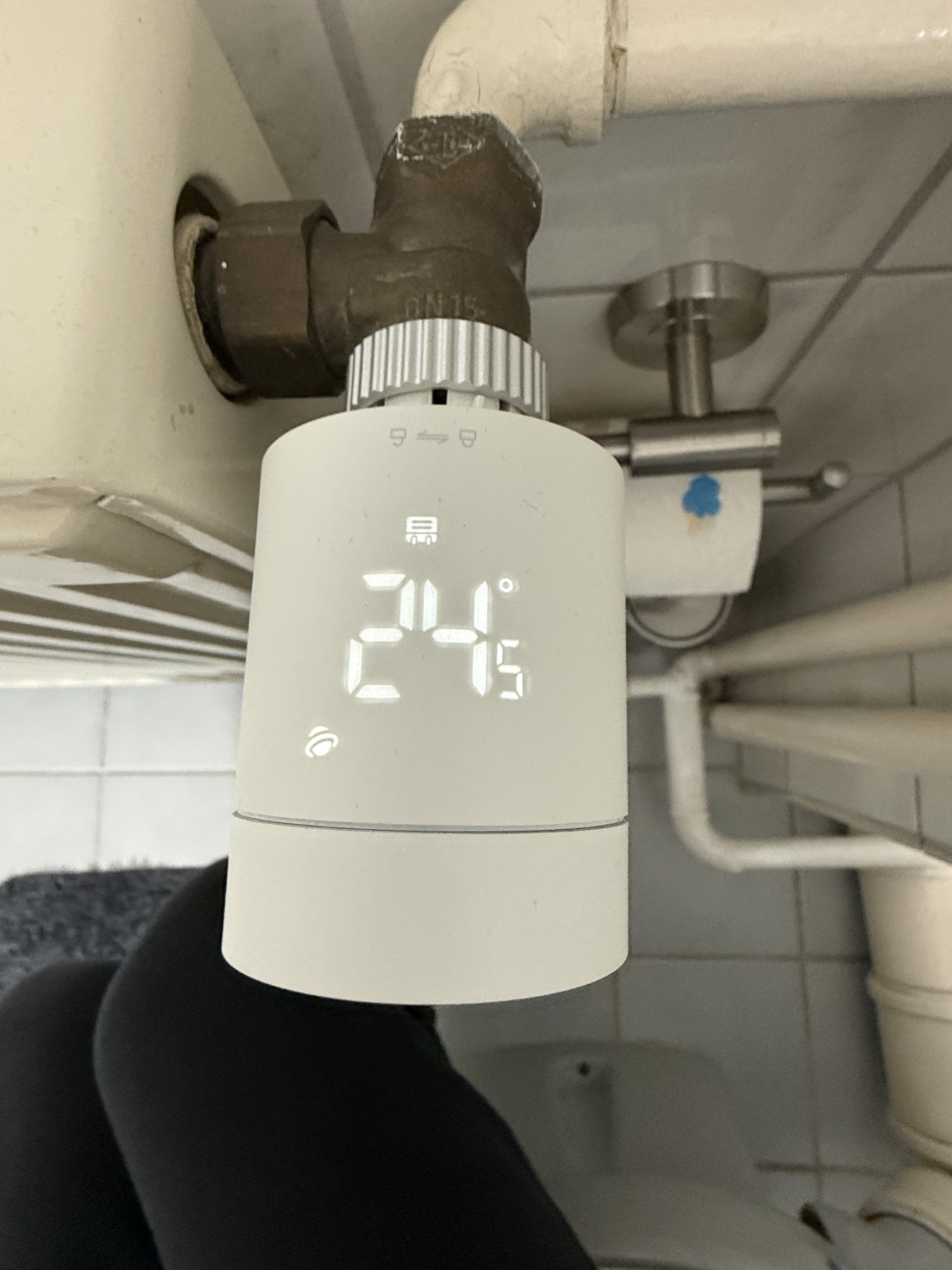

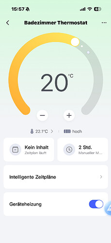

Press 1 time, means current temperature. Only 24.5 is displayed for me. No matter if the heating is on or off. Thermostat is set to 20, but heats up to 22. There’s something wrong.
It just shows the current temperature. What’s wrong here? It’s just warm. The app hasn’t updated. Go to the temperature chart.

To avoid additional power consumption caused by repeated startup and shutdown of the device, the current default temperature hysteresis of the W600 is set to 2℃. Under this setting, it will maintain a stable operating state without frequent startup and shutdown.
If you need the device to respond immediately when reaching the target temperature (without the aforementioned stable range), you can enable the temperature compensation function and adjust the compensation value to +2℃ or -2℃. This offsets the response delay caused by the default hysteresis and achieves instant temperature triggering.

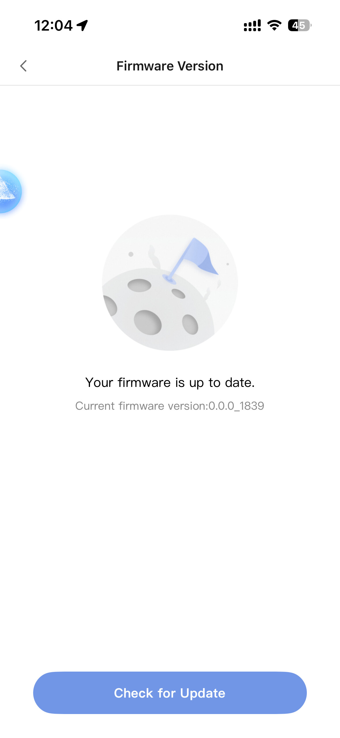

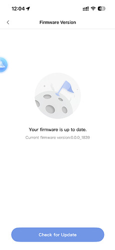

What is the version and when was it released?
what version number? patchnotes?
