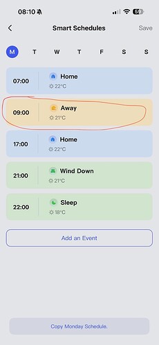

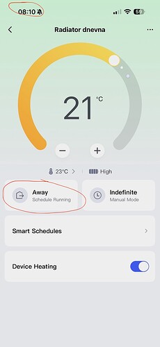

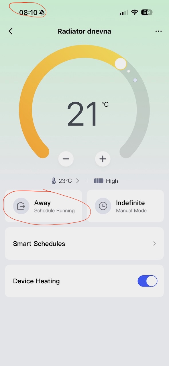

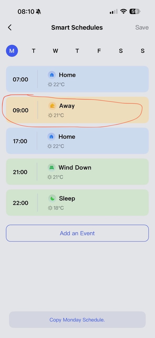

I have just noticed that smart schedules don’t use the correct time for Events… Maybe wrongly used daylight saving times?
