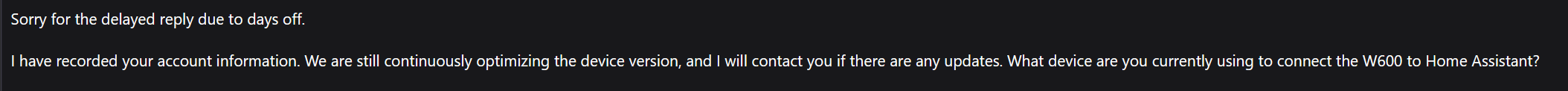

I contacted the aqara support again and and they told me they are still working on the optimization:
