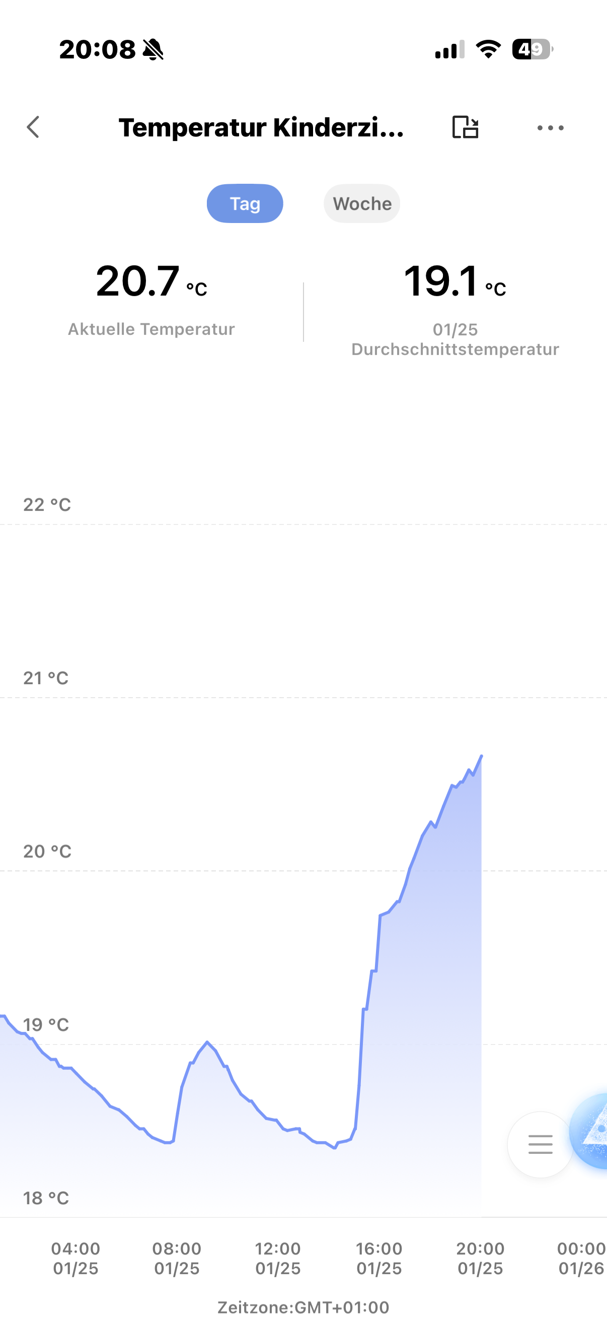

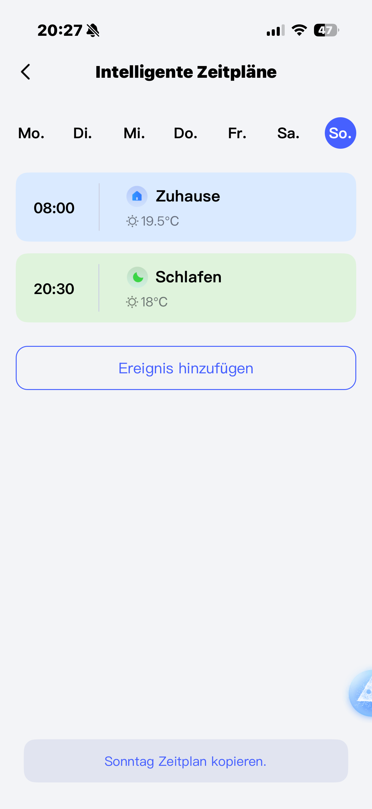

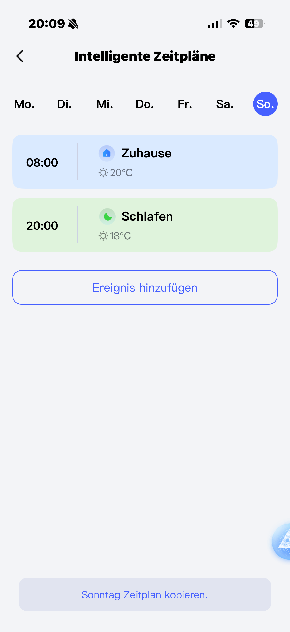

I confirm, it works perfectly, there are no problems with a reasonable schedule at all.

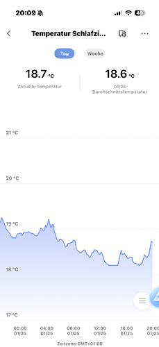

Do you have any chart? So you say and external temperature input is ready now and the PID Algorythm is working great?
Nothing works for me. It’s a disaster.
I don’t look at the temperature of the W600 radiator, it’s the temperature of the room where the radiator is, everything is OK here.
It’s the temperature of the w100, in the middle of the room.
Yes, W100

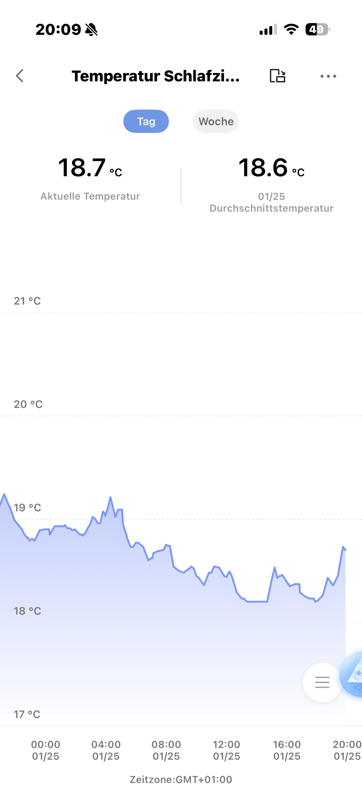

It still doesnt reach target temperature with version 2644.

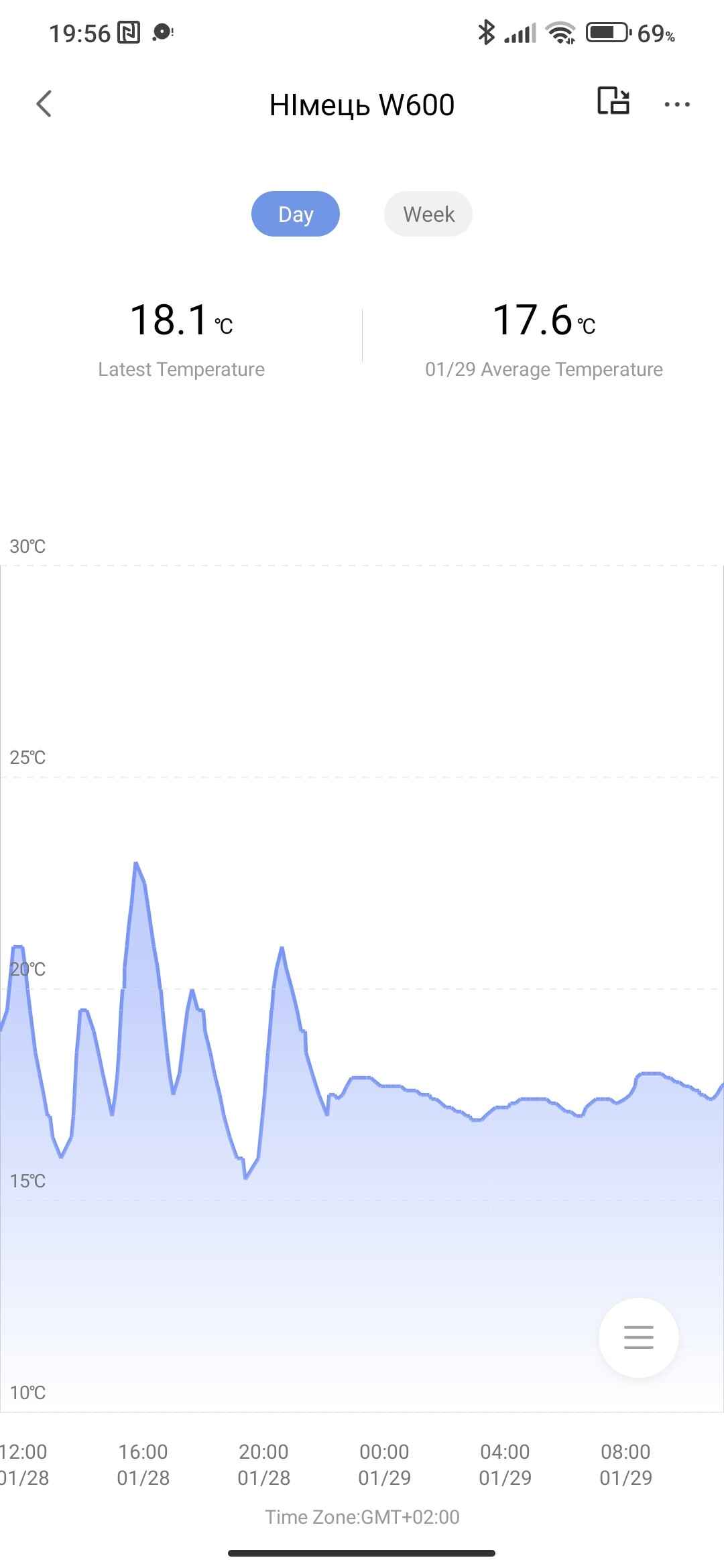

The latest update has not been successful for me.
Schedules don’t work.
2 do not reach the temperatures. One heats up all the time, above the set temperature.
All devices reset but no success.

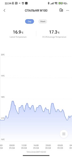

Hello, is the W600 tied to an external sensor?
Yes, W100

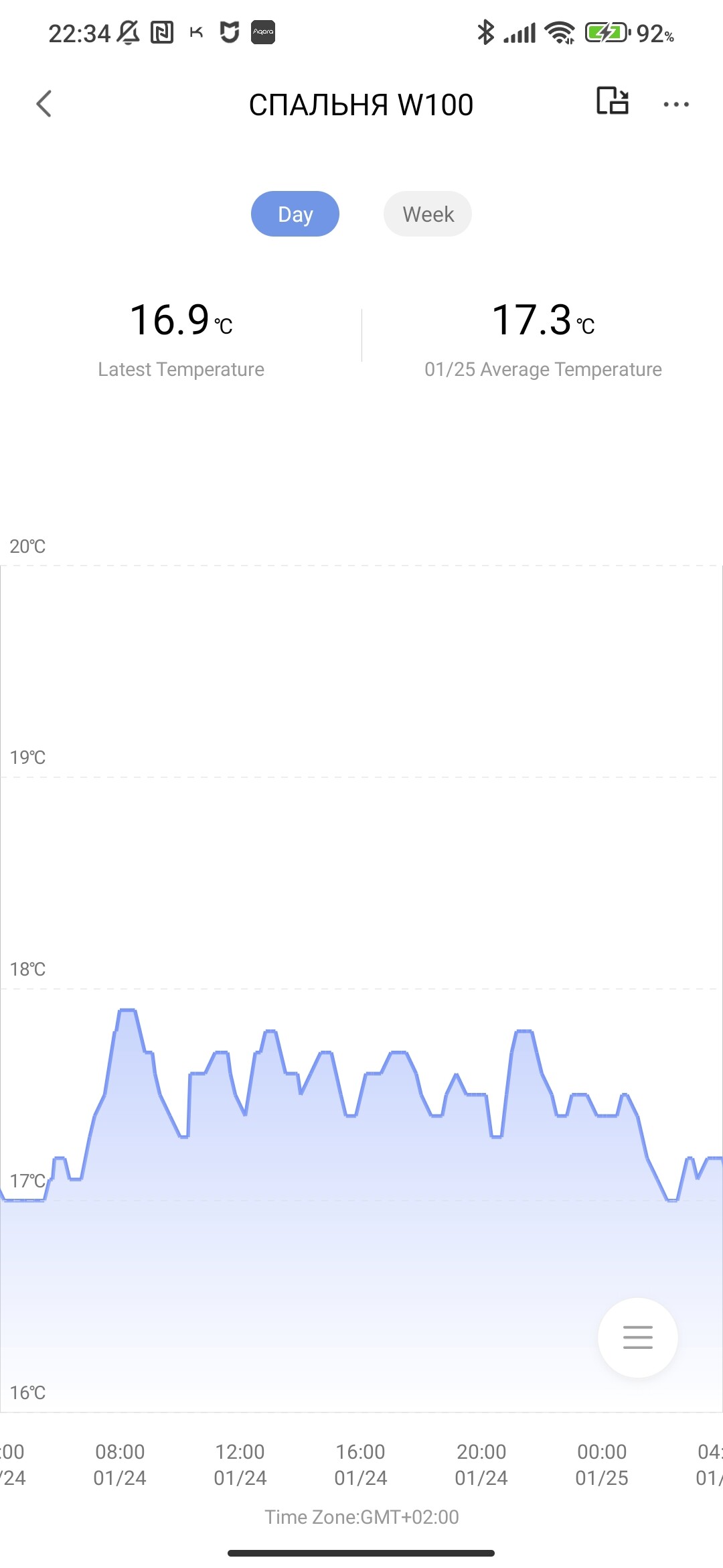

Hi, this problem has appeared recently. Re-bind the external thermometer. If you have a W100, give a sampling period of 10 minutes.
Specialists said they are working on this problem.

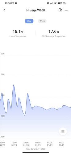

This is the W600 screen after reconnecting.
Thanks, but I’ve been doing that for a long time.
No improvement
Reconnect the W100 several times.
